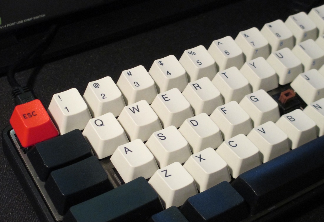

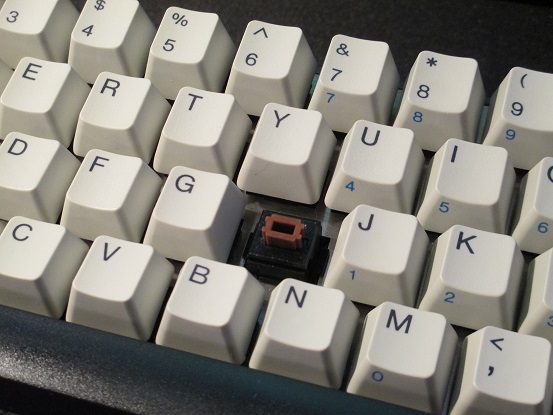

I wish I could take credit for building this 60% board with brown Alps, but I cannot. I bought the board on eBay from another keyboard enthusiast. He got the brown Alps switches from a Videowriter 250 keyboard and originally populated it with dye-sub PBT caps from an SGI board. However, I decided to add some finishing touches of my own.
The SGI caps are excellent, but I wanted the alphas to be whiter and in a non-Italic Helvetica font, so I switched the caps with alphas from an IBM 5140 and added a red Esc from SP. I got the blank black mods from Matias -- they are ABS, but I find this okay for modifiers. Matias didn't have a stepped Caps Lock, but they did have a 7-unit spacebar along with 1.5- and 1-unit keys for the bottom row.
I tweaked the spacebar stabilizer to smooth out the action, and I added some rubber pads under the spacebar stabilizer mounts to quiet the downstroke. I also put some rubber foam strips inside the spacebar to improve the sound a bit.
Finally, I changed the case from stock plastic to a TEX aluminum case. The TEX case came with nice aluminum feet, but these are too short to elevate the board to an angle that I find comfortable for typing. I needed something that would raise the rear of the board by 0.75 inches. It proved difficult to find self-adhesive feet that were 0.75 inches tall -- hemispherical ones would each look almost as large as half of a golf ball. Finally, I located some self-stick conical feet that look and work just fine.
With the steel frame and aluminum case, this is a very solid and rigid board, which seems to accentuate the definitive tactility of the brown Alps switches. The switches are intrinsically non-clicky, but I cannot help bottoming out, so with me typing, the board sounds as if it had clicky switches. When I first tried the board, I thought the switches were too heavy, but I have been typing on them all day, and I like them very much.
Another bonus to this board is that it is fully programmable via Hasu's firmware. I haven't programmed it yet, but I am using ATNsoft Key Manager to give it a HHKB layout.
Overall, this keyboard is a joy to look at and use.

Back to the keyboard -- I have little experience actually typing on genuine Alps-switch keyboards. Before acquiring the brown Alps board, my closest encounters were with my Matias-switch V60s (Click and Quiet Click). Unlike the Matias-switch boards, the keys on the brown Alps do not wobble, although I do not find the wobble of the Matias keys to be objectionable at all -- it is just different.
18 Apr 2016, 00:22
I really disliked the wobble on the Matias Ergo, other than that a great Ergo keyboard. I was also suprised at how different the Matias-switches are to Alps SKCM since Matias based their switch on Alps SKCM.
