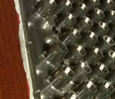

lot_lizard wrote: Also, as a reminder, all unused holes in the top plate can be covered by 19mm sheet metal plugs
Speaking of which: can I have some? And how easy are they to install / remove? Just in case I get ideas someday…
They are not too difficult to install (15-25 lbs of pressure), but I am going to preinstall those for folks if they like. I had a small number of other questions I didn't want to overwhelm people with when filling out the initial forms if it didn't impact parts quantities. Regardless, there will be approx. 10 of these (5 in your spare parts bag), and they are typically reusable.
The plugs have been ordered btw. I don't think I unannounced that one yet.
EDIT: tested one of my existing 1/2" ones. Was 18 pounds of pressure. Corrected the above. Point being you don't need to be one of the Avengers to work with them.

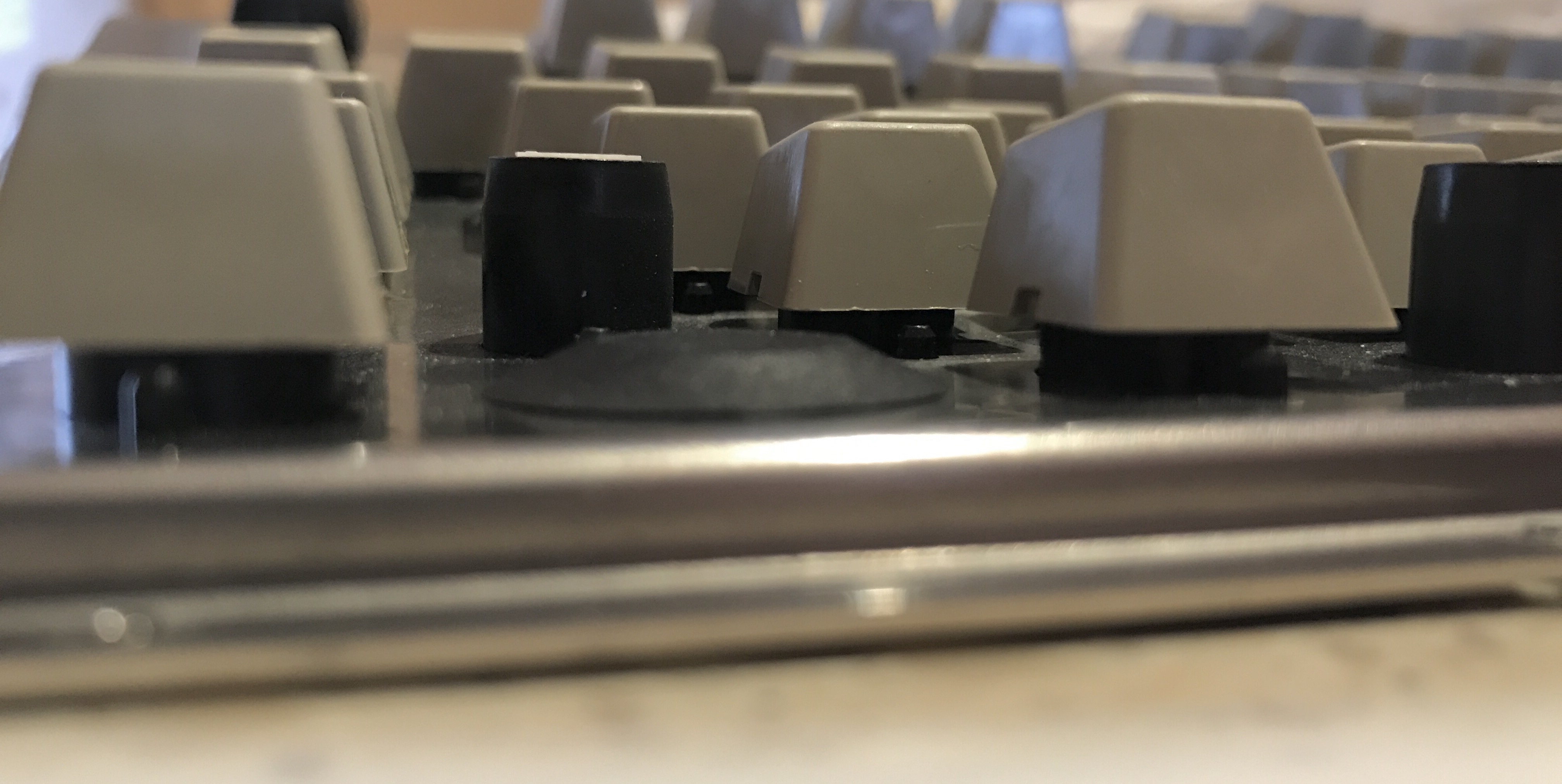

one question about the foam: the foam is supposed to stay between pcb and back plate or between the flippers and the pcb??
I made a curious experiment with my frankenstein work here and a model m thin foam between flippers and pcb and somehow it sounds not so nice imho.. it looses some of the F to go into the M sound.. I know the foam is super thin and ugly, but do not remember where is the positioning that is supposed..

tentator wrote: one question about the foam: the foam is supposed to stay between pcb and back plate or between the flippers and the pcb??
For the FSSK/FEXT, there was no foam... or if you did add a thin layer, it would be under the PCB. For the MF project, it is like a traditional F foam and sits between the independent barrels and the top plate. I also have a VERY thin layer of latex that is currently sitting under the PCB in one of the prototypes. Once we get the final set of plates in, I will test the foam layers one more time before making a decision. The change is very subtle mind you, so we might save a step and avoid the undermat (just use our modern spin on the traditional foam layer).
I have experimented with it for many hours now on the past several weeks, and we want it to be as good as we can make it without over architecting. We are very close... Just needs testing with the final plates (which need to wait until the controller can be fitted)
tentator
22 Dec 2016, 23:33
I see, very interesting. But so you didn't experiment with layer between flipper and pcb (I suppose the key will still register without issues if there is a thin layer between flipper and pcb), asking actually because of how it would "sound".. I mean to me it sounds a bit more silent but also a bit more "plasticky" and less "metallic" as it normally sounds when the flipper hits the pcb.. also ringing is attenuated.. but still in the end prefer the traditional f sound.. of course here I could only test it with a model m (platicky) barrelplate :)

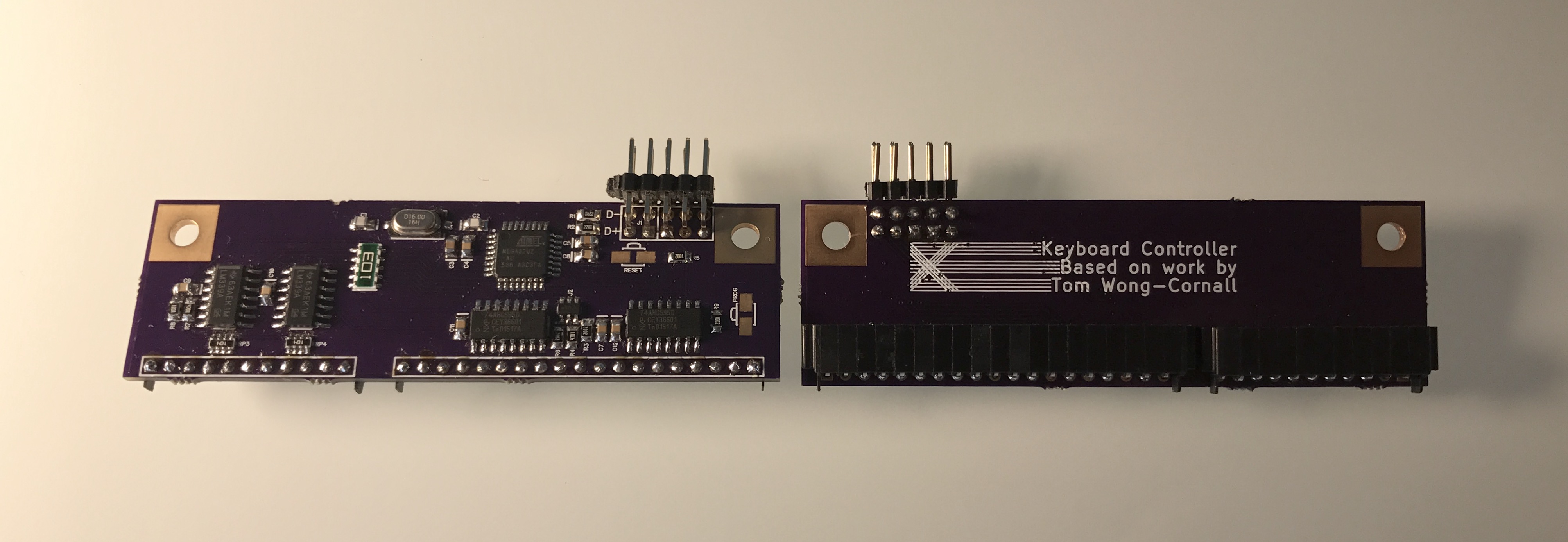

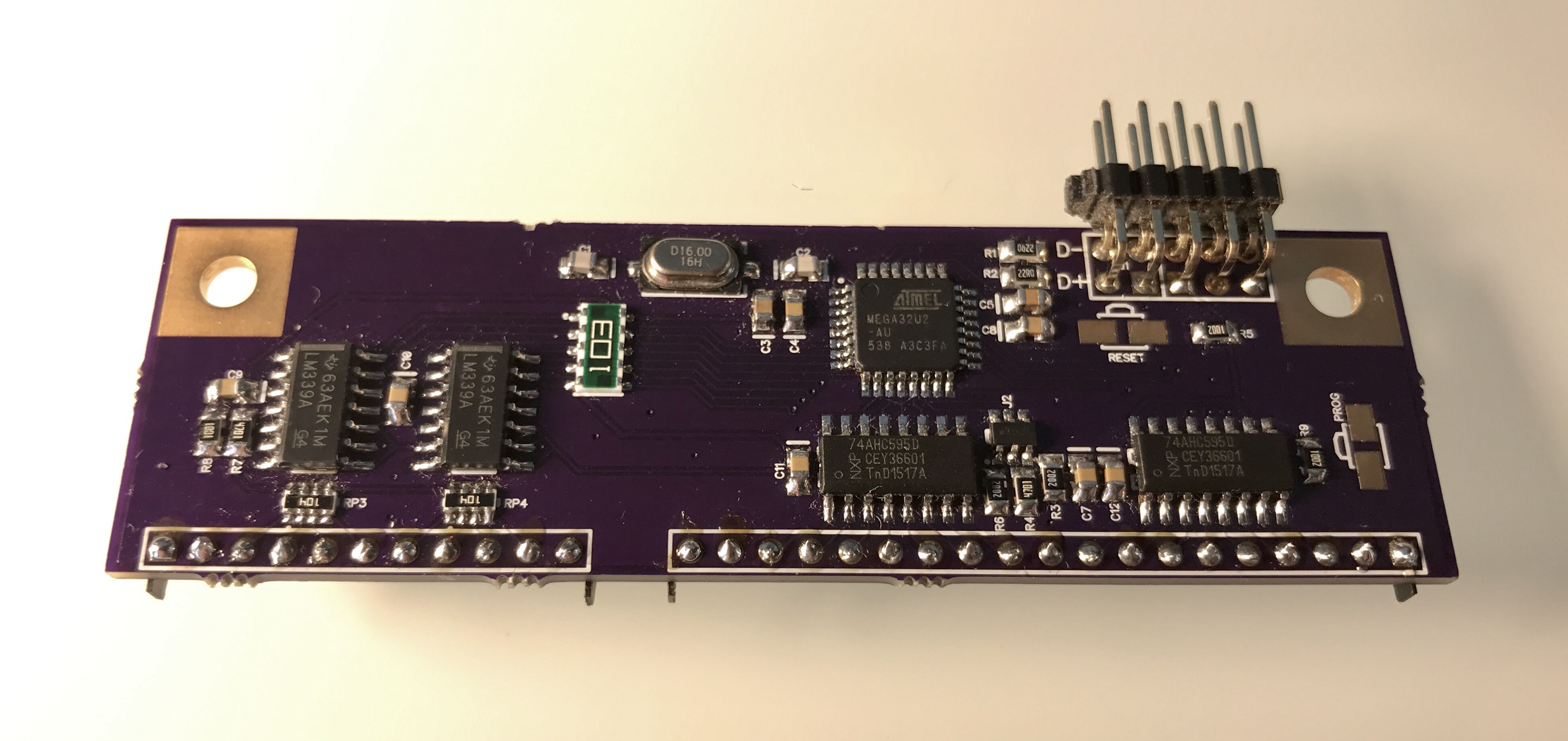

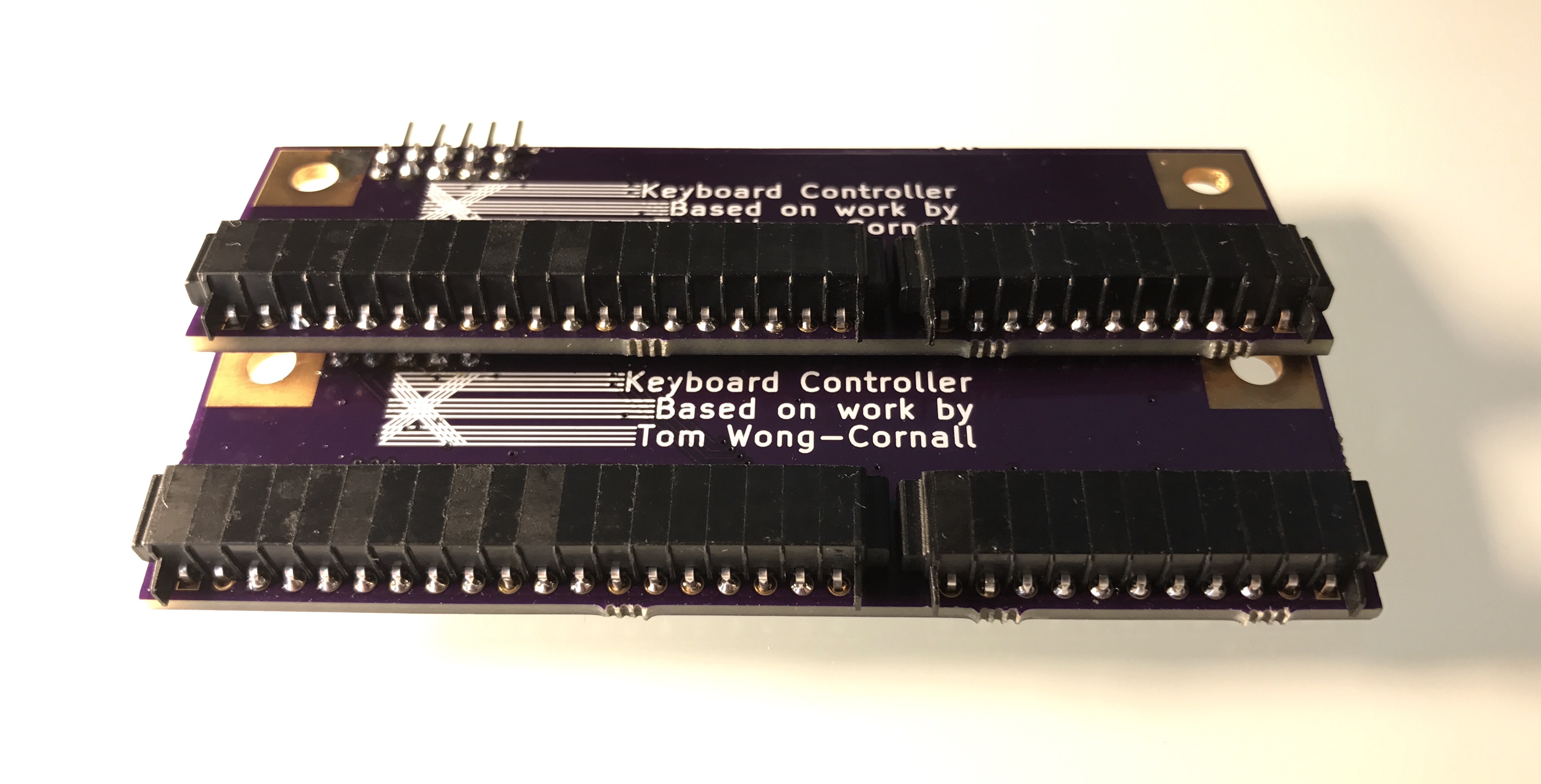

Sorry for the delay on updates everyone. We have been making some nice progress, but I haven't been able to get to the PC much with the holidays to post. I am putting together a progress "table" that I will add to the 3rd post so everyone has a nice place to go for a complete picture of timeframe for all parts and configurations.
I am happy to report though that our only known inhibitor (the controllers) are now ready for full testing. Thought you would appreciate some pics. The connector is a dream btw... So happy we decided to take that approach.
"Twin" brothers ready to do some heavy lifting
mini xWhatsit from the front
View of the slip-on connector profiles from the back

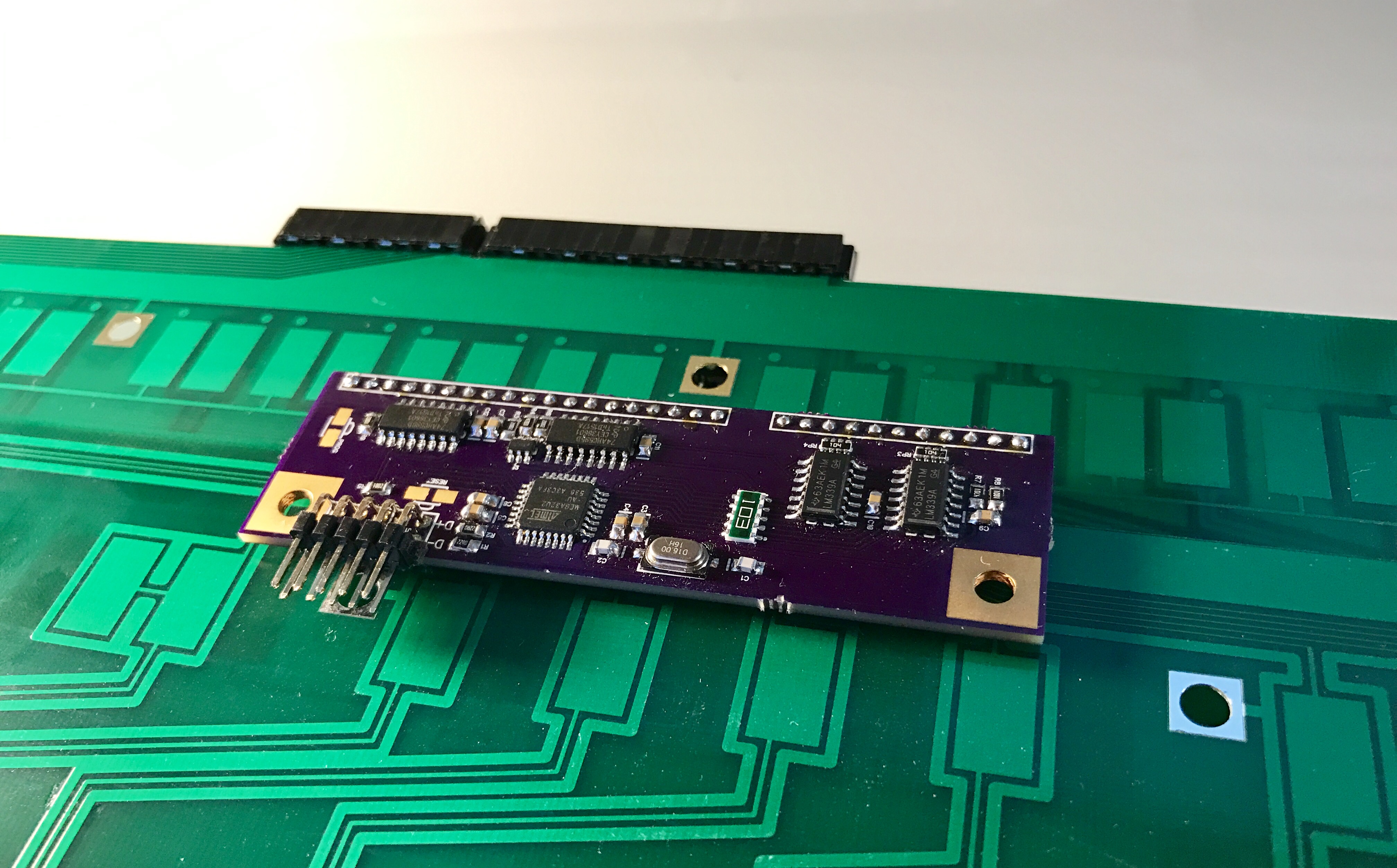

Test fit on both the SSK and Full-Size

Dont be sorry! this GB is moving faster than most other GBs, and is about 10x more complicated.
-[°_°]-
29 Dec 2016, 00:10
agreed
tentator
29 Dec 2016, 12:58
looks lovely!!!
Ir0n
29 Dec 2016, 13:04
._. I should have got a spare controller..
This group buy is going so smooth..I can't wait to try those new springs out.
livingspeedbump
Not what they seem
29 Dec 2016, 15:50
lot_lizard wrote: Sorry for the delay on updates everyone.
What? I don't think I've ever been in a group buy this this many/this frequency of updates. ;)
The progress and controller do look great though!

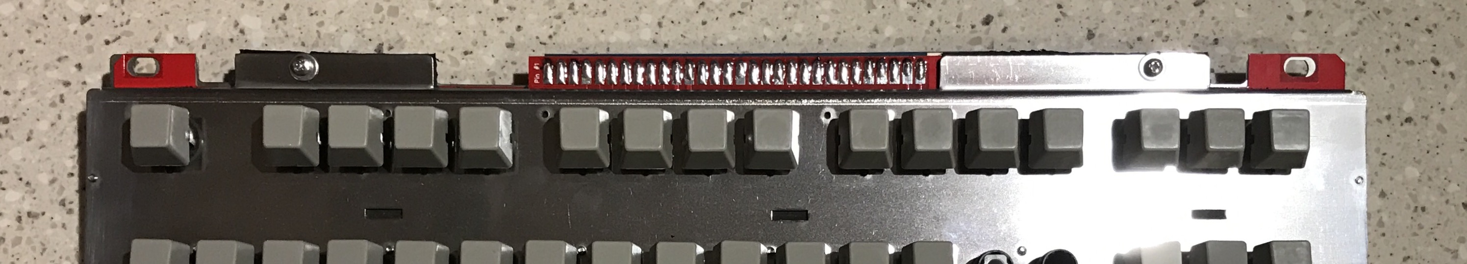

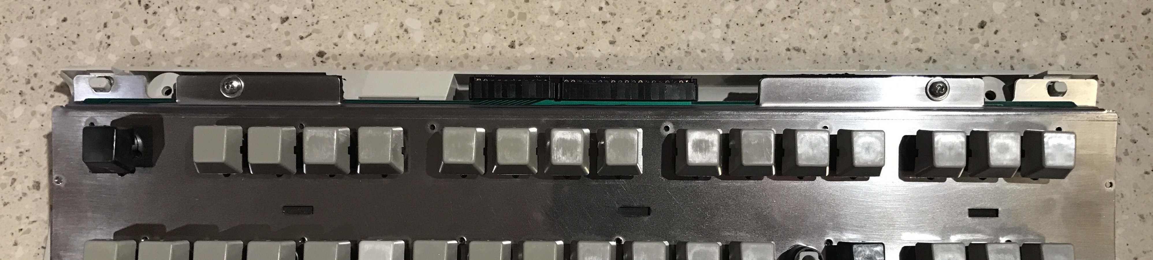

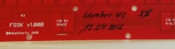

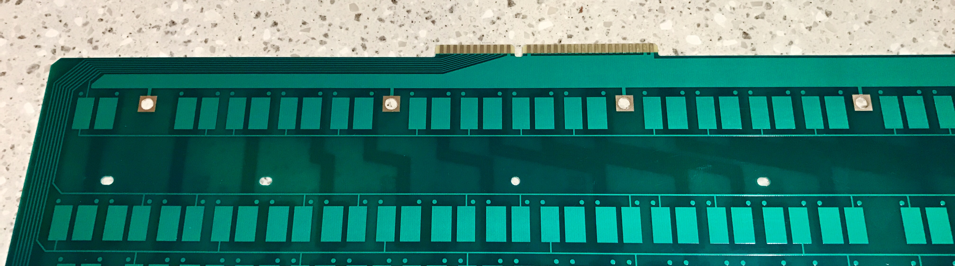

Doing some testing today against the SSK plates to validate the new controller and PCB. I should feel comfortable enough with the designs to make a call to the metal fabrication folks to produce a "final" set of protoype plates on Monday. After they are through, I will take them to our finishers (powdercoat and Chromate) to make a full test run through this process.
Everything is assembled and functional at this point. Just need to hook up the USB and take it for a test drive. I'm not going to be able to tension the center screws since we shifted our holes around in the new design. Keep in mind these tension screws really only provide mild adjustments. It is consistent and audibly nice without them. We just had room, so why not.
The following are some pics so you can see the controller and PCB changes. WCass bought us some nice room along the top ridge of the assembly that I can take advantage of. I made my adjustments as he was making his, but need to take a lot of measurements to validate before publishing the renders. One thing he did was keep the top of the PCB inside the assembly, which enables me to make mild tweaks to screw placement without bothering him about through hole adjustments. Our new top ridge on the plates are much more ideal in the redesign (again, renders to come)
Previous top edge of the FSSK
New top edge of the MF SSK

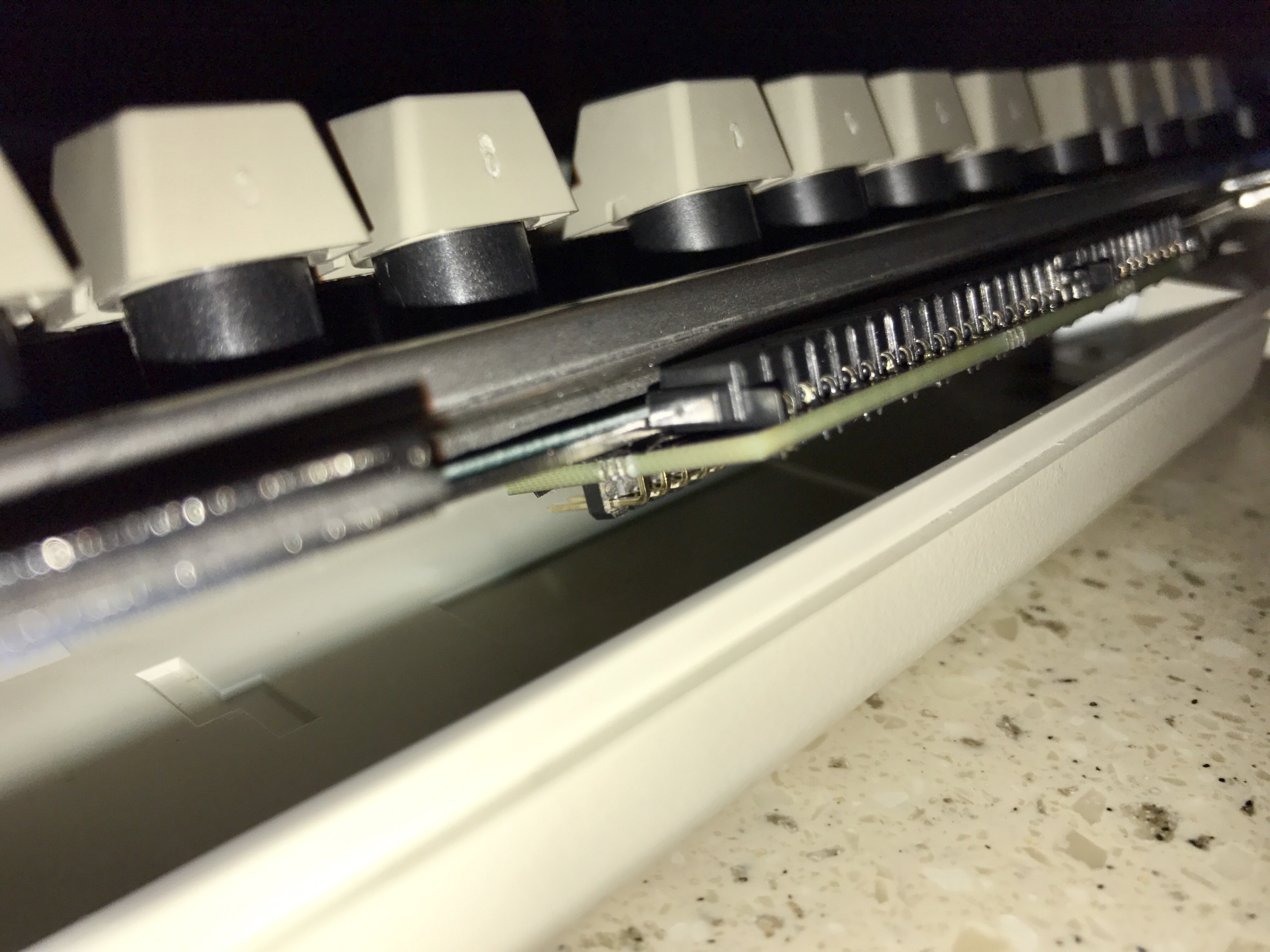

Hard photo to take, but the room under the assembly with controller attached.

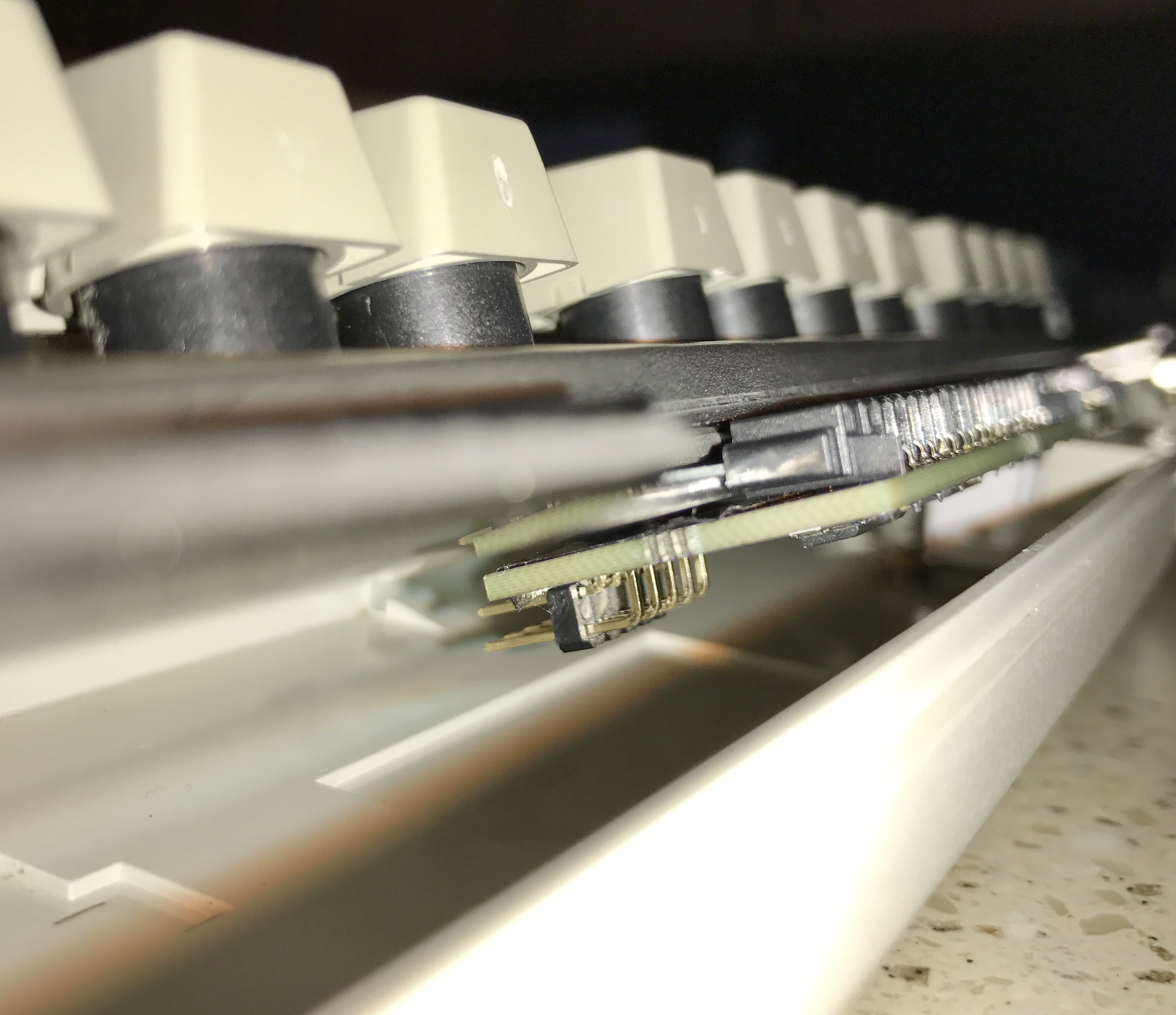

Another underneath shot that hopefully gives depth when combined with the previous

Nice. Is there anything supporting the bottom of the controller?

chzel wrote: Nice! Maybe now we can fit a large enough battery inside to go BT and make Mu happy!
It really did buy "gobs" (technical term) of room. The neat bit about this modular daughter board for USB, the BT integration can occur there as a replacement board in the future without smurfing with the xWhatsit.
One thing I have been meaning to point out, and maybe some of you have already noticed... The tension screws that separate the F-keys are different now. They are grounded. The two in the center I actually do need (by the controller) to keep proper tension on F5-8, but the two on either side have no real value. So... we are going to add two tapped screw holes TO THE BACK PLATE ONLY. Then we will add two ground screws that secure the PCB to the back plate before assembly. This will REALLY help us out with any grounding considerations, and will also make the assembly process easier since the PCB will always be lined up.
Ground screws securing to the back plate on the 1st and 4th holes above

E TwentyNine wrote: Nice. Is there anything supporting the bottom of the controller?
Why are you stealing all my announcement fun ;) (completely playing). The current plan is yes, but that is one of the pieces I need to validate in the blind adjustments I made previously before having all of this together. In the end, the goal is that the controller is grounded twice, and the PCB is grounded twice (both to the back plate).
The controller actually sits flush against the back plate beautifully. I have notched out already for the outbound header pins in the back plate since they protrude, and we will have to add an insulating layer to the back of the controller. Part of the trick with the controller grounding will be making sure I can find screws with the correct depth (so they don't come up through the back plate and contact the PCB). Working out to be highly ideal though (was on paper before, but is proving out to be in reality).

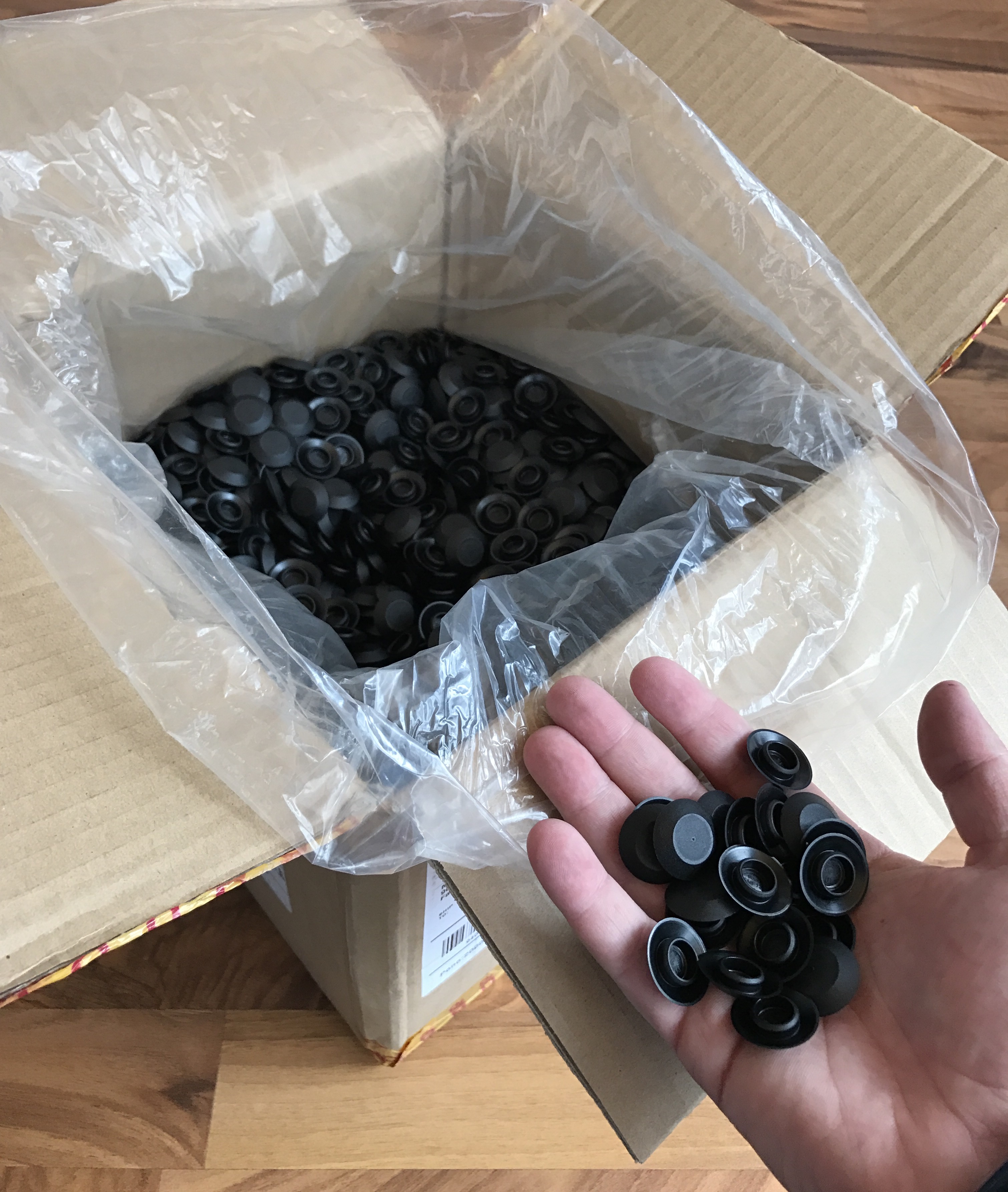

Sheet metal caps arrived... They look good. Not too rigid, not too soft. Just right. The second picture is how they would sit in relation to the keys. Keep in mind that all the keys are fully pressed at the moment because I just removed all of the springs for testing.
EDIT: and it looks like they sent me about 50% too many, so plan on having plenty of extras in the spare parts bag.
