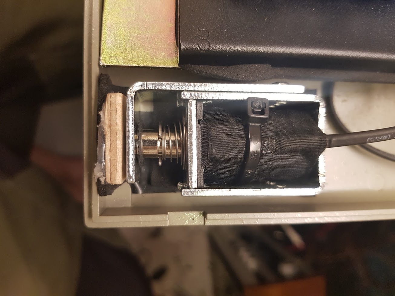

Twst
13 Jun 2020, 20:22
Been tweaking the solenoid sound, and have settled on a little plywood glued inside to fire on.
Gives more of a thock versus the pinging from hacking directly at the chassis. ;)
13 Jun 2020, 20:28
Twst wrote: 13 Jun 2020, 20:22 Been tweaking the solenoid sound, and have settled on a little plywood glued inside to fire on.
Lovely. Now the quest for the best wood type begins! :D
Twst
13 Jun 2020, 20:42
depletedvespene wrote: 13 Jun 2020, 20:28 Lovely. Now the quest for the best wood type begins! :D
Haha :lol:
And this was just some cheap scrap baltic birch. Makes me wonder how exotic hardwood types will sound :D
