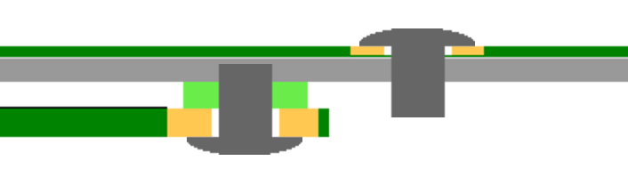

So to describe what we are going to test in the final prototype better, I put the following (crude but to scale) diagram together help see it a bit better. The layers are:
  • PCB (top green)
  • PCB insulating/protective layer (light grey)
  • Steel backplate (darker grey)
  • Header pin lift of the controller off the backplate (white)
  • Controller insulating layer, which would cover the header pin protrusions as well (black)
  • Controller (green)
In grounding the controller, m3x4mm pan head screws would have ~1mm bite into the backplate (plenty without passing through) if we have a ~1.5mm riser (lime green). The same screws would be used to ground the PCB to the backplate. The PCB ground screws will pass through the backplate ~1.8mm, but that doesn't bother me at all aesthetically. We want them to pass through some to achieve as much thread contact as possible.
To be honest, this securing/grounding of the controller to the backplate is unnecessary altogether really since we are grounding the PCB, but I am going to have the final prototype made with the needed backplate taps just to test it. If it is amazing, we will go with it... if not, the controller will only be secured by the triomate slip-on connectors (which is quite sturdy). The "riser" (lime green) would be a loose part similar to a washer, and would not be permanently attached to the backplate.

chzel
01 Jan 2017, 12:58
M3 has a thread pitch of .5mm and considering that the first/second threads are usually not fully formed, I'd be surprised if you managed to grab more than half a thread there. And even before that, how are you going to cut the threads on the plate?

lot_lizard
01 Jan 2017, 13:24
chzel wrote: M3 has a thread pitch of .5mm and considering that the first/second threads are usually not fully formed, I'd be surprised if you managed to grab more than half a thread there. And even before that, how are you going to cut the threads on the plate?
The threads will be cut into the plate using a traditional taper tap. For the m3x4mm screw, I had trouble finding them, but these screws have no "pitch diameter" (think flat tail). Normally a screw is made of three diameters (major, minor, and pitch). The pitch diameter only comes into play on the final thread as you mentioned where the tail tapers off. In this case, it wouldn't taper (the thread just dies flat). It does make it a bit tricky to thread properly when screwing in though. You would always want to counter-clockwise rotate softly until you hear/feel the "click", and then clockwise rotate.
Foreshadowing: I think we nix the controller ground screws in the end the more I have the working prototype in front of me, but want to know for certain. Having standoff's welded as the "riser" (lime green from before) is just a wasted expense that we really don't have a margin for.

DMA
01 Jan 2017, 16:55
lot_lizard wrote: In grounding the controller, m3x4mm pan head screws would have ~1mm bite into the backplate (plenty without passing through)
And then some extra-strong user will just strip the thread in that blind hole.
And it would be game over, because you can't replace the bolt which isn't there. :(
But, since you mention that you won't be doing those controller grounding screws - this all is theoretical. :)
lot_lizard
01 Jan 2017, 18:09
Exactly... In fact, it's officially off the table. Pulling on this in tests right now, if you manage to wreck this triomate only mount, you need to find a new hobby (like working for the airlines handling luggage :lol:) Along with pan heads securing the PCB ground on the 2 unneeded tensions, I'll make all 4 grounded, with the 2 tensions using short standoffs. The standoff will act as the pan head in the previous diagram.

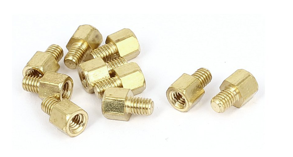

So I have new designs for both plates where we are going to ground the PCB to the backplate at 3 points for the SSK and 4 for the full-size. Do you even think we need to worry about grounding the controller separately? The reason I ask, I am getting rid of the need for bolts/nuts at all on the top ridge now. If you think we need one, I will add it back.
The ground of the PCB will be with standoffs that can still be used as tension bolts if needed (like below)
