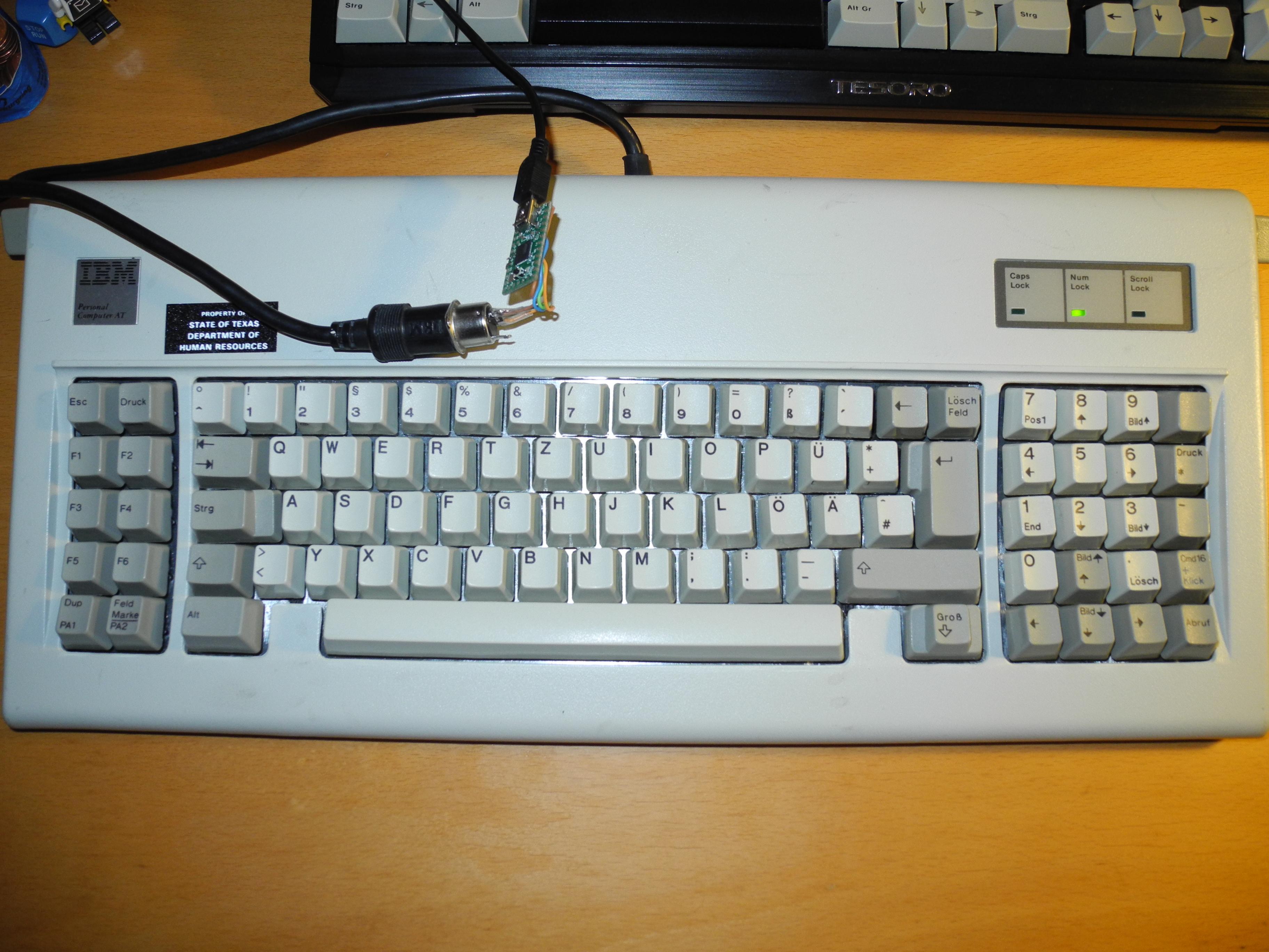

I just build and configured my own Soarer's Converter and it's awesome, thank you, Soarer!
I'm typing this on my freshly converted and remapped Model F AT.
I had a bit of a problem with a USB hub, because somewhere in the progress the Teensy stopped responding, but plugging it directly into the computers USB ports worked. Also the soldering went great, considering I'm not soldering stuff often.
The programming was a bit finicky, because I didn't quite understand how the scaswr.bat works (you have to drop the .txt-file onto the batch and not into the window the batch opens
and also you have to put the names of the keys and not the HID codes into the Remap file), but in the end everything went fine.
Now my converter needs a case, I already prepared a Kinder surprise egg (the yellow thingy), but now I need some hot glue.
Edit: Here is a quick picture of my updated layout and the converter itself, the case still has some scuffs, that need to be removed. PA1 is Fn, PA2 is the Windows key and Lösch Feld is delete, but that is gonna change, I think. The buttons right of the numpad numbers are the mathematical operators (/*-+). Num Lock is on Fn+5.

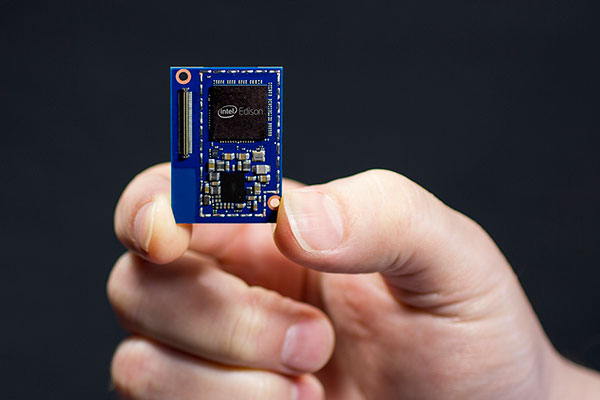

I've been thinking about the possibilities of using the Intel Edison. Imagine having wifi, bluetooth, USB (including host mode) and Linux inside your keyboard.

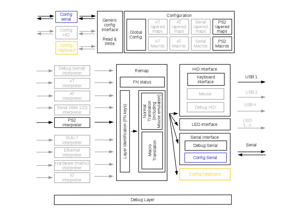

Hello again,
I have drawn a potential architecture (draft 0.1).
Black items are, to me, the first to implement. But the interfaces, data structures etc ... should be defined from the beginning. This would allow people to focus on different modules.
I attach the image here, but I guess that it may be better to create a separated entry in the forum.
If people is willing to support this idea, we should create a repository in a collaborative site. I have not experience doing it, but this fact only adds to my interest in this (potential) project.
Attached you can find the VERY draft 0.1 architecture
Cheers
Cheers
