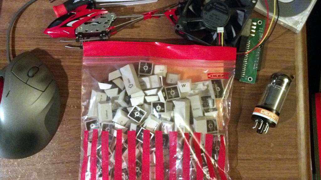

rknize
10 May 2012, 06:32
Got my keys, straight from Ikea! Thanks Ascaii!
