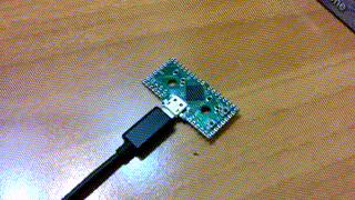

IT WORKS!
ohmy I'm happy like a child in a candy store!
Thank you so much to Hasu and pomk! Now let's get this resistor fixed so we can go production! :D
Like I said the only way I have to access the bootloader is from a windows tablet not connected to the wall power. Every other PC I have fails to connect. But anyway at least we know the board is working!
Now I'll try to make a decent keyboard firmware out of it :)

-[°_°]-
01 Dec 2016, 21:12
Laser wrote: Maybe compatible to Hasu's TMK ;) ?
believe it or not, that blinky thing is already TMK firmware!

cool! but did not understand, did you flash it because that tablet somehow is not interfering too much to let the rom bootloader not go towards SPI or is it because you soldered a 10k resistor somewhere now?
-[°_°]-
02 Dec 2016, 08:31
tentator wrote: cool! but did not understand, did you flash it because that tablet somehow is not interfering too much to let the rom bootloader not go towards SPI or is it because you soldered a 10k resistor somewhere now?
no resistor was used. that tablet I have somehow doesn't interferes with the rom bootloader via USB. Don't ask me why.
