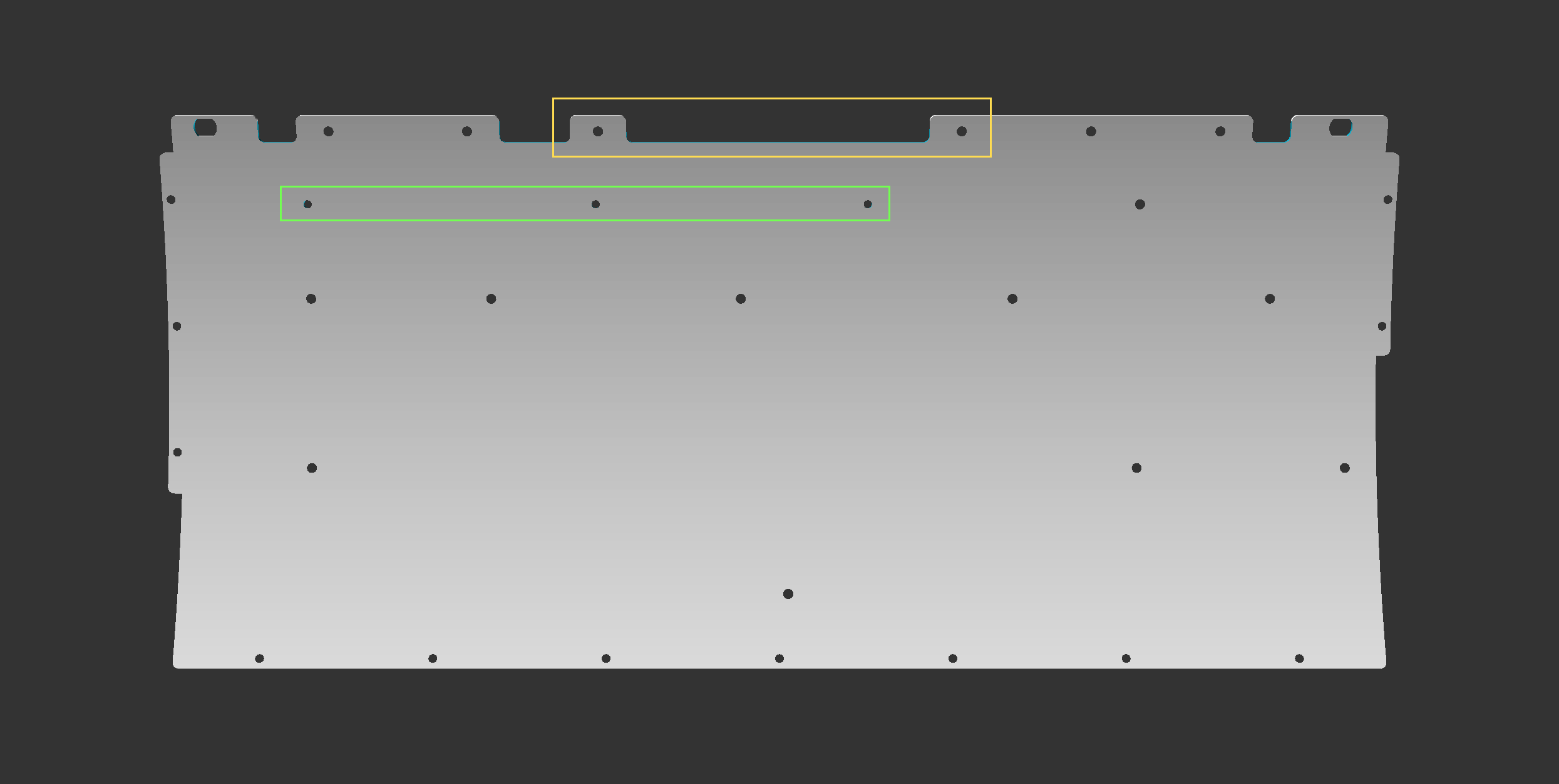

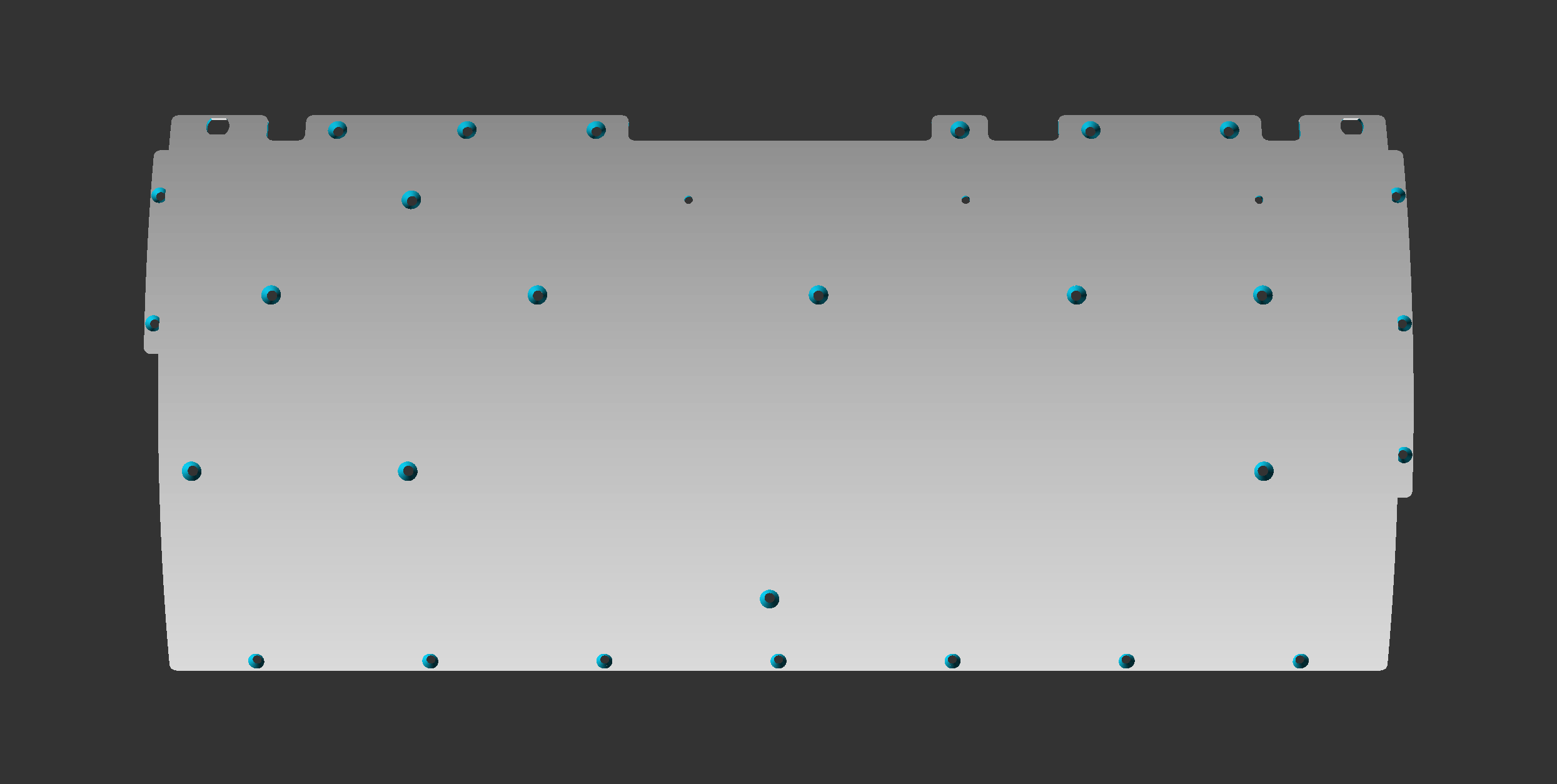

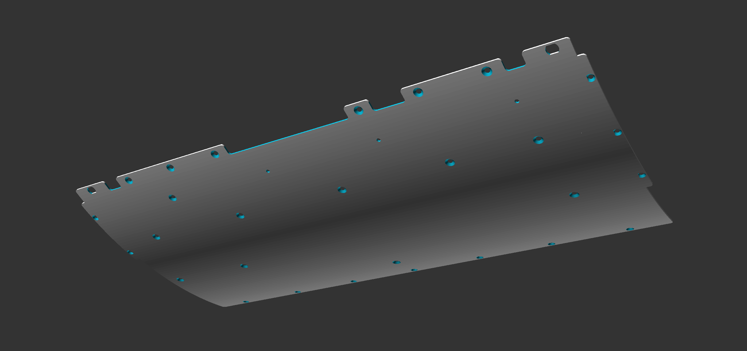

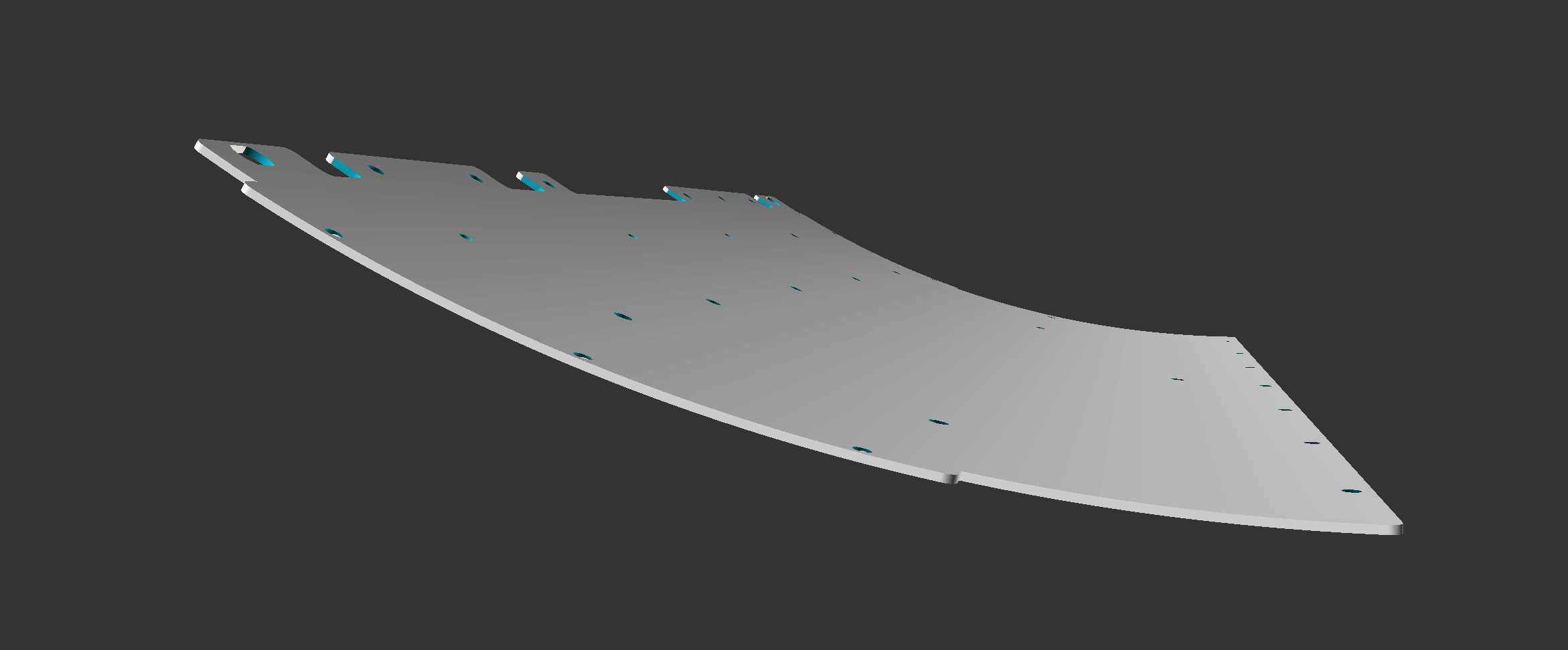

I hate to force one or the other on anyone considering it is so split, but I have all the numbers together and really want to move forward with the last of these orders (outside of the electronics). I have no issues running another small mini-buy and doing alternate fasteners though if we did it early enough. I would actually be interested in torx for myself to be honest. And for something so simple we could utilize Google Forms.
The following are renders of the revised backplate. This incorporates all the changes that WCass and I have put together (with a few additional changes I am going to ask him to make on our behalf). All the holes are countersunk from the bottom, with the exception of 3. The three will hold and ground the PCB from the inside using the standoffs we mentioned previously. If additional grounding of the controller is needed, you can just the single screw on the top row with a pan head screw and a washer (or as many of those screws as you like really). All screws at the top and in the middle of the plate are m3. The screws on either side and on the bottom edge will be m2.5 because of the constraints we mentioned. This should be the final version of the backplate that you should expect to receive.
EDIT: also, all screw holes are now tapped (before we had two on the top edge that required nuts).
Backplate from the top
Backplate ground locations (3 in the green box to the PCB, 2 in orange as optional for the controller)
Backplate from the bottom with countersinks
Backplate from the bottom angled
Backplate from the side

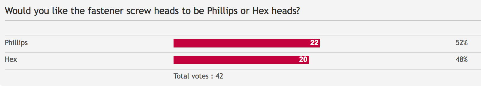

Screen Shot 2017-01-02 at 4.28.34 PM.png (48.53 KiB) Viewed 7426 times
Because the responses were much more even than I anticipated, I made the following form for those to sign up if they wanted torx (hex as a cost prohibitive backup) instead of Phillips driver head.
https://goo.gl/forms/OngAq2Uf3UM2ATfG3
Do it quickly if you are interested. I'm on my phone now so the form isn't the best, but should serve its purpose. This is an all or nothing election to have the alternate fasteners (so if you had more than one kit, this election would apply to all of those kits). Keep in mind there is no bad choice here, and no one that doesn't WANT torx/hex should feel the need to switch.
I'll send out a PM with the form link as well. Let's have these done by Wednesday if interested

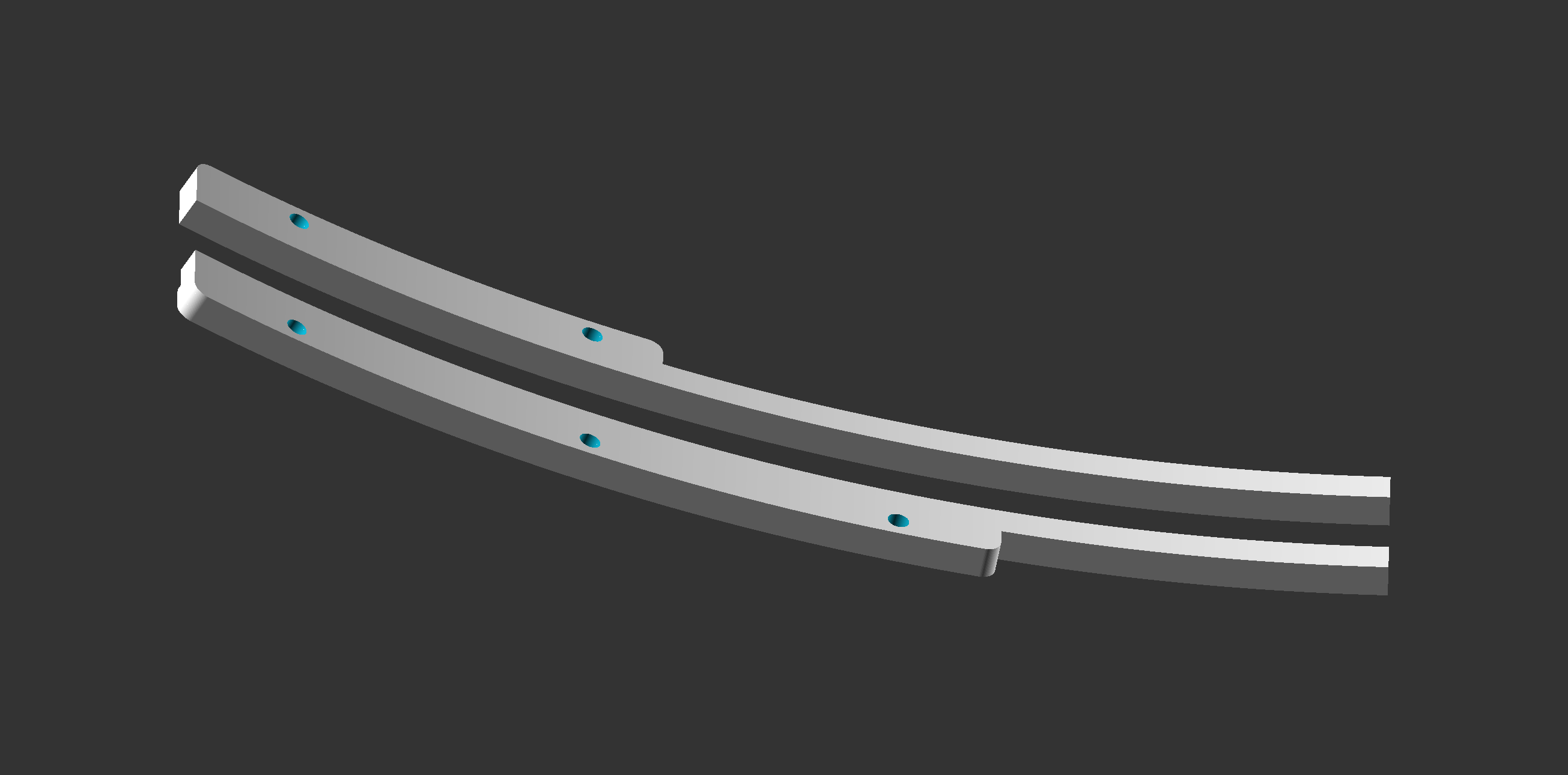

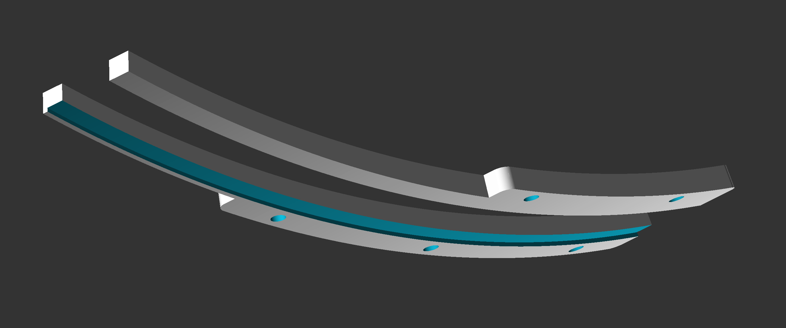

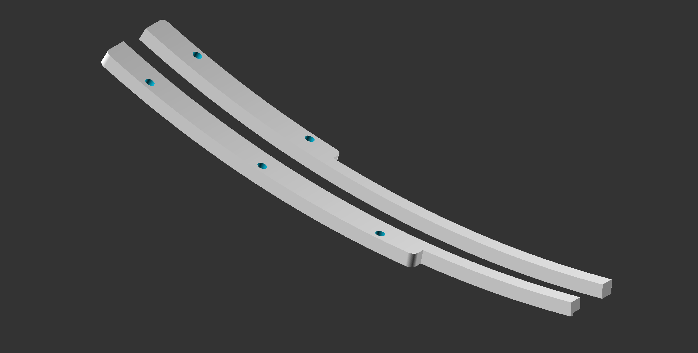

When I return from my work trip, I will begin printing the side spacers. They are modified now to act as a debris shield that is inset inside the entire length of the assembly plates. I would consider putting some message/artwork/logo/pattern into the visible side portion, if anyone had thoughts. Everything is being cleaned up and productized quite a bit with all final designs, and this would be an opportunity as well if we felt that it added to the end result in a positive way. The following are the final version of the spacers/debris shields. The left side will be notched on the bottom to let the PCB have clearance.
Side view
Side view
Bottom view (with notch on left spacer for PCB)
Top view at an angle

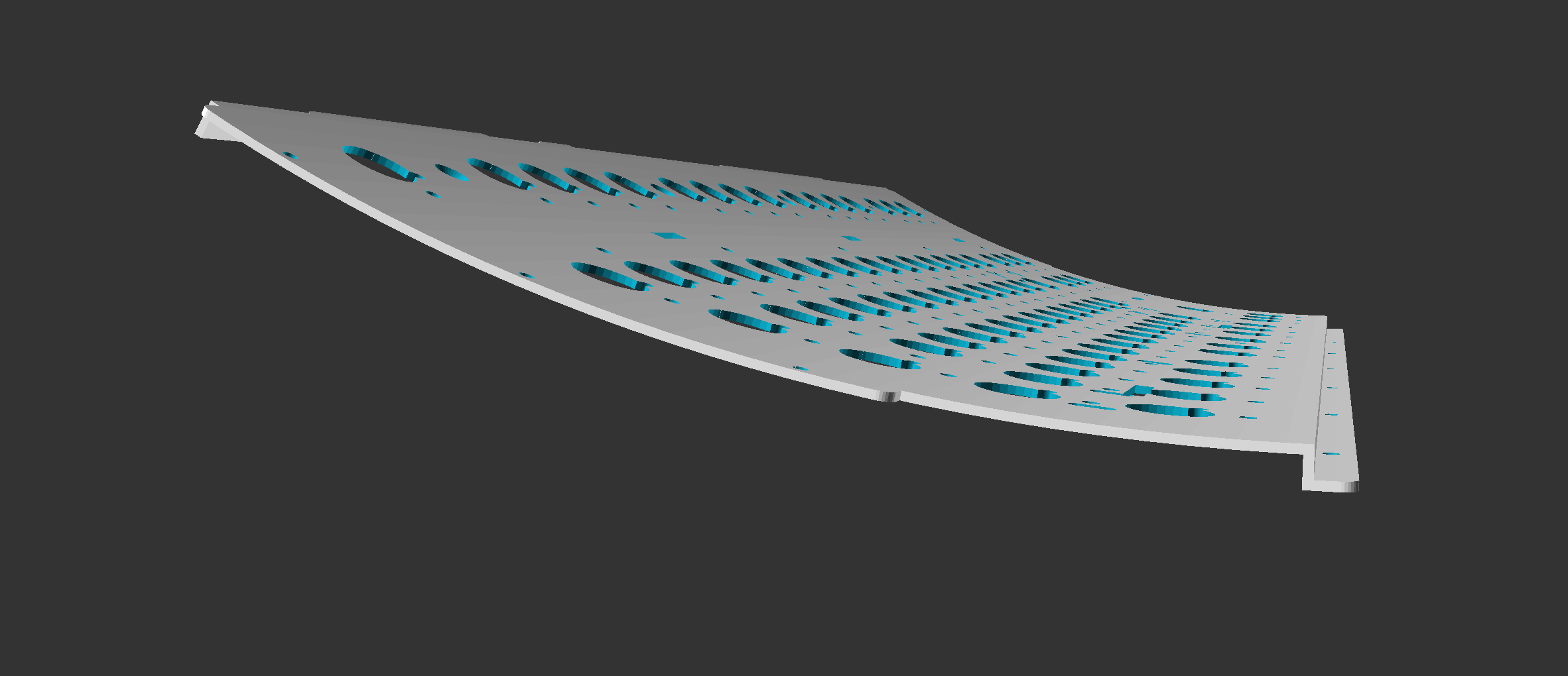

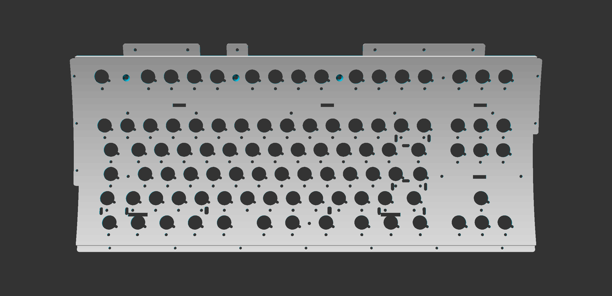

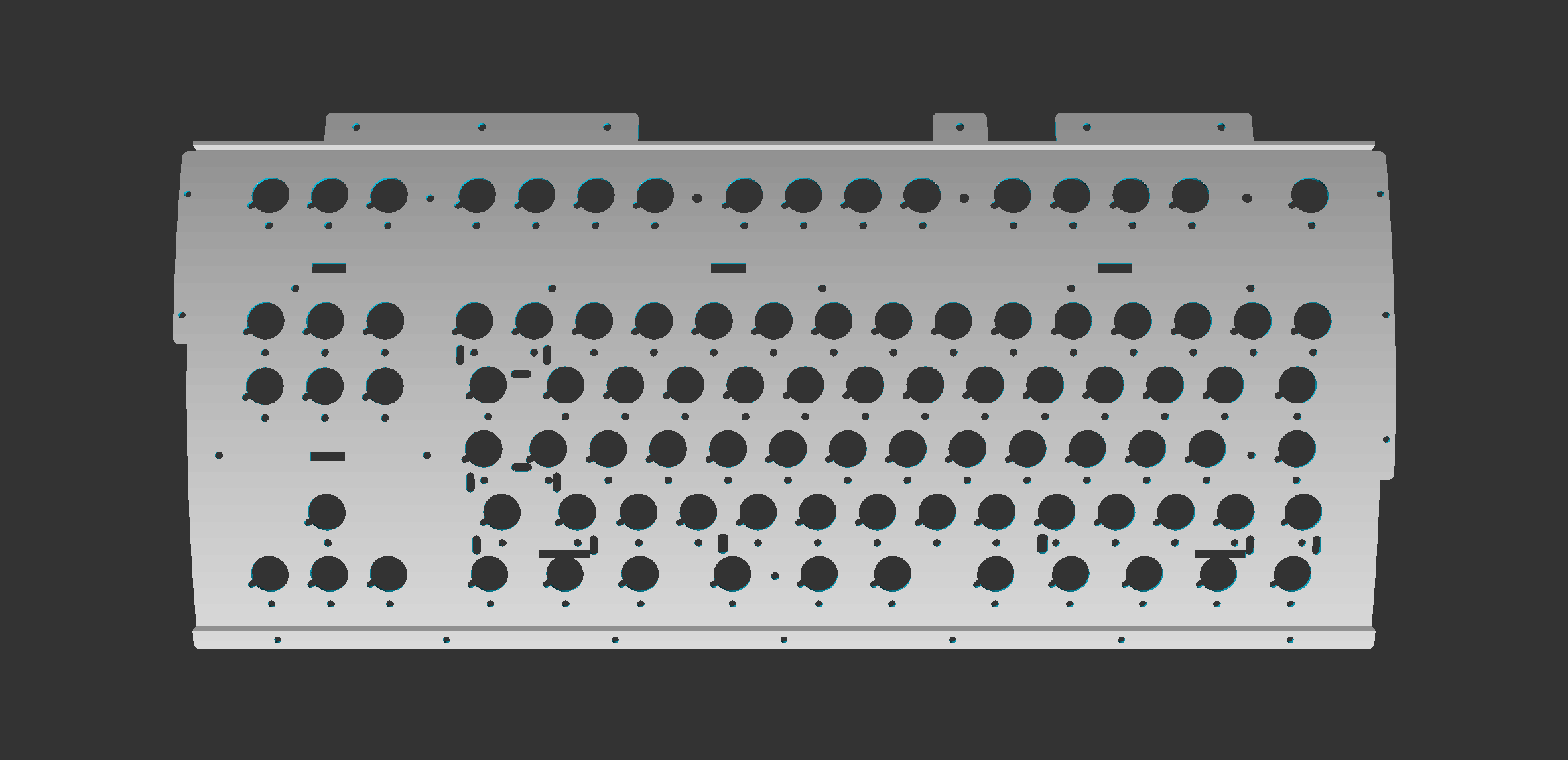

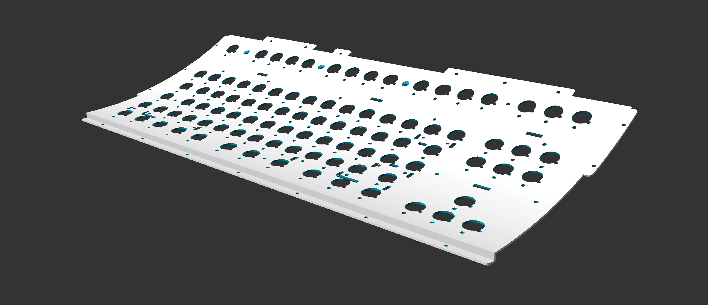

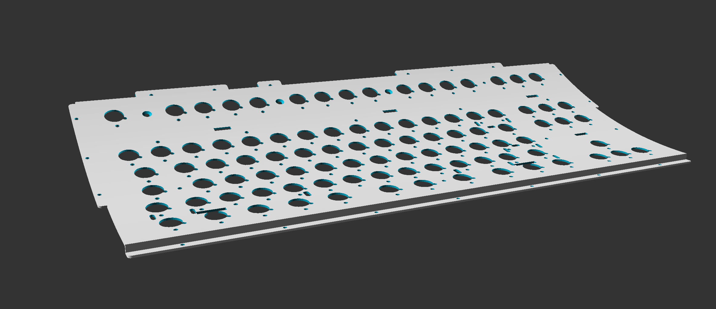

The following are the renders of the SSK top plate with updated layouts for our top ridge and spacers. It dawned on me after searching that I never published the renders for the top plate(s) after adding the wire stabilizers for spacebar and all of the legacy F keys
SSK top plate from above
SSK top plate from below
SSK top plate angled
SSK top plate angled from the other side
SSK top plate from the side
