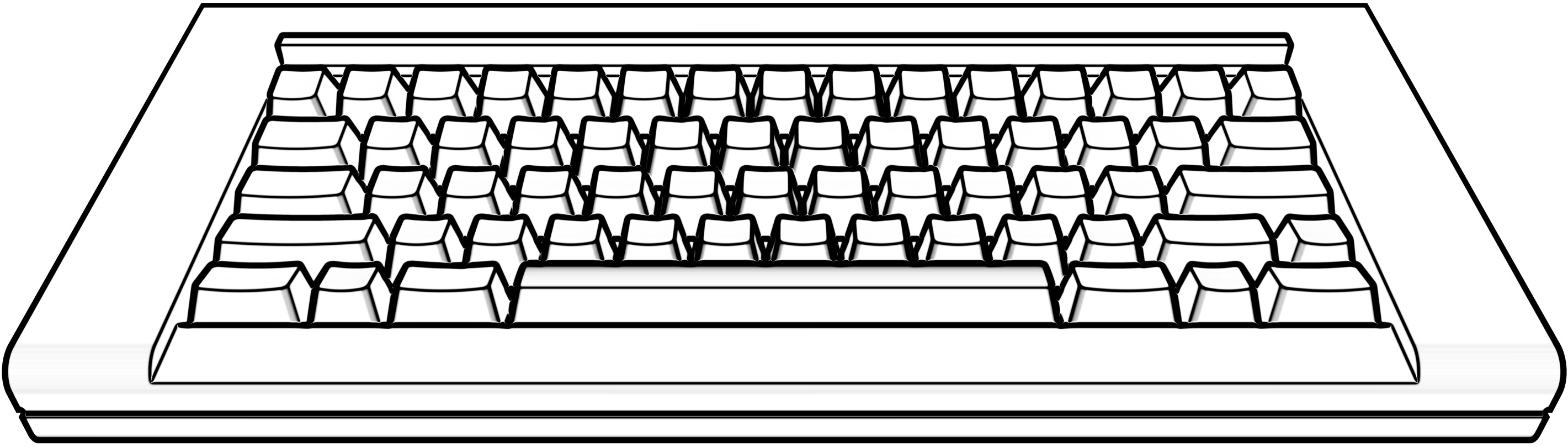

Zcool31 wrote: 21 Aug 2020, 22:53 Now in 60% size:
Also I can finally control the line thickness in proportion to resolution, so scaling pictures up won't result in thin-looking lines.
Next step - orthographic projection.
Some places where my guesses are particularly bad are the radius of the back plate, and the angle of the key cap. That is, suppose I somehow flattened the back plate and barrel plate. What would be the angle between the top of the keycap and the table upon which my now flat barrel plate lays?
These are great! Do you have any with the split backspace as well?

OxC0FFEE wrote: 24 Aug 2020, 18:02 These are great! Do you have any with the split backspace as well?

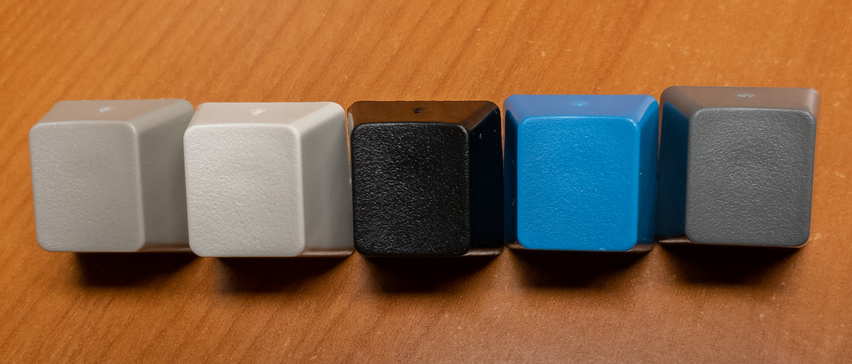

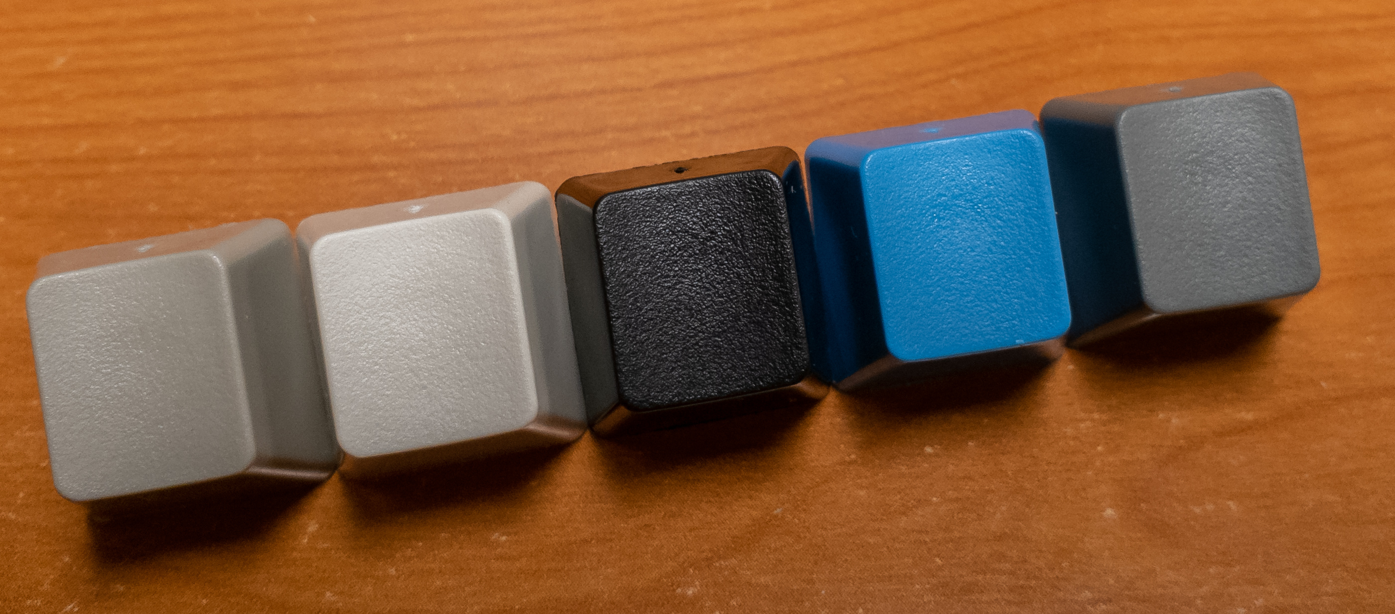

Ellipse
25 Aug 2020, 19:15
As requested here are photos of the production key colors, all in one photo.
Key colors (from left to right:  Pebble, Pearl, Black, Industrial SSK Blue, 60% Dark Gray):
key colors.jpg (1.4 MiB) Viewed 10168 times
key colors (2).jpg (1.55 MiB) Viewed 10168 times
Zcool31
25 Aug 2020, 20:47
Cross post: My renders of the compact case are here: viewtopic.php?p=470489#p470489

And in regards the last few updates here, they have been applied to the Technical Manual Draft here: http://www.linux-tin.org/ModelFManual.pdf
I have added the keycap colors but need to take photos from the same angle on white background. Nothing too fancy, as I want to print it in the original IBM style.
The keyboard drawings from ZCool31 have been added with a 300dpi diffusion dithering like in the original IBM manuals (where appropriate). The keypads have been replaced with a much better looking version that Zcool31 provided. More updates over the next days / weeks.
