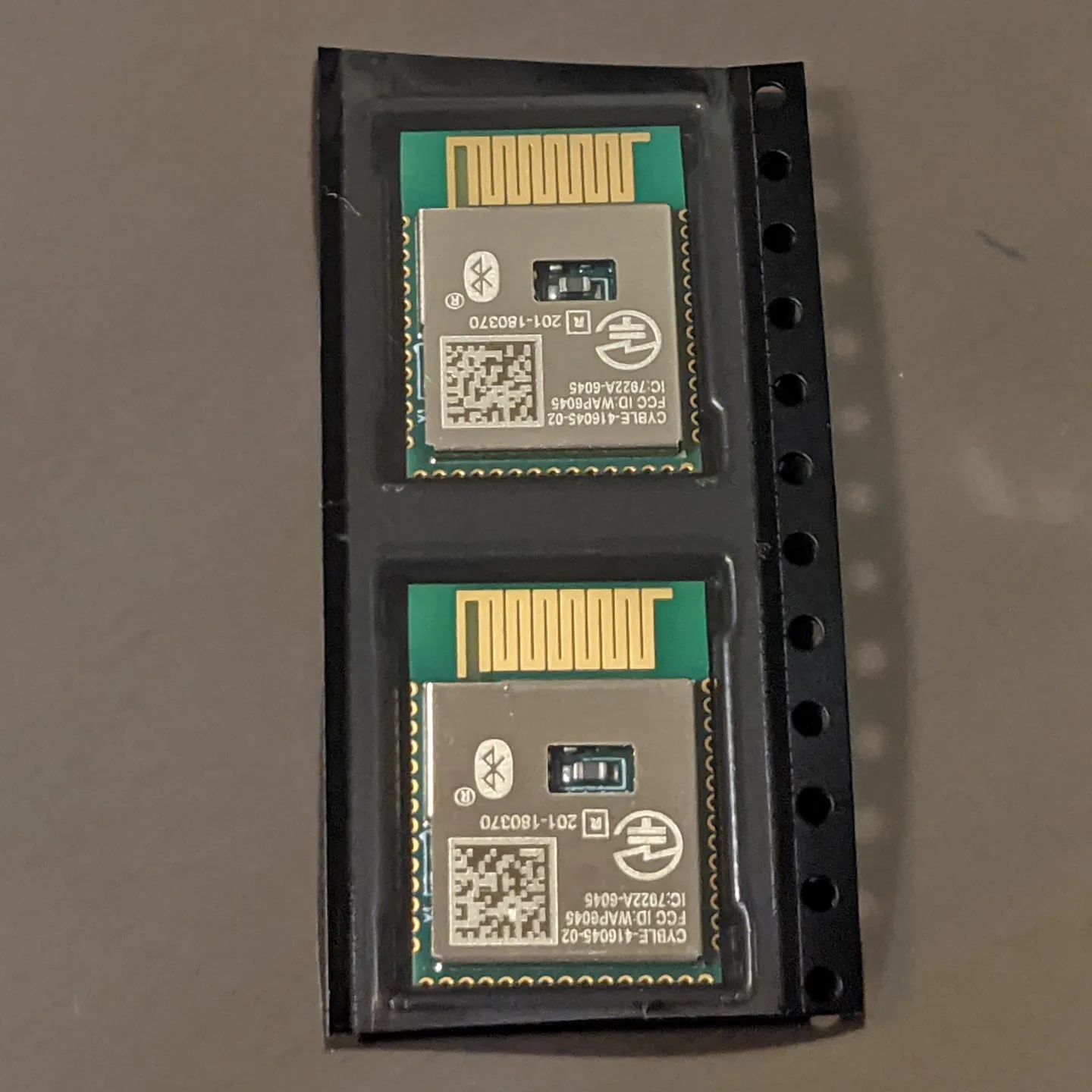

We finally have PSoC 6 part which has BT _and_ USB (in fact whole four of them) - but they are only available in glorious PG-VFBGA-124 (that's BGA-124, 9x9x1mm) and SG-WFWLB-104 (that one is even worse - "Silicon Green, Very, Very thin profile, Fine pitch, Wafer Level Ball grid array" - 3.8x5x0.65mm) - which are a bitch to solder, and Tmax of 260 degrees doesn't help.
However, I now have a reflow oven, so it's not much of a problem.

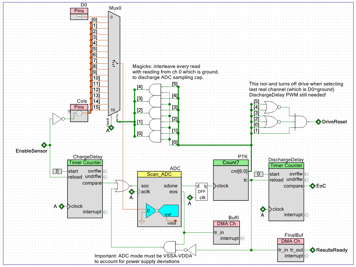

These two are USB-less, but are a good testbed of "if PSoC 6 ADC is good enough" and "Is 12 UDBs enough to drive everything without involving the CPU".

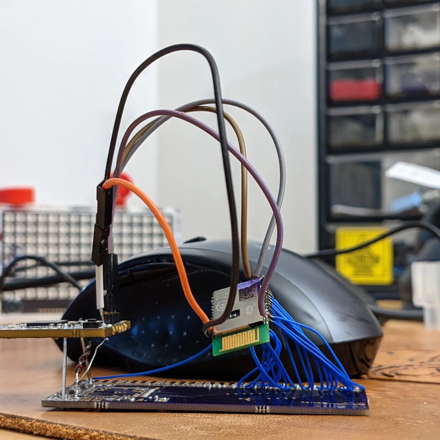

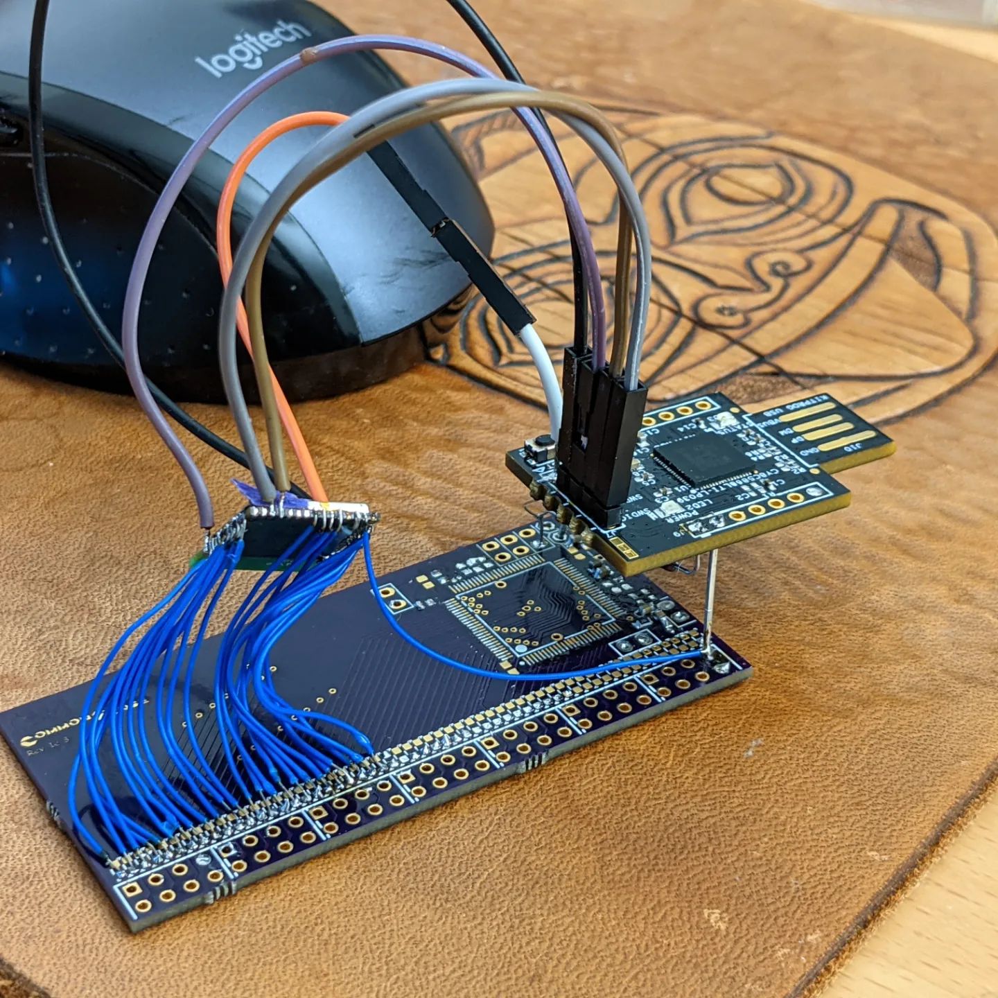

I did it! It involved some magicks, and I won't be able to produce anything decent out of those 4 modules mouser accidentally sent me instead of 2 because they don't have USB and I'm a bit too lazy to rewrite whole control interface to use bluetooth - BUT the scanner works!
It looks like this:
And externally, it's pretty nasty lol
fun fact - it reuses my first CS prototype board - in fact, the first PCB I ever ordered - as a carrier board:
Definitely not prod-ready, but "it's not just good - it's good enough!"
From this point, I can produce a BLE+USB (not "BLE but charged via USB", the real thing: USB-configurable, USB and BLE outputs, switched from keyboard by a key combination, battery- or bus-powered) capsense controller.
