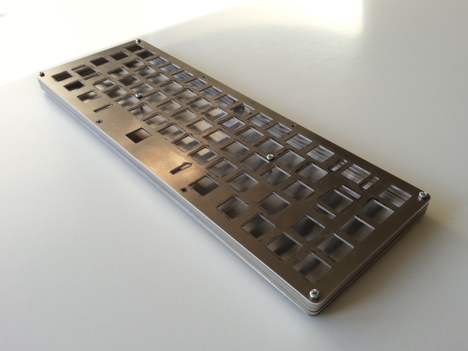

I took some pictures a long time ago, but haven't really uploaded them (for whatever reason)
I tested it with all the screws and they do seem to fit, even the two middle screws that supports the plate fits, I just think matt3o turned the bottom plate the wrong way since he said they didn't ;)
bad picture is bad
bad picture is bad
All the modifiers fit perfectly!
I have made the middle layers that got a bit skewed align correctly with bottom and top layer, so now I just need to file stab holes before I can continue (and figure out if I want black or brown switches).
Filing the stab holes turned out to be a bigger problem, no matter how much I file the stabilizers seems to get stuck or not fit that great (when tested with keycaps on) and some of the holes has got quite a bit filed away already :/ but I am sure i'll make it work!

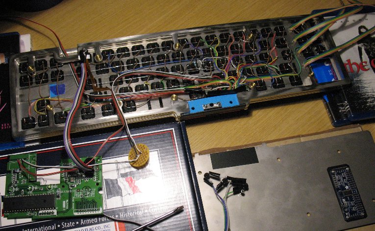

Finally I am done wiring the matrix and connecting it to the Teensy. This took such a huge effort that I think it is probably worth the time and money to design a PCB and have it produced. :!:
More pictures are in the photo album starting here. :)
Next I want to verify all the connections, then connect the various extra components. Also I have to pick up some resistors for the LEDs after I do the math.
12 Oct 2013, 20:18
Nice job. You had more to do than the rest of us, so I understand your relief to have finally made it, Mtl. Perhaps Matt's "handmade PCBs" are down your street. If I do another of these boards (and I think I will), it'll be a TKL or thereabouts and probably a good candidate for that too.
The Teensy++ is a pain to fit under the space bar, I bet. Its Mini-USB port looks damn close next to that switch. I made my own mini cable recently for my multi-socket Soarer's converter box, it uses a bare bones jack that might fit there. A regular cable's going to be tight.

Muirium wrote:Nice job. You had more to do than the rest of us, so I understand your relief to have finally made it, Mtl. Perhaps Matt's "handmade PCBs" are down your street. If I do another of these boards (and I think I will), it'll be a TKL or thereabouts and probably a good candidate for that too.
Thanks. It is a huge relief. :) I also am looking forward to Matt's PCB. Another nice thing about having a PCB is it would help keep the switches in place. I've found that stickers can interfere with the switches latching onto the plate (especially if you remove the switch once and try putting it back in).
The Teensy++ is a tight fit, though I am more worried about the wires sticking up out of it fitting vertically within the case -- another problem having a PCB would work wonders for. ;-) I'll be using one of these (without the shell) to plug into the Teensy. The wire and plug will have to rest on top of the space bar switch. I think it will fit, but haven't really checked yet. If all else fails, I will have to wire directly to the Teensy, which may require removing the USB connector.

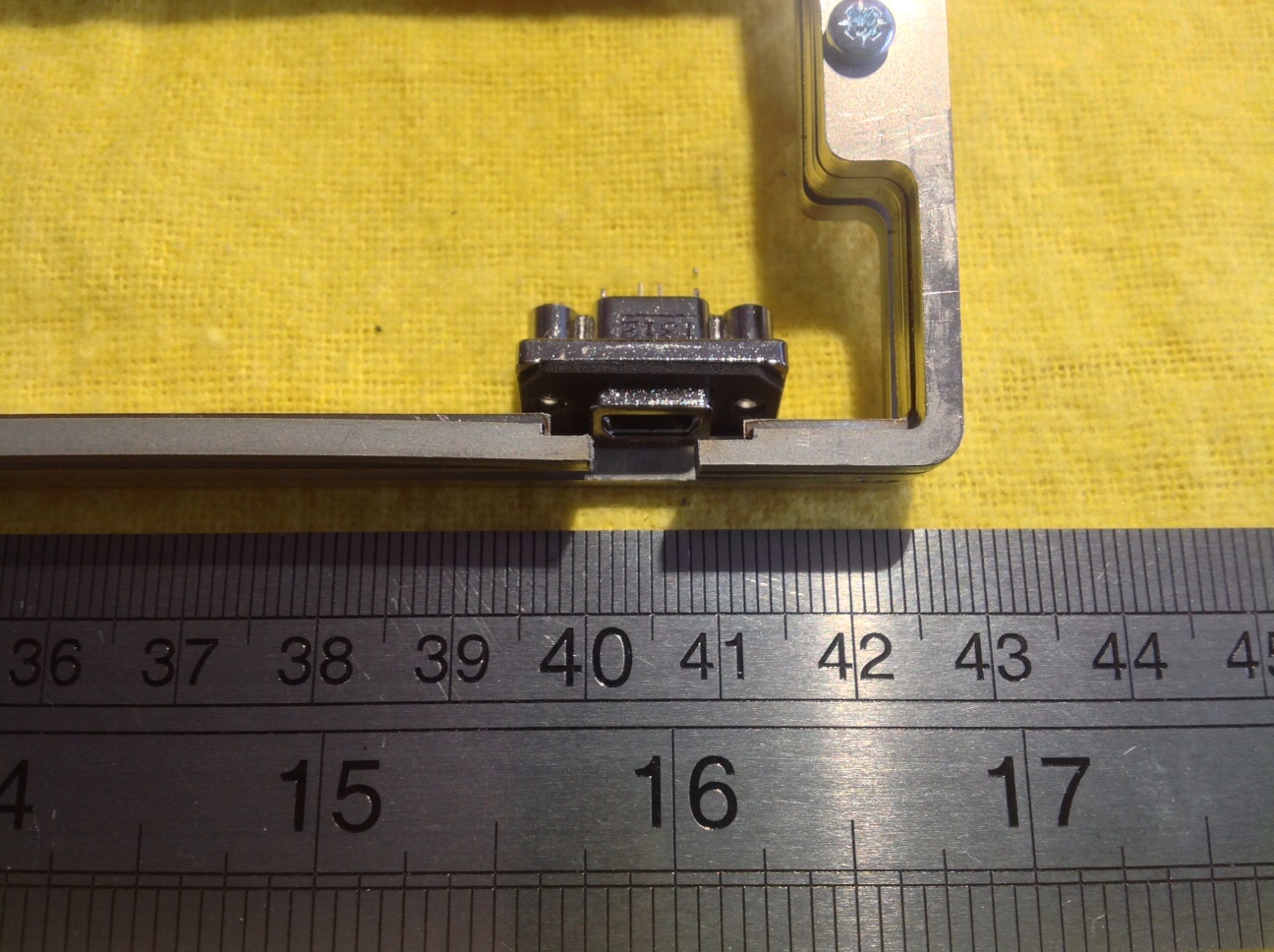

Meanwhile, back in the workshop. Here's the filing I have to do for the shiny socket:
The outer hole is only part of the story. Here's the geometry with an adjacent non-socket layer added for orientation underneath the stack:
Now, where'd I put my clamps? And is it best to file them while bolted together?
-[°_°]-
13 Oct 2013, 17:37
Muirium wrote:Every American barista's nightmare: an Italian customer!
I finally had a starbucks, very disappointing.
Muirium wrote:Now, where'd I put my clamps? And is it best to file them while bolted together?
the inner part is actually easier, you don't need to file the case... but the socket itself (which is made of very soft metal).

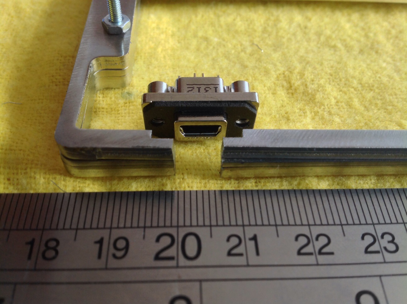

Oh, I see. I imagine that's also true vertically as the whole socket housing is easily thicker than all my slotted layers combined. In fact, I'm filing all three slotted layers you sent me together (including the one marked "don't use") as they give me a firmer filing target anyway. To use just two of them, I'd need to file the socket's outward facing part down a little too.
I'm thinking of maybe filing a little into one of the other case layers instead, but the answers are all in the margins and I'll only know what I've got when I've got it. Still a lot of elbow grease ahead!
Next case: I'll make the holes the exact dimensions of the socket. It's a smart wee thing.

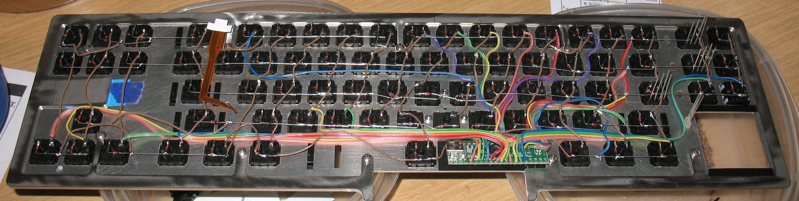

It's been a while since I have posted any updates. Over the last couple weeks I've been working sporadically on getting the keyboard to actually work. The good news is both the keyboard and TrackPoint are now working! Though, the TP is working just barely. :)
Here's the keyboard as it stands. It is a mess! I have tried closing the keyboard only partially and it is very hard to fit all the wires inside while not causing obstructions.
It took a while to get the matrix fully debugged. There were problems with both the wiring and firmware. I should have re-read matt3o's instructions earlier because initially I had started by modifying the TMK firmware's Phantom source code, instead of the GH60. Due to the direction the diodes are facing (I think), the matrix has to be scanned the GH60 way.
Just getting to the point where I could debug the matrix using hid_listen took a fair amount of effort for me. Also, I had no luck using D6 for column I/O. The Teensy wires a LED to this line, and I believe that is the source of the problem.
The TrackPoint has required a lot of effort so far. The TMK firmware claims to have TrackPoint support, but I believe it is incomplete. There were wiring bugs for me to figure out, too, that caused the TP to fail its POST. Now it works (yay!) but the motion is very choppy. Not sure if it's due to a bug, all the debug code I have enabled, or just a sub-optimal polling implementation.
The code I'm working with is up on github, in case it is useful to anyone. Most of the files are under keyboard/ssmx/. I am trying to keep it self-contained but have had to modify some of the common firmware files.
The keyboard is still a long way from done, but when I can get enough of it working to verify there are no wiring bugs, I can close it up and start using it! :D

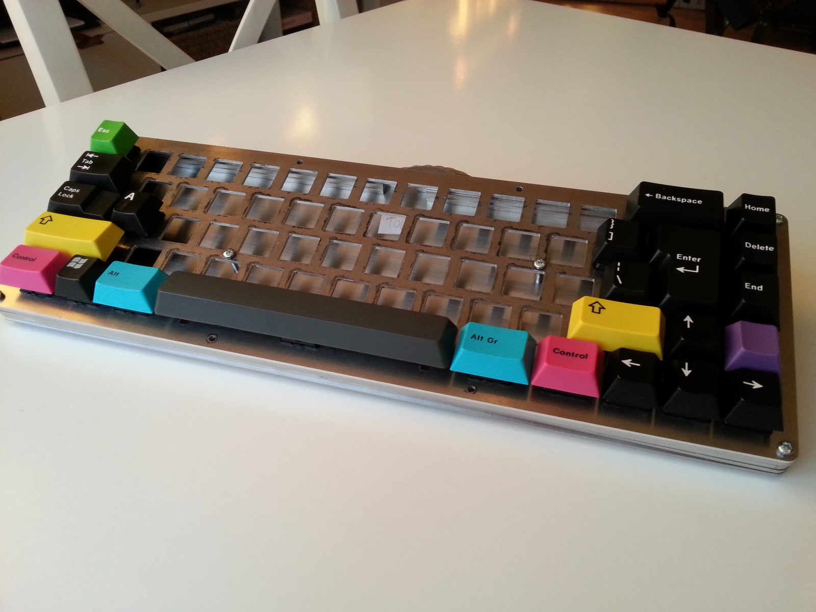

Gentlemen, it is complete! Typing on my Shiny assed Fox right now. Classy! It's just as tight and heavy as I always wanted. Thoroughly chuffed with this creation. Big thanks to Matteo and all of you guys in the GB for making this little beast real!
After a lot of luck with Soarer's Converter on my IBMs, his newly released controller inspired me to hook up a Teensy and put it all together at last. Finally a keyboard controller I can understand, with all my layers and macros intact. The "code" I wrote looks like this:

A few things remain to be done, hardware wise. First is my mini USB port. I've just installed the Teensy with a USB cable straight into it for now, running out through the gap. More steel filing awaits me there! Also, I'm waiting on stabs so the three stabilised keys on my layout are wobbly if hit off centre. Oh, and the semicolon key showed up earlier but not now so there's a solder joint to go back and check. Good reason I don't code!
Pictures when I've the port in place. And best of luck to the rest of you as your builds reach completion too.
