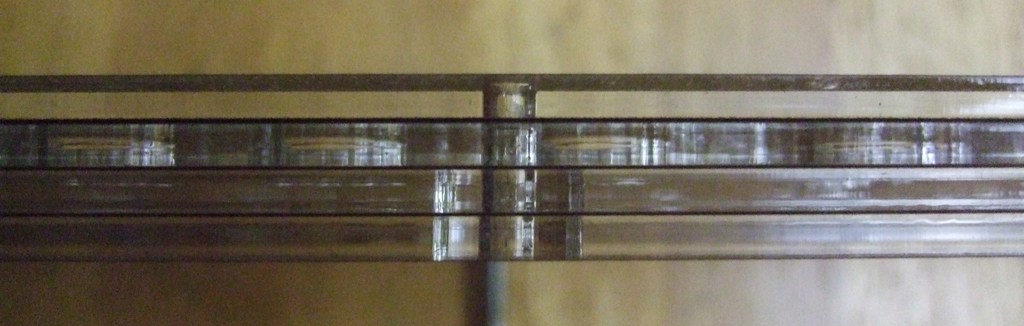

To illustrate what i am going for, consider this side view of the front edge of the keyboard. Grey lines are clear acrylic, blue lines represent a thin reflective covering. A red LED on the PCB shines up in a 120 arch. The top and front edge of the case (top and left side in this view) reflect the light so that the only place light can escape is under the key caps.

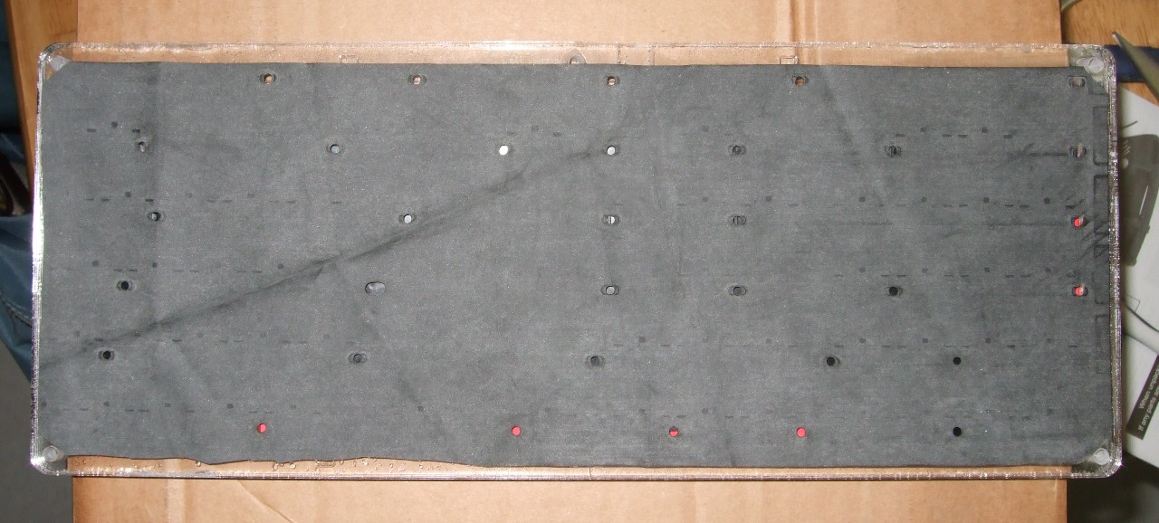

I think it will have an nice glow under everything. Here's what ended up with, by accident (apologies in advance for the terrible quality).
So that's an SMD RGB led mounted to the surface of the PCB, just below the acrylic. I do have a hole drilled through the acrylic just where the LED is, which I think helps the light enter the edge of the acrylic and spread it around. That wasn't my intention, I just wanted somewhere for the light to shine through in case I didn't go with clear acrylic. I get light all around the edges of the acrylic. I imagine the effect would be intensified if I had a white PCB instead.

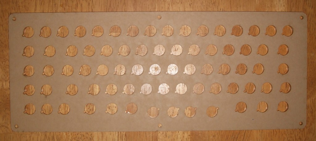

scottc wrote: I'm sorry if this is a stupid question but I can't figure it out. Will this take Model F barrels, or should we cut up Model M barrel plates for it?
It needs model F barrels. The acrylic is specifically cut for the "notch" (AT and 122) type - but I want to try out using the easier to get "pin" (XT and Bigfoot) type (but cut off the pin). Why? Remember the OP - I want to give discarded ideas a try. I want to see if the barrels will keep alignment from just the tight grid they are packed into. If it is not satisfactory, I have an AT that i can use. You can see that i had to trim 4 of the barrels so that they will fit properly when flipped 180° for the space bars.
The LEDs are the biggest unknown. The ones i chose are fairly bright, 1690mdc @ 20mA with 125° viewing angle. I have 6 spots that i might put the LEDs, but it is very unlikely that i will use them all. I will most likely only use just two.

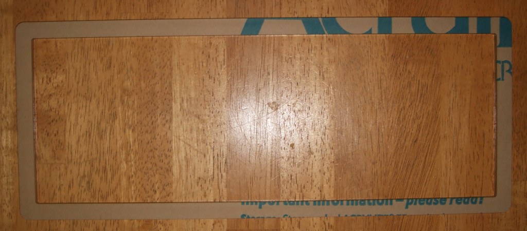

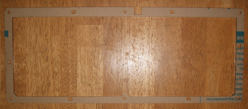

There was a slight change in plan for the case. In an earlier thread, i said that there would be 4 layers - two 3mm and two 6mm - with one of the 6mm layers needing to be etched. It turns out that doing everything in 3mm is much easier and therefore cheaper. There are now 6 layers. I'm going to leave the paper on until i am ready to weld them together.
Bottom Layer - this goes under the PCB
2nd Layer - this goes on top of the top membrane and has cut-outs for USB and LEDs
3rd Layer - solvent welded to layer 2, this just adds another 3mm for the barrels and foam
4th Layer - solvent welded to layer 3, this holds the barrels
5th layer - solvent welded to layer 4, this is trim and the last layer with screw holes
After welding layers 2-5, the holes will be enlarged with a #21 drill bit and tapped for #10-32 polycarbonate screw.
Side view of the case layers 2-5.
6th layer - solvent welded to layer 5, this is finish trim

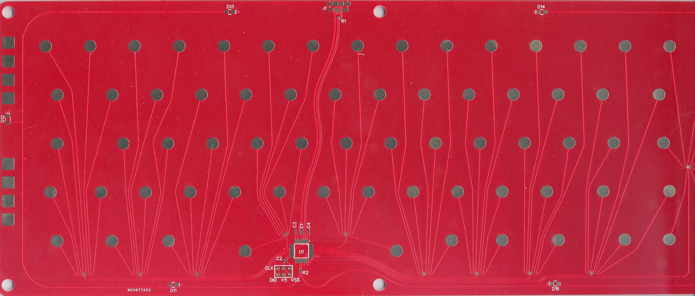

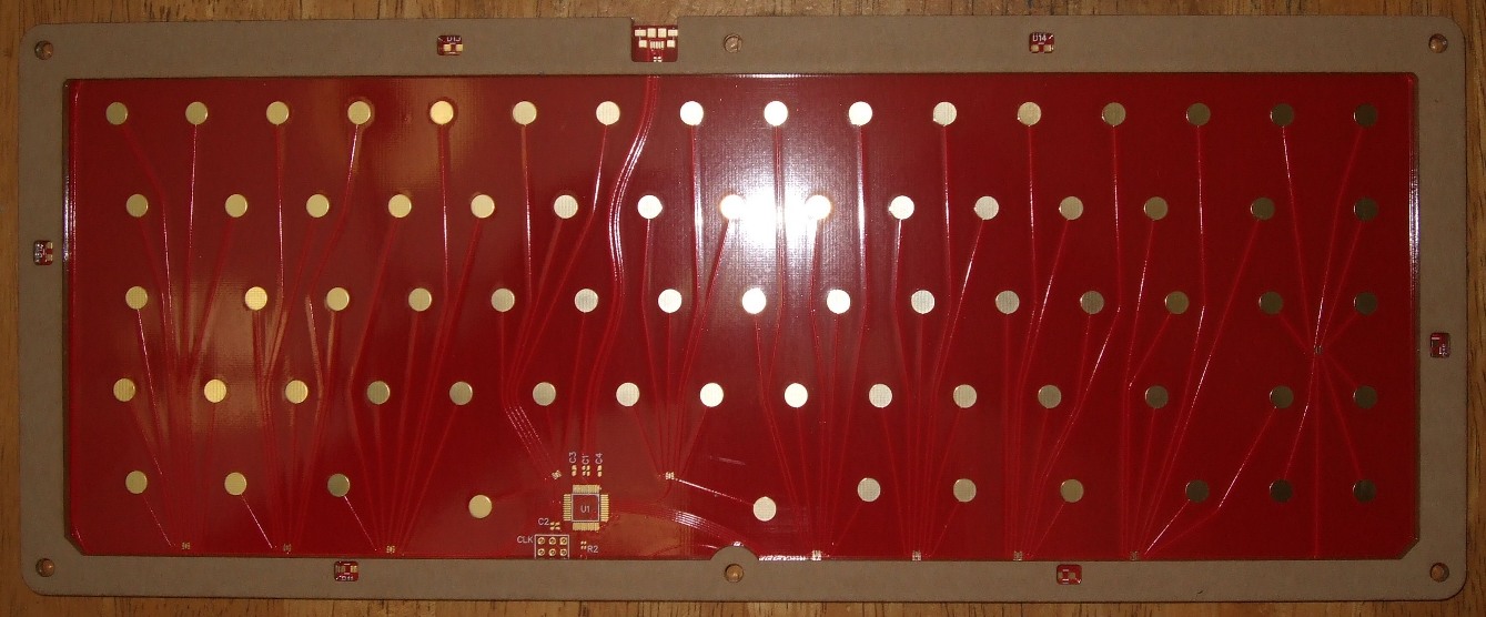

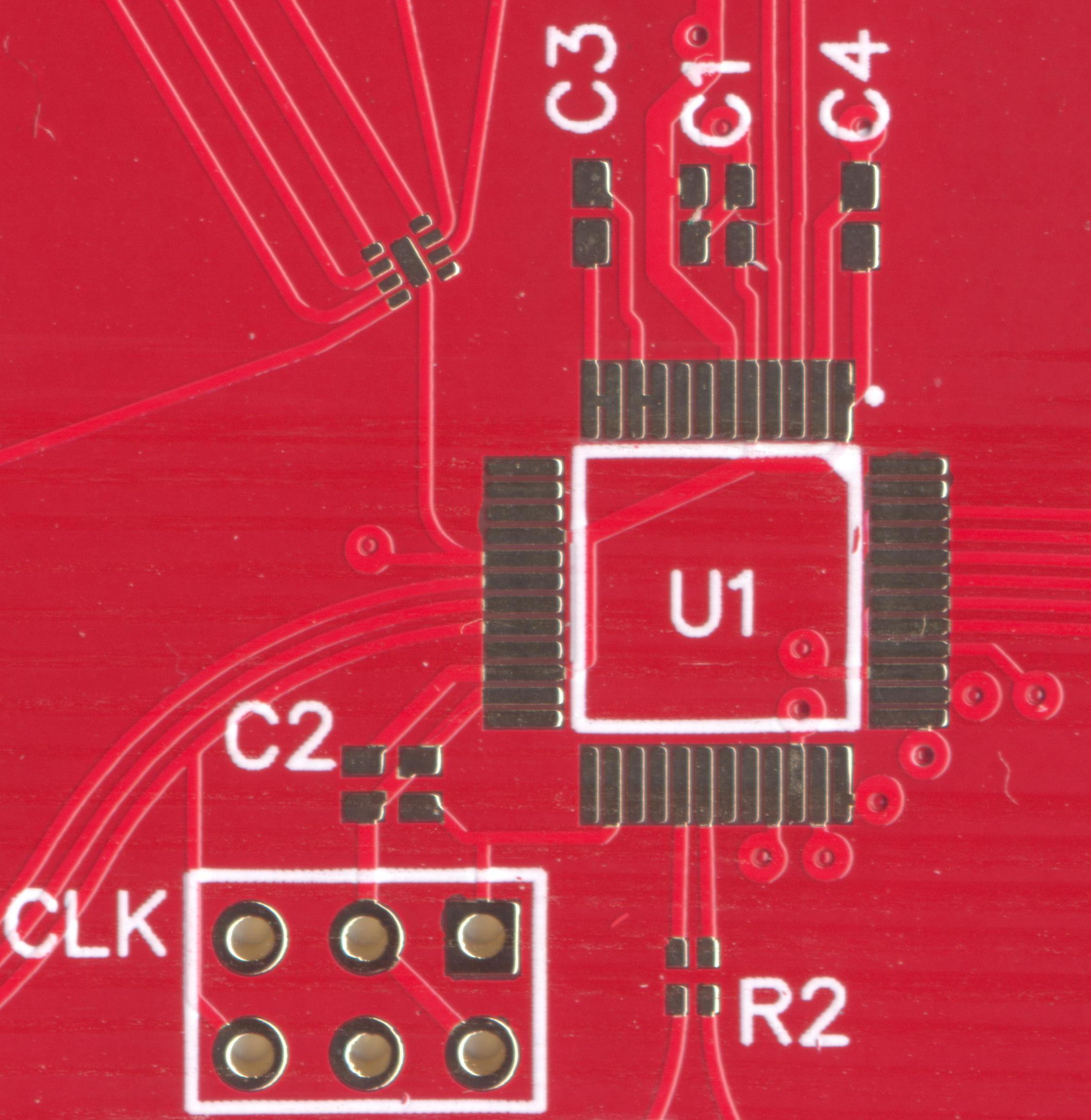

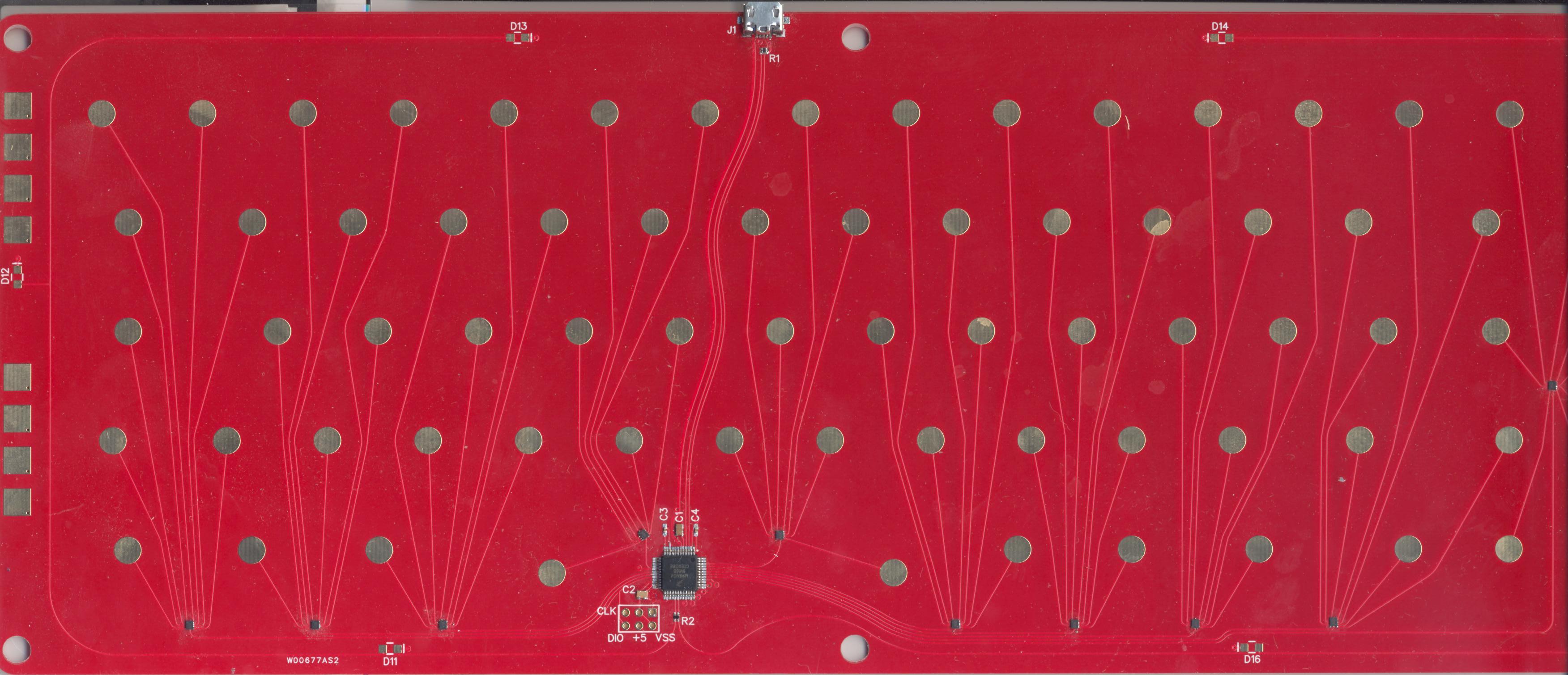

The PCBs came in from PCBWay. Here are a few pictures.
Sorry but it looks like i didn't clean the bed before scanning.
PCB 001.jpg (275.31 KiB) Viewed 16618 times
PCB 002.jpg (414.75 KiB) Viewed 16618 times
Bad news on the actual membrane part of the project. The prototype service is down for maintenance. I hope they are not down for too long.
regack
18 Apr 2015, 03:40
Exciting stuff :D. I take it D11-16 are the LEDs around the perimeter?
wcass
18 Apr 2015, 04:23
regack wrote: I take it D11-16 are the LEDs around the perimeter?
Yep.

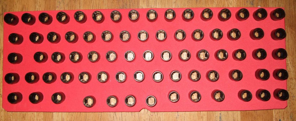

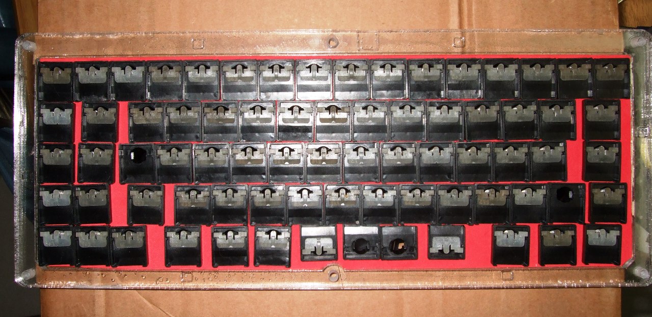

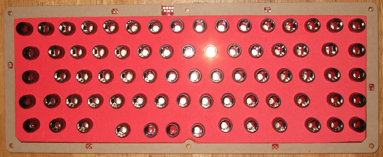

Here's a shot with the first layer of acrylic on top. As you can see, the LEDs will be inside the acrylic.
And here with the barrels and pad.
0100010
18 Apr 2015, 05:29
Will those barrels work inverted like that?
wcass
18 Apr 2015, 06:01
0100010 wrote: Will those barrels work inverted like that?
I think they will, but don't know for sure. That's the point of this keyboard - to try out some pretty radical ideas. This keyboard will test a lot of them and i don't expect that all will survive public scrutiny at the end.
The inverted barrels idea is an attempt to make the space bars more comfortable on the thumbs. To do that, i will flip the caps 180° - so that the tops are angled forward instead of back. To flip the caps, i have to flip the barrel. But the barrel is not directly underneath the cap - it is slightly ... below?under?forward? ... off center - which is why the barrels had to be cut when flipped.

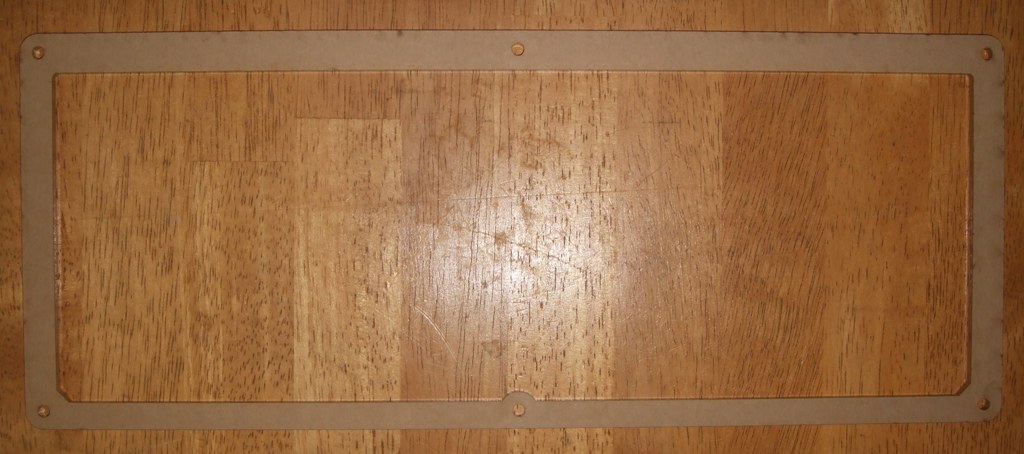

OK, first a disclaimer. I suck at soldering. It is not anything that will improve with practice - trust me on this or read about it here.
That said, i just did this:
PCB 005.jpg (457.25 KiB) Viewed 16541 times
No LEDs yet. I will probably populate the two spots at the top and see how that looks.

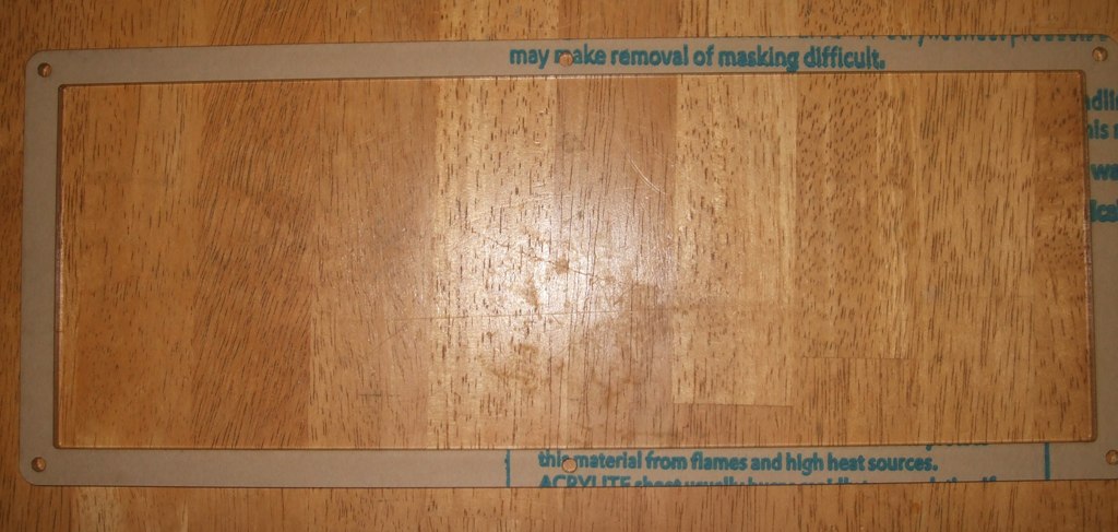

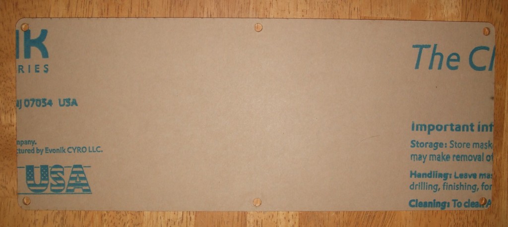

Layers 2 through 5 of the case have been solvent welded together and are ready to be tapped. Test fit on top of the PCB is good.

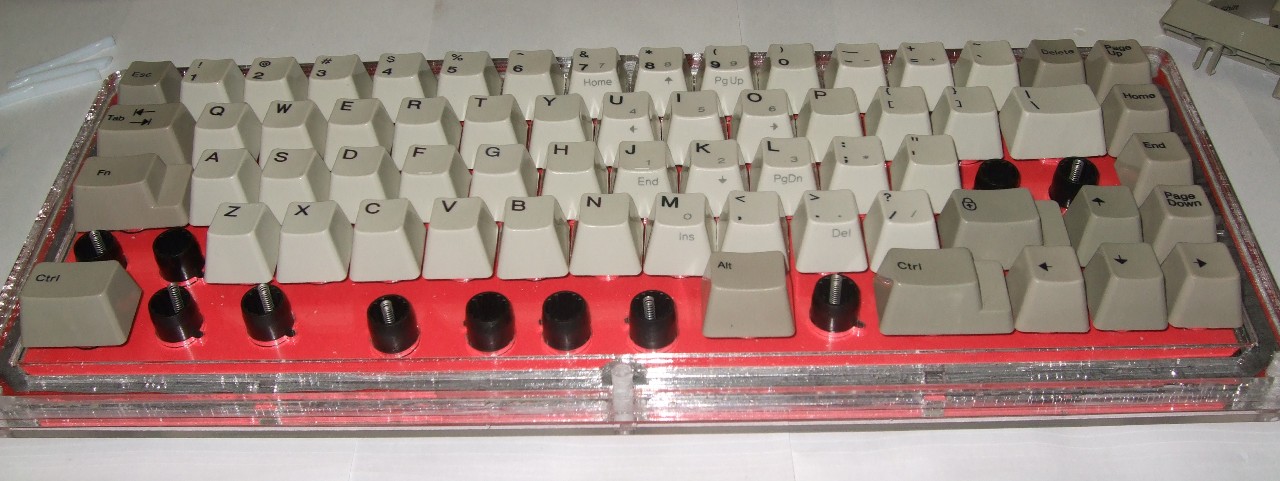

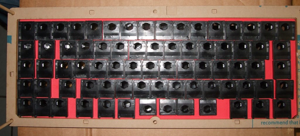

I tapped the holes in the case and test assembled the keyboard. I use a box to assemble my buckling spring keyboards. The box has a rectangular cut-out close to the outline of the barrels so that the barrels and springs hang into the box. Remember to leave empty spots for the stabilizer inserts.
test assembly barrels and springs.JPG (231.9 KiB) Viewed 16467 times
The rubber mat here is cut down from an old 122 (same one that supplied the pivot and springs). I will not be using this for the final - for that i will be using Theraband Red which is 8 mil thick (same as what IBM used).
test assembly rubber.JPG (189.75 KiB) Viewed 16467 times

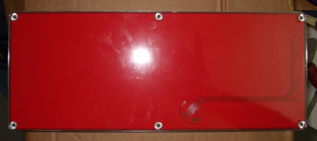

I don't have top or middle membranes yet, so i just dropped on the PCB (bottom membrane), bottom acrylic sheet, and screwed it down with 6 polycarbonate flat head screws.
test assembly bottom.JPG (136.07 KiB) Viewed 16467 times

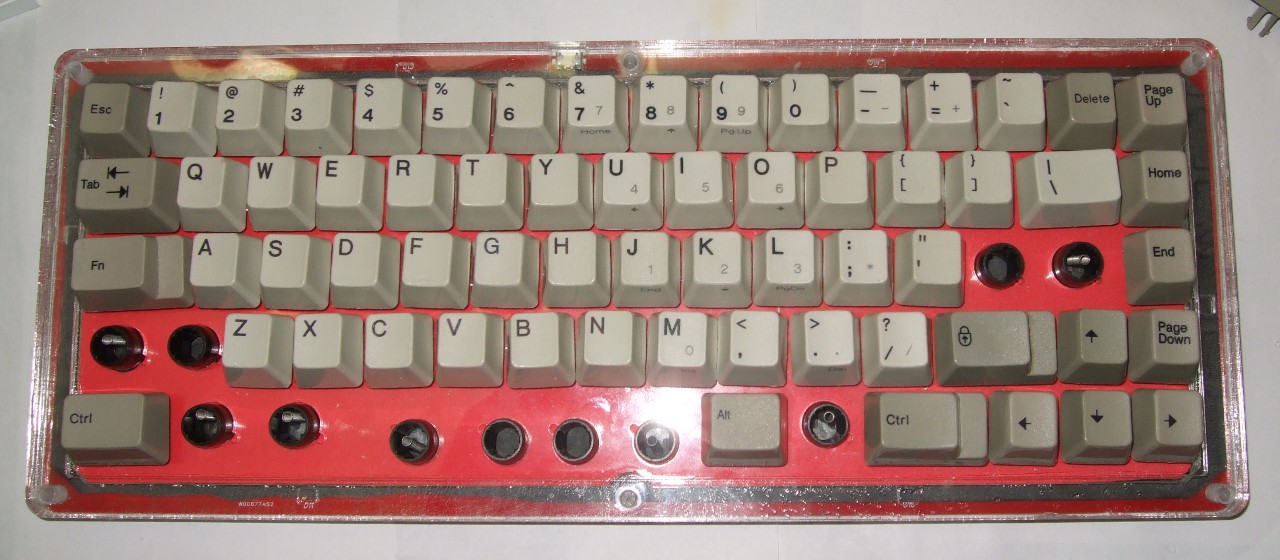

Pull it out of the box, flip it over, and put on the key caps. I don't remember where i put my stabilizer inserts - so the caps that take those are not on. I think it looks pretty nice.
test assembled top.JPG (172.25 KiB) Viewed 16467 times
test assembled angle.JPG (151.61 KiB) Viewed 16467 times
There is a bit of extra space between rows - a mm or two. I did not put any curve on the back plate, so I should have expected this. The extra space does not look or feel weird though, and it might allow more LED back-lighting to come through. The extra space and lack of a curve improves visibility of the front facing legends i have on some of the caps. I think that key feel is more like the feel of an F than the feel of an M. And one last revelation that was completely unexpected; typing on this keyboard is MUCH quieter than any other buckling spring keyboard i own.

wcass wrote: I think that key feel is more like the feel of an F than the feel of an M. And one last revelation that was completely unexpected; typing on this keyboard is MUCH quieter than any other buckling spring keyboard i own.
That is very interesting, feel like an F and quiet - you should make a video in the end if possible. But I really have to make also a keyboard like that, it is very interesting - for me as a daily Model M user!

This is great!! One thing that does bother me is the keys look rather "jiggled around".
wcass
28 Apr 2015, 14:49
Redmaus wrote: This is great!! One thing that does bother me is the keys look rather "jiggled around".
That would be my weld job which wants the same kind of dexterity as soldering. Much of that will disappear as the solvent trapped between the sheets evaporates. But I plan on "PlastiDipping" the top face and outer edge with a coat of white and then a top coat of black. The white inner coat will reflect the LED lighting toward the underside of the caps. And if i decide that i don't like that look, i can just peel it off.
