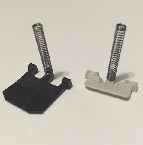

it cannot be hard in this modern age to get some F flippers and springs made, i dont have an SSK to kill ( it woudl be rude to kill mine as it was NIB and i am the only ever user :). But if i could find a junker, something with just a case and plate ... That would be the plan. Failing that i will just pick up another sliver label 102 terminal and go nuts with that.

andrewjoy wrote: it cannot be hard in this modern age to get some F flippers and springs made, i dont have an SSK to kill ( it woudl be rude to kill mine as it was NIB and i am the only ever user :). But if i could find a junker, something with just a case and plate ... That would be the plan. Failing that i will just pick up another sliver label 102 terminal and go nuts with that.
I imagine that for the FSSK to feel "right" like the F122 those reproduced flippers better have the exact right specs like the original ones. Now one might laugh and think, hell it`s only a tiny flipper. But remember how old those parts are in respect to plastic and spring quality. Pretty sure IBM did not use any ranndom parts they could get in their keyboard production. Probably custom designed and produced to exact IBM specs and tested thoroughly before going into production. What I`m saying is that the FSSK might feel different with reproduced flippers and springs. We shall see. Great work i$ ! ;)
26 May 2015, 10:46
true, we would need a good OEM to make them , not just farm them out to the cheapest OEM in china.
There are many variants of the flipper for model F and i honestly cannot tell the difference between them. i think its all to do with the angle of the flipper and its weight . It acts like a leaver on the spring thus needing less to bypass the "buckling"of the spring in comparison to an M. I think thats the main difference between them , other than the spring being slightly lighter. Try it, take a model M flipper and spring and put them next to each other and see how much easier it is to make the model F one buckle vs the M.
On top of that you have the much higher build quality with the crazy thick top and black plate with a PCB as a landing in place of a nasty rubber mat and membrane.
This project should solve almost all of the build quality issues, a PCB and a thick backplate :) nice hard landing + F flippers = AWSOME!

Let me repeat that the material used for the F flippers cannot be pure plastic. The capacitance would not change if there is not conductive material in the feet. I have not tested the conductivity of the F flippers, but we should cross-check my theory.
If the new flippers shall be done in plastic, one could always paint them with conductive paint. The effect in the capacitor of this setup is unknown to me. It shall be tested.
The same principle (add conductive paint) could be used with "normal" M flippers, but the ultimate goal (F feeling) would not be reached. I guess that most of the difference is in the fact that the F feet are larger than the M. Also, a different PCB would be needed as the conductive-M would hit the PCB in a different area.

@i$ I've been told that F flippers are plastic with a metallic compound either in the mix or on the surface. Keeps 'em light. This was a trick developed for their ancestor: the beamspring. The fly plates in those were lifted up by the keystroke and needed to be lightweight. Model F inherited the same sense pad design and so they used the same material.
chzel
26 May 2015, 13:31
The conductive material (graphite?) is probably added in the material. I had the pleasure of breaking a flipper and it doesn't seem to be coated under a 10x loupe. BTW thin CA works great to repair it!
26 May 2015, 13:51
Yeah, your guess is the same as mine. Carbon in the mix. It never wears off, no matter how much use these flippers see. Same principle as doubleshots, only without the need for any more than one shot.
I think I heard the material is resin. But I could be wrong. Whatever it is it's not crumbly 3D print cake!
