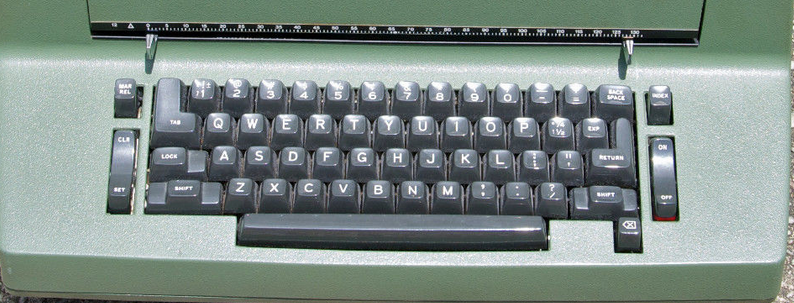

I think that caps from IBM Selectric II typewriters are compatible with Beam Spring. This model of typewriter is plentiful on eBay and elsewhere.
If it would help, I could send a set that i have harvested. I would like to have the set returned if possible.
05 Jun 2015, 15:46
Stepped Shifts, Caps Lock, and a nice Backspace. Good find, Hyper!

problem with those sets is that I miss a lot of key sizes.
05 Jun 2015, 15:59
Boards this old just didn't do modern layouts. They are older than ANSI and ISO!
Boards this old pre-date the drive to make everything cheap and shitty, too, of course. So the higher our desired standard to refer back to, the more work we (okay you) must do to synthesise a modern set of sizes.
I'm not sure what we're really missing. We can interpolate spacebars from the long originals. 1.25 and 1.5u mods can also be synthesised from we have. Same with long Shifts and ANSI Return. Depends on whether we want stepped or unstepped, mind. ISO Return we have. Numpad Enter? Well, the vertical Return key on the 3276 could cover that. Though it is convex. Could be funky!
No beamspring has a function row, so those caps must be a repeat of row 1, which makes sense.

if I have a bottom row 1.25 (for example) I can do a bottom row 1.50 (and vice versa). I definitely need not stepped shifts (any size). I need ANSI enter and ISO enter. Stepped capslock is a plus but not strictly needed. I need either tab or \|. Then a 2u R1. Function row can be done somehow, from R1 or from R3. I need just one spacebar. The others can be easily done. Of course I need 1u for each row. Having a vertical key would be a plus.
The Selectric above misses many of the needed keys.

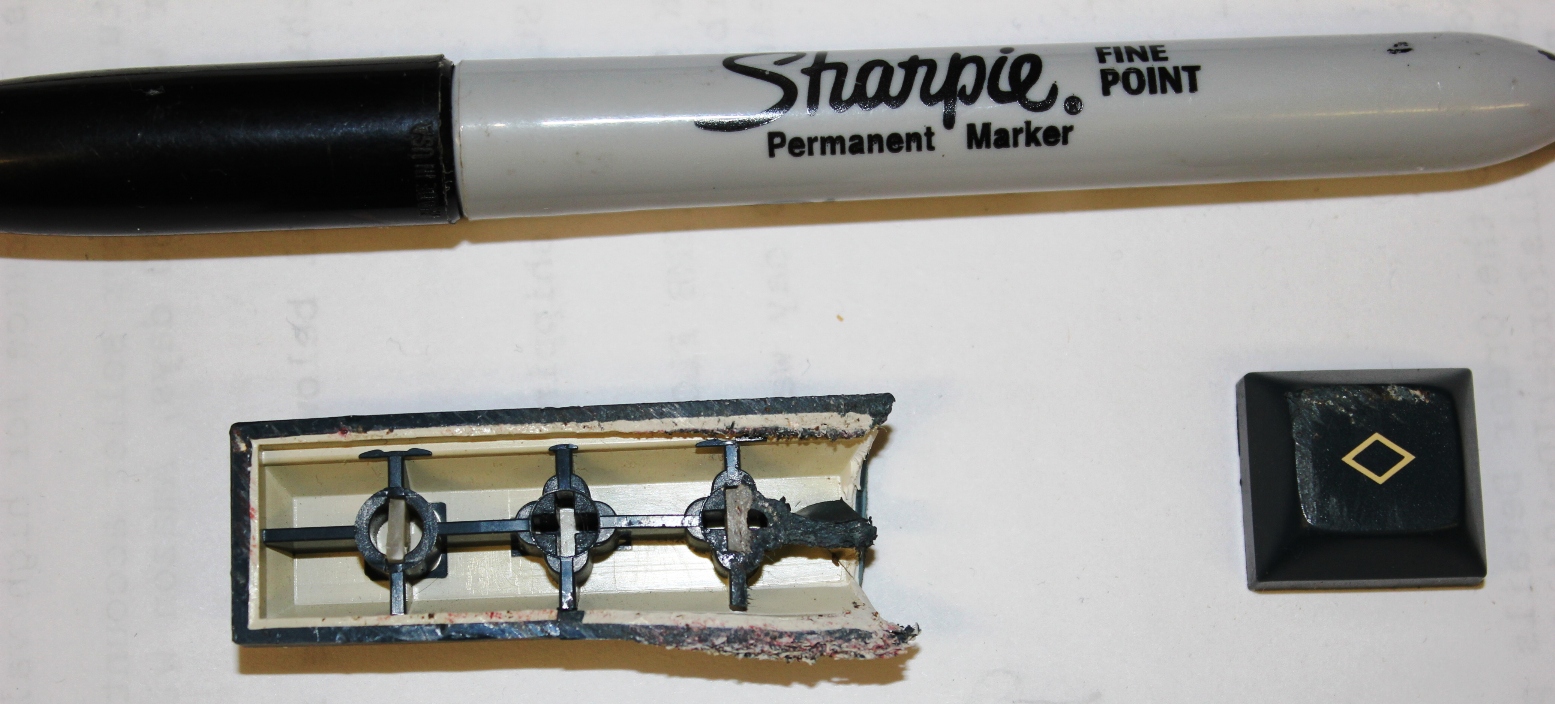

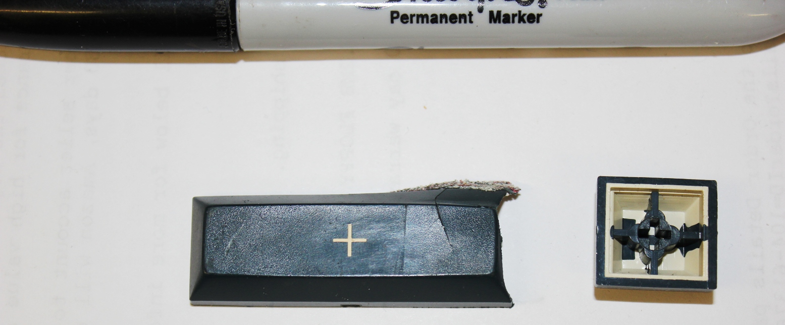

Not all caps are created equal. I will post pics in a few min of some caps that survived being run over by a forklift moving 4000 pound box of scrap. They came off an old calculator of some sort. These are very thick!

elecplus
05 Jun 2015, 18:28
A bit munched on the end, but it survived amazingly well! This is the + key off an old calculator.
