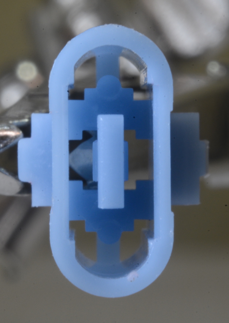

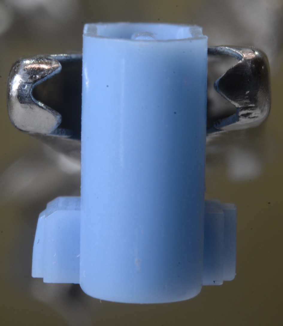

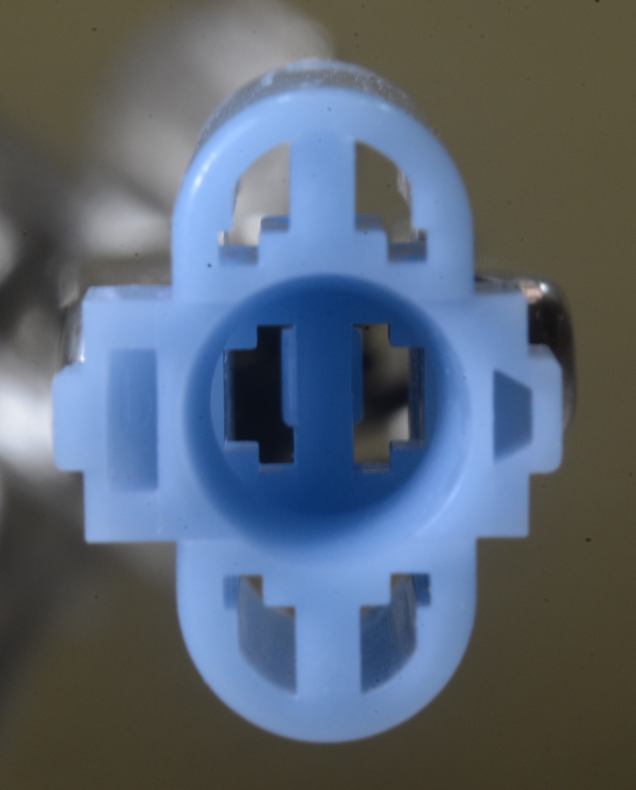

04 Jul 2015, 21:19
Chyros wrote: Is the slider on these reversible btw? It only ever shows one side in the pictures.
Surprisingly, it is not! Hopefully these macro shots tell the story better.
(f/32 to f/40, ISO 400, exposure as required for +-0EV, Mup mode, camera on table, helping hands holding subject. Overhead and spot lights. No flash. Nikon AF-S Micro NIKKOR 60mm 1:2.8G ED at 1:1.)
04 Jul 2015, 23:03
Excellent pictures. The non-reversibility makes sense. The front, slanted bit supposedly touches the electrical contacts, and the fact that it's ramped presumably controls the distance, exactly like with Cherry switches. The rear bit I'm assuming is stabilised by an oppositely-shaped guidance gutter?
