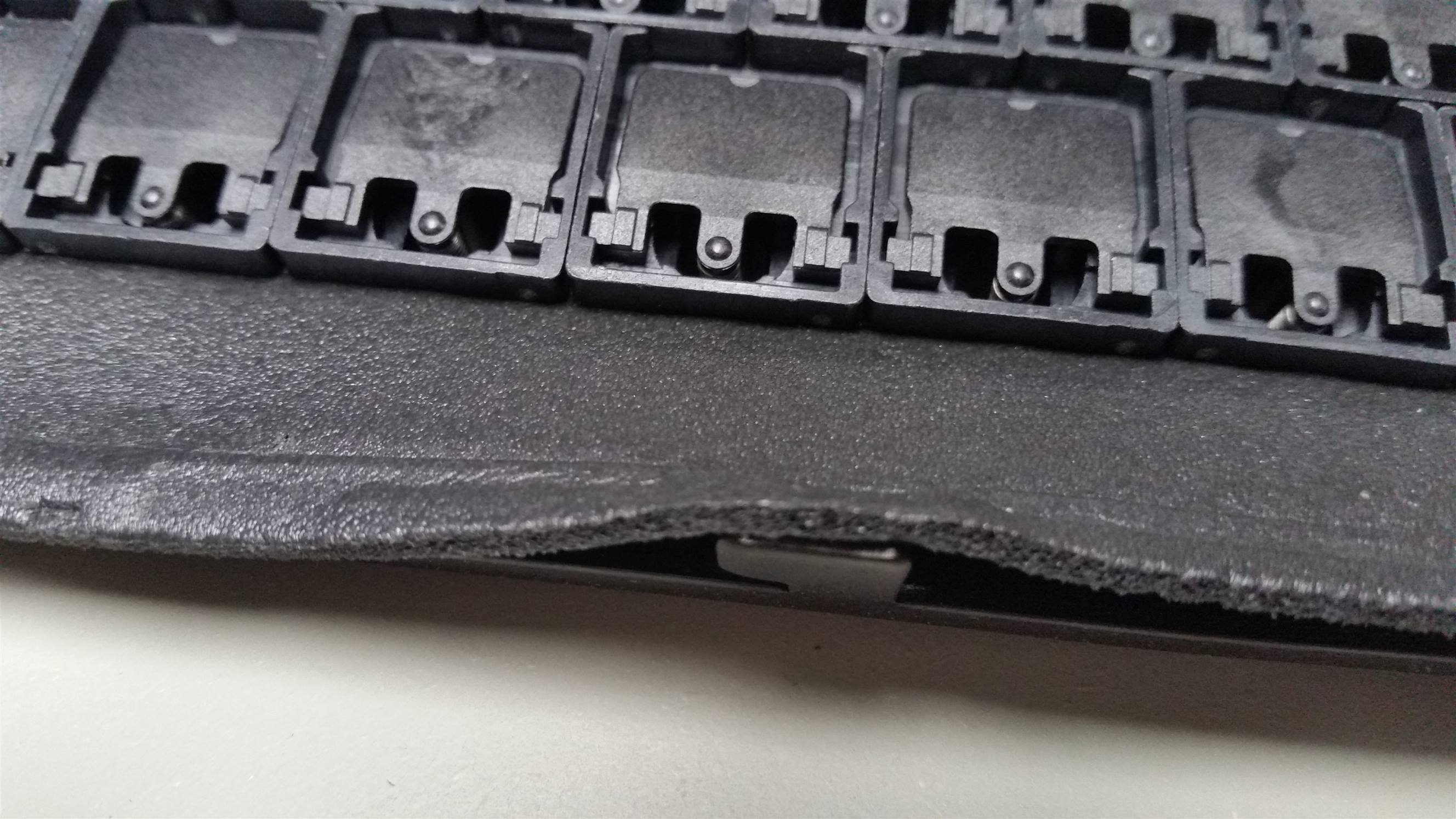

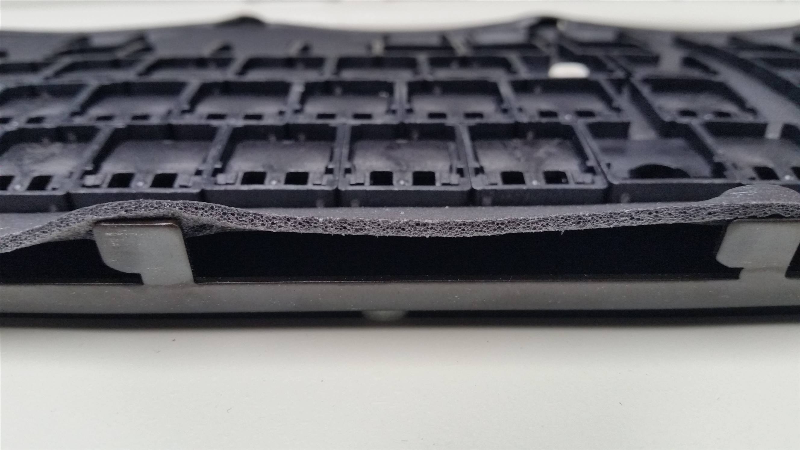

By the way does anyone know the specific type of foam used in my F77 judging by the following photos? It appears to be 2mm foam of some kind that has a smooth/solid top and bottom surface.

Nuum
04 Jul 2015, 11:43
Looks like something like Ensolite to me.
Ellipse
04 Jul 2015, 16:57
Thanks Nuum!

Engicoder
05 Jul 2015, 13:37
Enoslite make several different foams. Myself and others have used this foam with success.
http://www.mcmaster.com/#8647k102/=xx37ry
Its an extra soft Neoprene/EPDM/SBR
