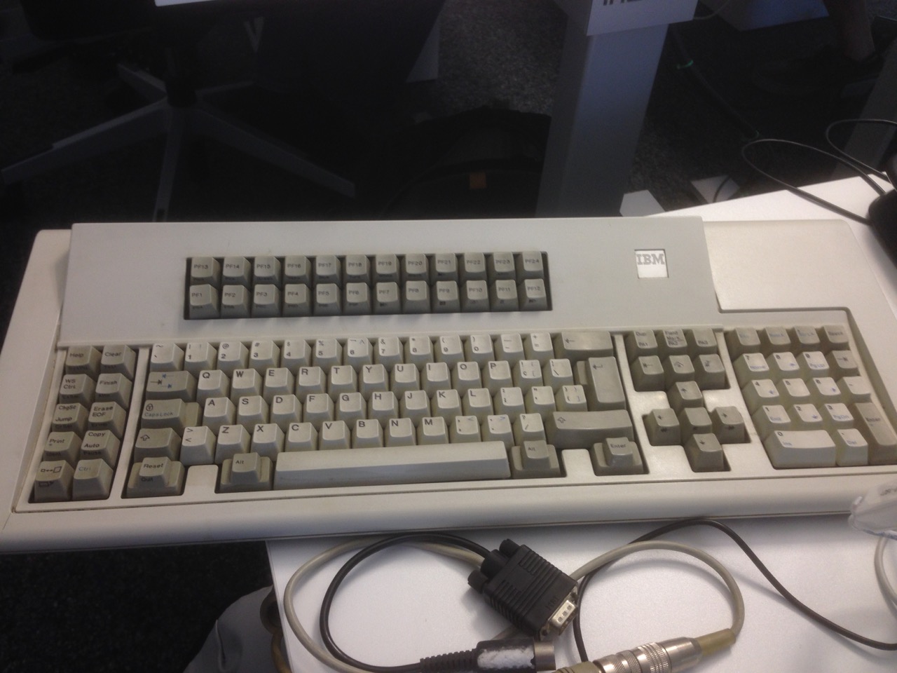

This is how mine looked like when I got it:

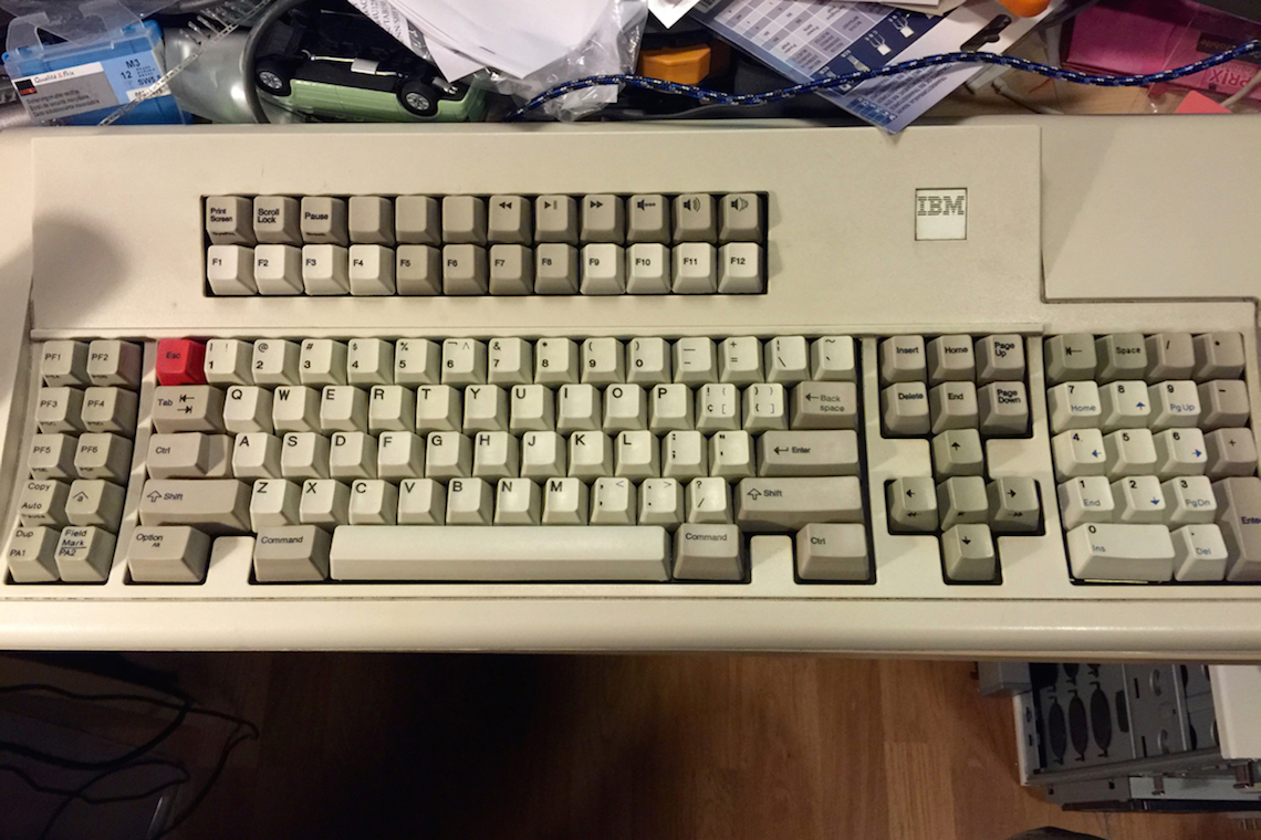

And this is how it looks now:

Wow Jou thats a nice 122 you got there! How did you remap those keys like that? And is it difficult to do? I really like how the shift and control are back to normal and your f keys are up there.

Its depends on what conversion method you use. If you use a replacement controller there is a nice GUI to change it.
The reason for replacing the foam is that i can degrade over time and lead to a less tactile feel. I have never bothered myself all my foam has been ok.
Most of the time the existing foam is fine , but if you are in there anyway then you may as well change it if needs it.
The layout is very easy to change , its just a case of switching the springs and flippers and putting new caps on it.

Mine has a Arduino Pro Micro clone stuffed inside with Soarer's converter flashed. Remapping the keys wasn't very difficult once you get a hang of it (I do deal with code and configuration files on a daily basis, so take "not very difficult" with a grain of salt ;) ). If you get stuck, you can ask for help here.
Physically rearranging the keys was a bit tricky but not unsurmountable, even with my mediocre mechanical skills. fohat has a detailed guide on how to do it.
