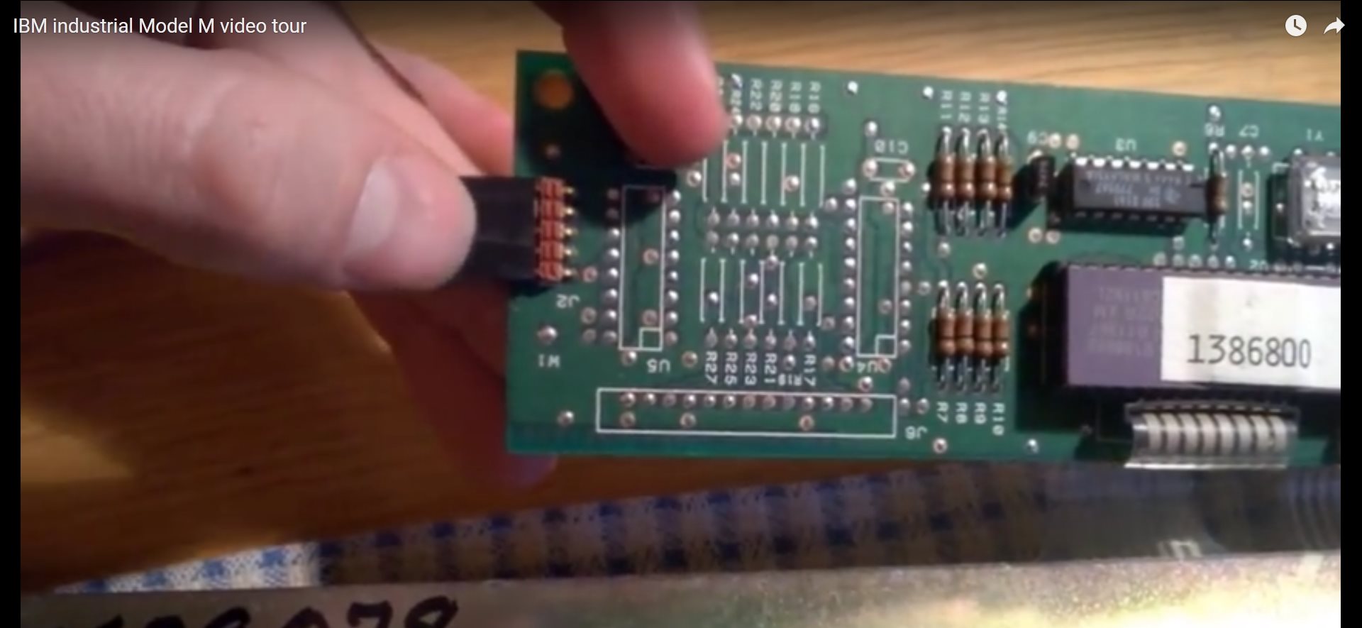

05 Feb 2016, 21:39
Took a little while but here's some more, as promised; I made a video instead of more pictures though. Thought that would be more comprehensive :) .

Maybe the chip with the opaque sticker on top is an EPROM?
08 Feb 2016, 11:44
jacobolus wrote: Maybe the chip with the opaque sticker on top is an EPROM?
Yeah that's what somebody suggested in the comments on Youtube, they said
It's an EPROM memory or a microcontroller with EPROM memory (I haven't found exactly this one, but it's something like "TMS7742JDL"). The sticker covers a window, under it is the memory itself - don't remove the sticker, the UV light could erase it -> making keyboard unusable...

bhtooefr
08 Feb 2016, 13:50
Erasable Programmable Read Only Memory.
Essentially, you have the following classes of ROM:
Mask ROM: Fabricated with the data that it'll always have - the cheapest type of ROM to make in mass quantity, but very expensive to change the data.
OTP ROM (One-Time Programmable ROM): Can be programmed by writing to it with high voltage, but once that's done, that's it, that's the data you've got on there.
EPROM: Similar to an OTP ROM, but with a window in the top. UV light can reset these, so they can be rewritten. The sticker makes sure no light can get in to accidentally erase it.
EEPROM (Electronically Erasable Programmable ROM): Similar to an EPROM, except instead of a window to erase it using UV, there's an erasing voltage that can be applied to erase the whole chip.
Flash: EEPROM that is organized in blocks, and erasing happens on one block at a time, instead of the whole chip.

I don't think it's an EPROM: It was quite common for chip packages to have a protruding metal plate on the top of the chip back in the days. On an EPROM they would probably have put a more oblique kind of sticker.
http://www.chipsetc.com/vintage-compute ... dware.html
08 Feb 2016, 16:20
But they did make one time programable versions , they would have no need for a window for UV erase.
I am guessing its just a keyboard controller.
The chip on that IBM will prob be a very early run of the chip, to be in a plastic package ( at least back then) the chip had to consume less than 0.5w, if you did not know the power draw then it makes sense to put it in a ceramic package until you have tested the physical chip sure the price for plastic vs ceramic is about 100x ( more for the ceramic) but if your doing an early small test run its not that big of an issue.
Mill spec stuff will usually stick to them for the durability.

BTW, the unpopulated part of the PCB is probably because they used the same controller PCB for 122 key terminal keyboards. Those have a third membrane connector that goes into the J6 spot. Rxx are resistor spots, U4 and U5 are the spots for logic chips.

andrewjoy wrote: But they did make one time programable versions , they would have no need for a window for UV erase.
If it’s a prototype board, then being able to erase it would make some sense.
