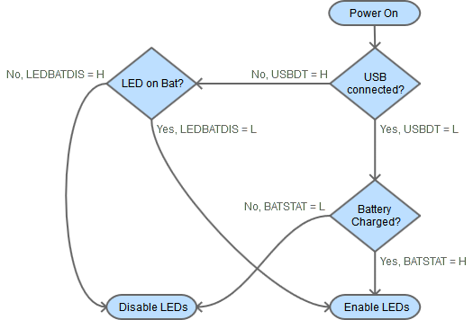

Here is what my current plan for the USB Charging looks like. By default, the device will charge the battery at 300mA (slow), and when on fast charge at 1A, like the example you provided, this would simply be done using a transistor to "enable" another resistor in parallel to increase the charge rate. I'm using MCP73833. No need for the complicated voltage reference and logic level shifting IMO.
Slightly related, here is the flowchart for automatically turning on the backlight and RGB LEDs once the charging is done and to toggle them when on battery. USBDT, LEDBATDIS, BATSTAT are all interrupts to the AT90USB1286, so a change in USB state, switch toggle and battery status will automatically trigger the MCU to check whether to enable the LEDs or not. LEDs disable means 0% duty on PWM for backlight and black color on RGB LEDs.

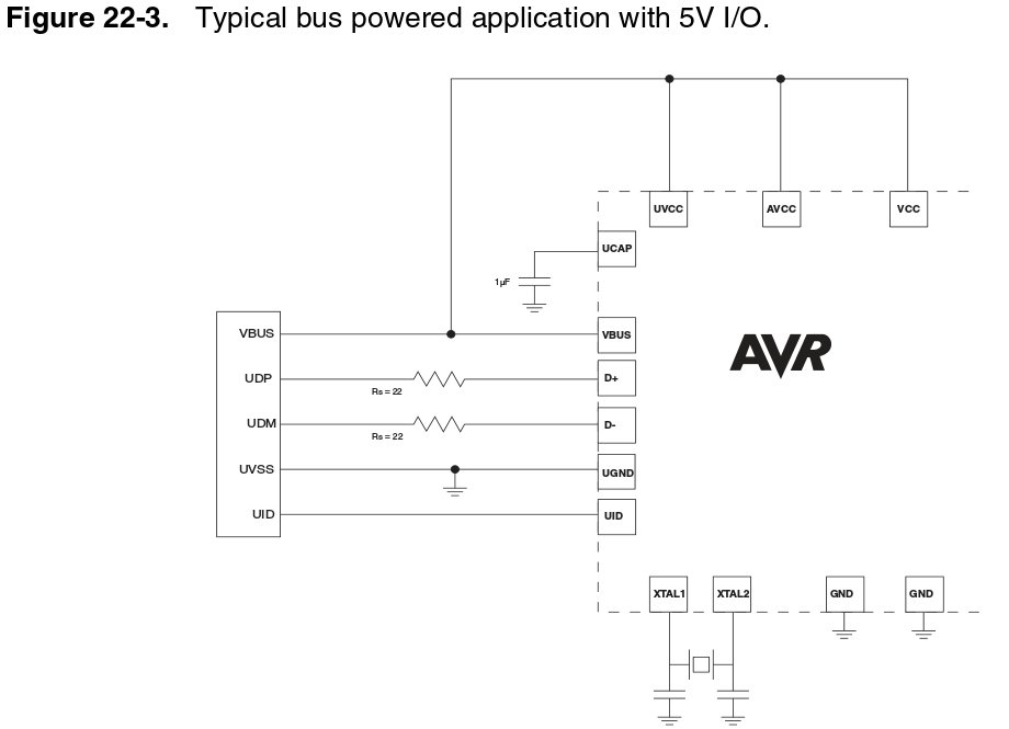

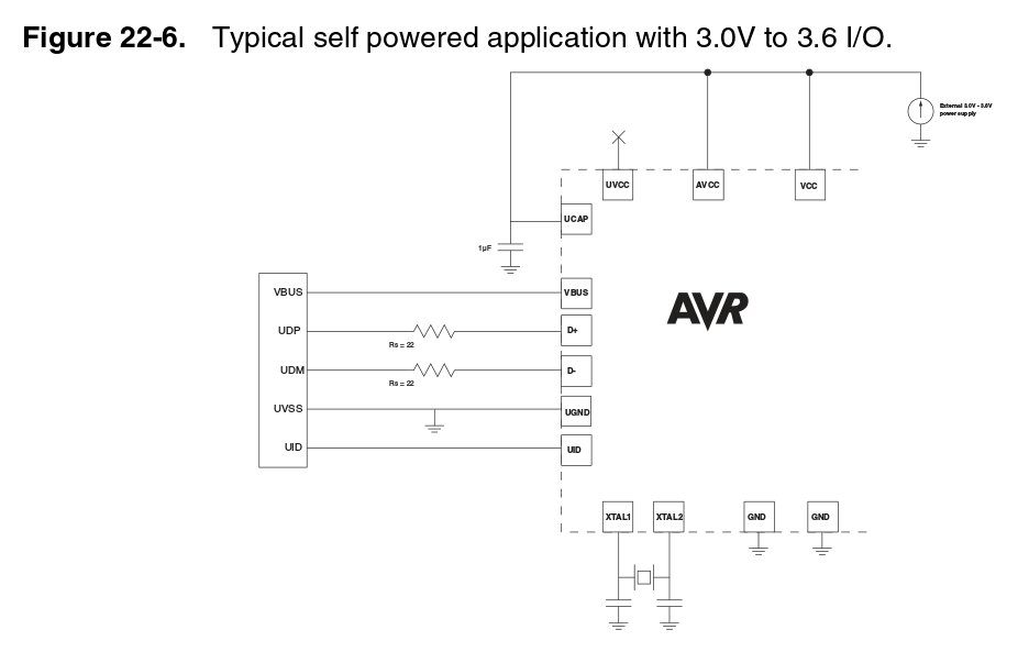

@phosphorglow: There should always be a 1uF cap on the VCAP line when you're using USB (datasheet says). It is the output from the internal 3.3V regulator and needs to be stabilised. {On these AVR chips that have USB, there is an internal regulator capable of doing 50mA. They need to have a source of 3.3V because that's what D+/D- lines run on.}
Also - I do not understand from your posts what does "flashing" mean - using a bootloader? AVR ISP? Which bootloader?
The bootloaders need to know in advance how fast is the crystal. It does not (well, should not) matter on which voltage the MCU runs, as long as the chip is not too overclocked to fail. It is possible for the MCU to figure out the voltage it's powered with (using the internal bandgap reference) and then adjust its crystal frequency expectation, but I highly doubt the ATMEL's DFU bootloader does this. Certainly LUFA bootloaders don't. Halfkay doesn't.
So, rule of thumb: if you replace the crystal, the bootloader stops working and needs to be reflashed.
BTW this guy (Justin Mattair) has a "correctly" (i.e. in accordance with 32u4 datasheet) wired atmega32u4 breakout: https://www.mattairtech.com/index.php/d ... tible.html
My point is in the manual to that board, page 12, he explains which pins are inputs and which are outputs in the respective power configurations: http://www.mattairtech.com/docs/MT-DB-U4_User_Guide.pdf

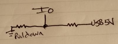

About detection of USB, why not connect your detection pin to 5V from USB via a resistor divider to get 3.3V for detection. Default state will be pull down. So if it's high, that means charging can be enabled, just choose at what rate based on if USB is configured or not.

Yup, 1uF on UCap like the datasheet says, regardless of 3.3V or 5V operation. However, in 3.3V self-powered applications they say to also connect the externally regulated voltage to UCap. And to disconnect UVcc, but it works either way (for example the Teensy).

As far as "flashing" I mean putting the controller into DFU mode and flashing a .hex to it.
I'm using stock Atmel DFU and fuse settings on a 1286.
At 3.3V operation as connected in the datasheet, I cannot flash a hex using a 16MHz XTAL. hasu tried the same thing on a USBKEY with a 1287 (also Atmel DFU) and got the same result. 8MHz XTAL at 3.3V flashes just fine though.
That's precisely how it's connected if I'm reading that correctly. I may have yammered too much to have explained it coherently. ;P
2016-03-30 05.06.29.jpg (11.45 KiB) Viewed 7725 times
(Which, if UVcc is connected, tosses voltage right into the 5V pin, hence my issue.)

That is what I mean, but I don't understand what you mean when you say, "if UVcc is connected, tosses voltage right into the 5V pin".
phosphorglow
30 Mar 2016, 12:41
In the self powered example, UVCC is disconnected. It measures 3.25V.
When it's connected, it feeds that voltage to VBUS.
...which pulls my USB detection input high.
mohitgarg
30 Mar 2016, 12:48
Still, don't understand :P
Probably have to see the complete schematic, looks like I'm missing something.
