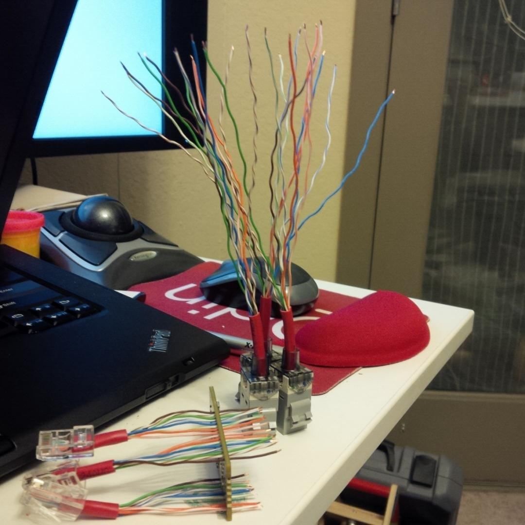

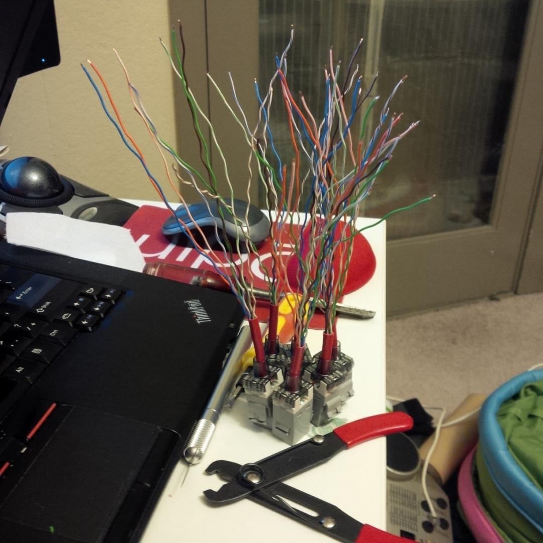

Because you're tired soldering and you was The Networking Guy.
Oh wait, I need that for two keyboards!
lot_lizard
08 Jul 2016, 14:07
Haha... That might be the picture of the year. Too funny. Clever though... Why not

lot_lizard wrote: Haha... That might be the picture of the year. Too funny. Clever though... Why not
It's called "568th of March" in my instagram :)
but yeah, all those experiments with "let's try drive those instead of those" led me to a modular solution. That and lots of stuff laying around from the previous office move.

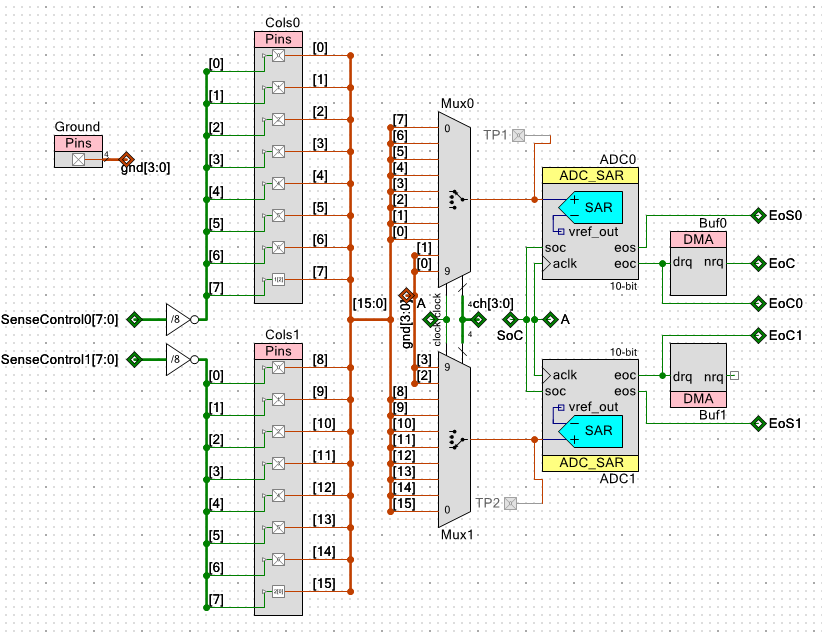

I'm typing this post on an F122 still attached to the scope, using a working version of the controller.
It has no foam, shoddy ground and a pretty long tail of wires made from cat5e twisted pair.
On the scope you can see signal levels going up and down depending on how hard you press the button - because barrels are literally floating, hanging from the keycaps which are propped up by the spring.
So far it works and even quite stable, cranking about 2500 matrix scans per second.
Every click is exactly one character appearing on the screen.
Layout is a bitch though. lot_lizard, where are you with your miracle steel plates?
Controller is tmk-based now but I can actually make it xwhatsit-interface-compatible for giggles. I like the fact that you can edit layout on the fly.

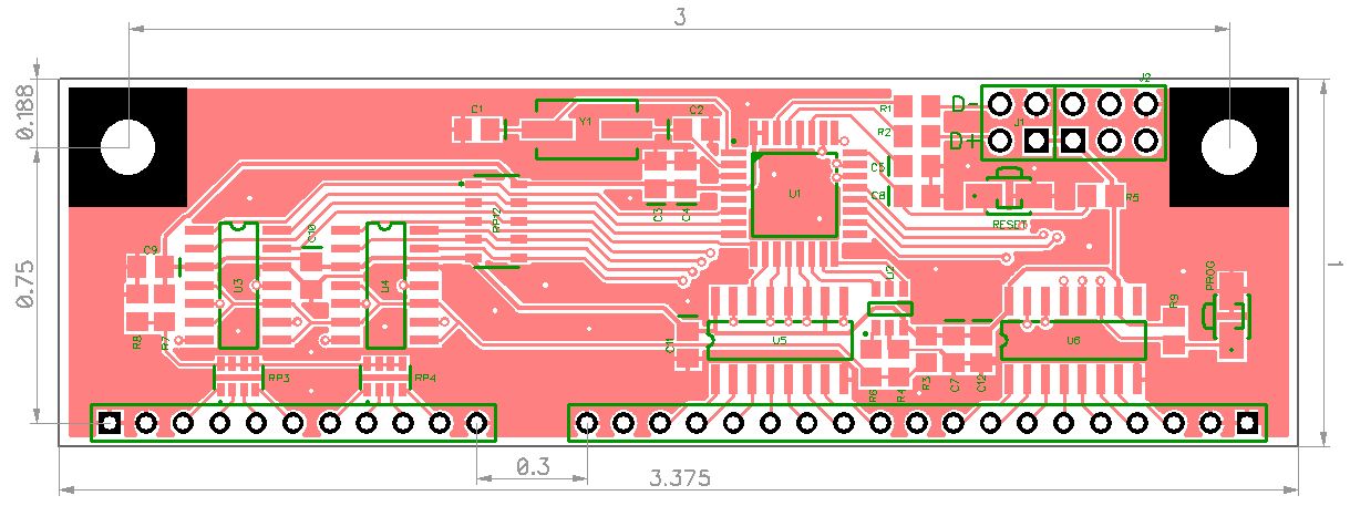

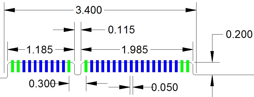

If you want to make a direct replacement for the MF ... the controller is laid out like this:
It uses a 19 pin and an 11 pin right-angle Triomate FFC connectors as PCB edge connectors so that the controller sits underneath the back plate. Four wires lead off to pick-your-type USB connector placed elsewhere. The top of the matrix PCB will look like this:

wcass wrote: If you want to make a direct replacement for the MF ... the controller is laid out like this:
I have no intention making hardware. Teensy (or any other MCU with ADC) would work just fine. Hell, even arduino probably will. So no point. Lower parts count (like 4 resistors and 4 caps IIRC) won't offset the chip price and sourcing hassles, and special compiler toolchain needs practically make this project dead from the start.
As for the nano-xwhatsit you're making - wouldn't using those connectors lead to problem Ratfink experiences once a month? Good old tin will take out huge amount of variability from the connection - and variability is one thing xwhatsit's sensing schematics doesn't tolerate well (though it can be improved on a per-column level using only firmware changes - this will save ratfink from monthly keyboard assembly-disassembly drill).

xwhatsit is using external comparators. This thing uses integrated ADC, so there's no external hardware. (In fact, out of curiosity I counted the BoM yesterday - it's the chip, 3 resistors, 1 10uF, 10 1uF and 4 0.1uF capacitors. If external reset pin is needed (can't see why) - that's +1 resistor and 1 0.1uF.)
ADC needs to be a good one - 2Msps gives about 4k matrix scans per second, so it's not desirable to go below 500ksps
atm32u4 ADC can only provide 15ksps. So, about 30 scans per second optimistically. Which is a bit low, you'll strat to haev mxide keyperses.

So.. it even works somehow. And even gets ~1.05kHz scanrate if not disturbed - but.
BUT.
Barely enough analog pins (20 total in K20 - and that would be _really_ stretching it, ganging pins together, using MUXSEL..), HORRIBLE ADCs (Just look at that noise spike!), essentially 8 bit (because lowest 4 bits in 12-bit mode are chemically pure shit, an 5th is so-so), SNR of only 2x..
In short, kinetis as a platform sucks.
OK, I've proven что не зассал and it's possible to implement this on kinetis if you take enough sea sickness pills.
But, since I've lost all interest - lack of commercial potential, "real life" - pick any, really - if anyone wants to pick up that flag, feel free to. Forking on github is real easy nowadays.
It's all actually pretty simple, no rocket science. You just need to remember to
a) not drive the strobe too hard so it doesn't ring as hell.
Slew control is your friend here. If it still rings - throw a resistor in series with the strobe trace. 1K should be more than enough. IBM for some reason used 10K ones, but I don't see much point in that.
and
b) interleave the ADC readings with reading from the ground, so that ADC sampling capacitor has a chance to discharge. If you don't - the charge from the pressed button will spill over the next buttons you scan (sample cap will charge the sense lines because it has higher voltage) and screw up your measurements.
I may return to this if I find an income source which doesn't eat all of my time.
Wouldn't count on that though, if I were you.
Thank you, and good luck.
PS: (too bad you can't lock your own topics)
PPS: Sorry, lot_lizard. I promised you to bring this to a workable stage. Can't keep all the promises, it seems.
