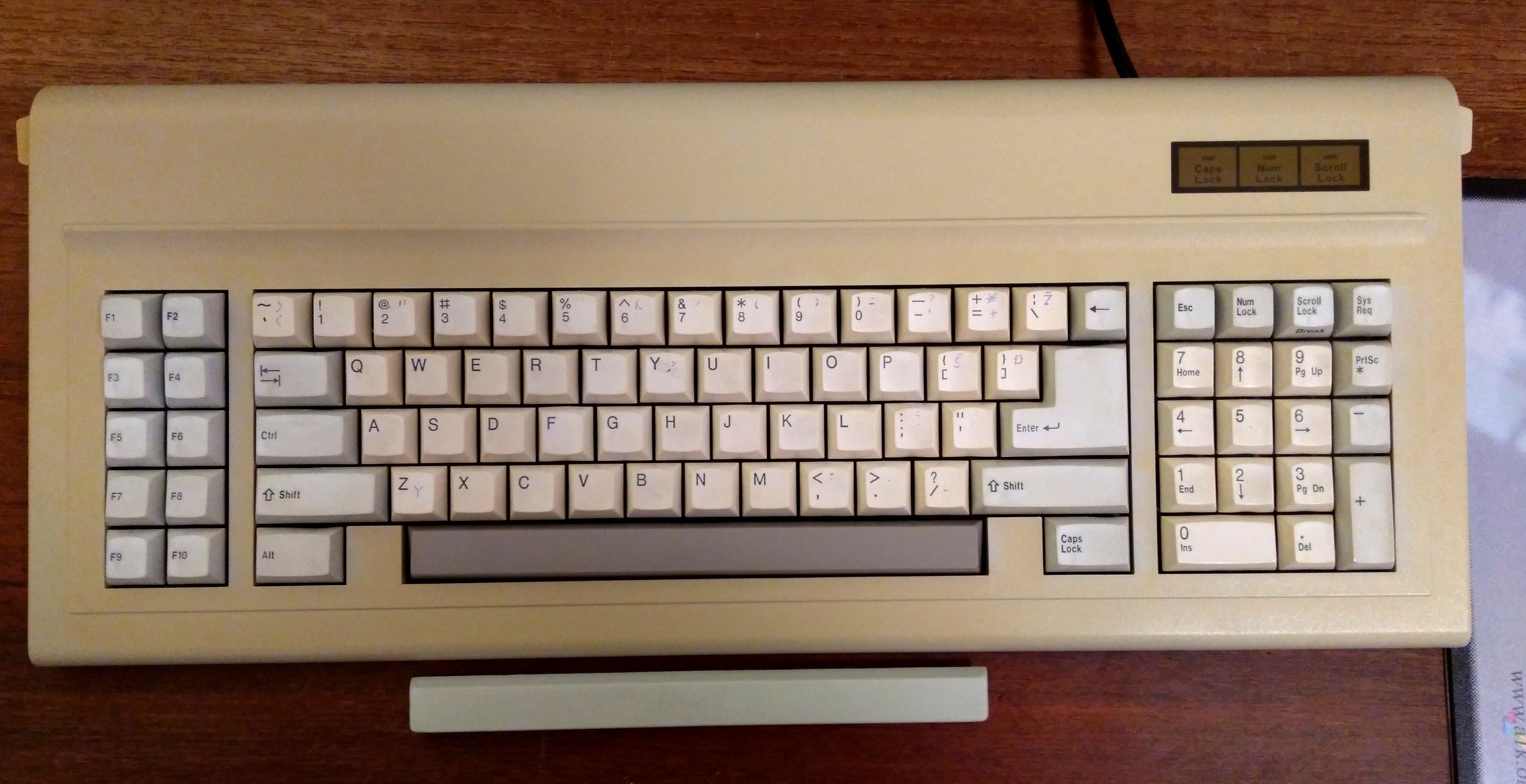

Datacomp DFK-777F:
Polecat
23 Nov 2017, 02:50
seebart wrote:
Polecat wrote: Here's the best view I've found of what's inside the Futaba switches:
http://www.kbdmania.net/xe/review/1274536
Nice, thanks for sharing. I'm really enjoying these clicky Futabas right now.
Datacomp DFK-777F:
Wow, nice, I had no idea those came with Futabas. I had a caseless DFK-777 that I used as a blue Alps donor, still have the PC board here someplace.

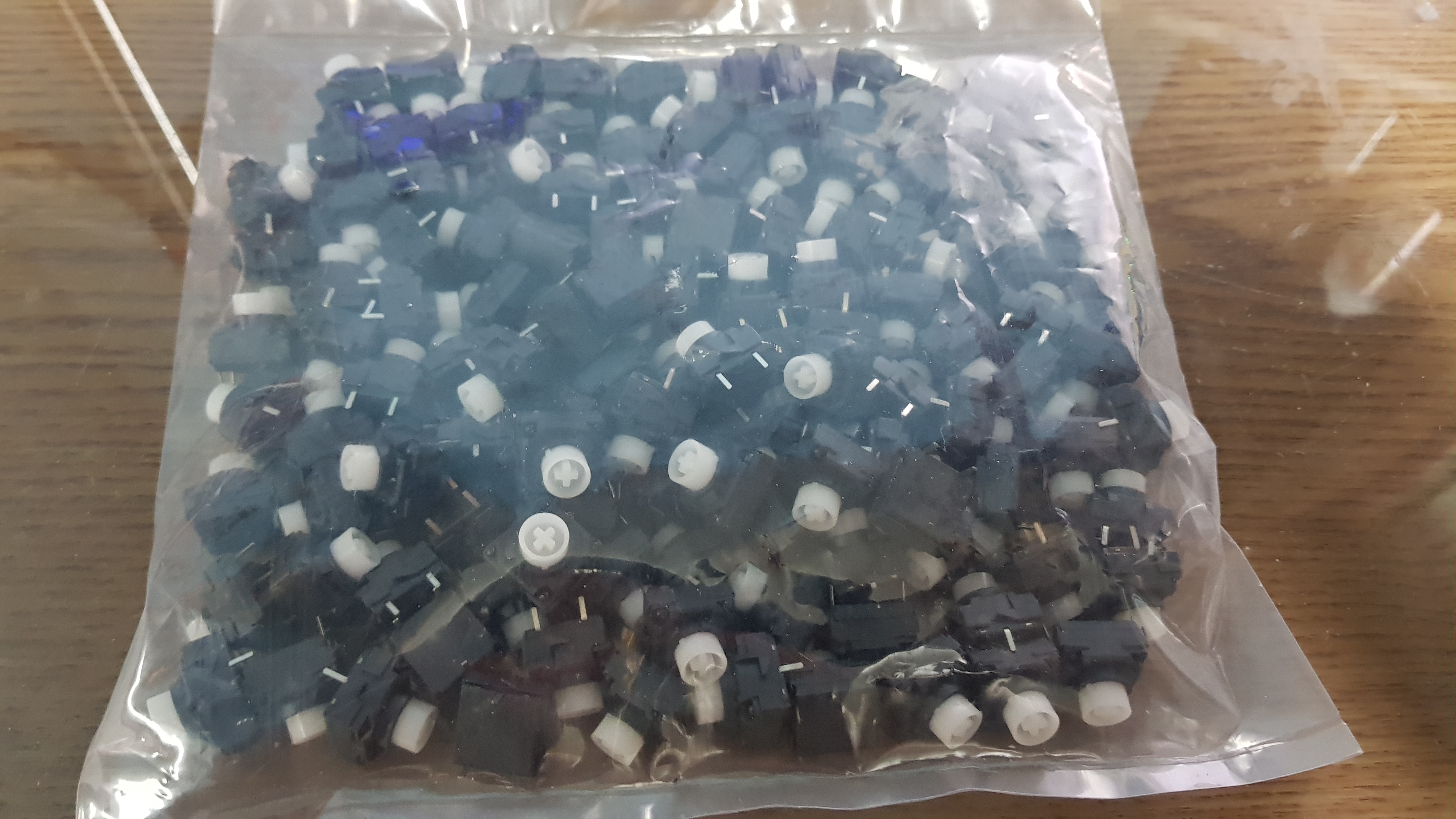

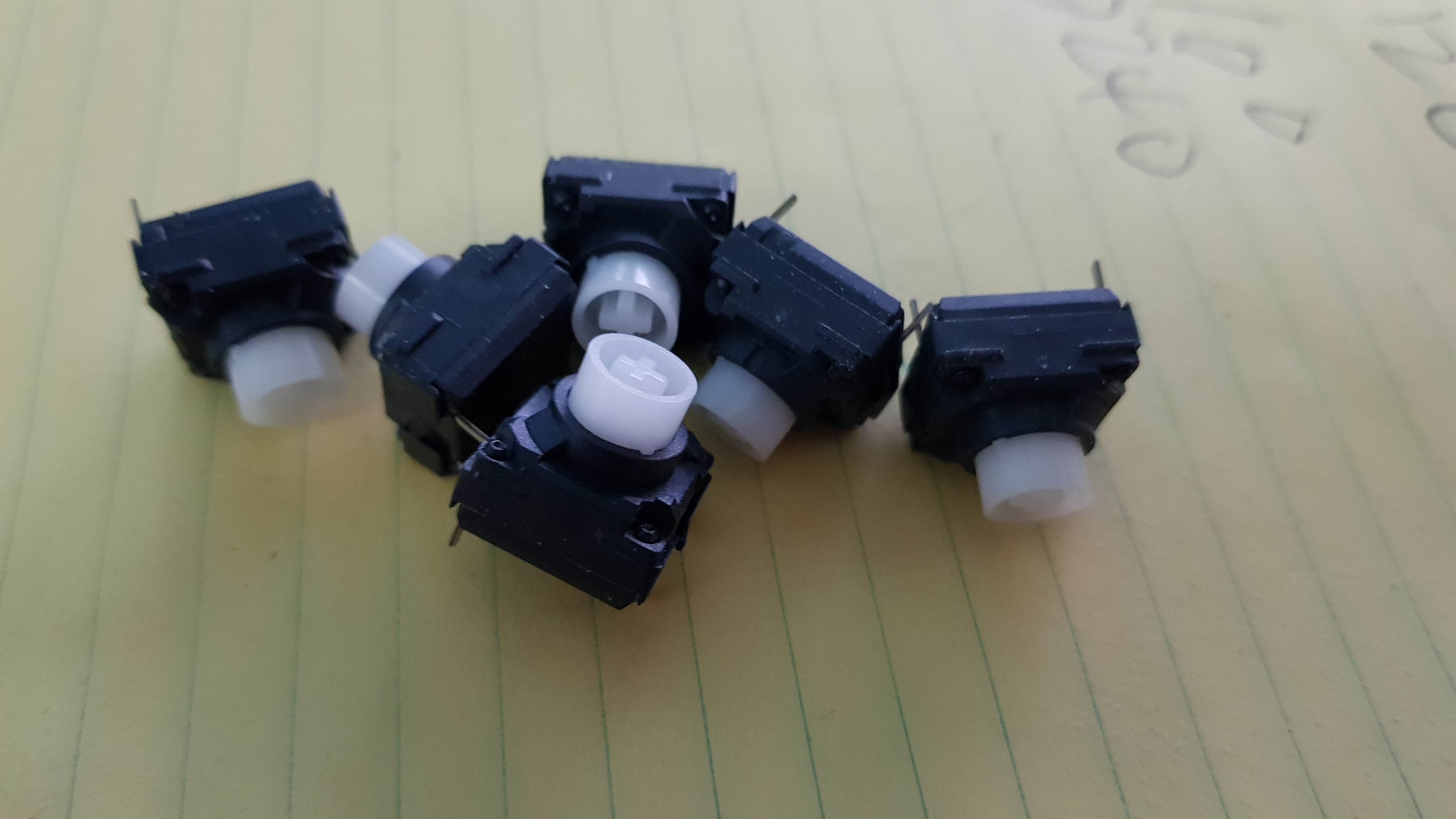

Please understand My English is not good.
I have never used Futaba Keyboard before. So I wanted to try this switch,
have been looking for a lot of places for a long time
I found a Futaba Switch that in an old electronics store!
finally succeeded in purchasing a completely new Futaba switch that was not used!
I purchased 125 switches that are compatible with Cherry MX keycap to create a new keyboard.
Does anyone want to buy a new Futaba Switch? The price is expensive, but it is completely new. And a very small amount remains.
30 Nov 2017, 13:42
I am guessing that you do not have the part number for these switches?
I managed to get those NOS, but it's the grey ones I need more of.
30 Nov 2017, 13:44
What is your price and what is "a small amount"?
miracle_hoshi
30 Nov 2017, 13:52
There are about 300 to 500 switches all that can not be found anymore after it has been exhausted.
price of a switch is about $ 1. I paid about $ 120 to buy them.

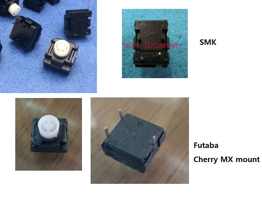

purdobol wrote: They're also on aliexpress: http://s.aliexpress.com/jYjIrAzq
and Taobao: https://world.taobao.com/item/540513185273.htm
They are not Futaba.
purdobol
30 Nov 2017, 14:05
Ahh my bad :P
miracle_hoshi
30 Nov 2017, 14:09
No. The SMK switch is similar to Futaba, but different.
rich1051414
30 Nov 2017, 23:29
Pretty sure the SMK is similar only in visible stem design, and that is pretty much where the similarity ends.
