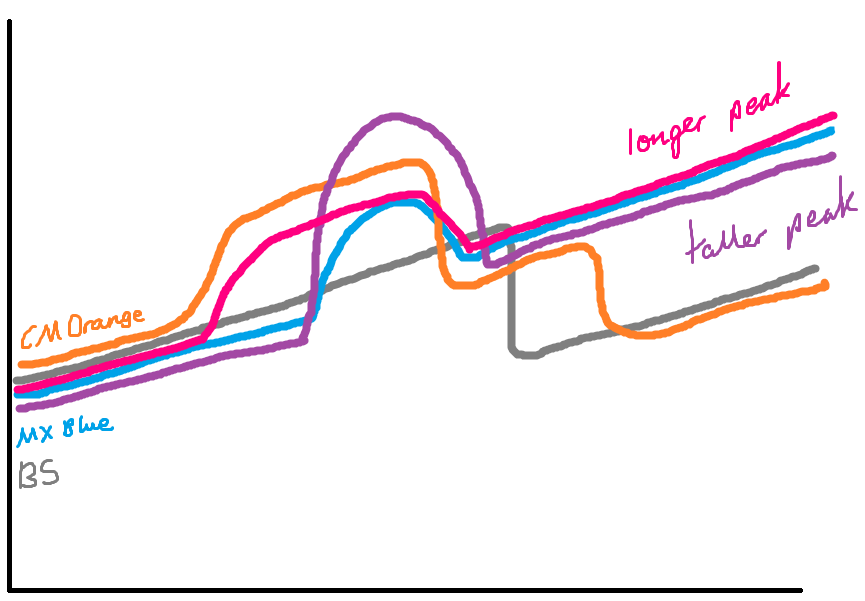

19 Feb 2017, 15:43
I think it was you, yes.
This should illustrate what I was thinking:
Graph theory (or someone extending Tube lines while stoned)
Graph theory.png (31.76 KiB) Viewed 7676 times
What would a switch with the pink or purple curves feel like? Purple increases the magnitude of drop (requiring more work) but with a greater wall at the start of the peak, while pink involves more priming but no greater drop. That is, can we prove whether this type of curve is truly non-viable, or whether it's only the force levels that are the problem.
What would be amazing is a machine with a mechanism under each key that modulates the force under computer control, say using electromagnets. You could draw in the curve you want into the computer and the keyboard would simulate it for you. (This could even work as a real keyboard.)

Daniel Beardsmore wrote: I think it was you, yes.

19 Feb 2017, 16:34
yes, just regular force curves, downstroke only.

19 Feb 2017, 20:38
This is the scheme I was talking about by the way, Alex drew it up:
It illustrates very well why Cherry MX is considered such an inherently "linear" switch IMO. Whether or not other switches are super tactile is another story of course — and there's sharp, broad, strong and weak tactility — but this kind of absolutely unchanged key travel isn't that common to find in other switch designs AFAIK.
