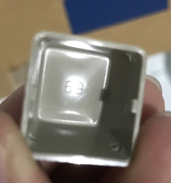

I just got my keycaps today. They look great by the way! There is one minor issue, at least with the two I received. It almost seems like the plastic of the keycap deformed slightly due to heat which causes the keycap to not fully seat onto the plastic stem. It almost feels like a deeper dish keycap, not to an extreme but slightly noticeable compared with other Unicomp keycaps. To compensate for this I simply used my dremel with a tiny carving bit to remove a little bit of material from the top of the plastic stem. All good now!
Hard to tell but the top of the cap bows inward just slightly.

Mine came in. The grey and pearl are good. The pebble is a little, melted for lack of a better term. The sides of the cap near the top are bubbled out a bit and it no longer snaps into place over a stem. Could probably workaround sanding down a stem.

Got mine as well! And same issue with the pebble one :/. It looks like pebble one got deformed just a tiny bit, and can't stay firm on the stem.
