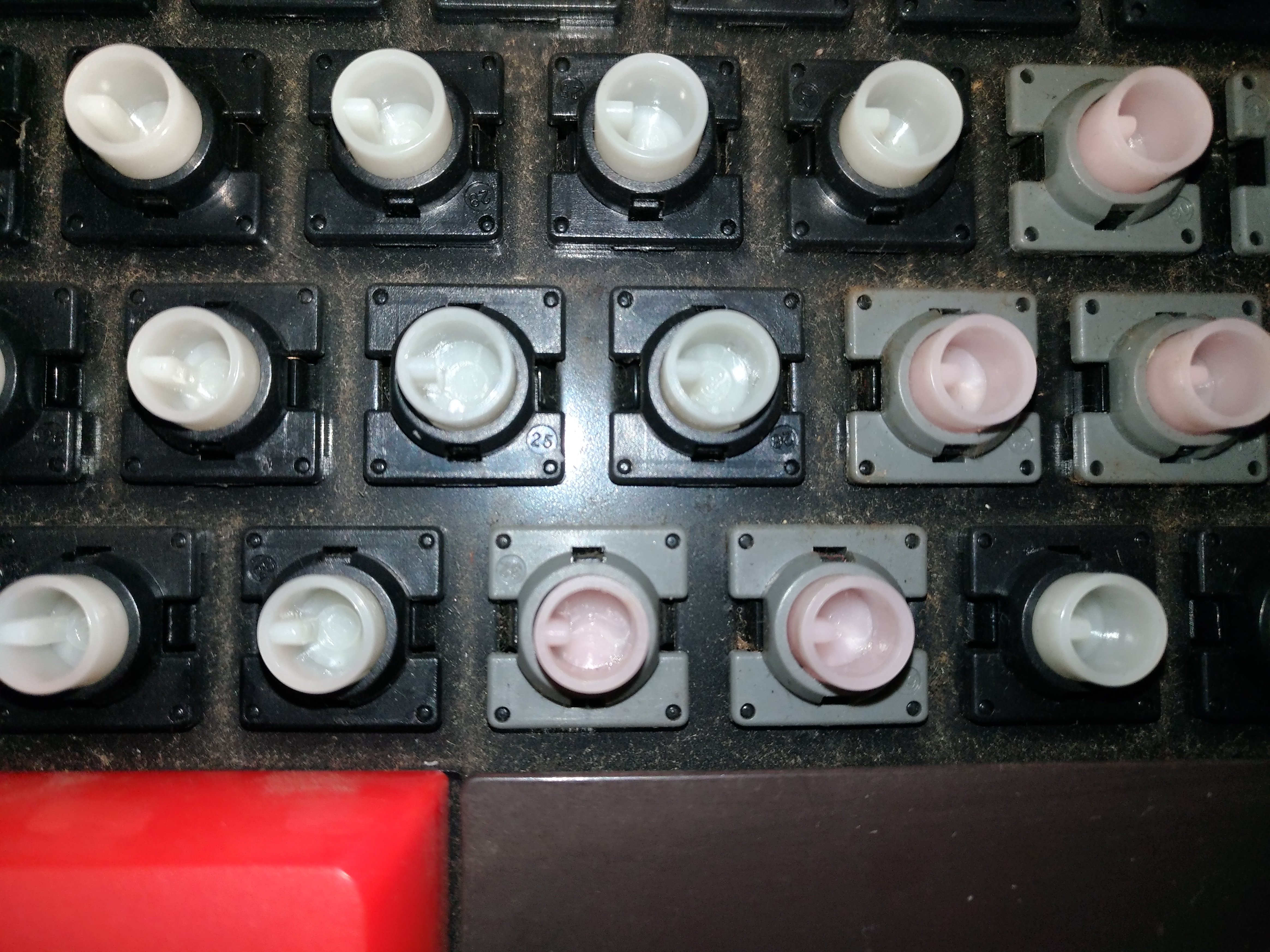

Can anyone identify what this is?
Sits in something called an East KB-5102 that a guy is selling, and i cant seem to find much info about.
quochung1989
Vintage Cherry Collector
20 Mar 2019, 02:23
It's from Sony KI-9700P. Who know it?
20 Mar 2019, 03:34
quochung1989 wrote: 20 Mar 2019, 02:23 It's from Sony KI-9700P. Who know it?
They remind me a lot of SMK spring-over-dome. Those are nice. But that could maybe be just a dome with slider.
quochung1989
20 Mar 2019, 04:24
Findecanor wrote: 20 Mar 2019, 03:34
Where can I read more info about it?
20 Mar 2019, 09:26
I couldn't find any existing info about them when I got them, unfortunately. I saw only "SMK" on the PCB.
quochung1989
20 Mar 2019, 09:32
Findecanor wrote: 20 Mar 2019, 09:26 I couldn't find any existing info about them when I got them, unfortunately. I saw only "SMK" on the PCB.
Ah I see. Thank you!

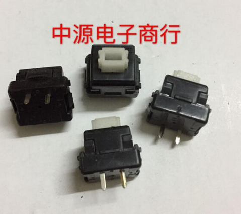

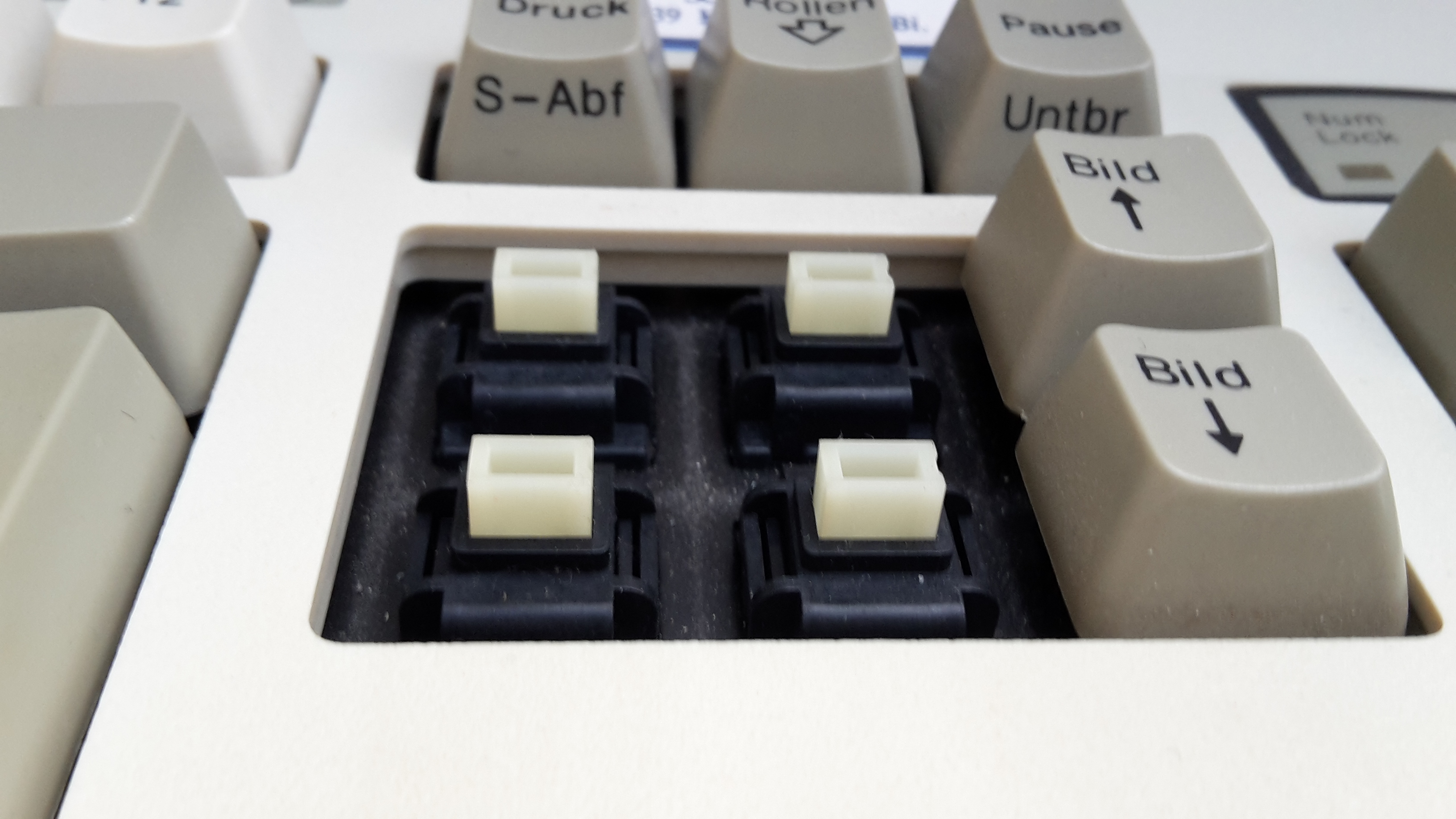

Anyone know what clones these are?
04 Apr 2019, 08:15
Many of those clones are impossible to place unless you can get a good view of the insides.

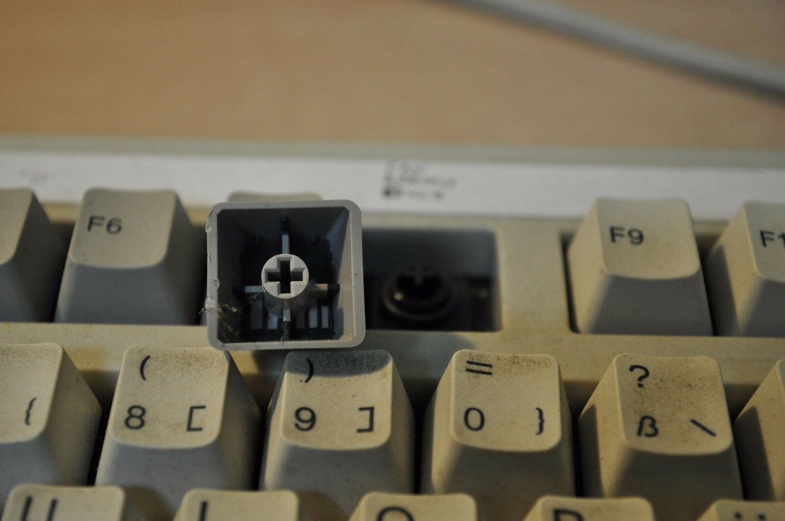

Today I have received a Datacomp DFK 192 from a fellow deskthority member. I am a little bit uncertain about the switches. I assume they are SMK 2nd generation with ALPS mount. But are they tactile white or yellowed clicky blues? They are really loud for a tactile switch, so what is this thing???
08 Apr 2019, 20:07
Looks like tactile whites. The blues turn greenish when yellowed.
Noobmaen
08 Apr 2019, 20:09
I am the previous owner of the datacomp, they certainly feel like normal blue SMK switches to me. I've seen apaprently unpigmented ones like this in another DFK 192 before.

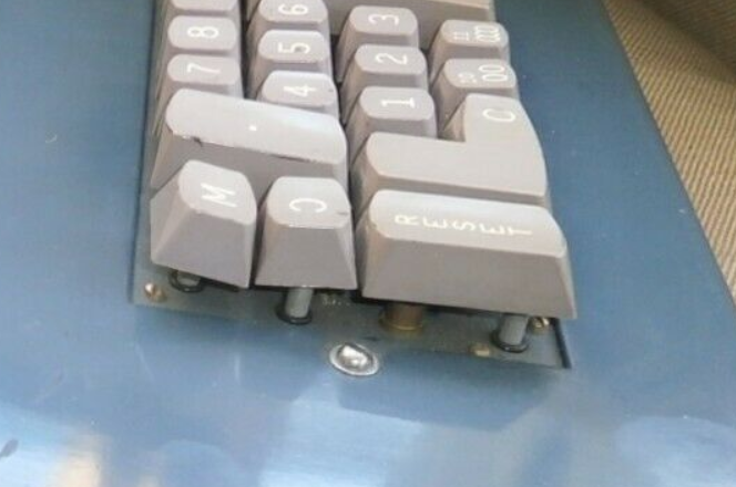

03 May 2019, 19:39
Found an old numerical keyboard from what looks like the 60's on ebay. Sorry for the low quality image:
What could the switches be?
HaaTa
Master Kiibohd Hunter
05 May 2019, 04:32
Aran.E99 wrote: 03 May 2019, 19:39 Found an old numerical keyboard from what looks like the 60's on ebay. Sorry for the low quality image:
Those look like Honeywell Micro Switch magnetic reed switches. Those were common in the 60s. My guess is that there's a kind of cover over top. The screw positions are correct for those switches.
Aran.E99
05 May 2019, 11:18
I think you're spot on. I'm going to send the seller an offer and hopefully they accept so I can document it. Thanks!
Update: he accepted the offer. I will post lots of images of it soon.

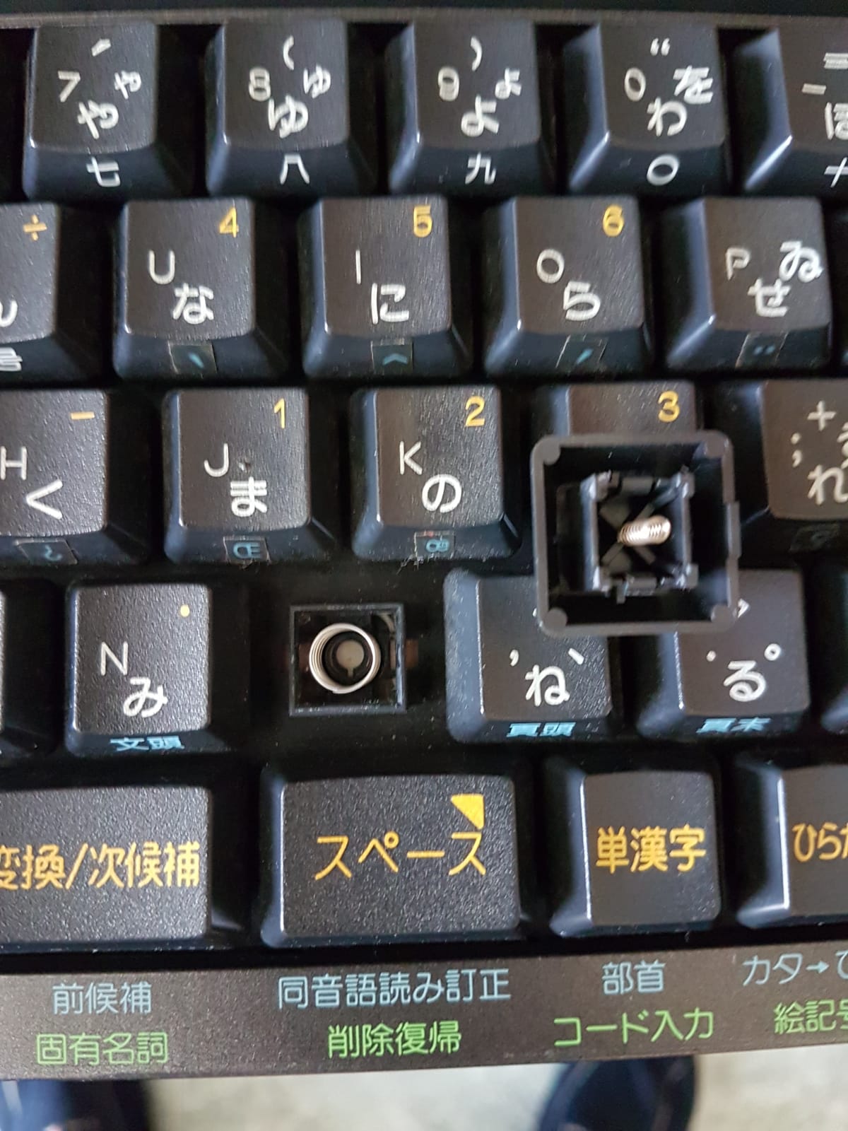

snacksthecat
16 May 2019, 01:20
Sorry if it's obvious -- What is this key switch?
It's linear and very very smooth. When I took the keyboard out of the box and tried it out I assumed it was Fujitsu leaf springs but I thought those were discrete switches. This is a membrane keyboard so now I'm confused.
Top
Bottom
16 May 2019, 08:03
Fujitsu leaf spring 4th gen
