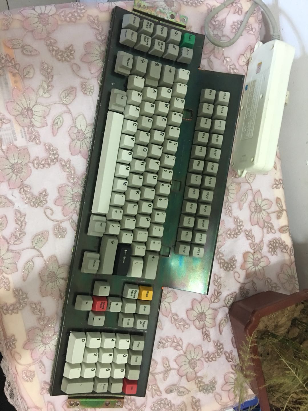

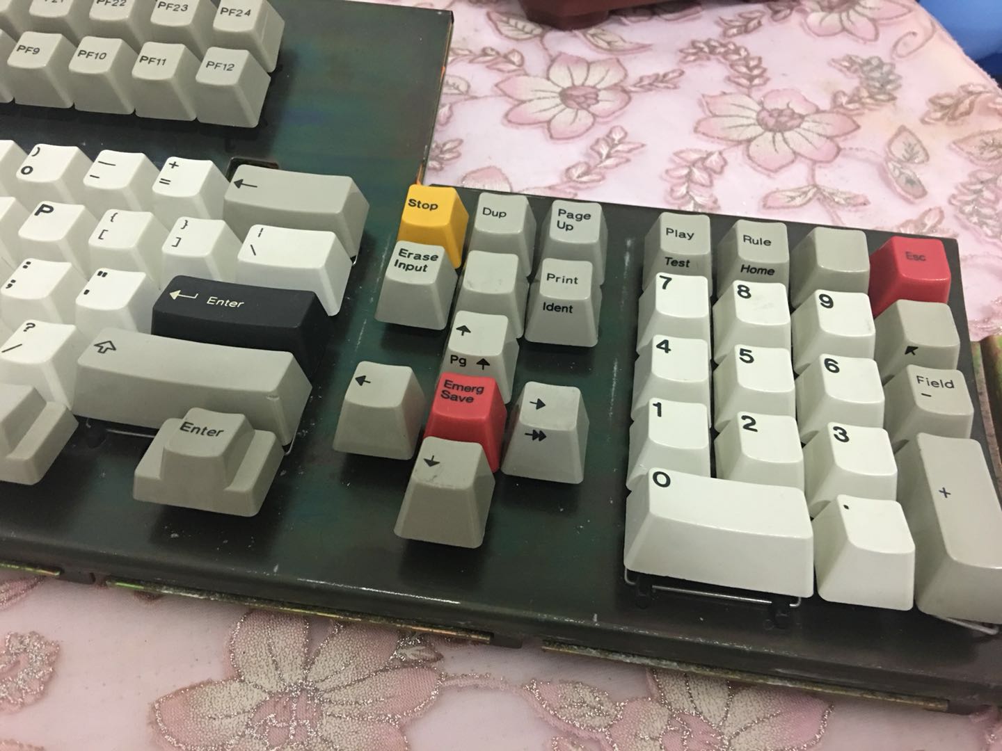

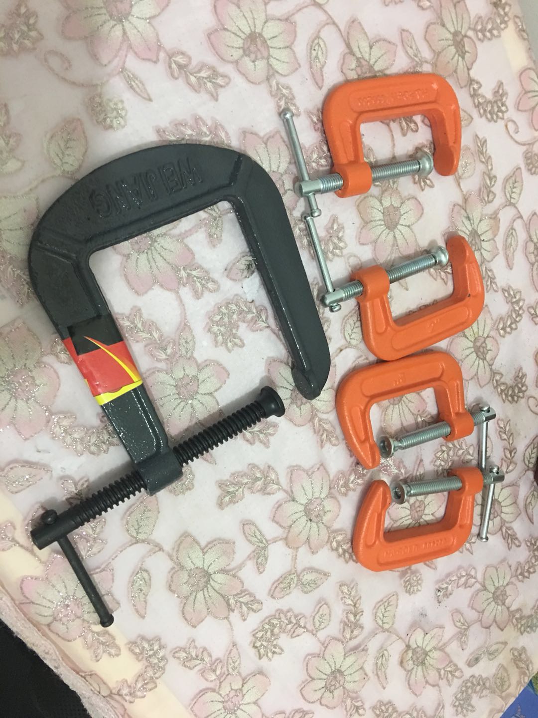

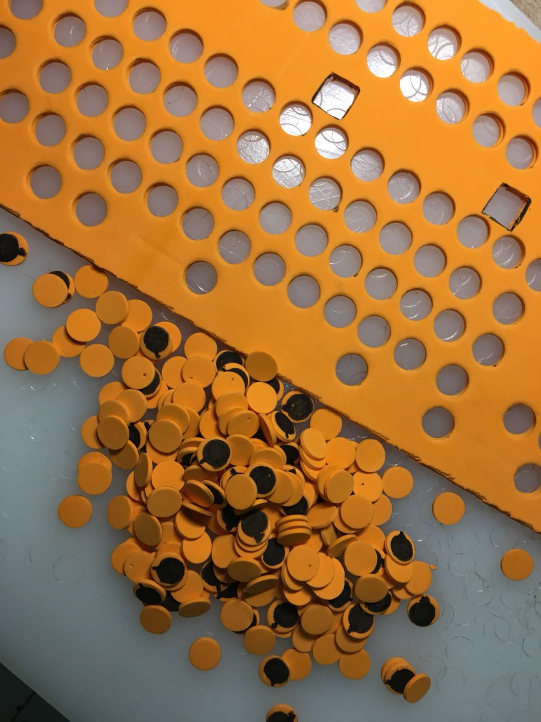

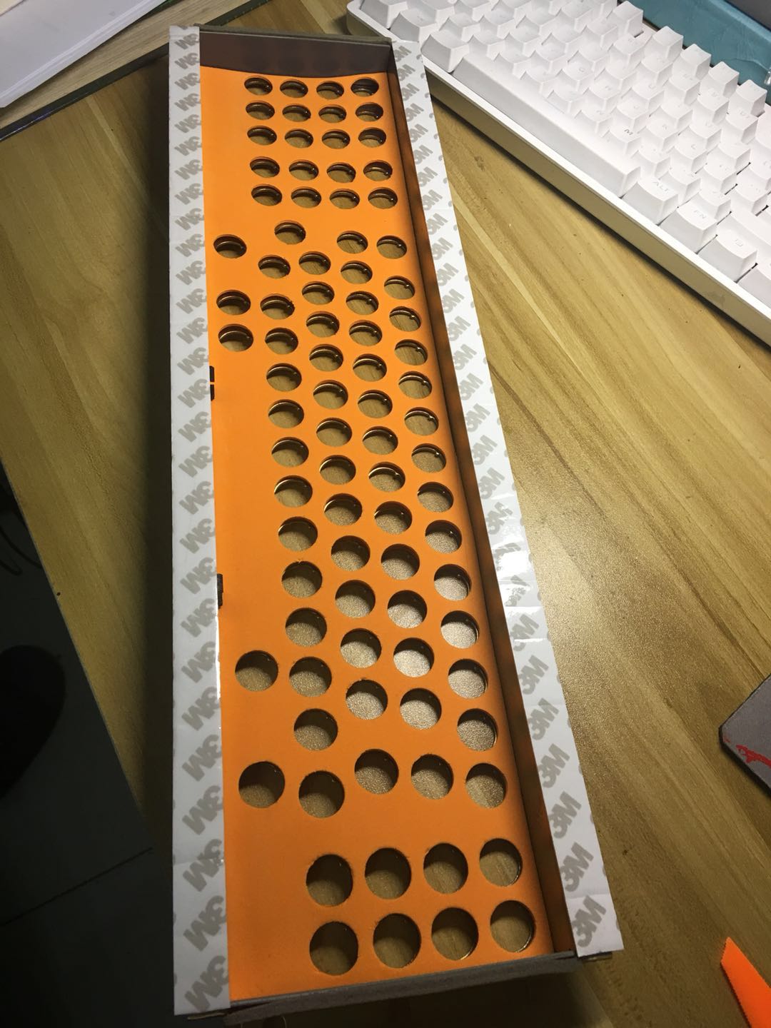

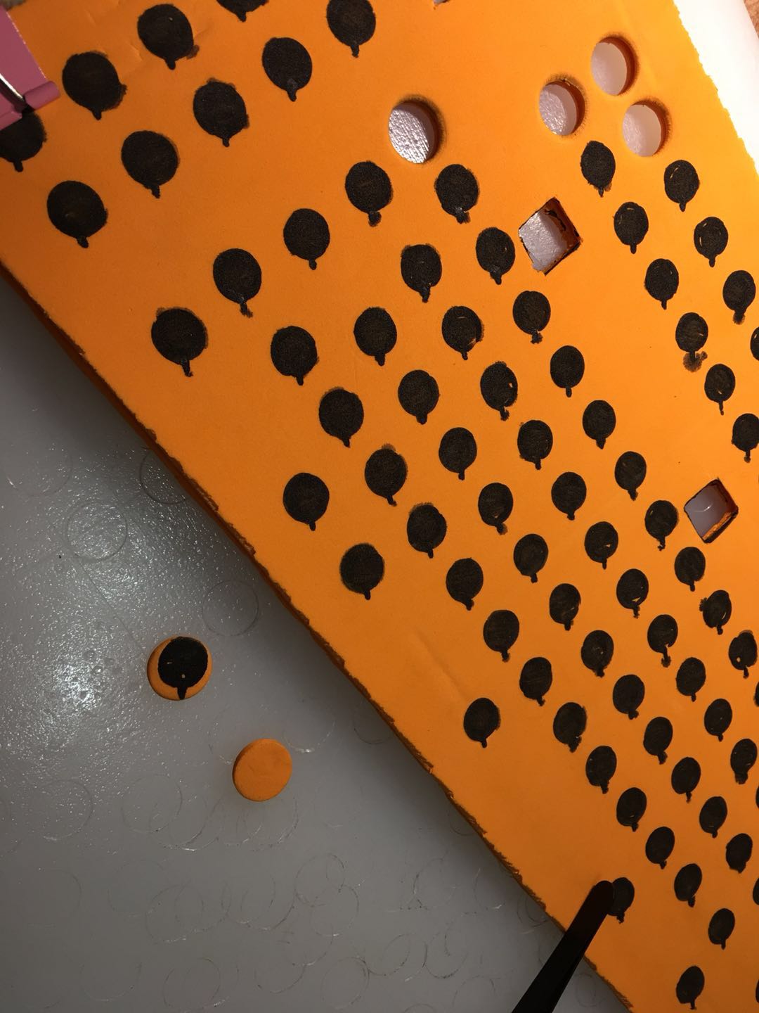

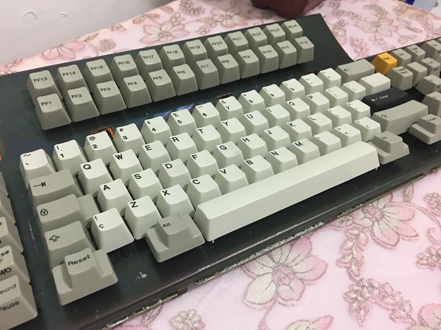

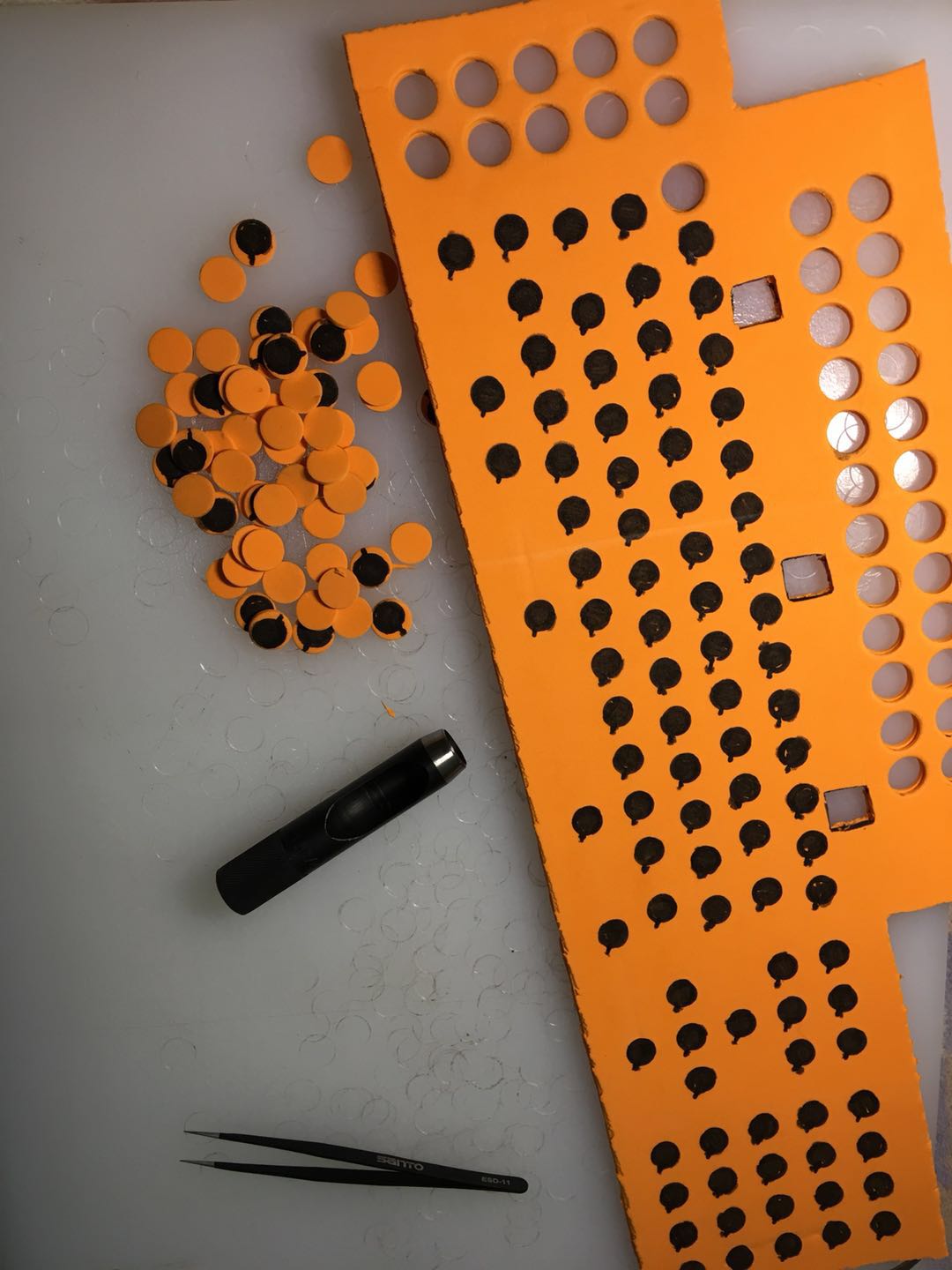

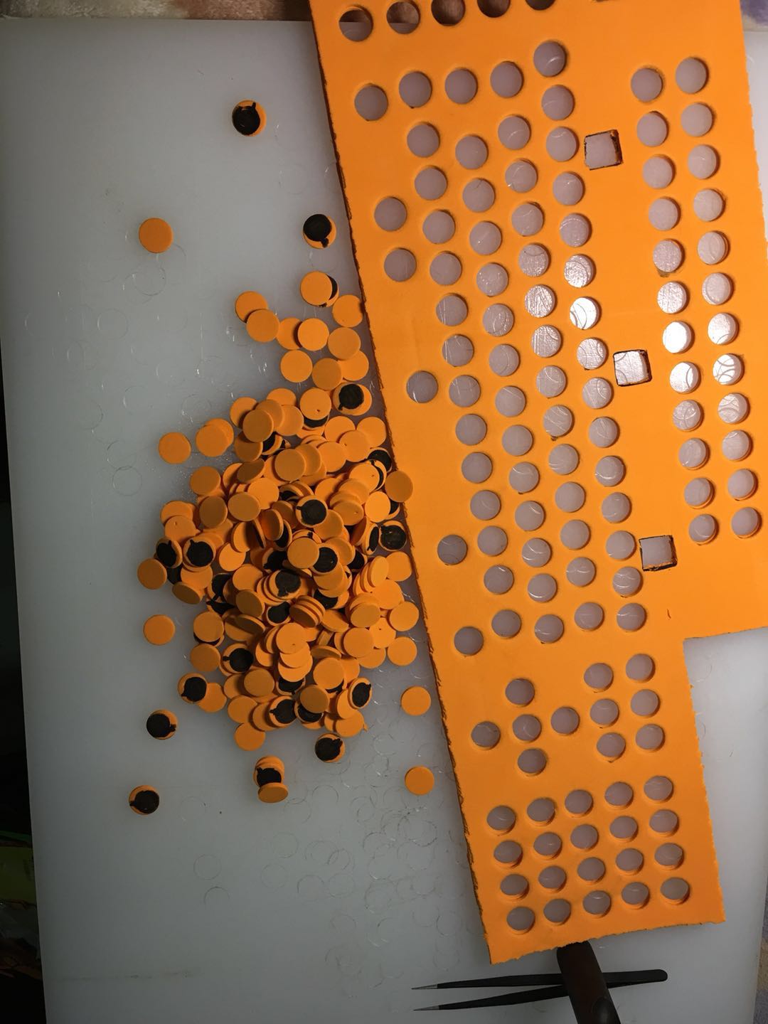

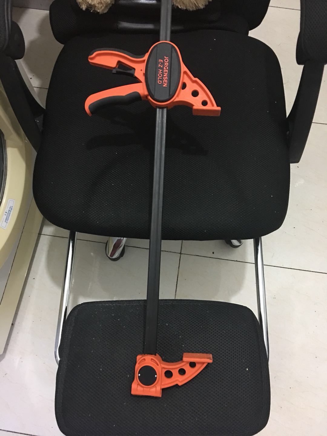

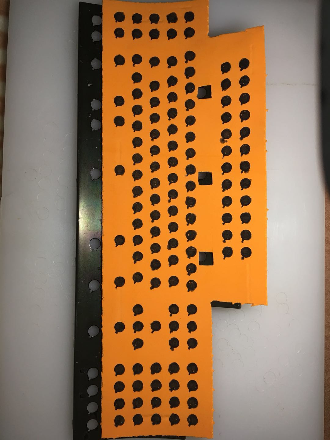

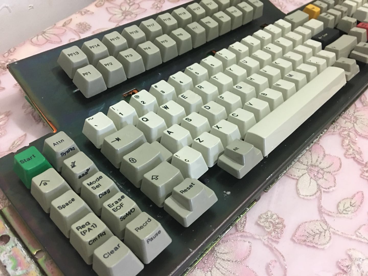

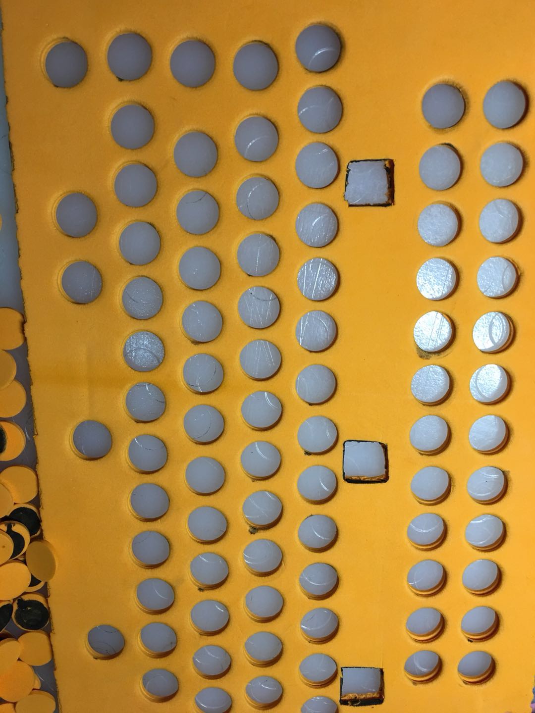

I'm also restoring my new "shit condition" F122 these days. For the foam replacement, I think 2mm EVA is a nice option in any way, its soft and hard, useful and cheap.
Some pics I taken, hope bit help for someone in the future:
15mm-diameter punch really help a lot:
Finally what's it looks like, far away from perfect but typing feeling awesome after whole keyboard reassembled:

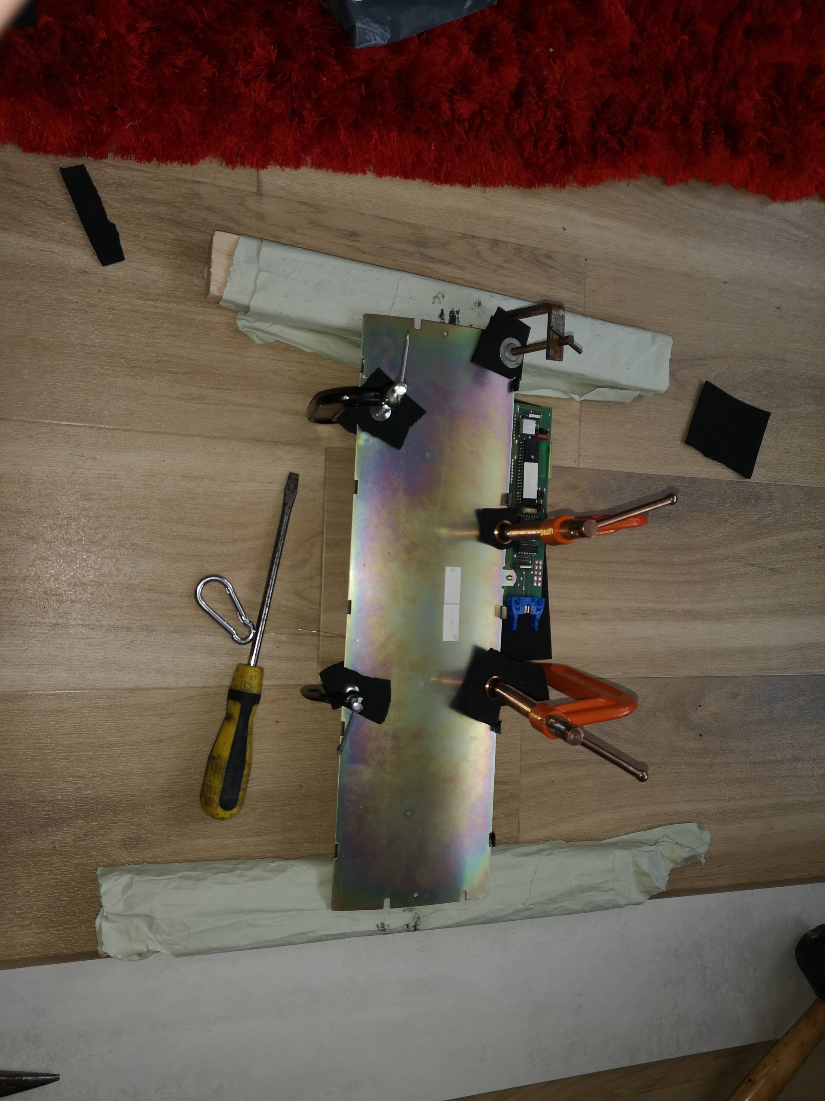

Not really sure what you are doing wrong but if it helps this is how I clamped my keyboard for the reassembly see the attached image
- IMG_20190526_184706.jpg (610.62 KiB) Viewed 7278 times

That's interesting, you use C-clamps. I think I'll buy some of those and give them a try.Fkazim wrote: 29 May 2019, 00:05 Not really sure what you are doing wrong but if it helps this is how I clamped my keyboard for the reassembly see the attached image
- PlacaFromHell
- Location: Argentina
- Main keyboard: IBM 3101
- Favorite switch: Beamspring
You have to be very careful with them, I damaged my plates a bit using C clamps.

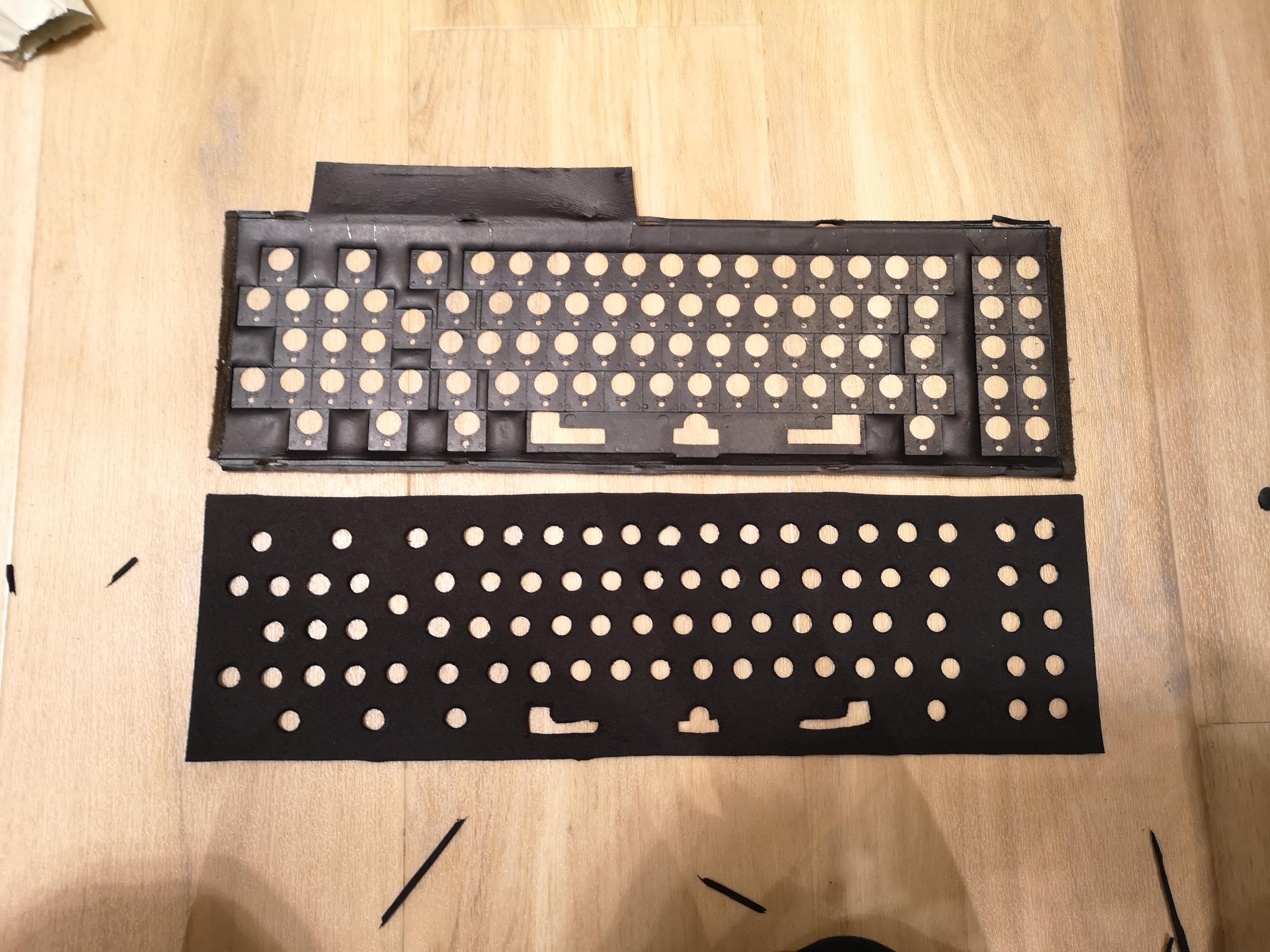

Also here is an image of my Foam all cut out compared to the original top is the original IBM Foam yes NOT disintegrated surprisingly and bottom is my new foam made out of the 3mm neoprene foam.
- IMG_20190523_001310.jpg (820.04 KiB) Viewed 7258 times
- Wazrach
- Location: Tyne and Wear, United Kingdom
- Main mouse: Razer Viper 8KHz/ Viper Mini
- Favorite switch: Buckling springs
Lovely work! Where are the holes for the XT barrel tabs?Fkazim wrote: 29 May 2019, 00:13 Also here is an image of my Foam all cut out compared to the original top is the original IBM Foam yes NOT disintegrated surprisingly and bottom is my new foam made out of the 3mm neoprene foam.

I cut my new foam shorter so it did not interfere with the locking tabs. It really makes no difference in the firmness and the strength of the keyboard assembly.Wazrach wrote: 29 May 2019, 00:17Lovely work! Where are the holes for the XT barrel tabs?Fkazim wrote: 29 May 2019, 00:13 Also here is an image of my Foam all cut out compared to the original top is the original IBM Foam yes NOT disintegrated surprisingly and bottom is my new foam made out of the 3mm neoprene foam.
15mm-diameter punch really help a lot:Spoiler:Finally what's it looks like, far away from perfect but typing feeling awesome after whole keyboard reassembled:Spoiler:Spoiler:I made yet another mat out of the exact stuff Fkazim mentioned, but again, it's far too firm and will not compress near the middle three tabs. Foam companies are still ignoring me when I go to them for soft, 3mm foam. I mean, how hard can it fucking be to get this material? Seriously.
