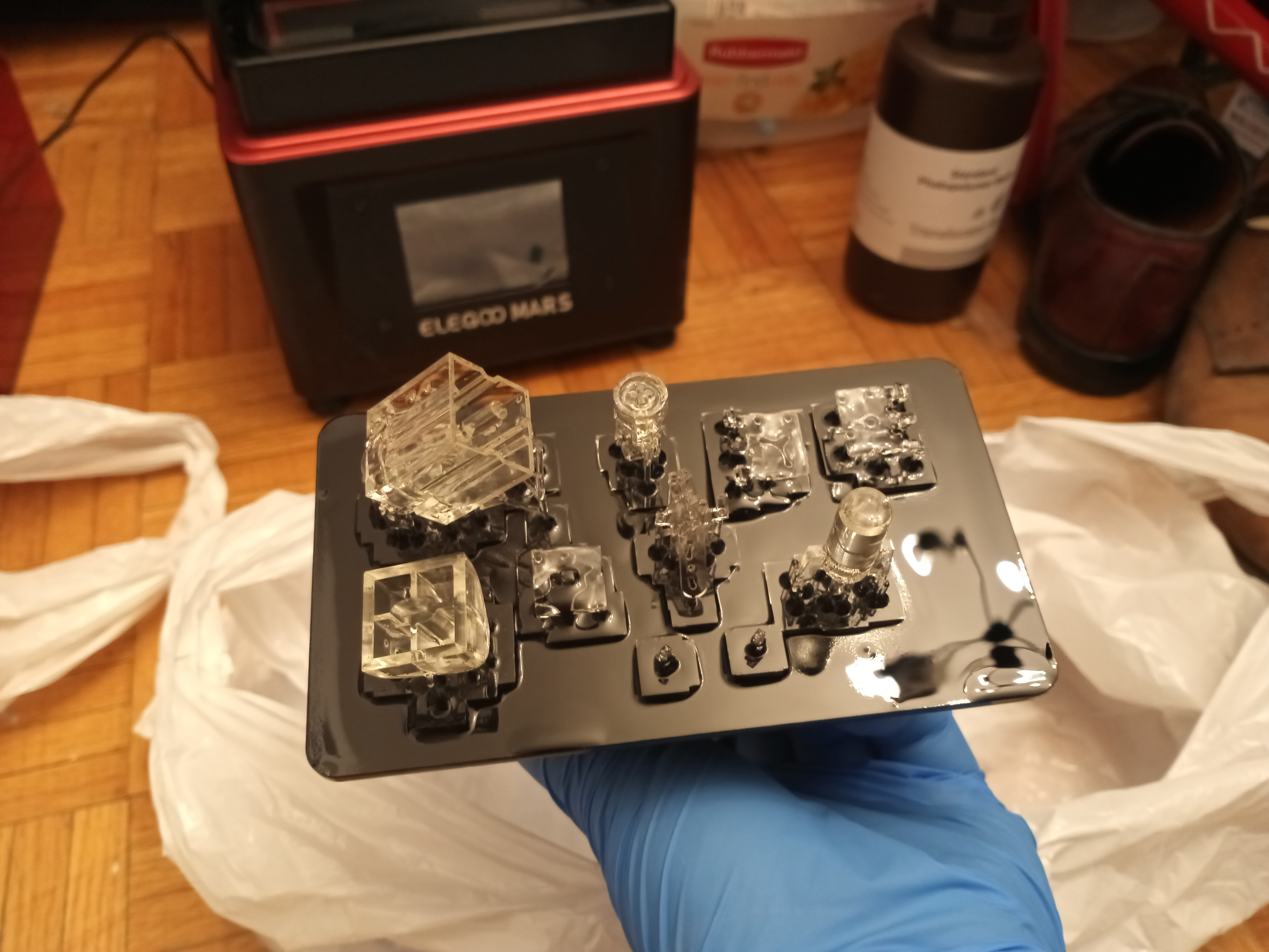

I am printing 1 more set but here is the current production.
I wanted to make keycap so that I can make the board with 100% new pieces.
Happy with how the keycap looks. I think its unrealistic to make the keycap stem in resin as it broke. Will use cnc to make metal ones.
Credit where it's due. I totally used manisteinn's keycap model.
The Cherry mx Slider adaptor works perfectly and is very durable. Very impress.

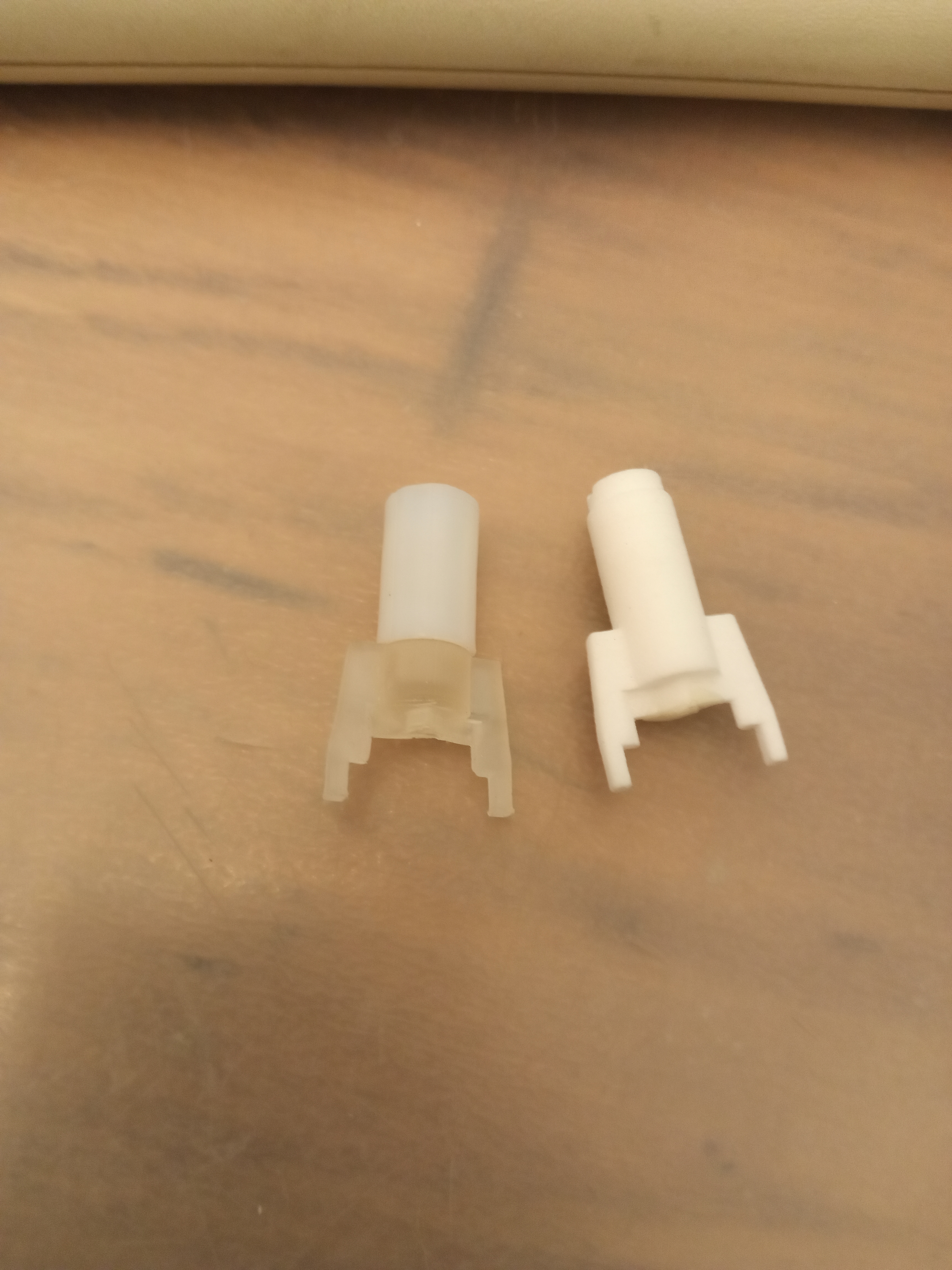

Just to update this is my current beamspring attachment method. A square peg with some glue. I am heavily considering doubling the thickness of my beamsprings. I just cannot seem to get them as hard as the original ones at the original thickness. I need to make the peg part bigger for alignment. The place I got them cut at, metaltronics in Mississauga used the hardest metal they could get and it is still not as hard as the original. So I will likely just go thicker.
I have added some models to my grabcad account.
https://grabcad.com/sneaky.robb-2
I made a new cherry mx slider for the beamspring. The old model was not very good. This one is better.
mx slider.jpg (3.29 MiB) Viewed 15954 times
I got this parallel square hole tool to make the holes if need be by hand in the beamsprings. I also use it for 4x alps project. The cutting method used for the beamsprings has little artefacts.
square hole pliers.jpg (3.35 MiB) Viewed 15954 times
Here are the stems.
For a case I have ordered a model M "silver badge" case. Sort of like this image. When it arrives I will examine how to best integrate the top and bottom. I thought this would be the most amusing way to do that. It doesn't have the badge so I will make a pcb one with some kind of ibm logo.
I would be going for something like this post
viewtopic.php?t=17339
As seen above I have started to make resin keycaps. They are pretty decent so far. Still learning. Printing a black one now.
For the barrels I am almost done with them. They are starting to look extremely close and am very pleased with them. This is mostly a printing issue not a model issue.
compare 1.jpg (2.82 MiB) Viewed 15954 times
I mentioned before that I would get some teflon tube. This never arrived. Randomly after 5 months it did in fact arrive but the supplier sent the wrong size anyway!
This was what I wanted to do. TBH it actually is ultra smooth and I still want to buy some teflon tube for this purpose.
The idea being the tube forms the surface where the slider and barrel interact. It is just slightly too wide.
teflon tube applied.jpg (3.39 MiB) Viewed 15954 times

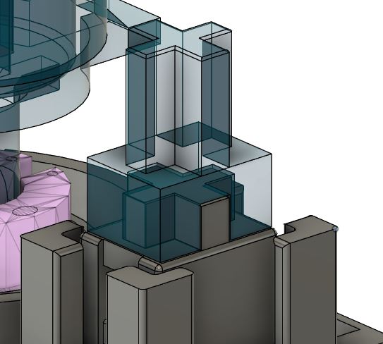

by SneakyRobb
For the stabs I found they do in fact sit too low. This is only really a large issue for the space bar. What im going to do is either make a new stab vertical, or shave off an existing one and glue a hat ontop of it. I think the hat method will be easier.
Left side has a taller cross which I am not sure I could make easily.
stabs 1.jpg (53.21 KiB) Viewed 15692 times
Right side I would shave down the existing cross, make an extension piece that glues on top. This seems easier so that's what Ill try
stab hat.jpg (35.93 KiB) Viewed 15692 times

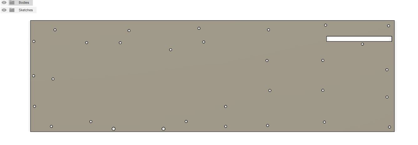

I forgot to include a jumper wire relief area. This is causing the entire board to short.
Here is where you can see the flex
and here is where I should have added a cutout.
bottom plate og.JPG (33.8 KiB) Viewed 15554 times
bottom plate.JPG (29.88 KiB) Viewed 15554 times
Basically right now the leads from the jumpers are pressing onto the bottom steel plate causing shorts. I will need to saw or dremel a channel for them to go without interference. STILL. I want to finish this very very soon.
Robb
