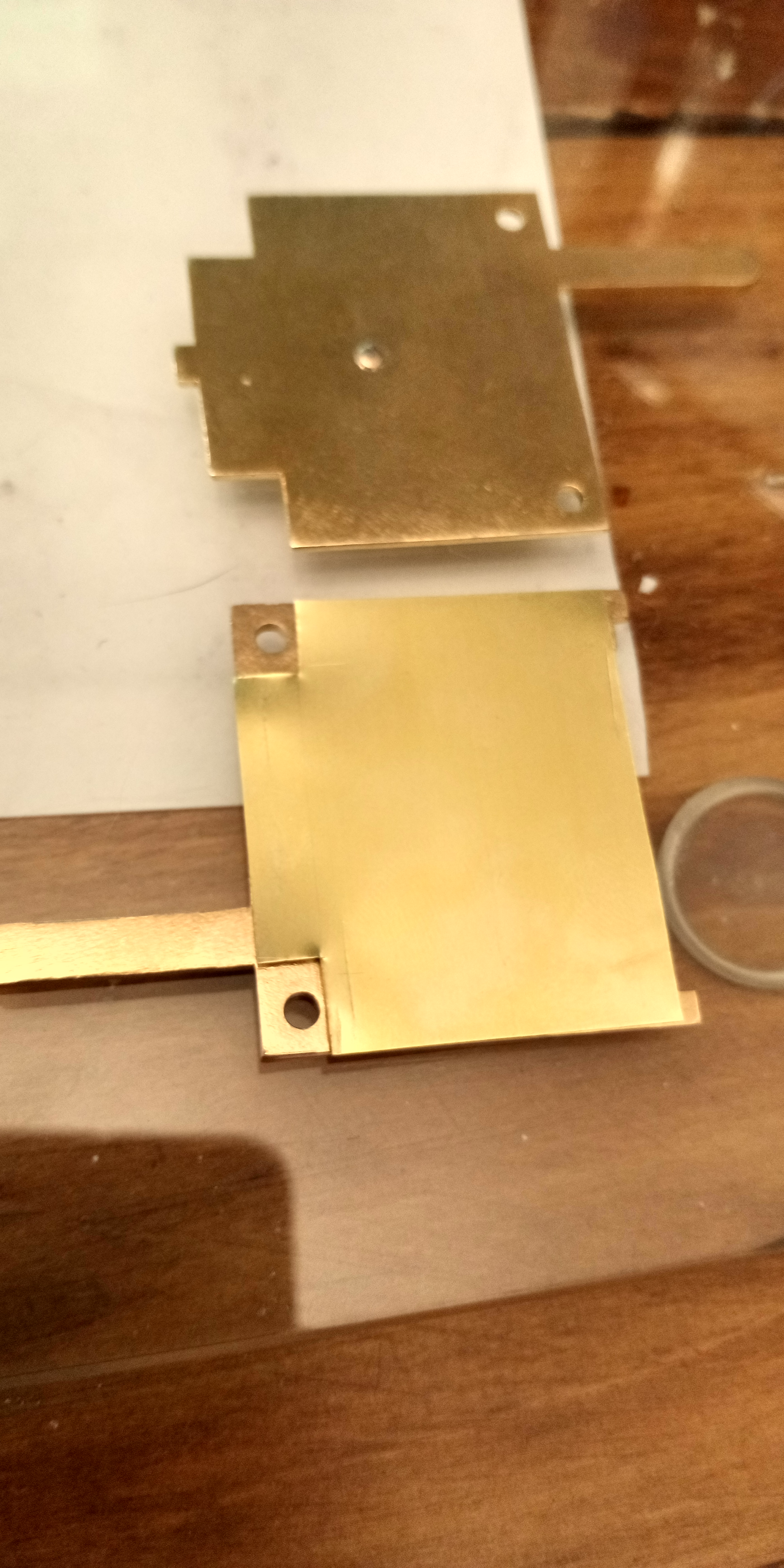

I will try to glue this foil piece now.
I will also remake the switch plate plastic frame so its easier to disassemble.
I also wonder why the insulator piece is asymmetrical. Why is this? There must be a reason. I will think on this.

By "insulator" you mean the little dot on the full piece? Indeed it is assymetric. On the big printed piece, it is centered between the side on the top and the side on the bottom of the small rectangle extension.
On the original piece, though, the dot is instead on the center between the side on the top and the side of the lower part that has the two cuts, excluding the small rectangle completely.
And what do you mean exactly that the lower part is mirrored? I can't see it.

How is the project going? Quite interested tbhSneakyRobb wrote: 11 May 2020, 00:46 Hi,
I have seen some attempts at making new skcm blue alps switches. I wish for more attempts. With the recent lubricant discussion I wondered how we could make a new skcm blue alps switch. Not switches... just 1 switch.

I made an account just for this thread. I have a few suggestions.
- Why not just solder the foil onto the leaf? A little bit of flux and that baby would be solid.
- Have you considered vapor smoothing? Could improve the smoothness quite a bit, although the new slider looks wayyyy smoother.
- Also, you could use some lube of some sort, I actually think wax, much like the current alps meta dictates, would work very well. It would fill in all of those printing ridges to form a nice, smooth surface along the rails of the slider.
