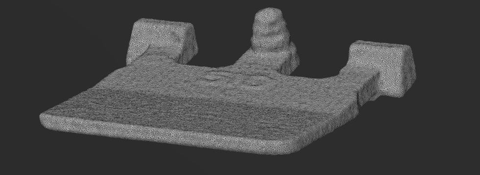

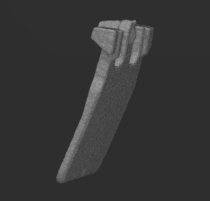

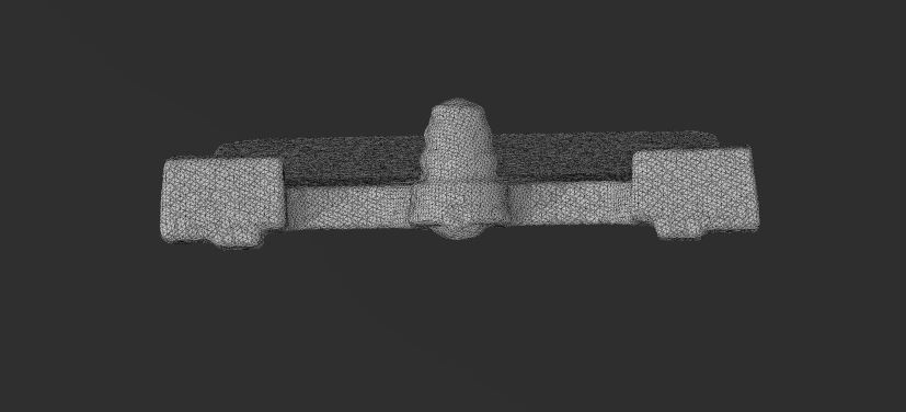

HI,
Here is 3D laser scan file. It cost a few many dollars to have made, but I am here to share.
It's a bit bumpy! This provides a good comparison point to further refine the previously shared model f model. Or maybe for you to make your own file for production. Using calipers and visual is only so good for making a 3d model of model f flipper. The working surfaces are small and need to be precise. I can now import this to cad software to try to fix the existing model. You can do this as well reader.

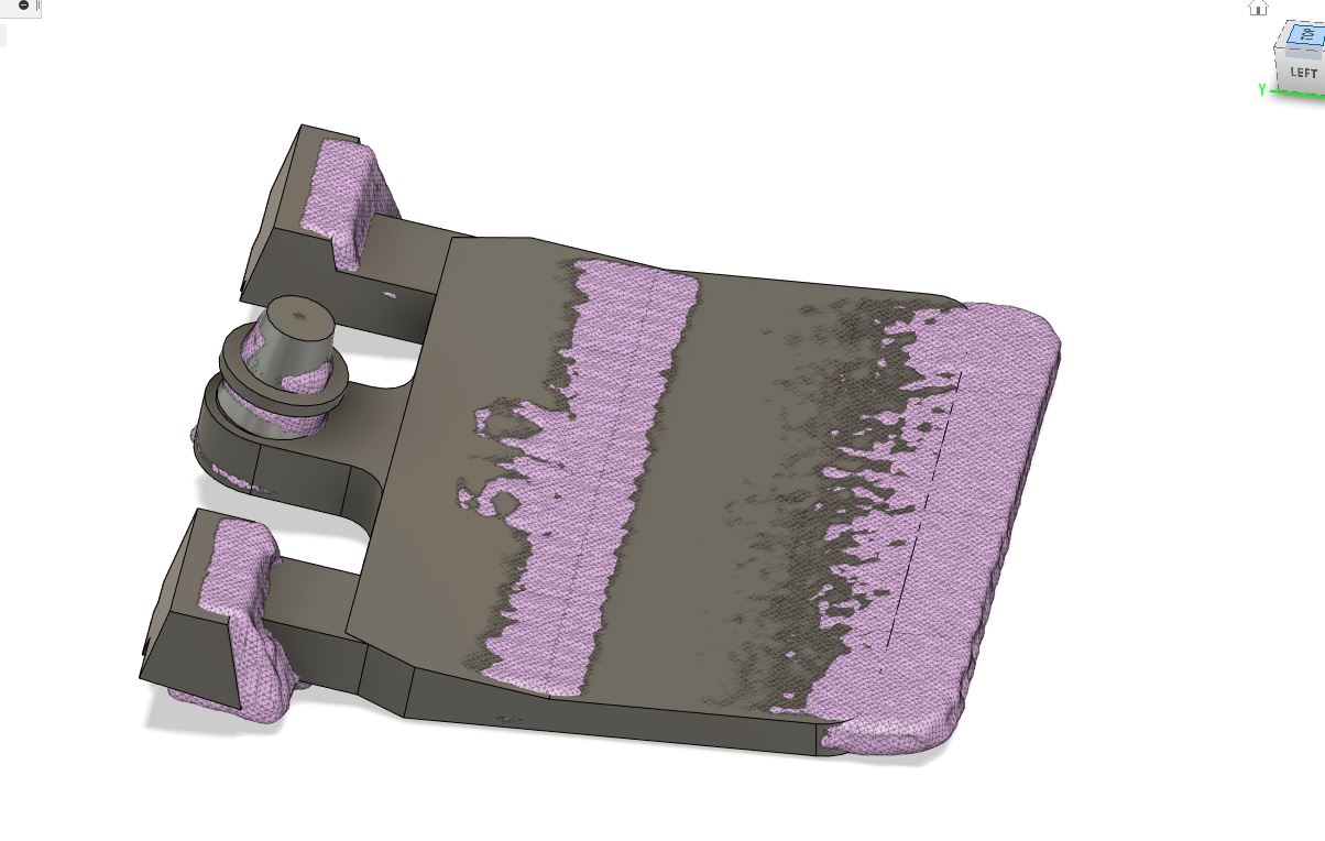

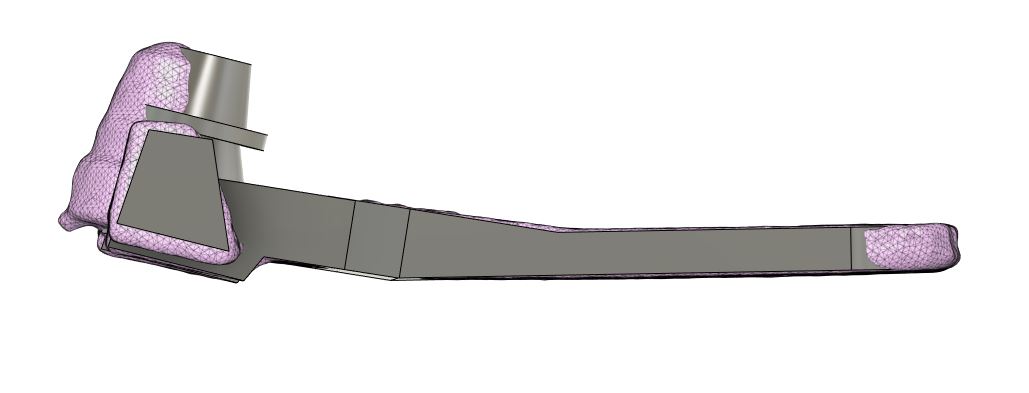

27 Mar 2021, 22:08
Hi,

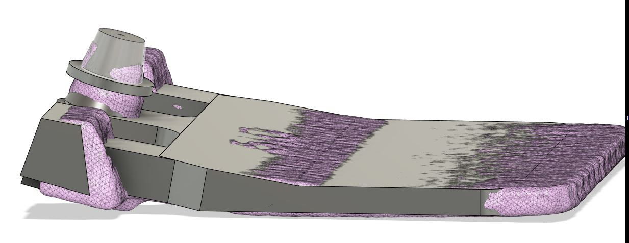

Here is my preliminary comparison from my previous CAD model to the 3d laser scan of the XT flipper.
You can see how the pivot points in particular didn't align. This is a great tool to use to compare!!
As well the ears on my model are actually a bit further back. My model worked functionally, but felt a bit weird. Now I can see why
flapper pivot.JPG (73.16 KiB) Viewed 2550 times
flapper c.JPG (138.15 KiB) Viewed 2550 times
flapper b.JPG (92.34 KiB) Viewed 2550 times

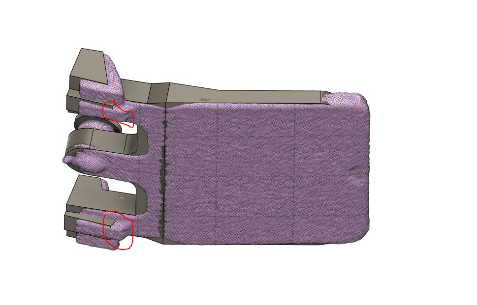

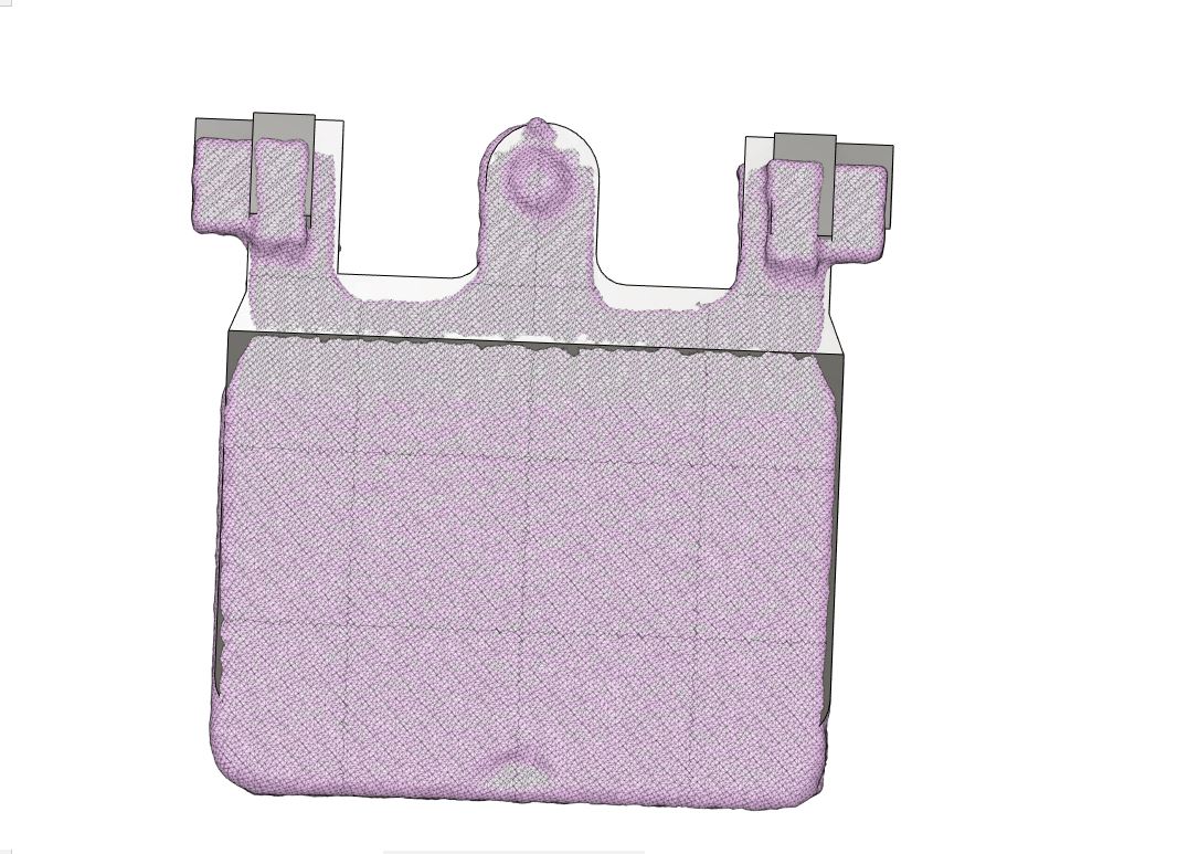

SneakyRobb
THINK
27 Mar 2021, 22:14
As well if I try to align those pivot points, other areas are not aligned!
flapper try to align.JPG (29.95 KiB) Viewed 2545 times
