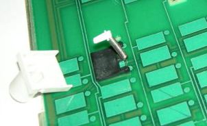

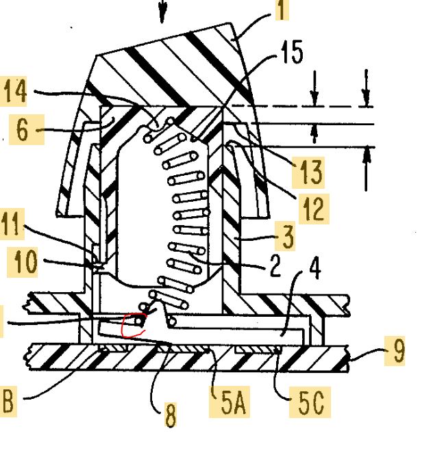

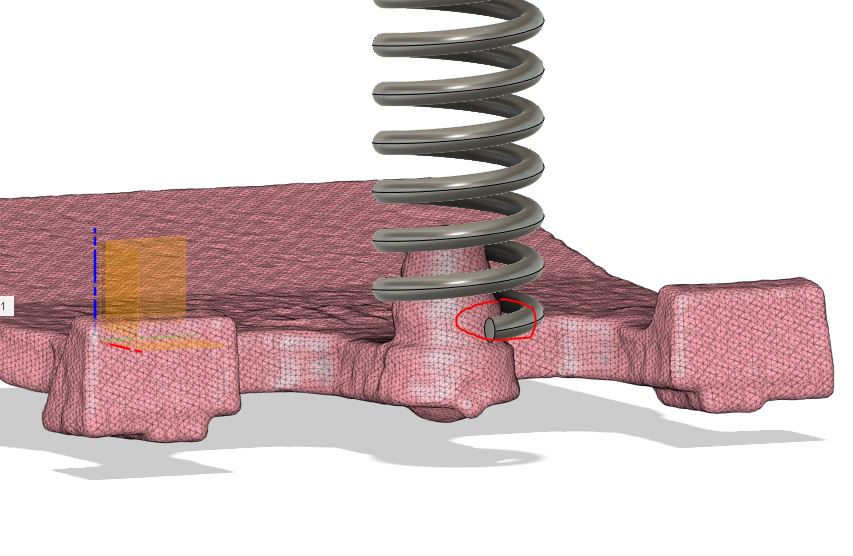

The way people in production handled this was to use a toothpick or other cylinder object, put the spring into position and push it down from the side.SneakyRobb wrote: 04 Jun 2021, 22:07 21.
Was there an official IBM method of reattaching a buckling spring that fell out of the module. People now often use a chopstick to press it on. How would you have restuck a spring that came off while the board was assembled?
He was not sure how long they kept doing it, but the original way to attach the spring correctly that quality control actually looked at was where the top of the spring was oriented to the back on the flipper. I made a quick image to show what that means. It might not be intentional but the patent drawing also shows it.
The spring is not ground flat, so it has a slight angle to it where it runs out, so the part where it ends should be at the back. If the spring is installed in a different orientation it would very very slightly alter the actuation. Although likely not noticeable. Not sure how necessary that really was, but that's what he told me they did for at least some time. Maybe someone with an early XT they are taking apart can check.
- back of spring on patent.JPG (83.08 KiB) Viewed 13245 times
- flipper spring orientation.JPG (73.81 KiB) Viewed 13245 times

Hey Dick,
I have two more questions:
1) Do you happen to know what the purpose of those two floating tiny dots/circles was above the Model F pad card footprint, as shown here? I would guess that they are there for mechanical reasons, perhaps to lift up the flipper pivot point to the same height as the sense copper area, or maybe to ease the pivoting action of the flipper by providing a smoother contact surface with some PCB technology of the time. There have been other non-mechanical guesses too by others. The soviet clone model F had what looks like even bigger circles: 2) You mentioned before when speaking about Model F keyboards that they are "buckling spring with unconstrained end condition".
Could you clarify what you mean by that? And perhaps what would a constrained end condition buckling spring look like? Wouldn't the way the buckling spring hits the wall of the barrel when it buckles be considered a constrained condition? Maybe I'm just misunderstanding what you're referring to.

"1) You are correct. The dots do maintain the relationship of the pivot point and the capacitive sensing surfaces. They eliminate the effects of any variations in copper thickness. The capacitive sensing signal is generally proportional to 1/d where d is the thickness of the gap between the pivot plate (flipper) and the copper surface. With very small gaps signal differences can vary significantly with gap changes. This makes the design very sensitive to dust, particulate contamination and part tolerances that effect this gap. This was likely the main exposure that lead to Keyboard M.
2) Actually the buckling spring is already buckled slightly when the key-stem is assembled. This buckle is the result of the slope of the surface that the top of the spring rests against, and the fact that the spring is rotated before it is pressed onto the flipper so that the spring wire end is oriented at the back (away from the pivot point of the flipper). We discussed this last week. The spring is partially unconstrained at the top to allow the top of the spring to rotate around the front of the top coil. The lower end of the spring is constrained in relation to the flipper, but the flipper is unconstrained just enough to allow the flipper to rotate against the circuit board (capacitor plates). So actually the snap doesn't occur when the spring buckles. It occurs when the force center through the lateral most deflection of the already buckled spring moves across the pivot point of the flipper. To control the key travel required for the system to snap, it is important that the spring is free from any frictional forces caused by rubbing against wall of the barrel. After the snap, it doesn't matter if there is slight friction from the walls of the barrel as long as the spring is free when the key moves upward causing the force center of the spring to move back across the flipper pivot point and resets the key signal. Hope this makes sense.
Just for clarity, the only totally unconstrained spring would be one that is flying slowly through the air. A totally constrained spring would be one that has both ends pressed on a post similar to the post on the flipper, be in some amount of compression and be in a cylinder the diameter of the OD of the spring. Maybe there is still some degree of freedom that isn't constrained here, but you get the idea."
