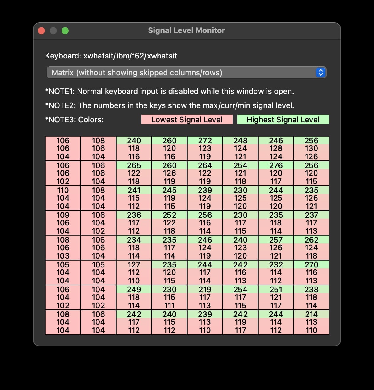

Capsense is inherently analogue. Try watching the live signal numbers dancing in Pandrew's capsense QMK!
