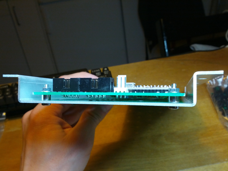

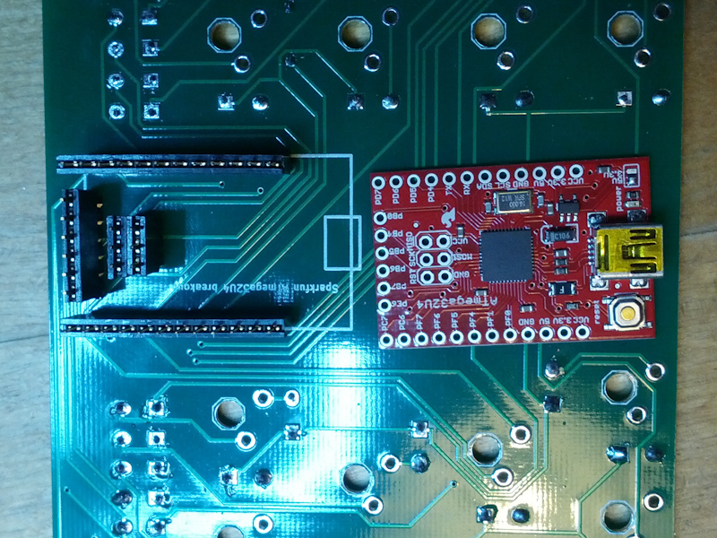

Assembly instructions
Here is some assembly tips, I'm jumping a lot of steps and describe mostly parts that are not obvious.
Just ask if there is any questions :-D

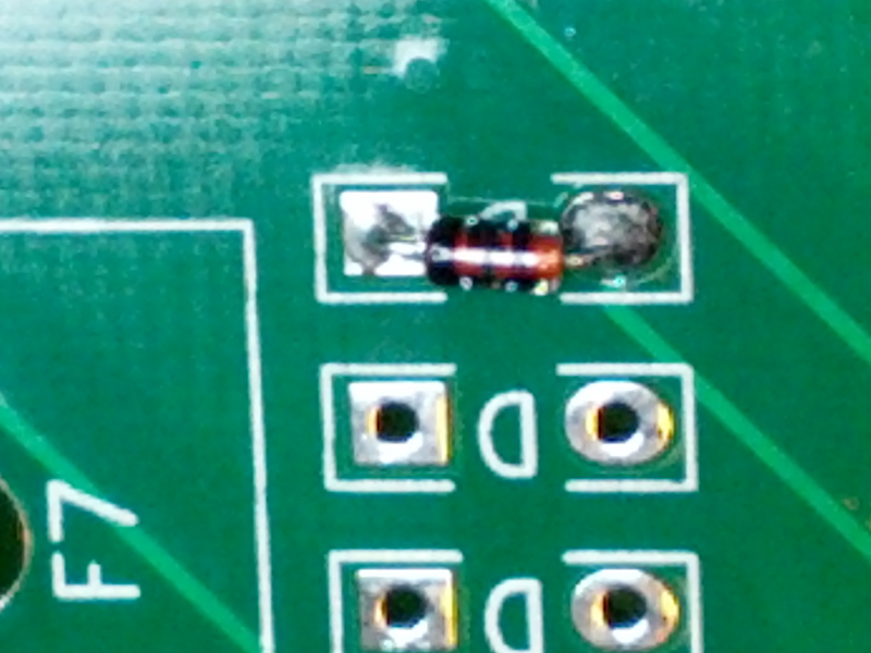

- Solder all diodes, direct the side of the diode with the strip towards the square soldering pad
- Solder resistor for led

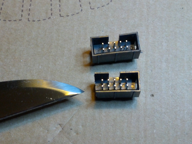

- Solder Contacts, one of the joystick sockets needs to be modified (PCB design mistake)

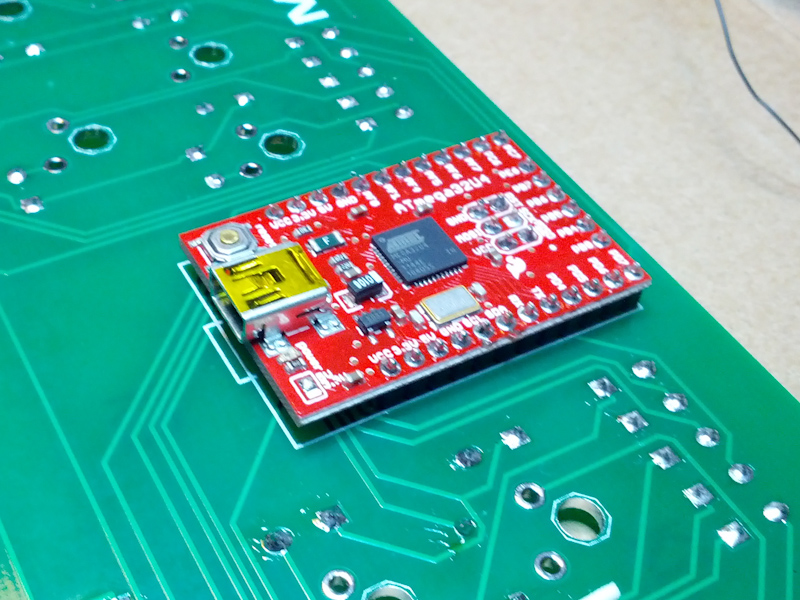

-Solder controller board or headers for it depending on if it should be removable.
not removable:
Put controller board and headers on PCB before you start to solder to get everything aligned.
removable:
-Bolt the PCB to the mounting plate
-Put in the switches and solder them
Get the key caps on
-Gently open you C64, be careful not to break the plastic hocks holding it together in the back.
-Unscrew the old keyboard from the top part of the case and take it out.
-Pull off all the key caps with a Filco style key puller, space bar has got stabilizers so be careful not to break it , take it of last so you have more space.
-Put on new stabilizers for space and return on the MeC64 if it's not already there.
-Clean the hole in the adapter from plastic dust by scraping with something like a small screwdriver and knock it against the table to get it out.

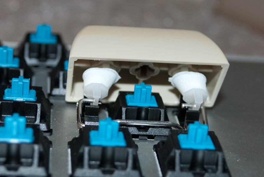

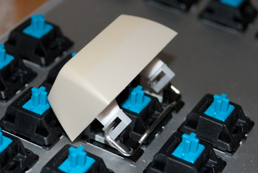

- Put the adapter in the switch and the key cap on the adapter and use the cap to push the adapter all the way down over the switch. If you can't get it all the way down you need to take it off again and clean out some more plastic dust. Put on the space and return pretty early as they are the most fiddly to get on and need space around them to do it. There are support legs for the 1,5u keys(shift, control...), just put them in the unused hole of the key cap.
Pictures of how the adapters for the return (and space) should be positioned. (the stabilizer thingy should stick out towards the back of the keybaord)
-Put the keyboard into the case. If you are using USB, connect the power led board. If your using the C64 main board, connect the adapter cable, the first pin of the IDC contact (marked with an arrow) goes on the first pin of the header (the one closest the the front).
-Make sure that the back of the keyboard does not come in contact with other electronics on for instance the main board and cause a short circuit! The original C64 has paper that shields it, put that or something else between the keyboard and other stuff to isolate it.
Post some picture of your board/setup when your done, I would really appreciate that!

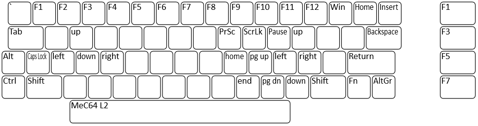

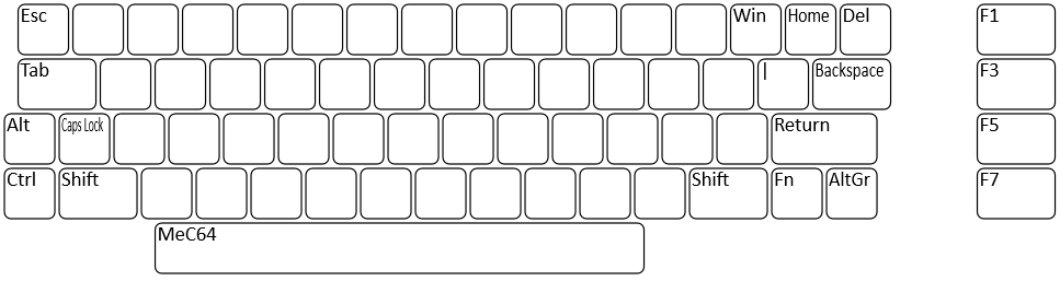

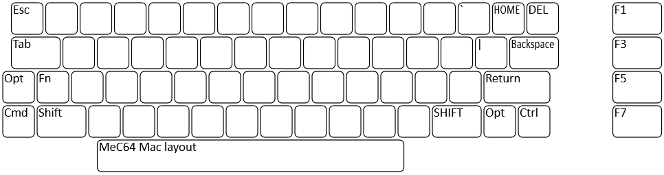

This is the Layouts I have implemented now. (Plus CeeSA's layout)
Standard layout:
MeC64 layout.png (11.79 KiB) Viewed 12747 times
Standard L2
MeC64 layout L2.png (16.16 KiB) Viewed 12747 times

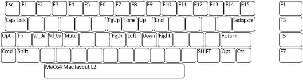

For Mac
Mac L2
Mac L2.png (16.18 KiB) Viewed 12747 times

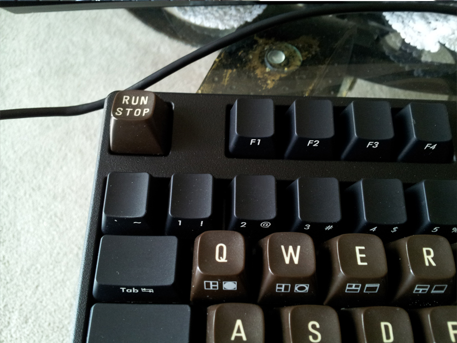

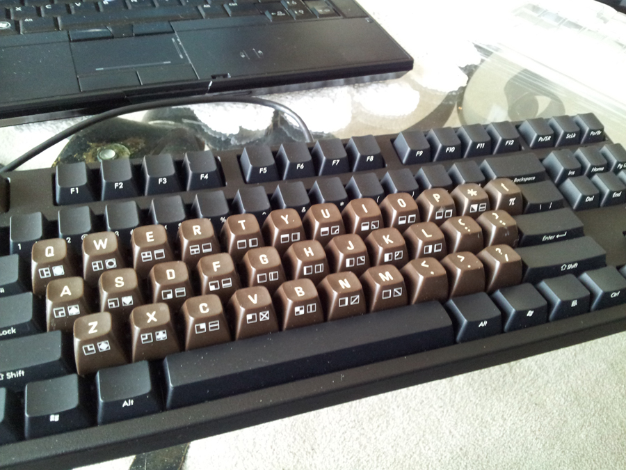

Got my keycap adapters from Shapeways. I decided it would look best if I just fill out the QWERTY area and leave the modifiers alone; I might add the numbers later.
I wanted to use the Commodore logo key as my ESC, but its profile makes it look too weird; so I used the RUN/STOP key, which I think has a great vintage computer appeal.

Turned out OK I think, doesn't look to crazy and the escape looks good. How is it to type on?
GordonZed
16 Mar 2013, 18:49
Not bad, I've been using it for about a day now. My fingers can definitely tell that the profile is off, but I love the feel of the C64 keys. It's weird for shortcuts, like CTRL+C etc, but I'm thinking of adding some modifiers, just not sure how yet.
