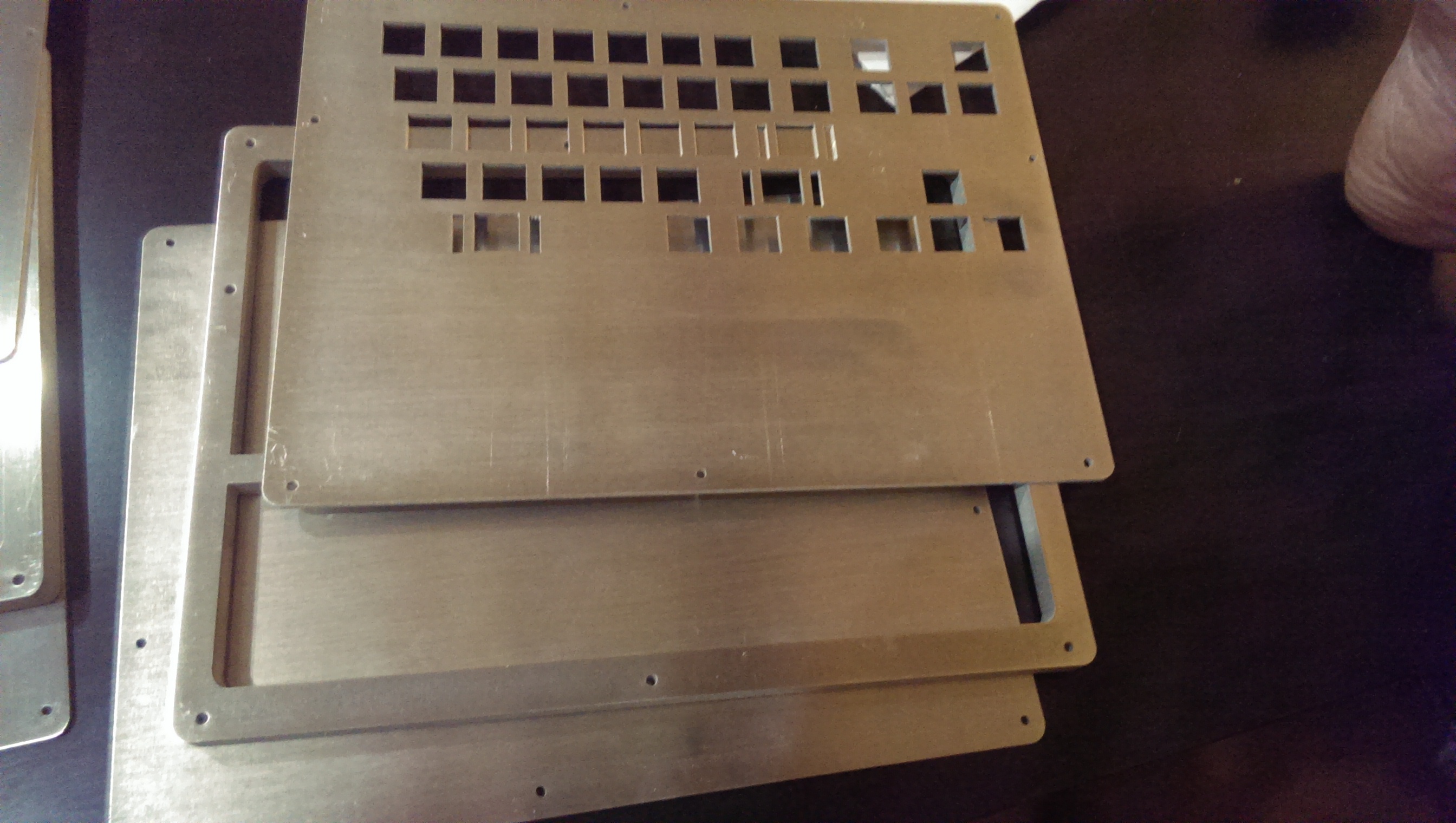

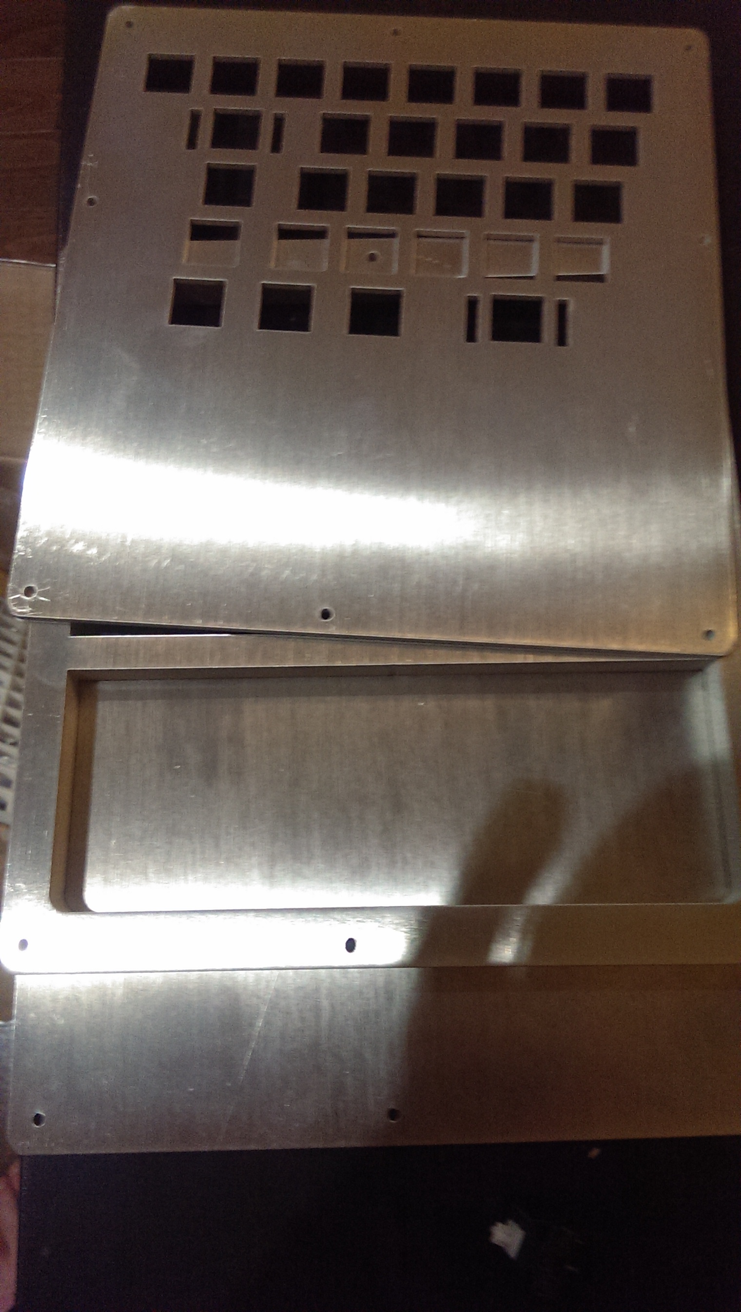

pjmelon
16 Dec 2013, 04:15
Well I finally got the keyboard plates.
Everything lines up correctly which is great. Impressed with the quality of the work. First thing is to lightly polish the aluminium and get it ready for the switches. Will start work over the Christmas break.
2013-12-15 19.23.17.jpg (896.83 KiB) Viewed 12977 times
2013-12-15 19.23.10.jpg (949.73 KiB) Viewed 12977 times

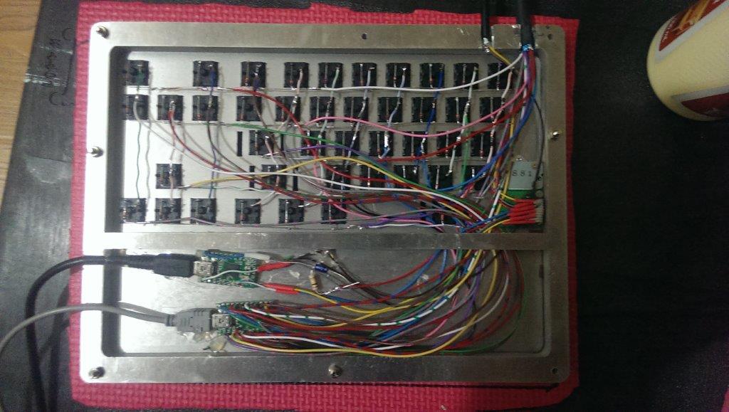

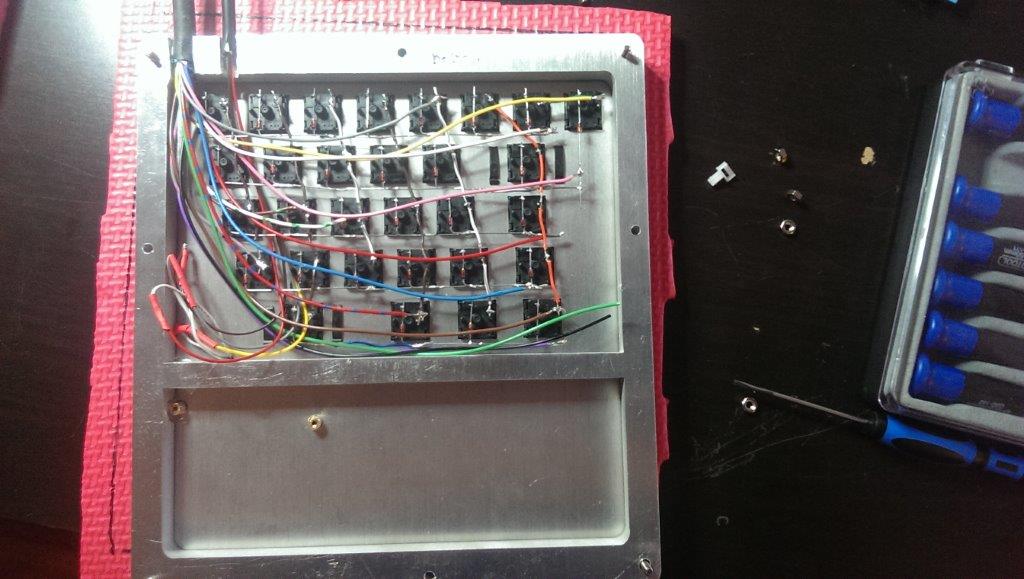

pjmelon
03 Feb 2014, 04:49
Well the end is nigh. Spent the last two days working solid on it. The trackpoint is wired and works well although will play around with mtl's fork when I get some time. Wired in the keyboard and working on firmware now. Got most of it figured out with only a few errors in my make. Ill sleep on it and recheck my keymaps as that is where the error is.
2014-02-02 16.34.47.jpg (96.53 KiB) Viewed 12726 times
2014-02-02 16.09.24.jpg (92.47 KiB) Viewed 12726 times

Plugged the keyboard in have a problem that every time I hit a button all of the keys in that column are typed. It seems consistent on every single row.
pjmelon
04 Feb 2014, 04:45
Actually the more I look at it the more random it feels.
ماء
04 Feb 2014, 08:31
pjmelon wrote:Actually the more I look at it the more random it feels.
pjmelon,how to feel you type on DSA than DCS on staggering :)
though i think DSA would good on Columnar sgg
BTW:Hasu uses ava,i never see before :P
pjmelon
04 Feb 2014, 17:15
The random feel that I was referring to was the output of the keys when I press the buttons. When I first got the keyboard made I put all the switches and keys on and found it quite nice to type on.
I am going to check tonight for short circuits to make sure that I have everything wired correctly. I think my problem may be in the code as well so will have another look tonight at that as well. Always frustrating trying to troubleshoot. Given that it has taken 6 months to get this far I am a little impatient and excited to finish up the project.
