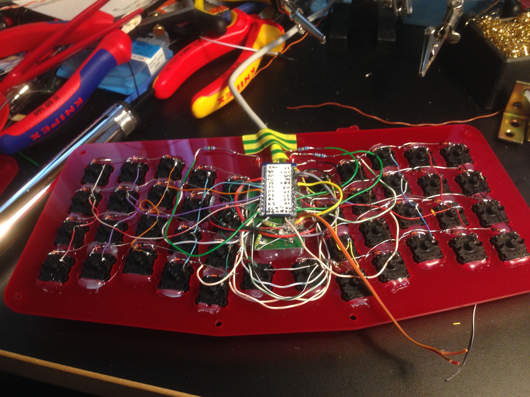

If you need more than the 18 pins available, you can get two more by repurposing the onboard LED pins.
I just did an Atreus build with a Pro Micro clone and was exactly two pins short. I needed 15 pins for the matrix, 2 for the Trackpoint and 3 for indicator LEDs, totalling 20. So I desoldered the RX/TX LEDs and soldered wires to the end of the current limiting resistor connected to the controller.
There's also a reset button, so every pin except RAW on that little thing is connected to something.
