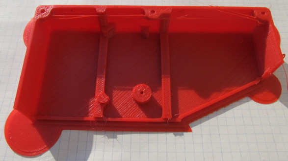

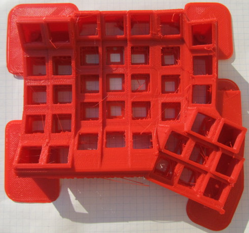

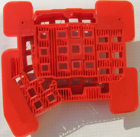

I talked about getting raw printouts from an FFF reprap printer. It should be possible to get these cheaply (definitely compared to shapeways). Here are some examples what the delivered parts would look like:
These were printed with ABS on a reprap (linear delta bot) which does not have a heat chamber. The print took 3h 37m for the keyPart and 1h 20m for the palm part. It was printed at 120 mm/s print moves, 240 mm/s non-printing moves, 7200 mm/s² X/Y/Z acceleration. This is kind of a middle of the print speed range for a delta printer. It is on a high end of the range for a cartesian printer. The delta pritner used a bowden extruder so you can see some strings there. A lot of cartesian printers do not use bowden extruders and should provide a cleaner result but in a longer time.
You can see the adhesion pads to prevent curving of the model during printing (needed for ABS when there is no heat chamber). You can sometimes see plastic strings which should not be there. And of course the support structure on the keywell part.
To finish the top part of the case one would need to do these things:
  • cut away the adhesion pads
  • pry away the support material
  • clean up (cut away) the strings (if any)
  • paint it with acetone
  • fix possible delamination or broken parts with acetone or ABS-glue
  • glue the two parts together with ABS-glue (there is a gluing template shape to make this easier)
  • optional - smooth it with sand paper
  • optional - paint with acetone or give it an acetone vapor bath
So now you can consider whether the chores are worth the cheaper price :D
If you do that without the last two optional steps (I did not bother) then it will look approximately as the pictures I posted earlier.
Even if it looks bad, the ABS-glue or ABS-juice work great on a ABS printout. Almost anything can be fixed. I did not try PLA (except for some testing keywells). So I do not really know about PLA.

Update: The right keywell came out pretty good. I do have to emphasize vpp's warning on taking care near the outer wall of the RJ-45. I caused a partial delamination by rushing through that area a bit. Nothing a bit of super-glue couldn't fix. I started the left keywell over night, and it appears to have printed well. I'll go pick it up when I can. Only the left base plate and palm parts left.
I'm putting everything up in an imgur album for those interested: http://imgur.com/a/n9cuT.

I do not have much experience with PLA. I printed only 0.2 kg of it. It is a bit more stiff and a bit more brittle. It has lower glass transition temperature (just above 60°C) compared to ABS (just above 100°C). So do not leave your PLA case in a car in summer.
Acetone (and ABS-glue) does not work for it. So disregard any instructions involving acetone. People use super glue instead of ABS-glue to glue PLA parts together. The only problem I see here is that super glue is too thin and dries too quickly. ABS-glue dries in about a minute or two after the parts are pressed together. This is true if there is not a thick layer of the ABS-glue (i.e. when the parts actually touch each other). It will not dry completely in that time but it will dry enough so that you do not need to hold it any more. The super glue will dry in few tens of seconds. So you have less time to attach palmPart and keyPart together precisely. It probably will not be a big problem since the gluing template screws will position the part properly. Select screws of just the right length when screwing the gluing template. That way you do not waste time tightening them. Add super glue, tighten the gluing template and press the parts together. In a thick layer super glue will not dry quickly too. So the quick dry time of super glue after the parts are pressed together may be even an advantage. Train at least once without the glue. You will also check whether the parts fit well.
Ask your RepRap chap about how to surface treat PLA. I do not know this.
You can use a thick (i.e. highly viscous) ABS-glue to add even a few mm of material to an ABS part on a place where it is missing because something went horribly wrong. I do not know about such possibility with PLA.
On the other side, PLA tends to curve less when printing. So there is a bigger chance it will print properly. But this should not be a problem since the adhesion pads are quite big.

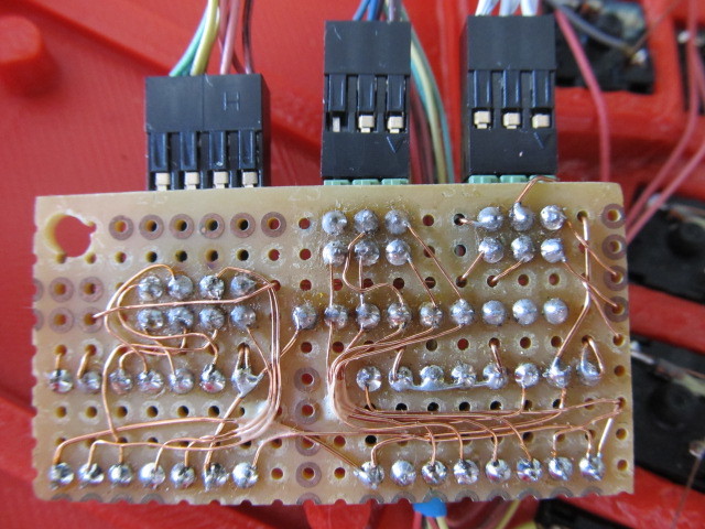

Ach right. You are considering using an universal PCB and a magnet wire to connect the pads. I actually did this for the left side of Katy v0.6.
Even in this case I would recommend to draw the PCB (probably with a lot of layers so that you can cross wires) in Kicad. This way it will show you which pads to connect together. Kicad will check your PCB so that it corresponds to the schematic. You do not want to connect wrong pads. It would be hard to find the error.

Another status update: I've now gotten both keywells and base plates printed. Printing the left palm part now, and hopefully the right one after that. I need to run into town and pick up some acetone for ABS glue. Gotta watch those outer walls when you are clearing the keywell supports. Be patient and don't rush or get too excited.

One more tip. If you have a problem with wall delamination when cleaning the support then paint just the walls with acetone even before cleaning the support. They will be probably painted only from the outside where they are accessible but it will make them stronger. Paint the whole part with acetone again when all the support (and strings if any) is cleared.
Good acetone painting will improve the strength of the part a lot. This also means that un-removed support (or strings) will hold better when painted with acetone. So do not paint the support (or the strings if any) when they are still on the part.
After it is cleaned up, it would be just easier to submerge it in acetone for about 2 seconds a pull it out and shake it a bit to remove excess acetone. But I do not want to contaminate so much acetone with ABS plastic. Also when painting I put a bit of acetone which will be used for painting into a small separate container because it will get contaminated from the ABS on the brush.
The walls will be strong plenty enough after key and palm parts are glued and the RJ45 (or your DP alternative socket) is glued into its slot.
Do not pour dirty acetone directly into a drain. Home drain pipes are often from some version of ABS. They could melt. And work with acetone in a well ventilated room or outside. It stinks badly.
