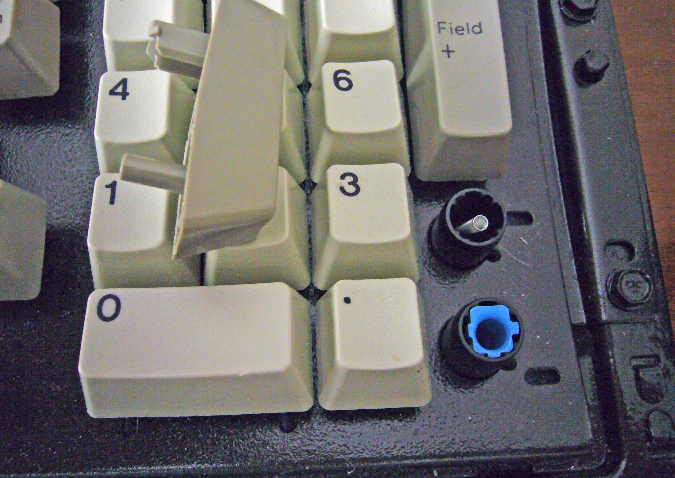

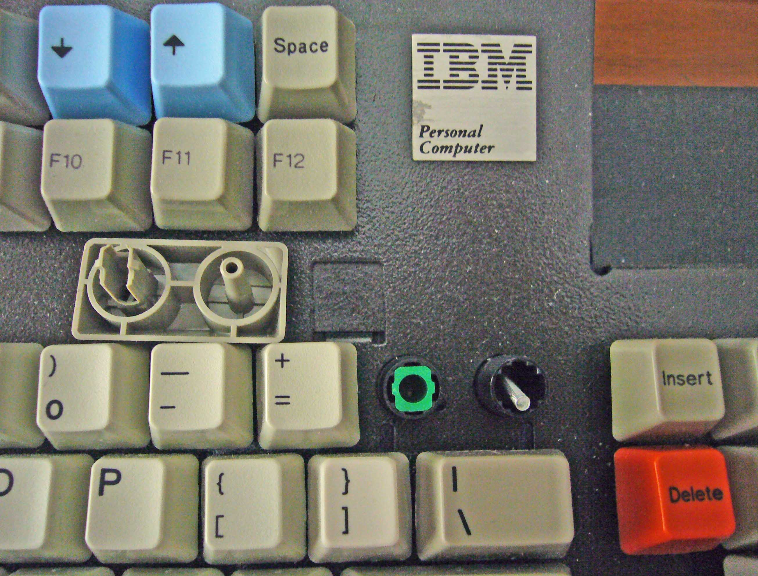

Hi guys, sorry this is a bit of an odd question, and i know people have said use the extra numpad key as a tab button, but i would really like the numberpad to be like a standard keyboard as i enter a lot of numbers and calculations for my work. Does anyone know where I can get a number pad plus key from so that it will take up 2 places? I know I'll need a "supporter" too (I'm not sure what they're called(. I've swapped the Model m and F large keys over already as they can be pressed anywhere and still work (done for right hand shift, enter and backspace.

i would get one from unicomp , you will have to take the spring and hammer out also
you can also get them from clickykeybords it may batch better
Halvar
28 Oct 2014, 22:09
... or just ask in the marketplace forum, someone might be able to help you out with a + key and a stabilizer insert from a Model M.

Right. Bear in mind that those inserts don't like to share a barrel with a spring. It's possible to remove a spring without taking apart the keyboard (using a "chopstick") but on a Model F you have much better access to the insides anyway, and can take out the flipper yourself.
28 Oct 2014, 22:15
Remember that the plastic barrel insert stabilizers come in "centered" and "off-center" and that the vertical keys require the "off-center" kind.
