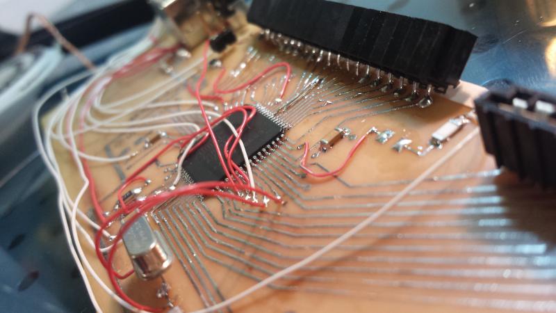

Posted: 09 Feb 2015, 01:02
by phosphorglow
Sooooo I need to run a couple of wires to replace crappy traces, otherwise so far so good.
The toner transfer sheets I got were utter crap.

Posted: 09 Feb 2015, 12:26
by phosphorglow
2015-02-09 04.58.191.jpg (57.2 KiB) Viewed 9009 times
In all its wondrous glory. Can't wait for a real double sided PCB!
Amazingly, it's functional! Not so amazing is that FLIP now throws me an error upon erase/verify after I loaded Soarers Controller (it did flash and verify properly the first time). Google tells me it's because of some stock fuse/lock settings and I need to re-flash the bootloader. Aside from that though, it's working. Time to put the TeensyduinoISP to work!
A thought occurred to me: Do I really need the crystal? Isn't there an internal oscillator? I'm sure I need it, but it doesn't hurt to ask.

Very nice to know about the resistor - I was hoping that was the case!
Have you ran into the above mentioned issue with the erase/verify error?

Posted: 09 Feb 2015, 18:08
by phosphorglow
Okie dokie - I can definitely use some help on what fuse settings I should throw at this thing... :P
The fusecalc site has a whole bunch of options that are currently over my head.
Current read of settings is:
lfuse 5E
hfuse 99
efuse F3
Posted: 09 Feb 2015, 19:35
by phosphorglow
Otay.
I currently have LUFA DFU bootloader installed, and Soarers Controller. It enumerates as Soarers upon plugin.
New fuse settings are, low 5E, high DA, extended F1.
So I have BOOTRST and HWBE enabled, .
Now... isn't it supposed to enumerate as a DFU device when I hit the reset button? Because it doesn't.
(And now I momentarily bricked it by setting the CKSEL0-3 to programmed, assuming it was to use the external 16MHz crystal, and now I'm getting a verification error saying it's set to FF. This is exciting. I probably don't have the correct capacitors on the xtal. I have 10pF's, and the crystal is 20pF. That's incorrect, I'm assuming. I'm doing a lot of assuming today.)
Edit/Update:
Apparently I set it to use an external clock? Time to whip out another teensy...
Edit edit:
Grr. Walking away from this for now. Time to play with some large power tools instead.
