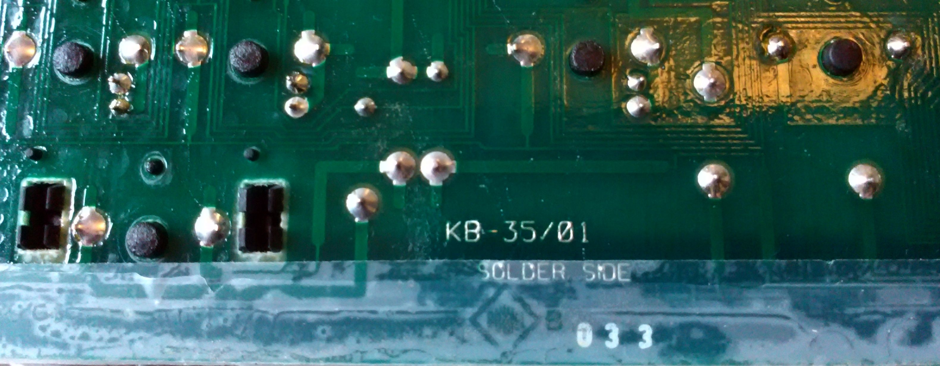

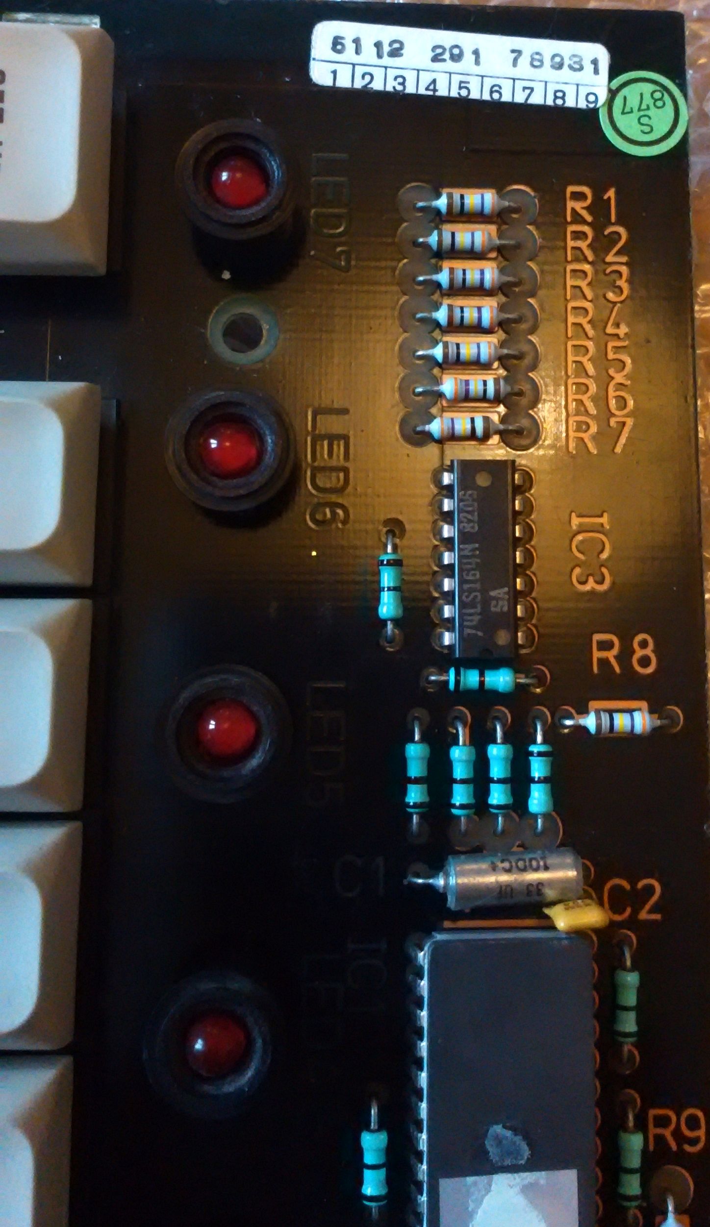

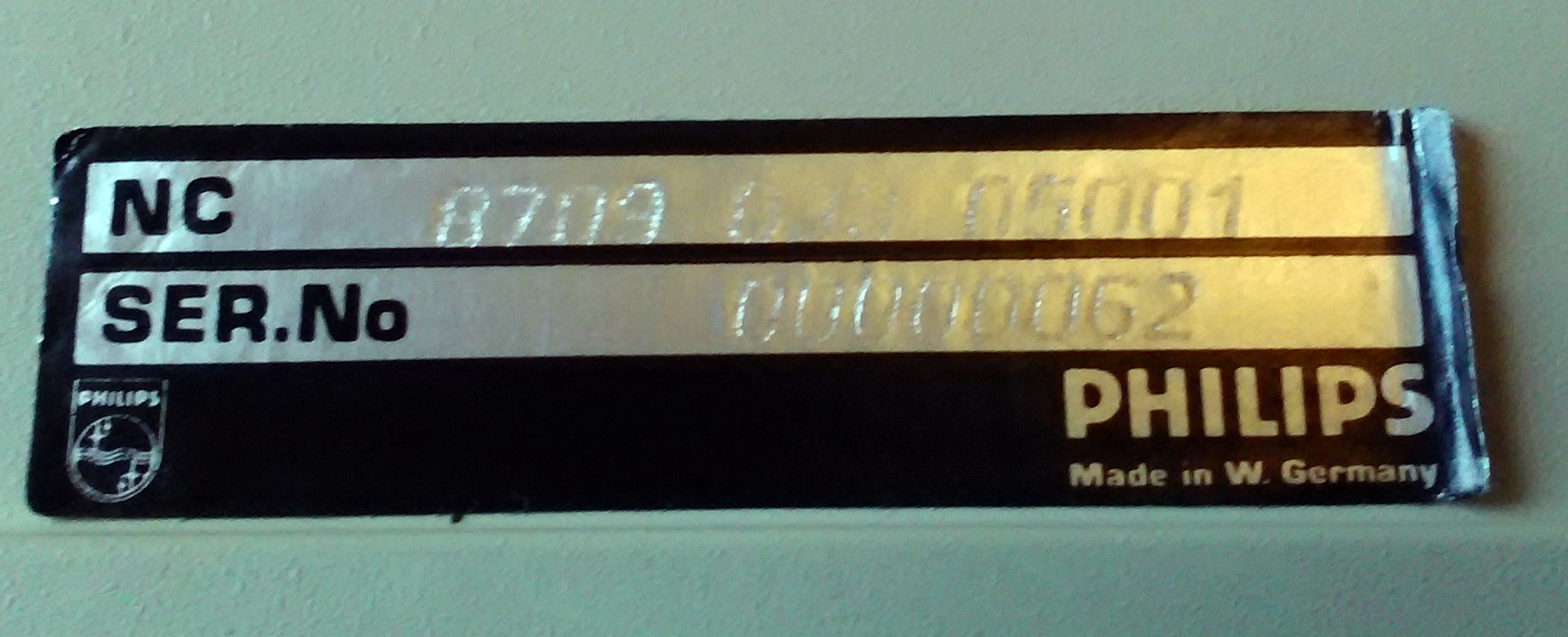

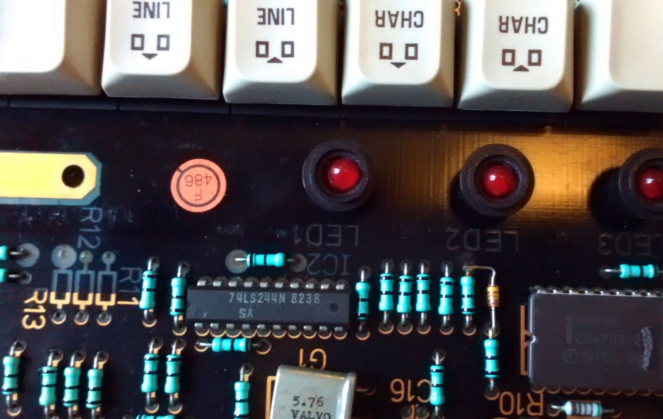

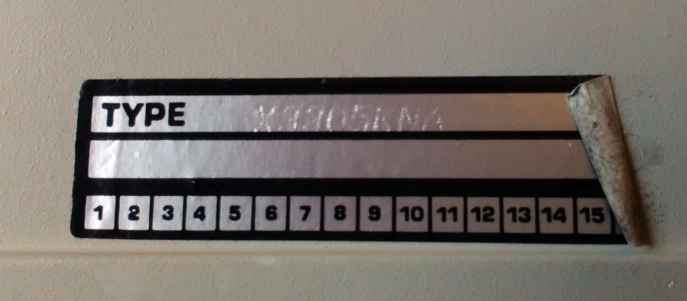

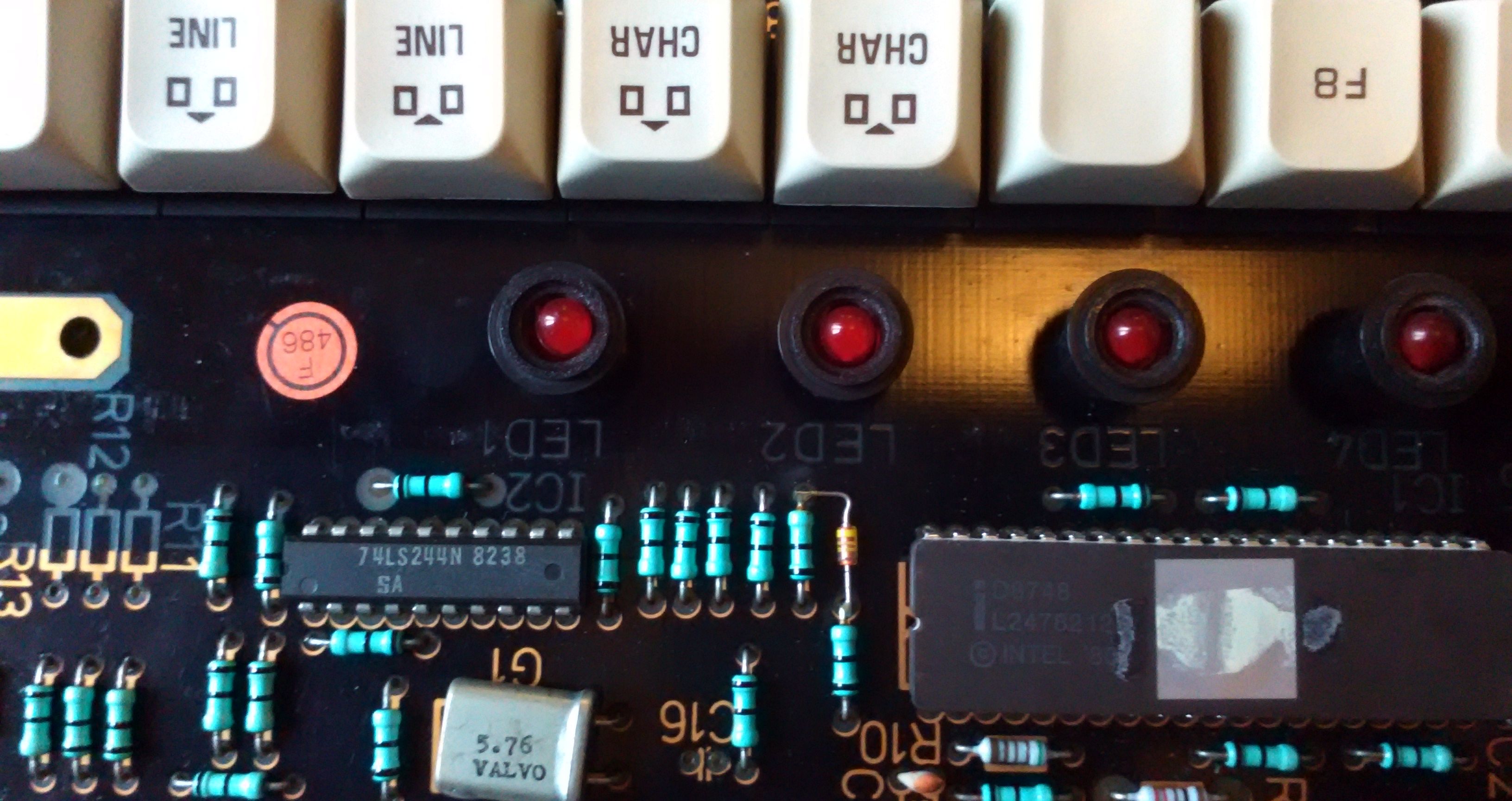

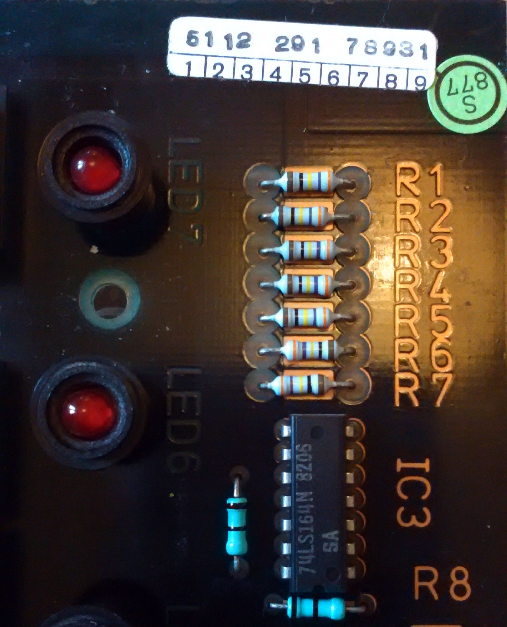

Daniel Beardsmore wrote: A photo of the controller IC would be interesting — and any markings on the PCB. i.e. is it contemporary with the Loewe keyboard?
Here pics I just made, don't know if that's enough to date the board.. nothing like a date is in or out.
Stickers and PN
NC 8709 033 05001
SER.No 00000062

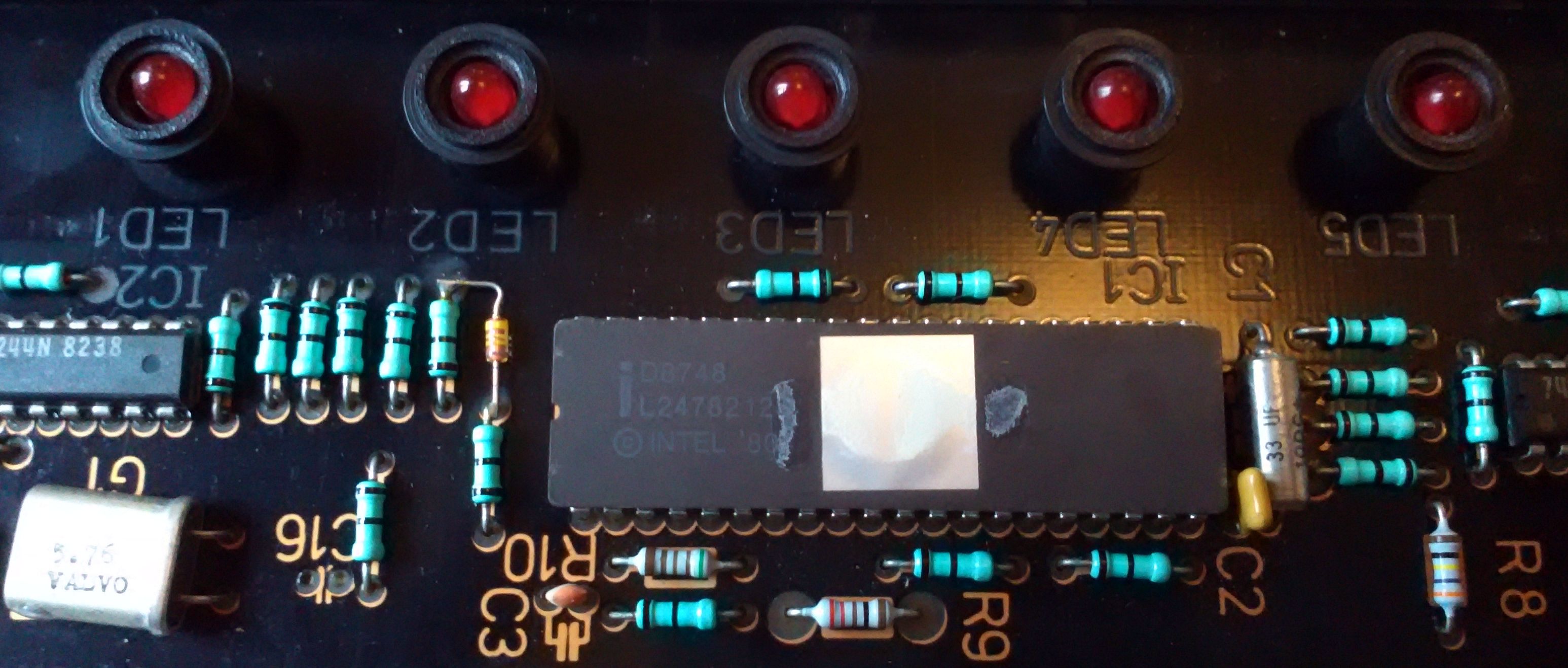

Controller
beside the big I the 2 numbers
D8748
L2478212S
INTEL 80
paper sticker on front pcb
marking back pcb

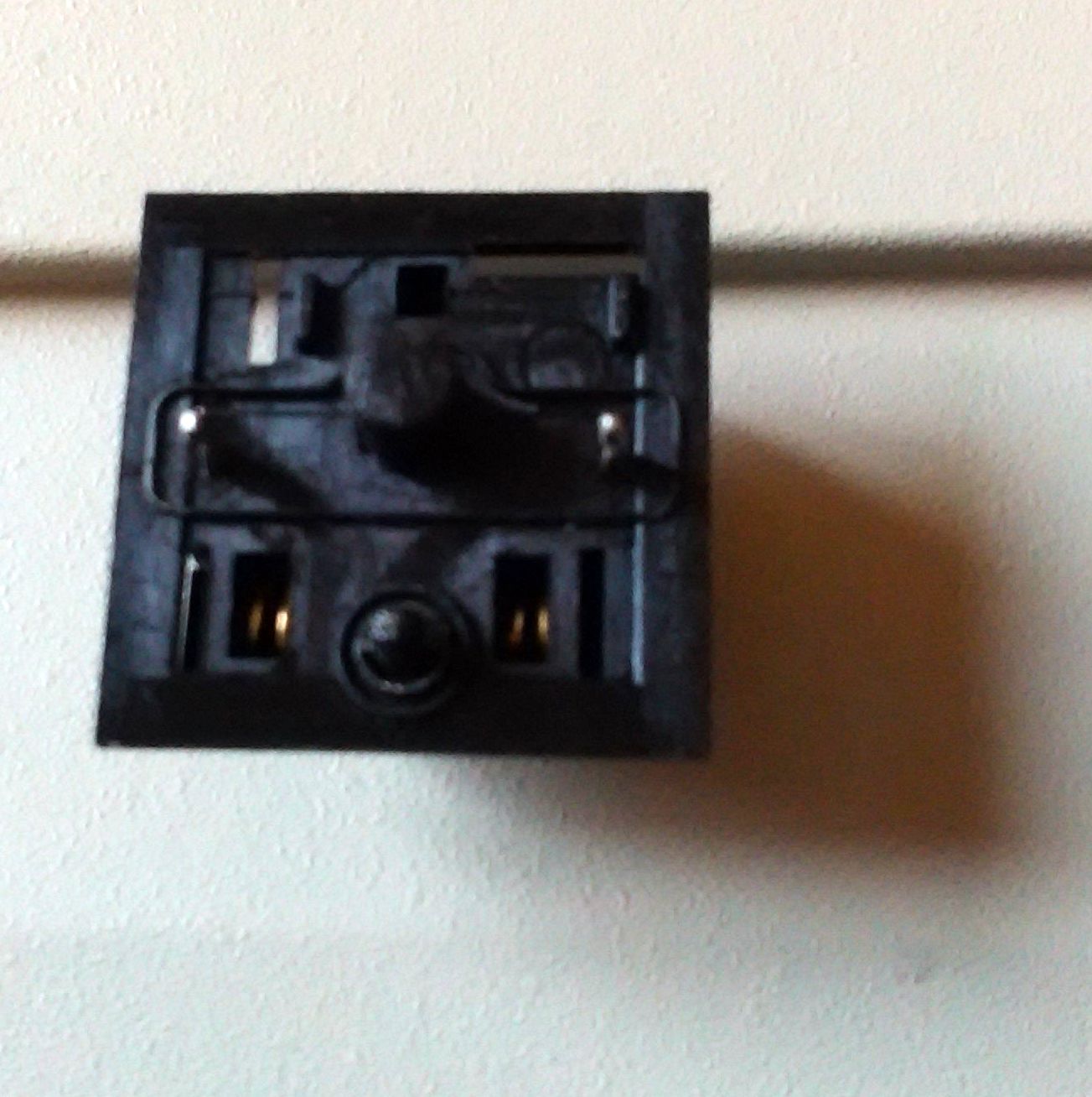

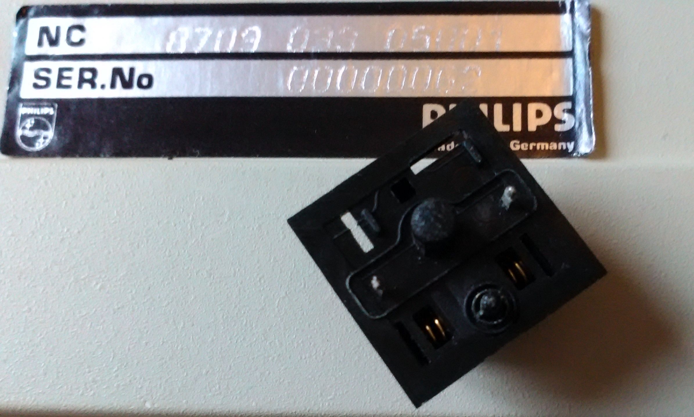

Desoldered one switch, one without diode cause others have one with.
There is no brand back the switch, nor front.
17 Feb 2015, 19:55
D8748 is an Intel microcontroller, so that's not 1987. L2478212S, if taken to read week 12 of 1982, fits the same year as what's written on the smaller ICs.
So, it appears to be 1982, and contemporary with the Loewe keyboard (ca. 1984). Loewe sounds German (and the text on the Loewe keyboard is in German), and the Philips keyboard is made in Germany.
Both tie in well together. Sadly, neither one suggests a switch manufacturer.
