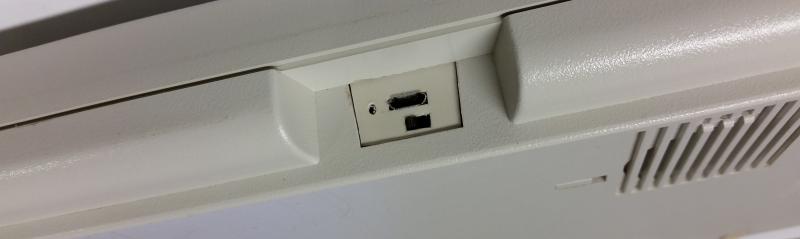

I can, however, help with the issue of the USB port. I'm just about done revising Colossus V2.0, which has the option between USB-B, Micro, and Mini. Yes, I know, USB-B is deprecated. And it's been as such for a long while. But, as far as something that makes a nod to the original SDL connector, it's pretty cool. And sturdy.
I saw a post a few pages back about me using nylon risers to slip over the posts in the case. I stopped doing that quite a while ago after I came up with a more elegant solution. On SSKs the extra height touches the top of the case, and on full sized boards the bit of plastic that normally presses down on the SDL connector presses down on a folded section of the plastic port cover. Basically the same story for Micro and Mini. Those are on a single daughterboard for the extra height required. Pads for either connector on both sides. Choices are fun.
And my Micro port cover/holder:

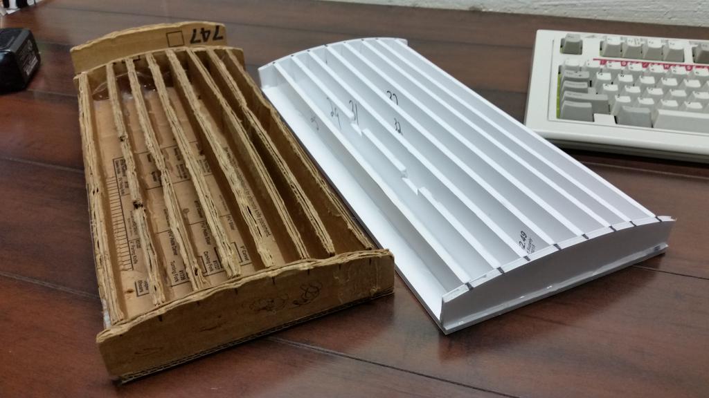

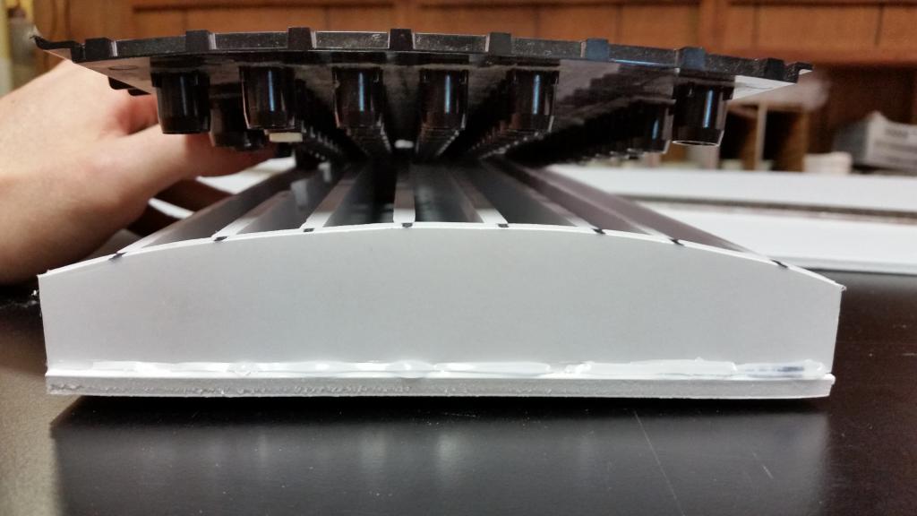

I'm working on an official comprehensive bolt mod how-to guide. In order for me to do that properly I needed to make up plans for a work jig like the one I've been using.
Though I consider it a necessity in properly putting an M back together, it will be especially useful for this project because of the force that will be required to bend the new capacitive PCB during reassembly.

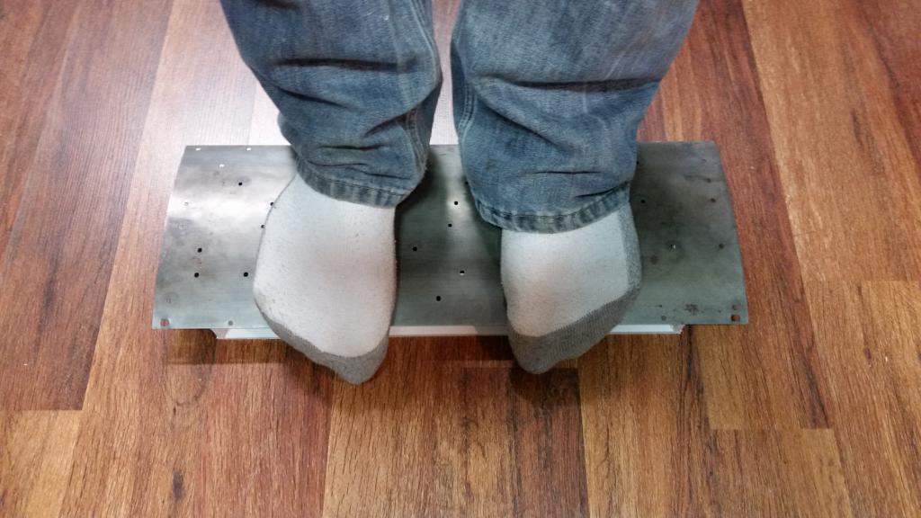

Once built, they're quite strong...
Clearly nowhere near this much force will required to bend the new PCB - I'm just showing off for the camera. :P

A flat PCB would not work with a curved keyboard. This was my first and biggest fear when the PCBs arrived. The solution that I applied that has worked like a dream was to bend (curve) the PCBs before installation.
This is simply done by applying heat (the hairdryer that we have was sufficient), covering the PCB with some paper to avoid the tape to get in the PCB, bend it a little bit more than what is actually required, apply packing tape in this position to keep the shape, and let it cold down. The result is a nice curved PCB that fits the sandwich.
The FSSK prototypers have seen the result. The FSSK prototypes had two mistakes that I managed to manually correct. The correction needs to be applied after the shaping process. the patches would break if applied before. As I offered to patch the FSSK prototypes, I had to curve them also. This is why they have seen the final result in their boxes :-)

phosphorglow - that jig is a brilliant idea. This would be really easy to laser cut from a singly sheet of acrylic or thin plywood. You could design in assembly tabs and slots so the whole thing just snaps together. For those of us with access to a laser cutter this would probably take 10-20 minutes to cut and assemble given a working file. As a side project (famous last words...) I can work on drawing this up if you share even some rudimentary dimensions.
Fixtures!
