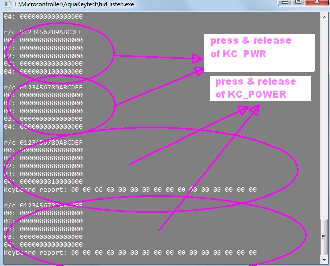

Hi! I have a question, how can I get KC_PWR or KC_POWER to take any effect? On my Windows 7 those scancodes do nothing. My PC meets the hardware requirements with ACPI, and ICH9+. With HID_listen I get these reports:
Laser
emacs -nw
17 Oct 2016, 21:29
What happens when you press the Power button on your computer (i.e. is Windows configured to actually do something)? KC_PWR should work on Windows, according to https://github.com/tmk/tmk_keyboard/wik ... oesnt-work (but you probably know that already).
Eszett
17 Oct 2016, 21:42
Hi Laser. The physical Powerbutton on my PC shuts my OS (Win7) down. Yes, I've read that FAQ article, and according to HID_listen, KC_POWER does at least send a "keyboard_report", KC_PWR does not. According to the "USB HID usage table", the value "66" is correct: "0x66 Keyboard Power". However, my PC doesn't react to it.
Laser
emacs -nw
17 Oct 2016, 22:51
What follows is just a supposition: your keyboard may not be allowed to shut down the computer - in the similar way a USB device (mouse, keyboard etc.) has to be allowed to "wake the computer" from sleep. This can be disabled/enabled at two levels, which should be checked (if supposition is true ...): in BIOS, and then at Windows keyboard driver - power management level (e.g. probably like here).
hasu
18 Oct 2016, 01:56
In addition to what Laser pointed out you have to know KC_PWR is a system control key while KC_POWER is a normal keyboard key. System control keys and media control keys are called as 'extra keys' in TMK.
Unfortunately current tmk_core doesn't spit debug print for the system control keys, to see them on hid_listen apply this patch, you will find output like below. If you don't find it you should build with 'EXTRAKEY_ENABLE'.
system: 0081
system: 0000

Eszett
18 Oct 2016, 06:37
Hi Laser. It seems to me that In the properties of "USB Root Hub" or "HID conform Device" (I hope I translated it correctly to it's english naming) I can control if the Compuer may turn off the device to save power, but I can't control if the Devices may shut down the Computer. In BIOS I found indeed a setting, that prevented the keyboard from shutting down the Computer. I changed the setting properly, but unfortunately, the scancodes still don't work :-(
Eszett
18 Oct 2016, 06:54
Hi hasu. I've applied your patch, and indeed, HID listen reports 0081 and 0000 as the "system codes". So far, so good. That means, the scancodes are sent properly, just my system ignores them, right? So it isn't actually a problem of the firmware of the keyboard ...
hasu
18 Oct 2016, 10:40
Then, it may be worth checking this FAQ entry. Windows can cache device driver setting wrongly and you have to clear it manually in some situations.
https://github.com/tmk/tmk_keyboard/wik ... not-change

Eszett wrote: Hi Laser. It seems to me that In the properties of "USB Root Hub" or "HID conform Device" (I hope I translated it correctly to it's english naming) I can control if the Compuer may turn off the device to save power, but I can't control if the Devices may shut down the Computer. In BIOS I found indeed a setting, that prevented the keyboard from shutting down the Computer. I changed the setting properly, but unfortunately, the scancodes still don't work :-(
You'll (probably!) have to change that BIOS setting which, after you boot again/afterwards into Windows, finally allows you to control if the Devices may shut down the Computer, *and* also change that (so, 2 settings, one in BIOS, one in Windows). It may be the BIOS setting you found, or another one, in the lines of "Wake up on ...".
Eszett
18 Oct 2016, 23:28
@hasu Hm, I don't see how this would solve the issue..
@Laser There is no checkbox "Device may shutdown computer", not even after I've changed the BIOS settings.

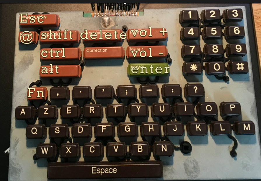

ibandreas
20 Oct 2016, 18:13
Thanks so much for providing this tutorial. I am reverse engineering the keyboard on an old Minitel device which has 16 pins and have an 8X8 grid where pressing the key closes the connection between row x and col y. I cant really peer inside without breaking the keyboard - I dont think there are any diodes and I think they are simply switches directly wired to the output pins in a matrix which I have solved for. I didnt hook anything up to the led pin and actually i didnt use or alter the led.c file at all nor hook up any leds to any pins which I hope is optional.
I was able to follow all of the instrutions and make the gh60_lufa.hex file and write it to the Teensy 2 ++. At least I think so. The log showed downloading file... compete. But after this nothing happens. I am expecting the keyboard to immediately start working but it doesnt seem to be recognized at all by my mac. Pressing keys does nothing.
Looking forward to any guidance you can give me on this. Im hoping there is some kind of logic missing for this particular kind of direct link keyboard wiring scheme.
Attached are all of my gh60 modified files.
Archive.zip
(255.48 KiB) Downloaded 319 times
ibandreas
21 Oct 2016, 10:07
And heres a picture of the keyboard I am trying to bring back to life.
Minitel keys
Minitel keys
Minitel keys.png (997.62 KiB) Viewed 11993 times
