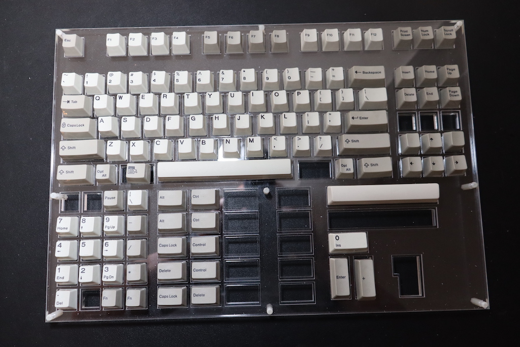

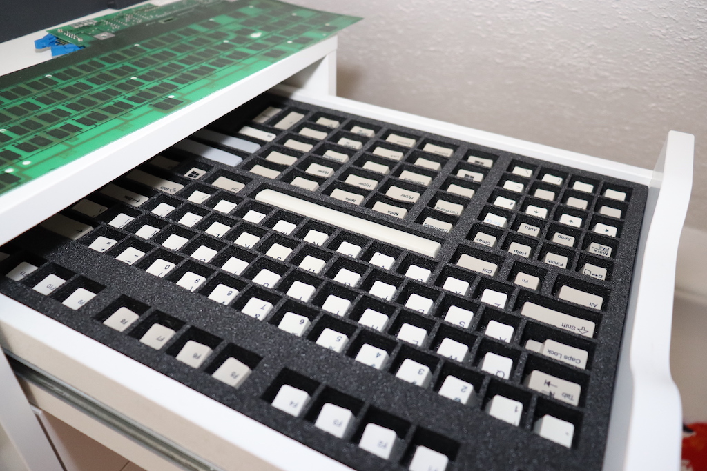

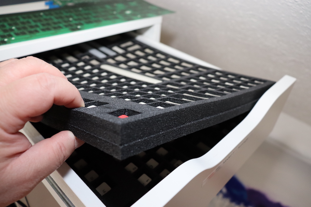

16 Apr 2021, 17:41
I was doing some work on getting proper buckling spring keycap storage systems and display trays created. I thought I am sharing the results here also:

A cool idea, darkcruix! Are this already ellipse's keys? Because the print looks very sharp!
