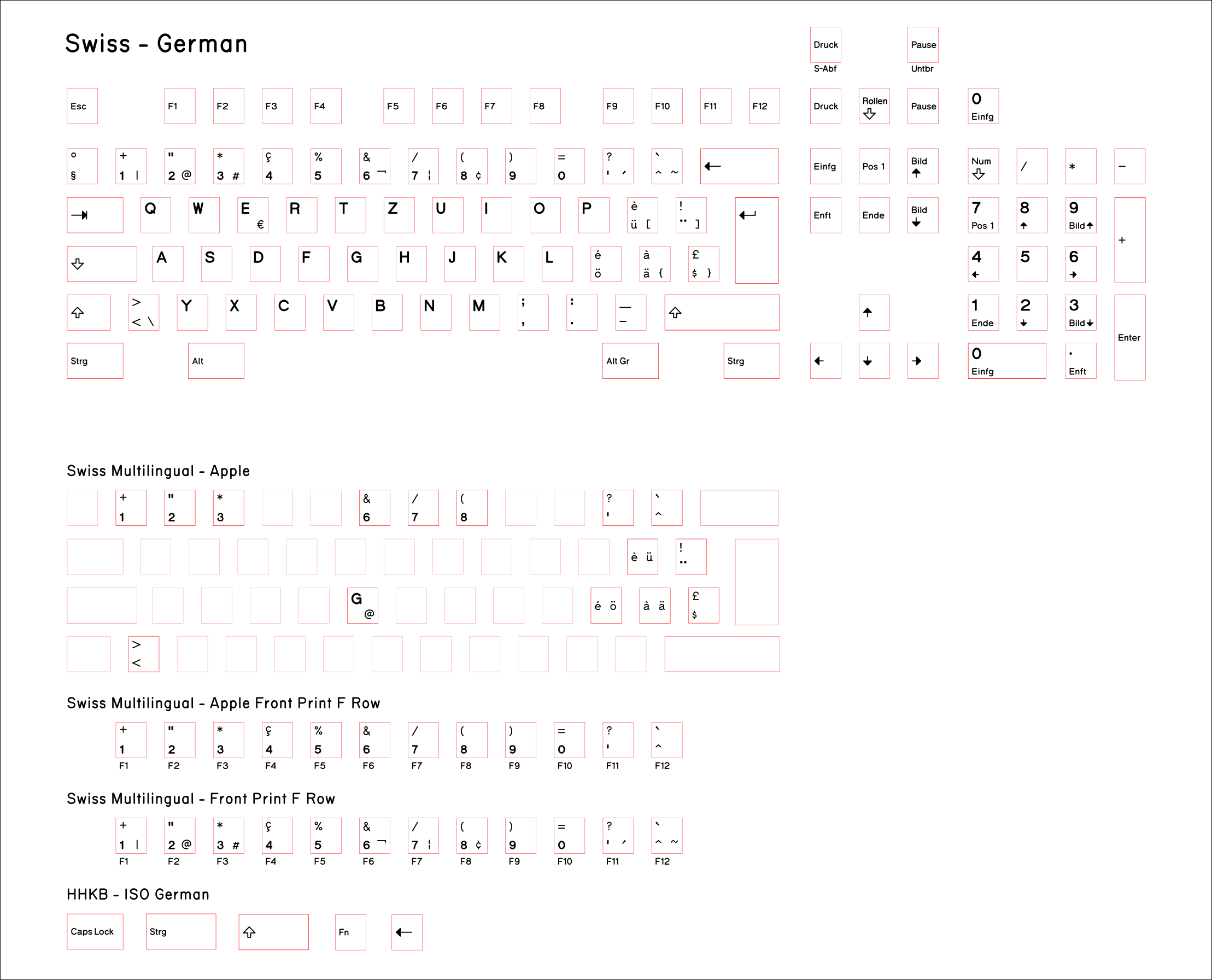

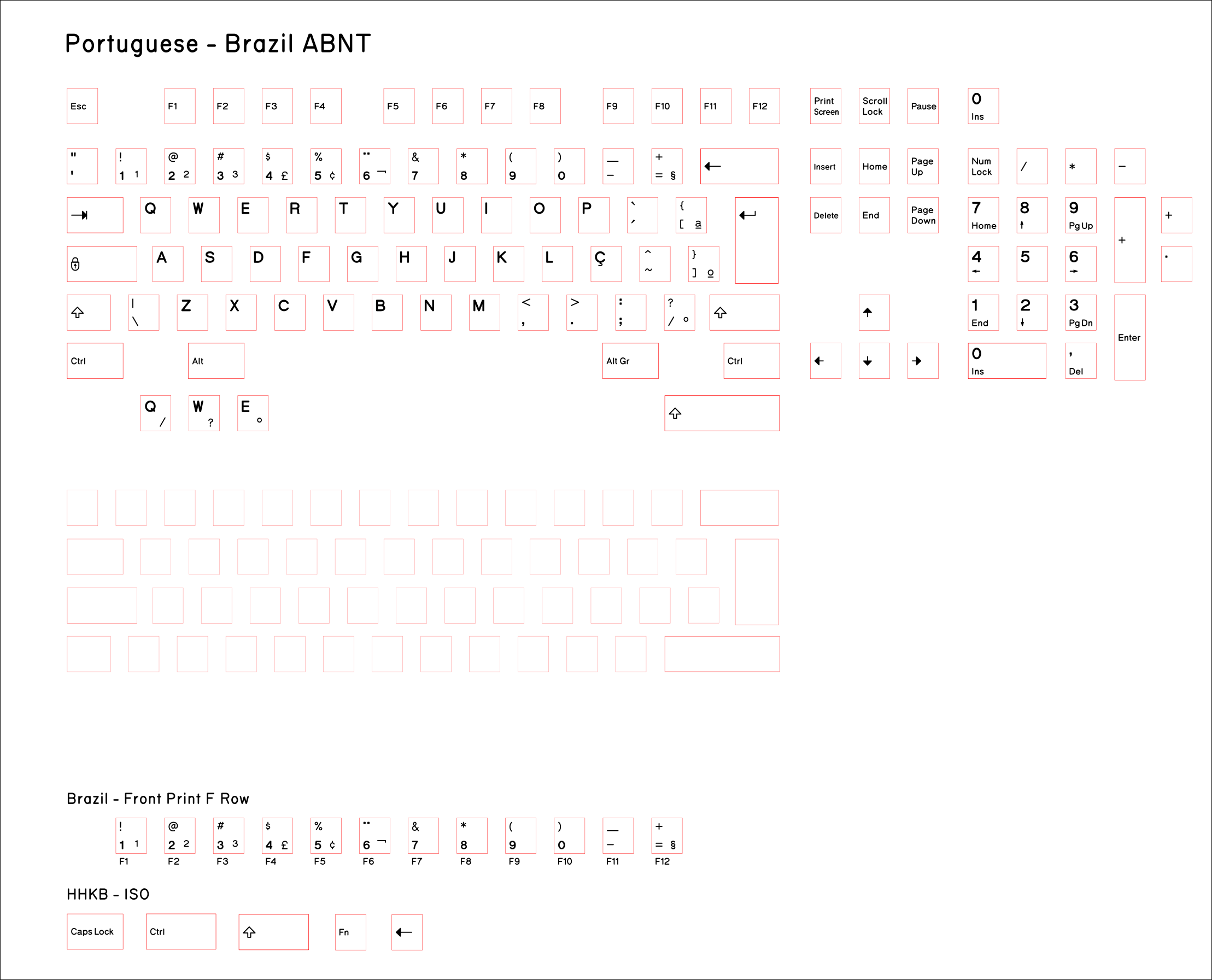

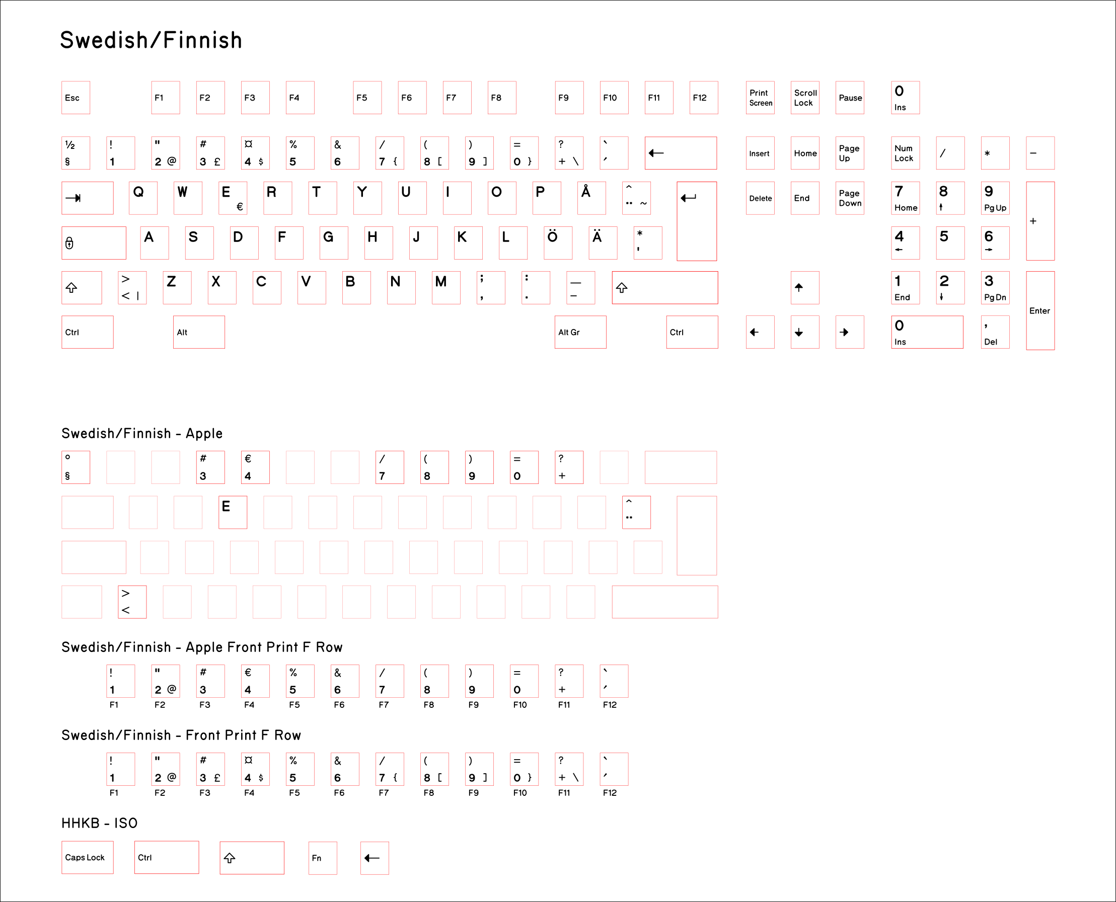

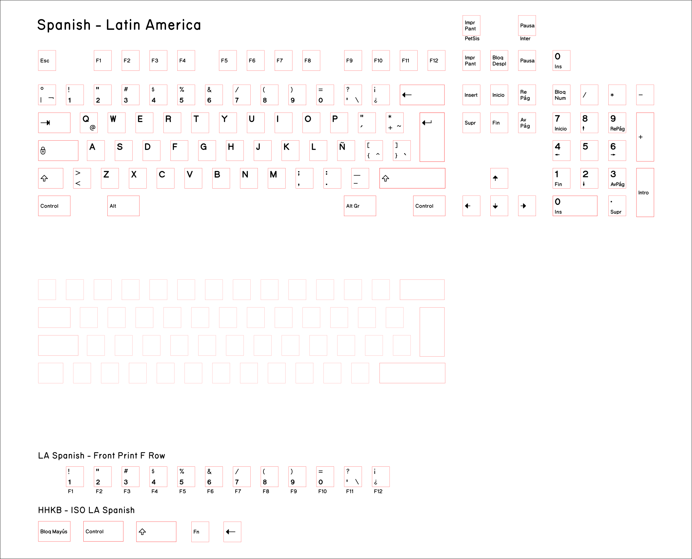

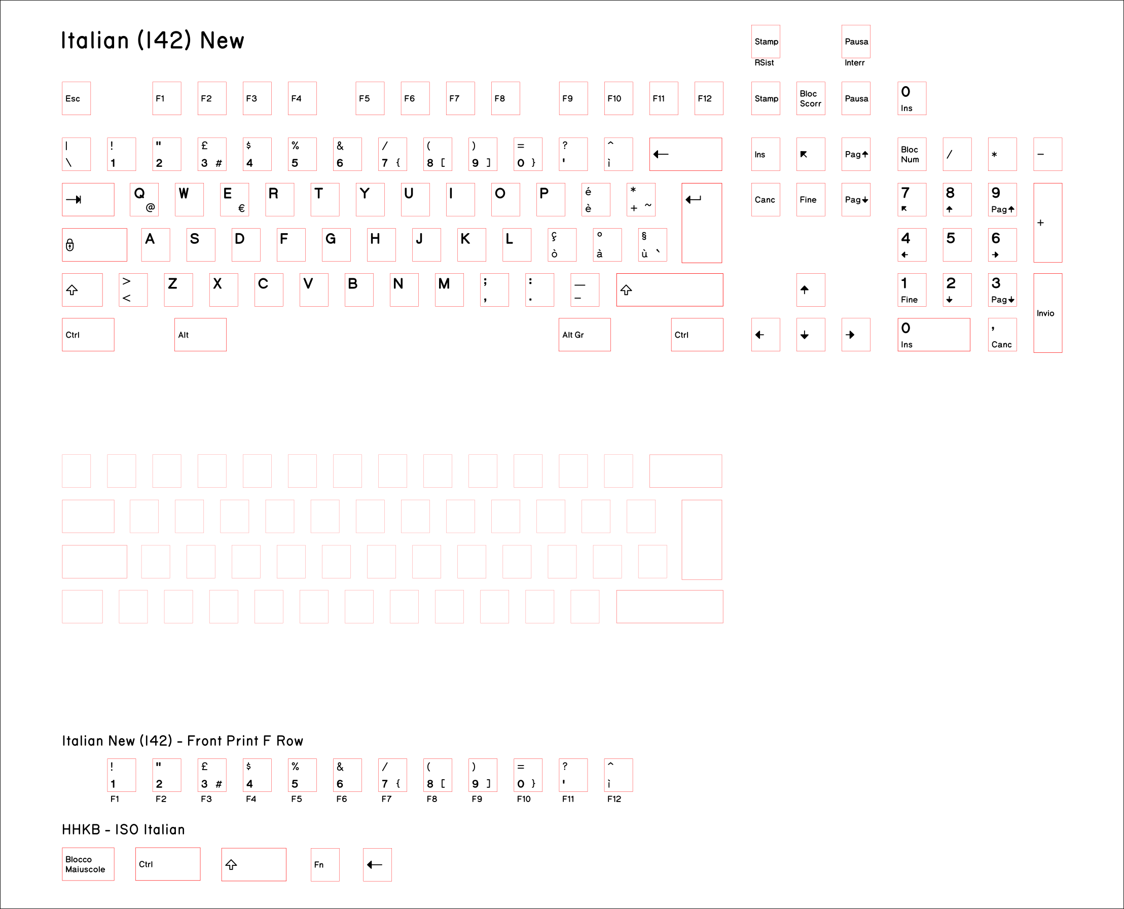

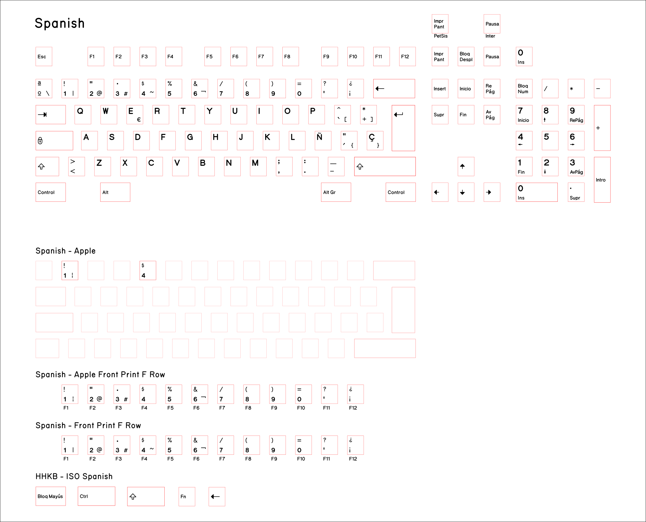

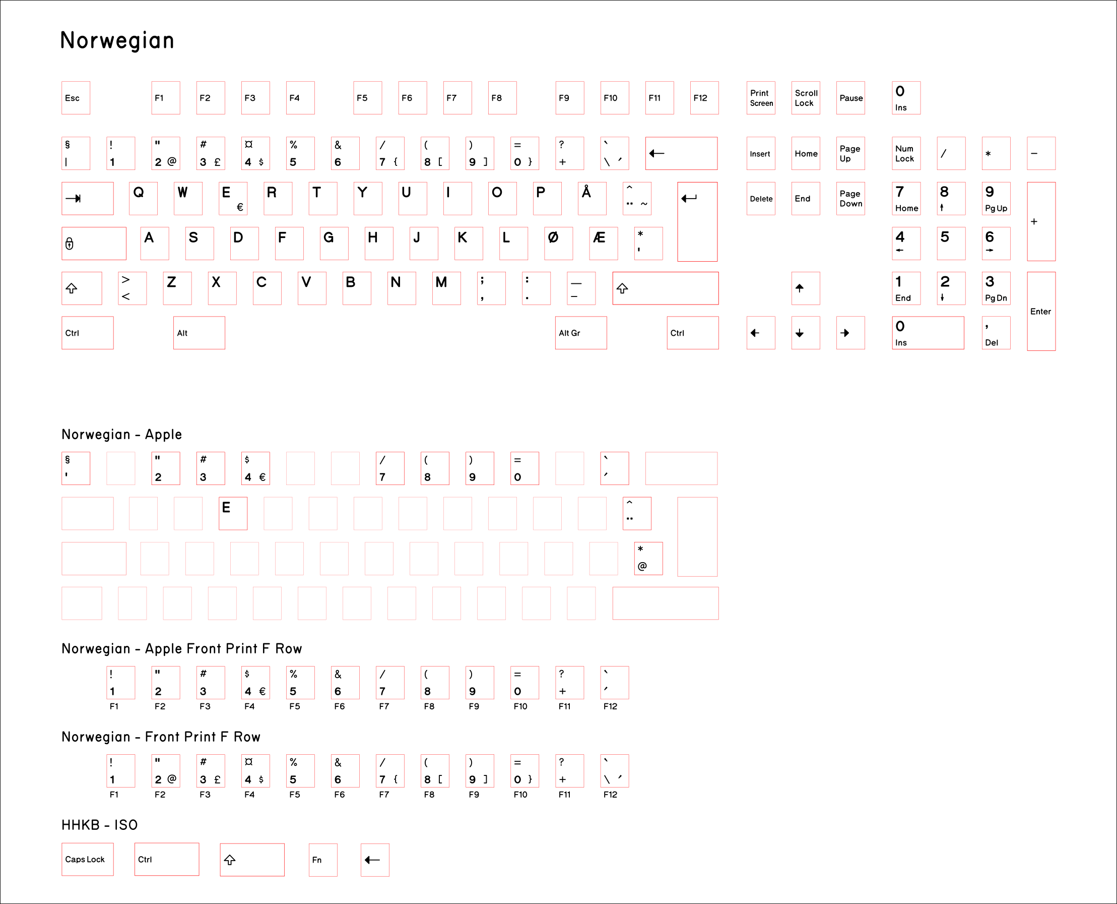

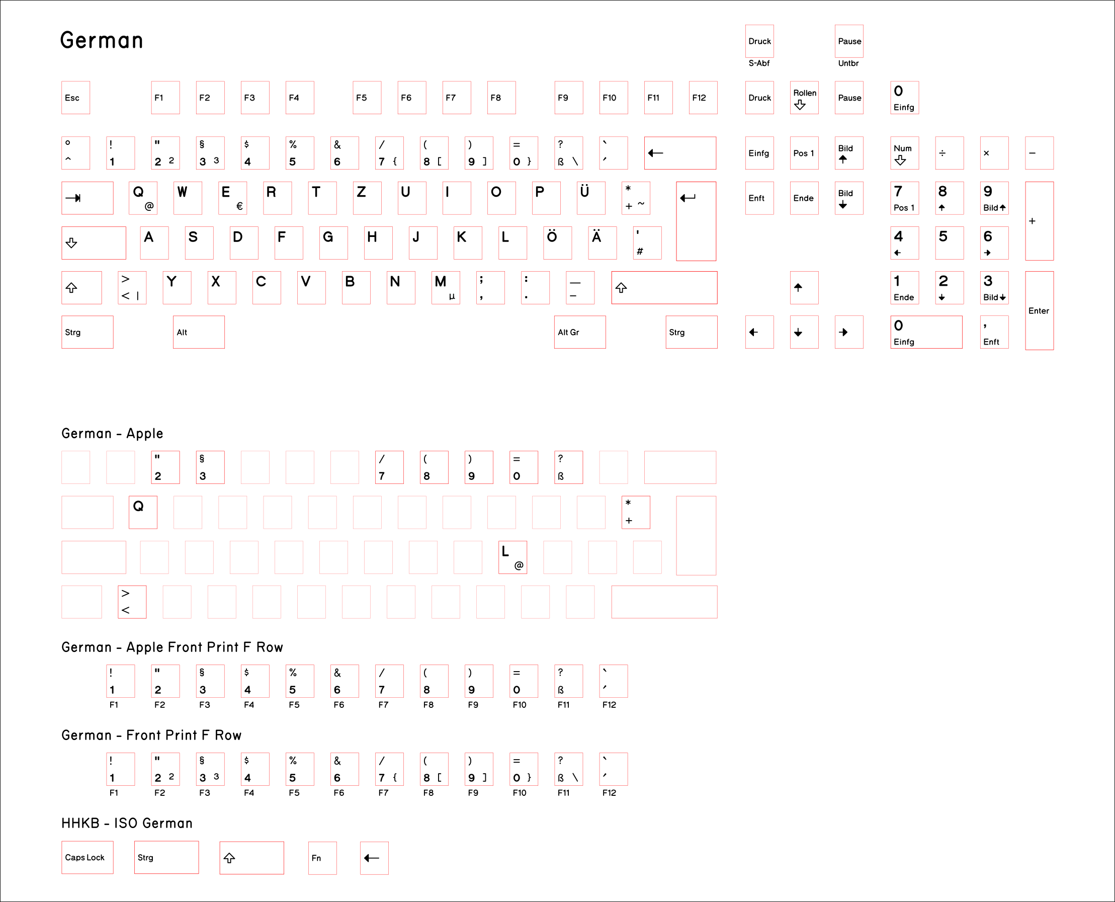

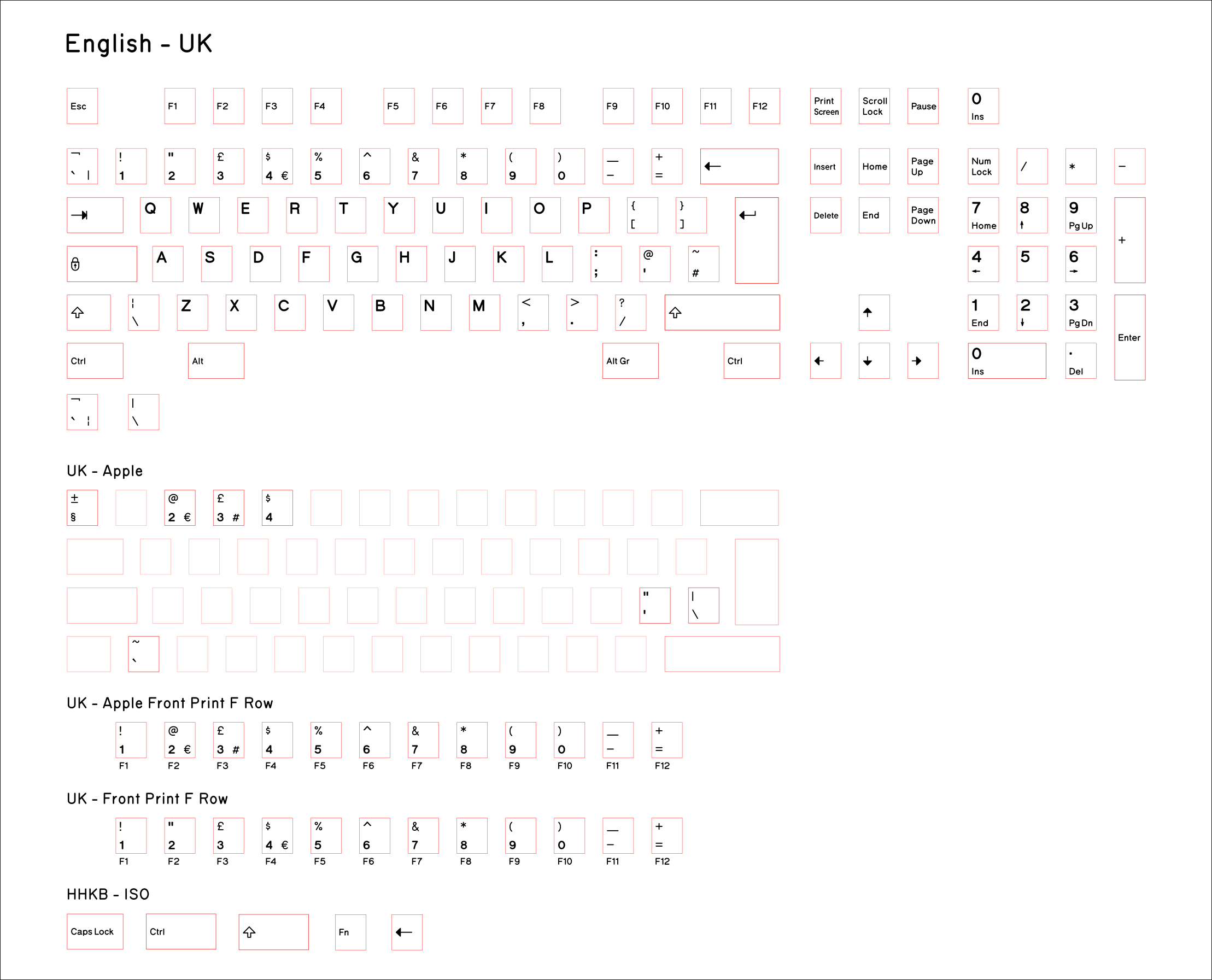

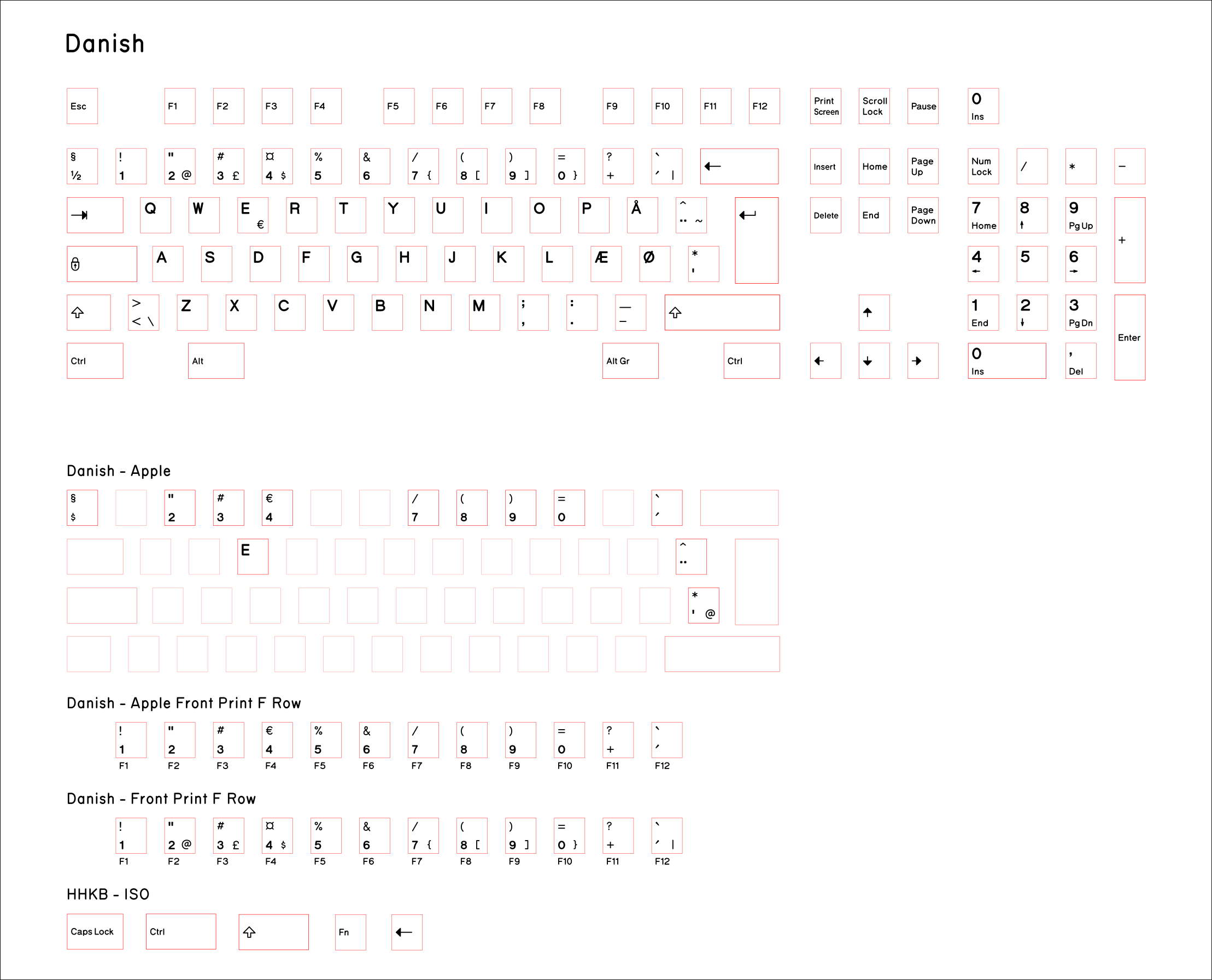

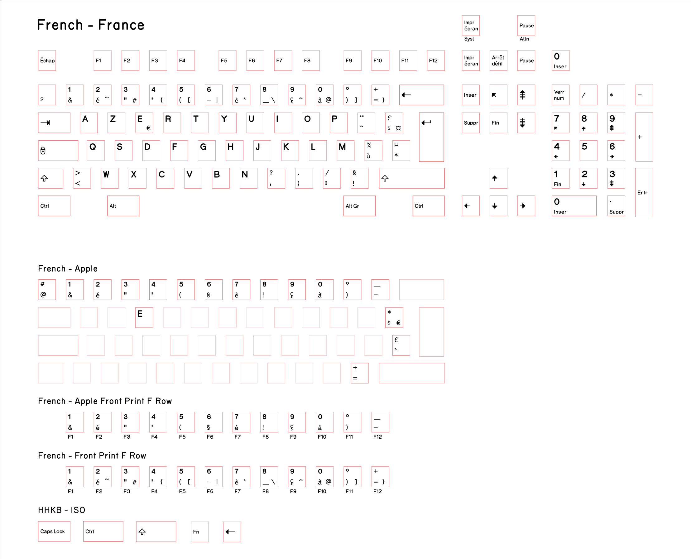

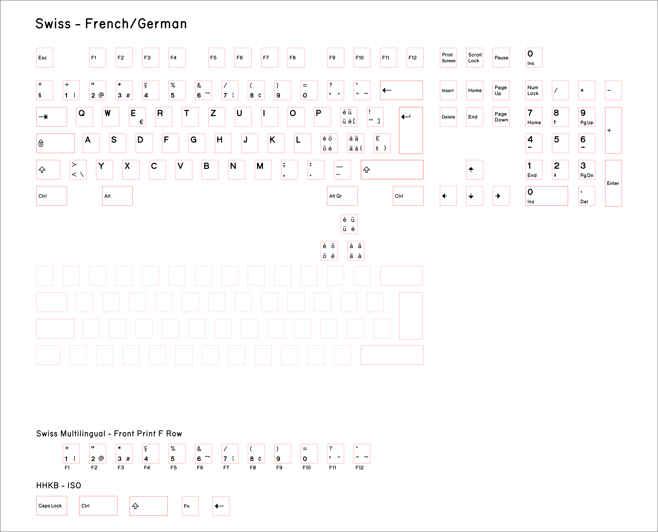

Ellipse

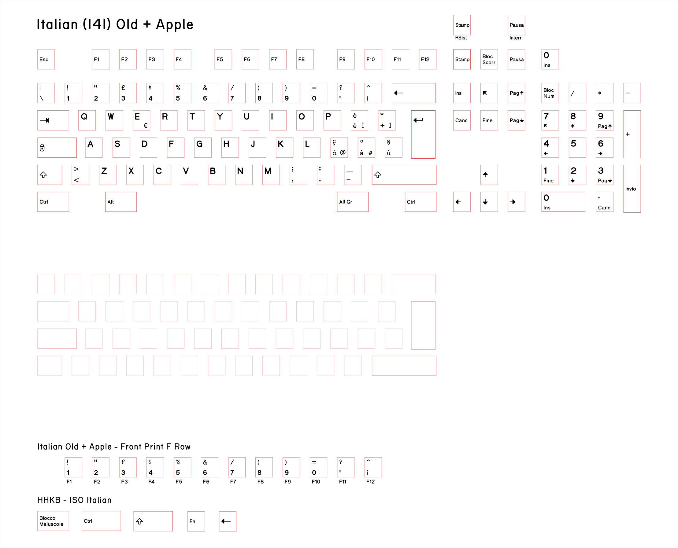

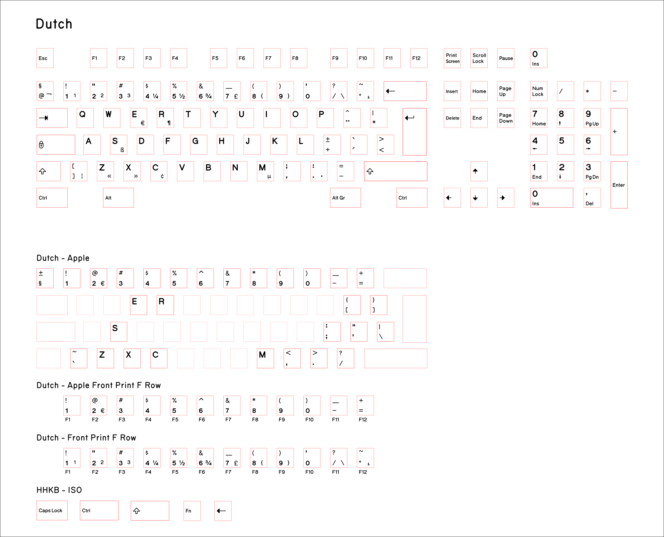

Attached is Zed's draft artwork for the international sublimated key sets. The factory expects to start production on these in a few days. If there are any issues please post a reply on this thread.
As a note, these images are drafts and you will not receive all of the keys below in any set. Each language file contains multiple sets that can be ordered separately (front print, base key set, etc.).
As a note the Apple specific keys in the below proposed artwork would be for new orders only. I will not be changing any prior front print orders for the new apple front print.
To view them larger, you can right click and click open image in new tab, or right click to save the file.
- UK.png (171.43 KiB) Viewed 10083 times
- Swiss_German.png (202.44 KiB) Viewed 10083 times
- Swiss_French_German.png (162.39 KiB) Viewed 10083 times
- Swedish_Finnish.png (193.23 KiB) Viewed 10083 times
- Spanish_LA.png (156.07 KiB) Viewed 10083 times
- Spanish.png (181.5 KiB) Viewed 10083 times
- Norwegian.png (185.74 KiB) Viewed 10083 times
- Italian_Old.png (152.2 KiB) Viewed 10083 times
- Italian_New.png (151.74 KiB) Viewed 10083 times
- German.png (186.13 KiB) Viewed 10083 times
- French.png (188.49 KiB) Viewed 10083 times
- Dutch.png (192.86 KiB) Viewed 10083 times
- Danish.png (179.27 KiB) Viewed 10083 times
- Brazil.png (153.73 KiB) Viewed 10083 times

I ordered an F77 compact with blank black keys with a HHKB layout in mid-2016. Didn’t do a low serial or anything. I’m in no rush haha
- Zed
- Location: US
- Main keyboard: Unicomp Model M
- Main mouse: Ducky Secret
Thanks for the feedback. Any opinions on my 1.5U 'Caps Lock' legend in the HHKB ISO German set? I wanted to make the bottom row consistent and do a text legend and Google translate claims that 'Caps Lock' is proper German. Google seems pretty smart with regards to keyboard specific legends (it translates 'Ctrl' to 'Strg' for example) but I wanted to be sure.Xcore wrote: 18 Apr 2021, 16:57 I looked at the German keyset and on my MacBook and my Model M and everything seems to be alright![]()

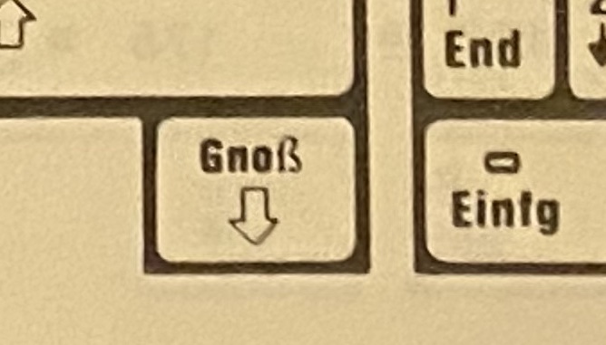

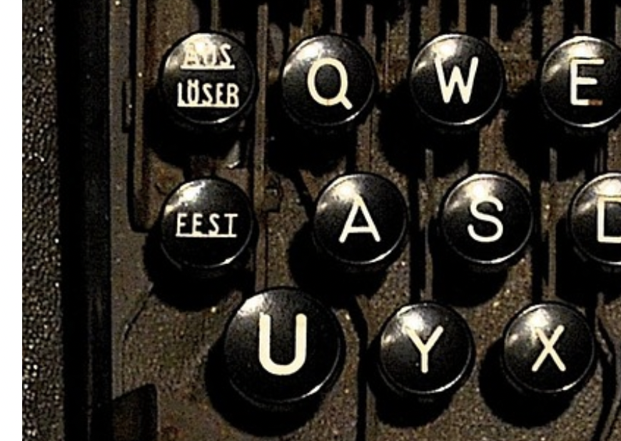

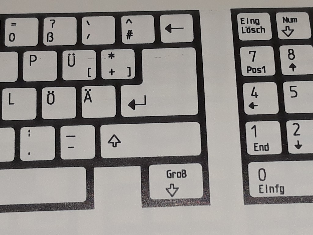

Hi Zed,Zed wrote: 18 Apr 2021, 22:35Thanks for the feedback. Any opinions on my 1.5U 'Caps Lock' legend in the HHKB ISO German set? I wanted to make the bottom row consistent and do a text legend and Google translate claims that 'Caps Lock' is proper German. Google seems pretty smart with regards to keyboard specific legends (it translates 'Ctrl' to 'Strg' for example) but I wanted to be sure.Xcore wrote: 18 Apr 2021, 16:57 I looked at the German keyset and on my MacBook and my Model M and everything seems to be alright![]()
Caps Lock was initially described by IBM as Feststelltaste or Groß. It just looks wrong to me to not use Caps Lock but according the IBM AT handbook (German variant) and looking at a German Model F AT, it is Groß and can be seen in the copy attached (they have a typo in the handbook - it is Groß and not Gnoß).

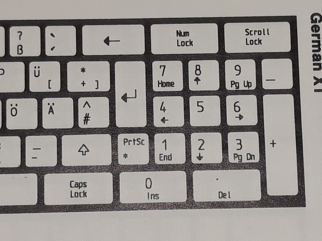

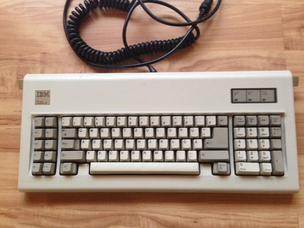

The German term for Caps Lock (literally maybe "Kap[itälchen]-Schloss") would indeed be "Feststelltaste" – but I have never seen the word Feststelltaste been written on a keyboard ever. I think the German norms are calling for just the arrow symbol without any text.Zed wrote: 18 Apr 2021, 22:35 Any opinions on my 1.5U 'Caps Lock' legend in the HHKB ISO German set? I wanted to make the bottom row consistent and do a text legend and Google translate claims that 'Caps Lock' is proper German.
Caps Lock seems to be used on at least some older Keyboards, e.g. my F/XT has the key labeled Caps Lock.
I dig the "Groß ⇩" from darkcruix photos (even though the manual seems to give it as "Gnoß"?

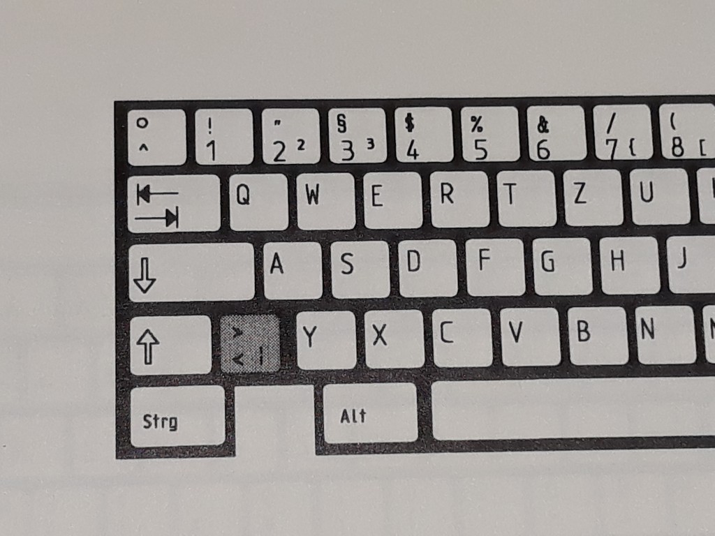

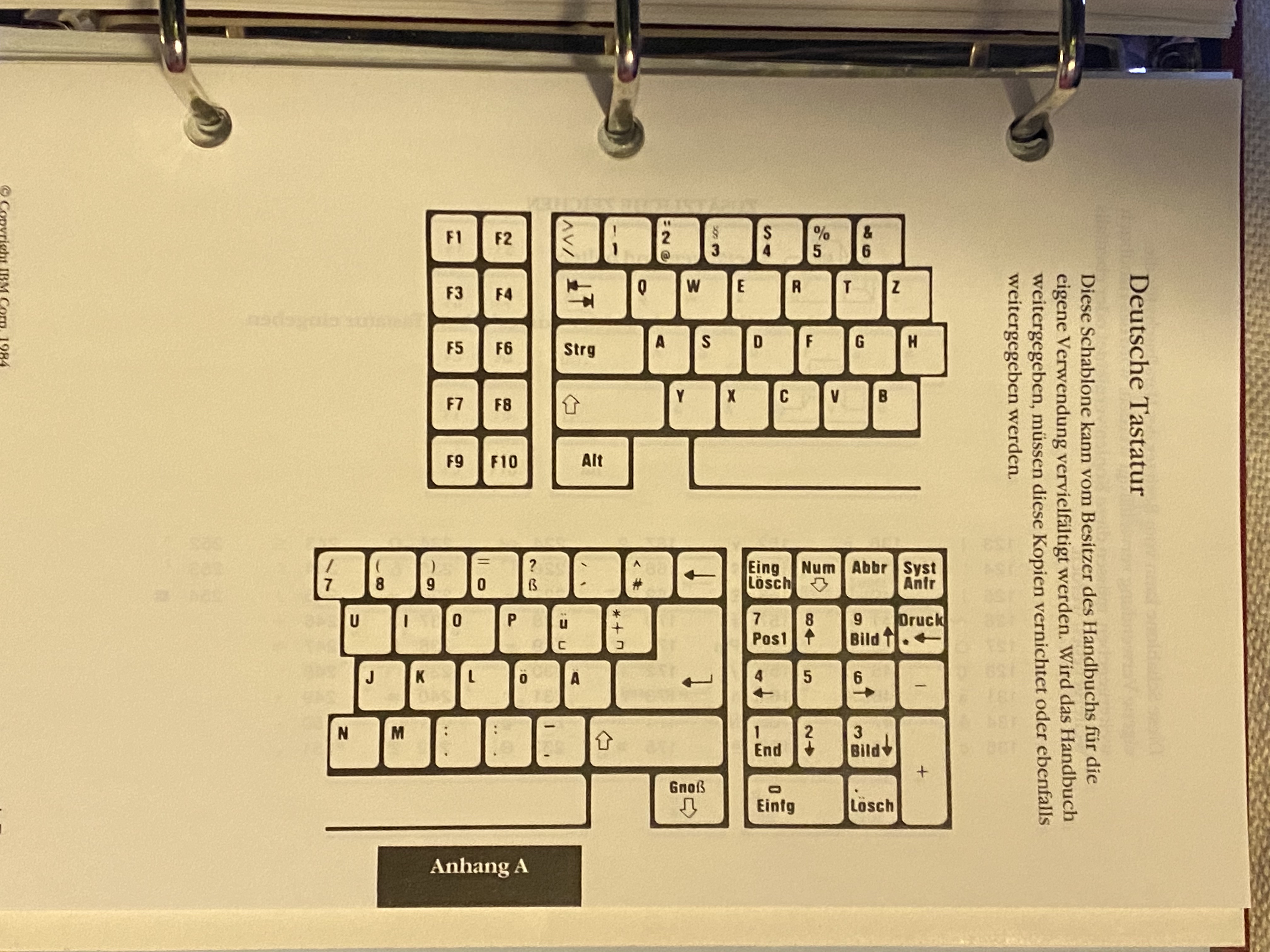

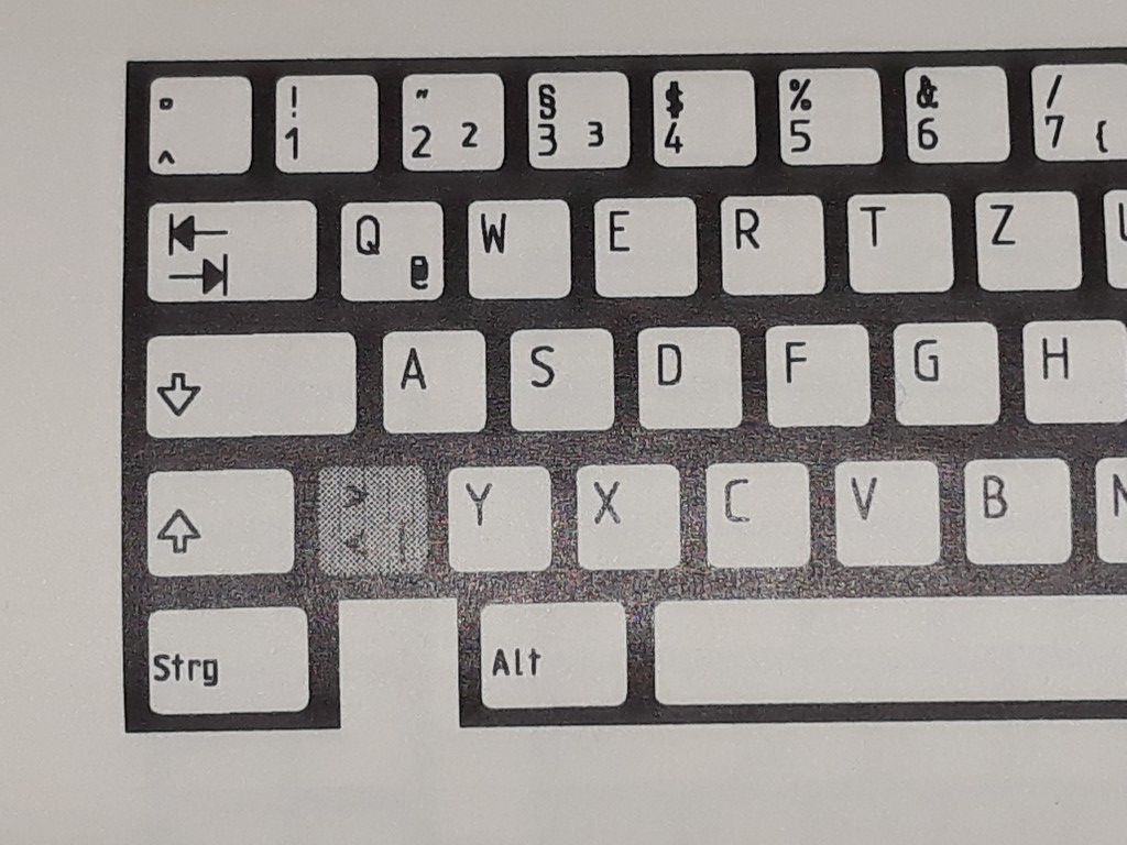

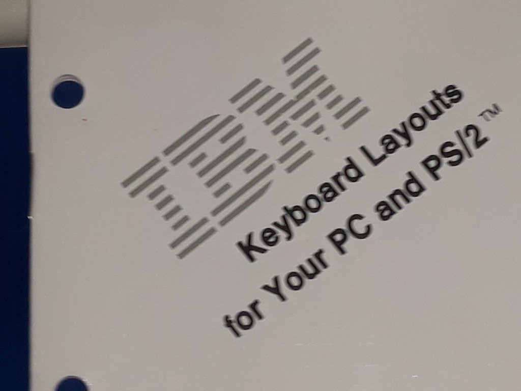

Okay, so I took a look at my old IBM manuals, and...
Indeed, where it comes to German keyboards, IBM used the icon exclusively on the Enhanced layout (and the PC convertible), "GroB" [sic] on the AT keyboard, and "Caps Lock" on the XT keyboard. But then, the XT keyboards of ALL national layouts had English legends on the modifiers; legends in Spanish, Italian, German and French didn't show up until the AT keyboard era.

Great feedback darkcruix, XCore and depletedvespene!
While the XT is the model for the project artwork, I am leaning towards the AT style "Groß ⇩" as the way to go. The standard HHKB ISO keys can be ordered by those who want to go with "Caps Lock" and/or "Ctrl" as well.

Wise choice (but DO remember the Swiss don't use the eszett).Zed wrote: 19 Apr 2021, 01:02 Great feedback darkcruix, XCore and depletedvespene!

I was not aware. Two years of High School German did not get to the differences in Swiss dialects! So 1.5U "Caps Lock" and 1.75U "Strg" as they are in the currently posted pics then? Any Swiss German customers care to chime in?depletedvespene wrote: 19 Apr 2021, 01:09Wise choice (but DO remember the Swiss don't use the eszett).Zed wrote: 19 Apr 2021, 01:02 Great feedback darkcruix, XCore and depletedvespene!
While the XT is the model for the project artwork, I am leaning towards the AT style "Groß ⇩" as the way to go. The standard HHKB ISO keys can be ordered by those who want to go with "Caps Lock" and/or "Ctrl" as well.![]()
Or "Grooss" ?

There is no specific Swiss layout in the handbook for the early IBM keyboards (I went as far as getting all of the "Technisches Handbuch" out for the models until 1984). When I look online Swiss layout uses Caps Lock or Caps for keyboards nowadays - this derives out of a Swiss norm that modifiers have to be language neutral (https://de.wikipedia.org/wiki/Tastaturbelegung#Schweiz). I found some stock photos of old typewriters of the era before the norm and there it was nearly always Fest (deriving from Feststelltaste) as the writing on it. See below:Zed wrote: 19 Apr 2021, 01:35I was not aware. Two years of High School German did not get to the differences in Swiss dialects! So 1.5U "Caps Lock" and 1.75U "Strg" as they are in the currently posted pics then? Any Swiss German customers care to chime in?depletedvespene wrote: 19 Apr 2021, 01:09Wise choice (but DO remember the Swiss don't use the eszett).Zed wrote: 19 Apr 2021, 01:02 Great feedback darkcruix, XCore and depletedvespene!
Or "Grooss" ?

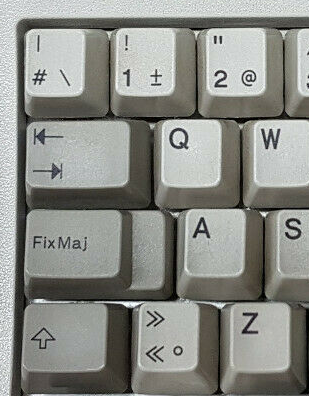

Hi all. I'm new to the forum, even though I follow this thread since I ordered an F77 a year and a half back.
Re. French layout, I didn't see any problem, until HHKB "Caps Lock" was mentionned. In order to be consistent with "Verr num" and other french localisations, "Caps Lock" should probably be "Verr maj". I'm not able to find proper historical labelling, but many of you seem to have the documentation.
I don't like "Verr maj" or "Verr num" or "Impr écran", but I'd rather have proper vintage labelling.
Nota : I'm not able to validate the Mac layout. PC is OK.
@Ellipse : since I ordered the HHBK layout, I will be receiving the "HHKB-ISO" keys (in French).
Will the regular Ctrl and CapsLock keys be also supplied (regular prints on regular key sizes), ie. will I be able to configure the keys with the standard Ctrl + CapsLock, and not the reversed HHKB ones ?
I don't know yet if I like those keys reversed...

I haven't seen any French (France) Model M keyboards with anything other than the icon on Caps Lock. French Canadian units, on the other hand, use "Fix Maj".sedevidi wrote: 19 Apr 2021, 12:25 Hi all. I'm new to the forum, even though I follow this thread since I ordered an F77 a year and a half back.
- frca.png (237.1 KiB) Viewed 9465 times
