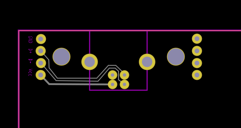

I am building test controllers now to verify that they work as expected, but they are not. But that might be an issue with the PCB I got from OSHPark.
I've had other projects fail when a strictly surface mount USB connector came loose, so now I like to use USB connectors with some pins. Notice that the holes on the board don't match the holes in the design. Apparently OSHPark does not do slots. I had to bend the "side" pins out just to seat the connector. The "back" pins fit in the holes, but looking at the scan - the holes are off center, so the pins must be off center too. I have two more PCB to try with - might just bend all the pins out of the way and see if that helps.

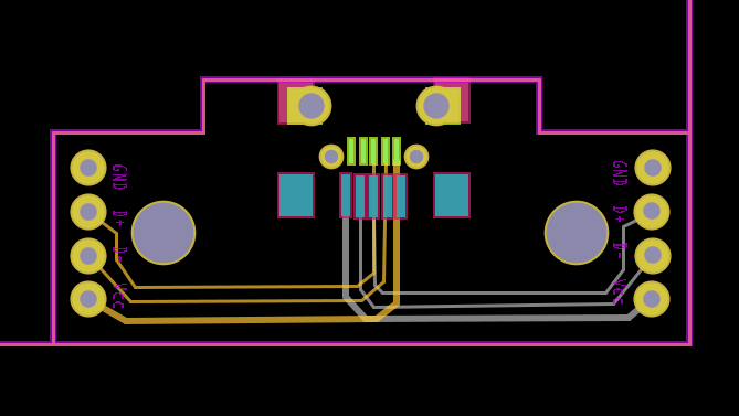

Gerbiegoo.
I hope that's helpful to some degree.
If you kill off USB-B entirely - :( - you can make that daughterboard less shapely, but you should definitely keep the extension away from the main board.
Mini one side, micro on the flip.
Micro is tested and awesome. I used a good through hole case mounting connector with SMT pads. Hirose I believe.
Mini is untested officially, but I'm pretty certain you'll have to break the little plastic nubs off of one in order for it to work. Those don't exactly seem to do much anyways, considering they break off very easily...
Or just kill mini and fit a USB-C connector there. That would rock.
Oh, and the through holes on the right hand side that don't connect to anything are only there for stability of the daughterboard. Standard break-away headers to connect the two boards together works really well.
(And you could technically flip it around so that the Micro connector is oriented right side up. It's currently upside down, but in my scenario I need it that way because of a slide switch underneath for bluetooth.)
(P.S. - my apologies for not having something more useful than gerber. Learning KiCAD or Eagle has not been high on my list of priorities.)

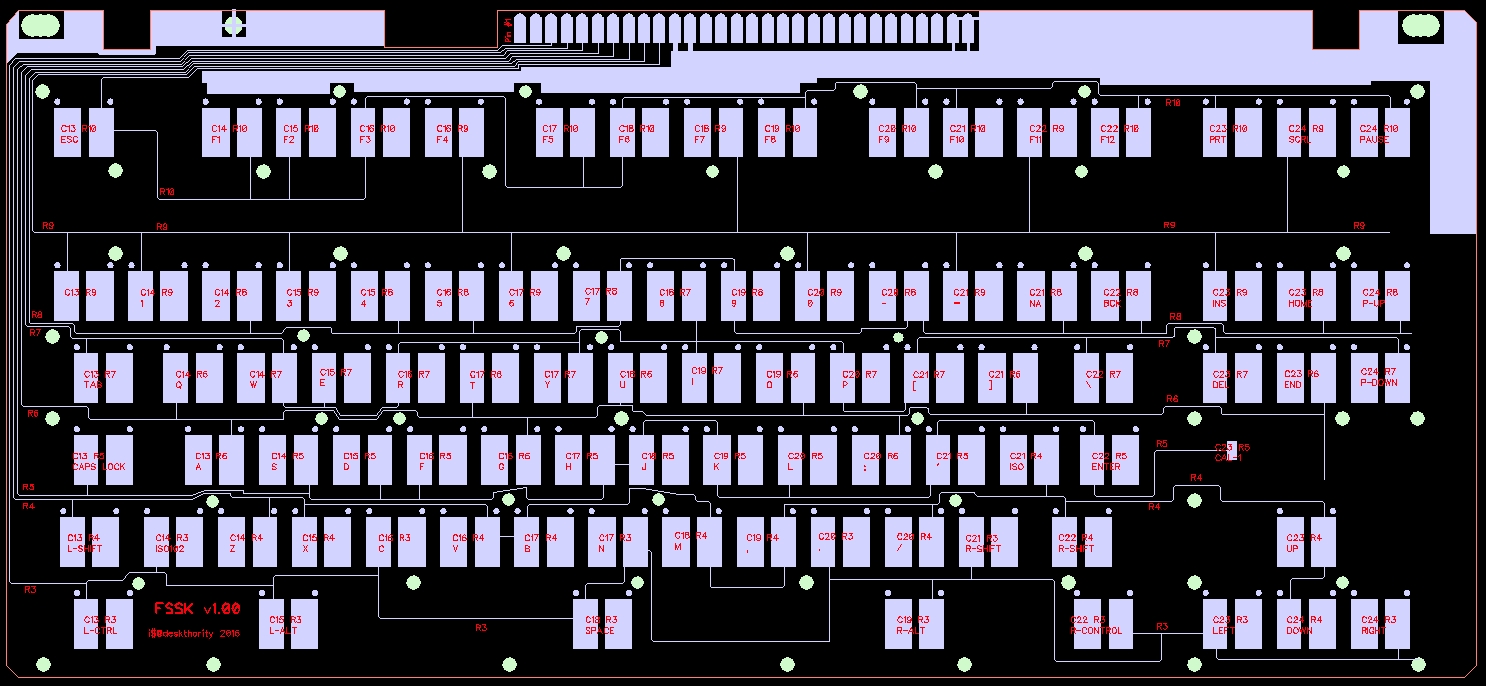

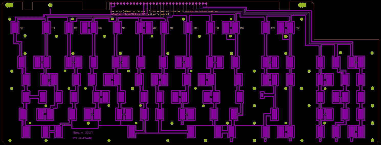

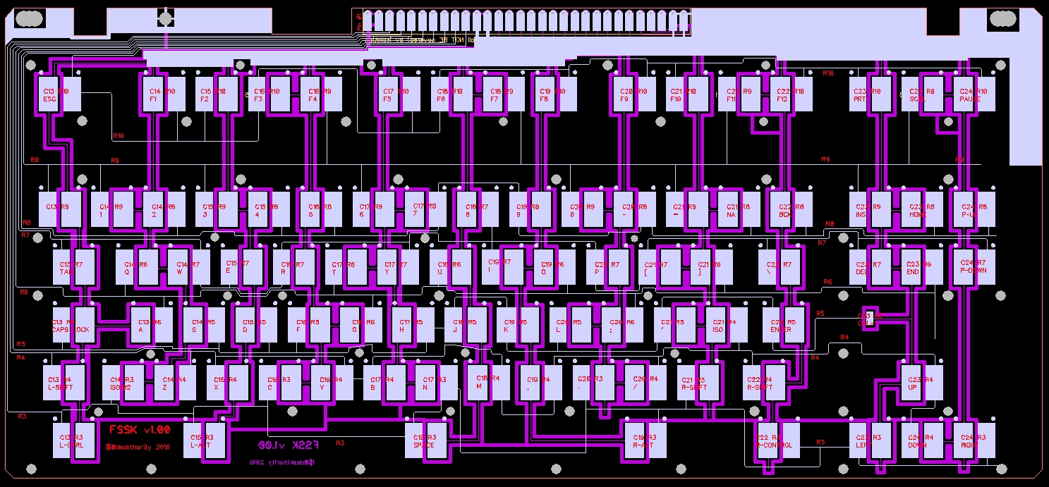

All,
I am ready with the updated version of the FSSK. It is called V1.00
Notes on this version
  • It is the same version as the prototype one with corrected errors.
  • It does not have the extra keys that XMIT suggested. This change required a redesign of two rows which add risk that I will not take in the production unit.
The pictures from the Gerber follow:
FSSK V1.00 - Top layer from Gerber.jpg (523.98 KiB) Viewed 23530 times
FSSK V1.00 - Bottom layer from Gerber.jpg (422.16 KiB) Viewed 23530 times
FSSK V1.00 - All layers from Gerber.jpg (693.06 KiB) Viewed 23535 times

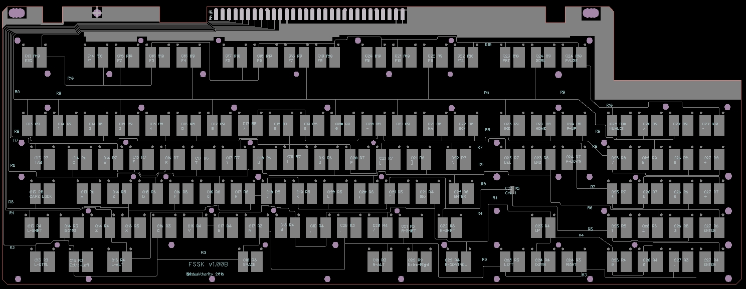

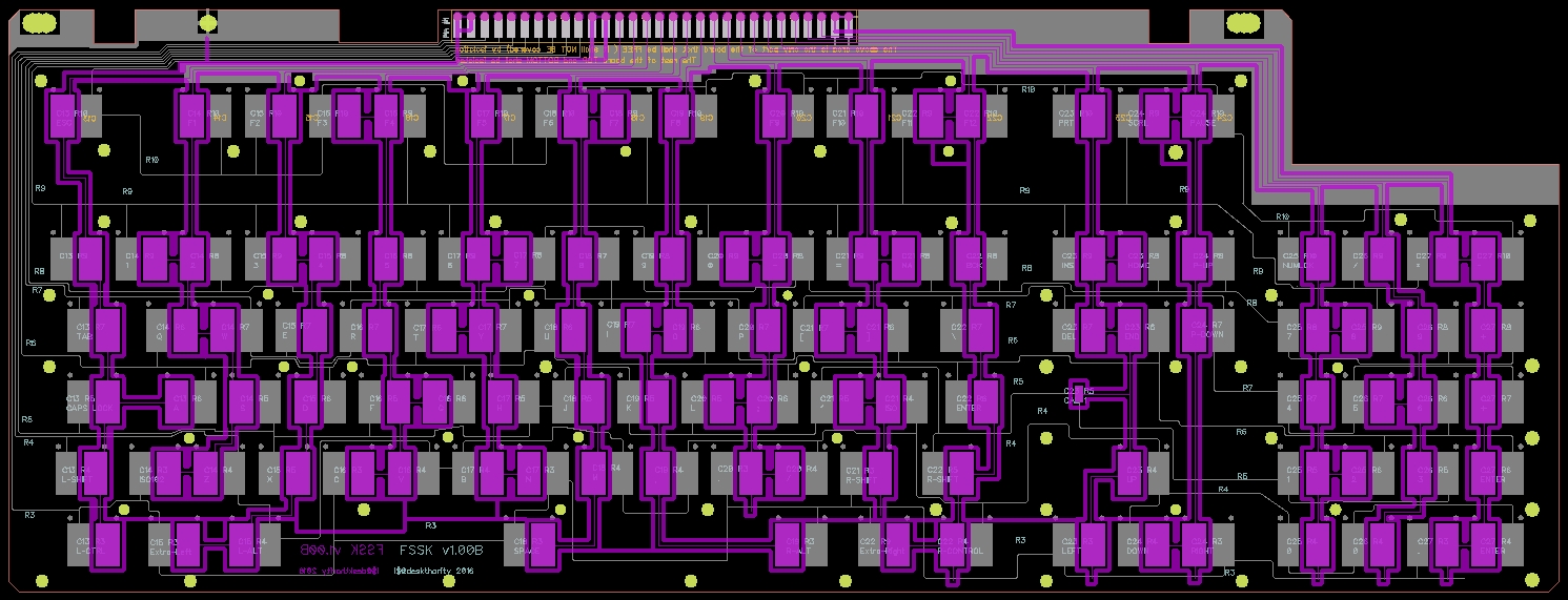

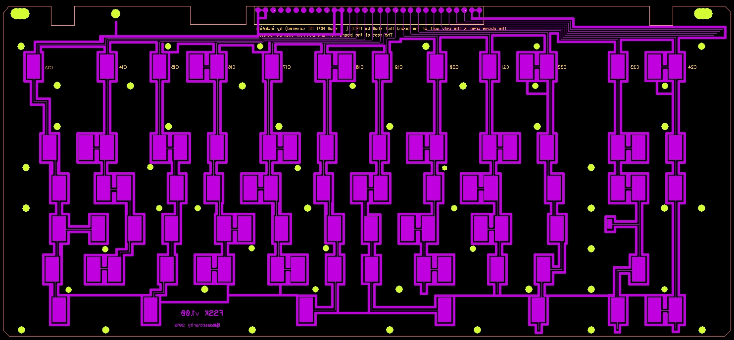

And here is the FEXT v1.00B (The B is to distinguish it from the FSKK v1.00 above)
The features on this file are:
  • FEXT files that could ALSO be digitally cut to create a FSSK v1.00B
  • Added extra keys con XMIT demand
  • Rework of two of the columns to achieve the above
I plan to order some of these also as prototypes during the Group Buy.
Here are the pictures:
FSSK v1.0 - Top layer from Gerber.jpg (363.74 KiB) Viewed 23528 times
FSSK v1.0 - Bottom layer from Gerber.jpg (356.58 KiB) Viewed 23528 times
FSSK v1.0 - All layers from Gerber.jpg (561.55 KiB) Viewed 23528 times

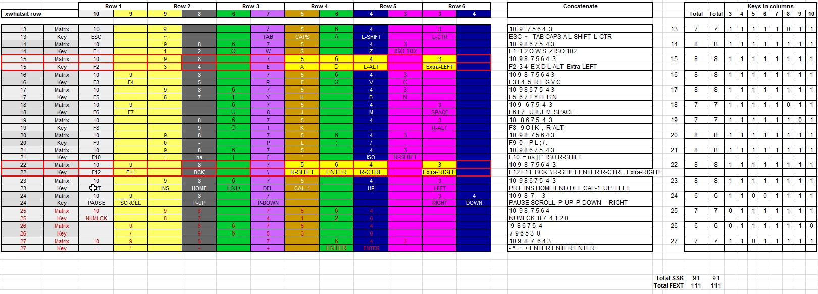

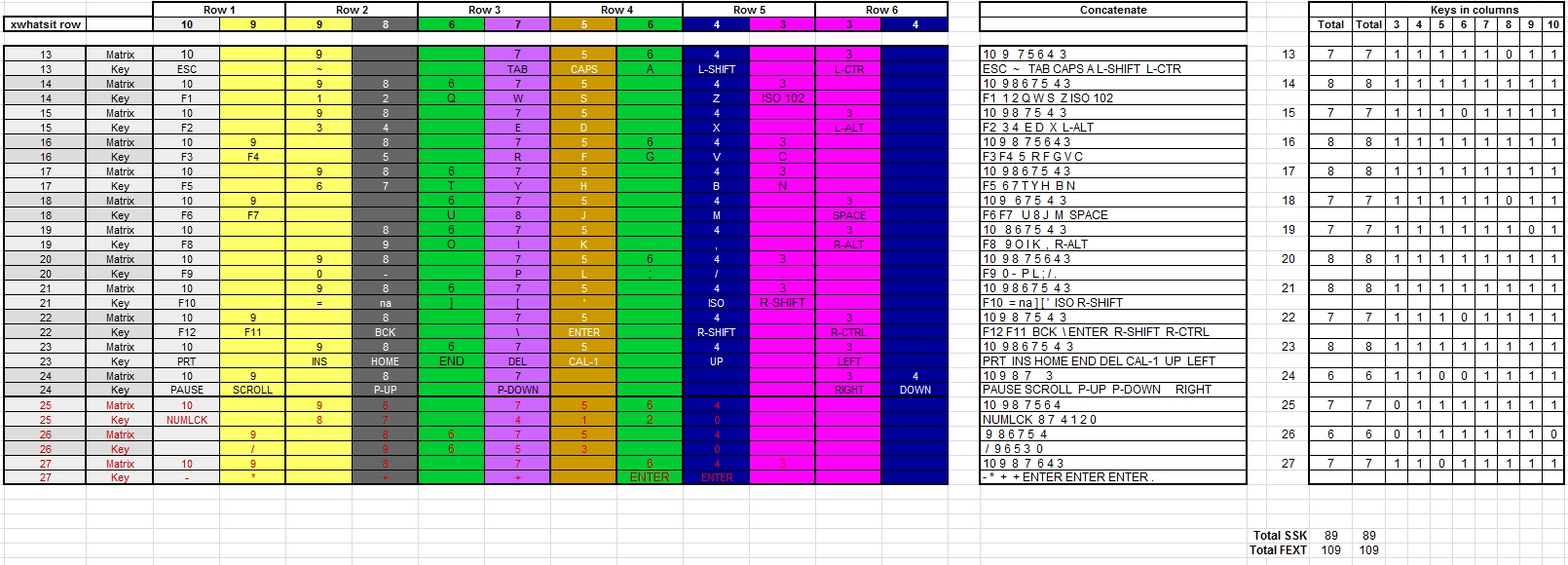

For those interested in the differences between the new Version V1.00B and the V1.00, following you can find the tables that I have used to check the design:
FSSK V1.00
FSSK v1.00 - Matrix table.jpg (643.52 KiB) Viewed 23494 times
FSSK (=FEXT) V1.00B
FEXT v1.00B - Matrix table.jpg (641.42 KiB) Viewed 23494 times
The keys that have been changed are marked in a different color.[/quote]

Essentially, using a FEXT v1.00B PCB, and cutting that down, would allow me to build an SSK with Winkeys, correct?
idollar
i$
01 Apr 2016, 22:07
shreebles wrote: Great!
There is no need to cut anything. The design (CAD files) is done in two parts. When put together create a FSEXT.
I can easily use the SSK part of the V1.00B to create the FSSK V1.00B from the FEXT V1.00B. They are basically the same thing !!!
Check the updates above with the design tables. It will help you to understand the concept.
Sumarsing : With the FEXT V1.00B board I will test the additional keys, the extended keyboard and the FSSK V1.00B all at the same time.
