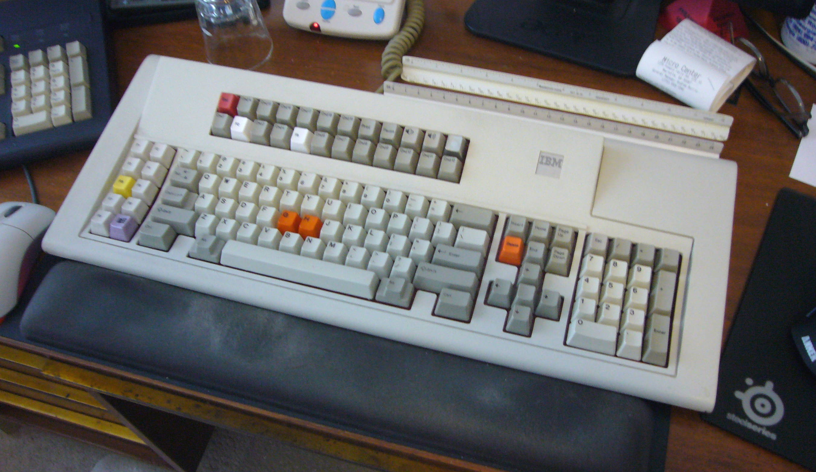

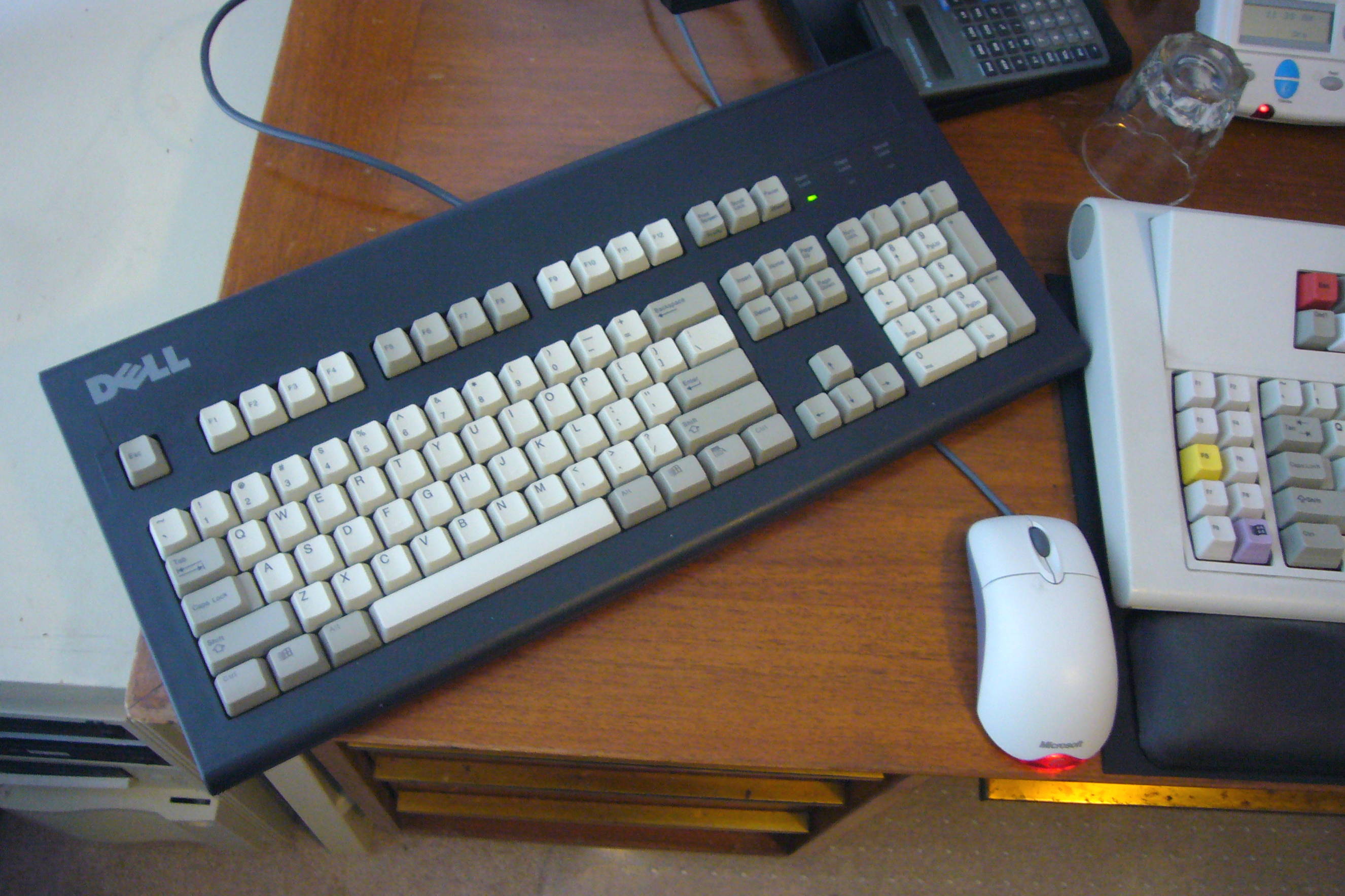

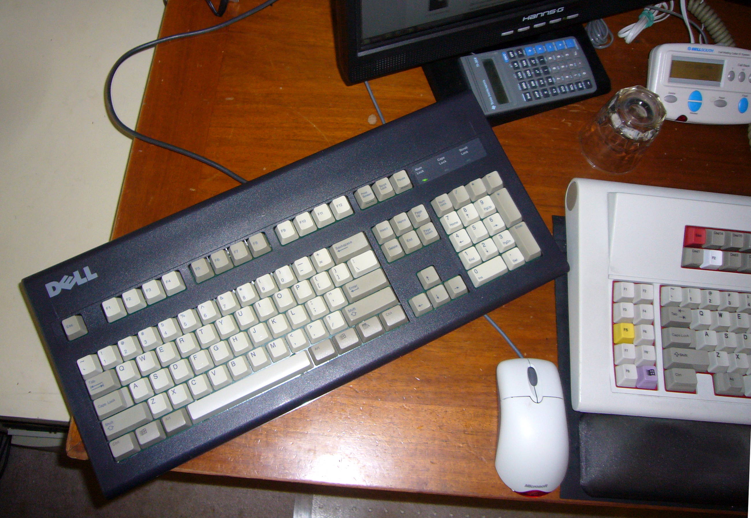

My "2nd" keyboard, behind the fully modded F-122 is an AT101W with orange Alps in a padded black case (with weight bar - a little Dremelling is required to force-fit in in) and beige PBT caps (except for the bottom row, of course).
It gets far more use than the Omnikey 101 with blues, but perhaps because that one is boxed tight in deep storage!

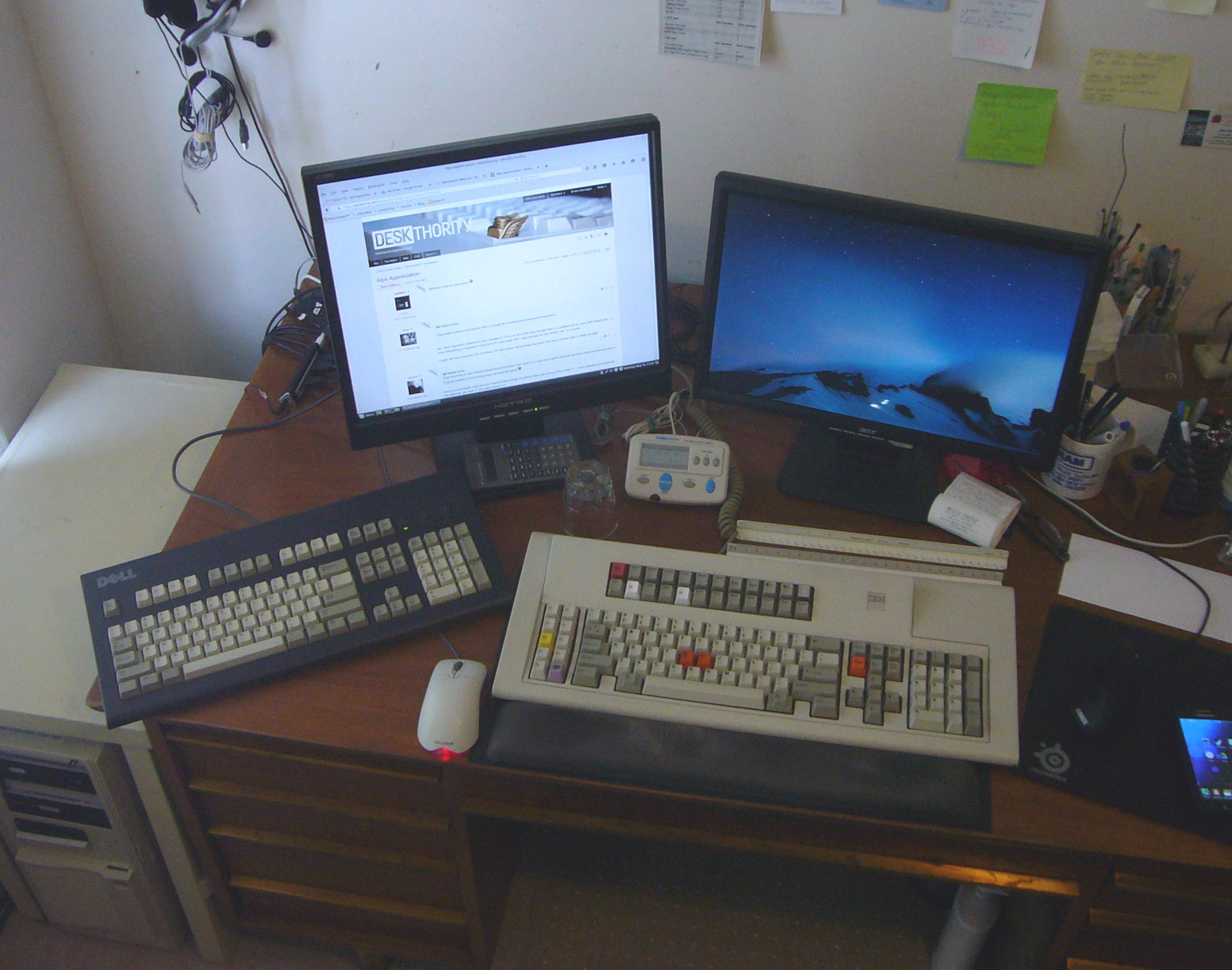

quickies
- k-overall.JPG (315.88 KiB) Viewed 6437 times
- k-101-no-flash.JPG (444.51 KiB) Viewed 6437 times
- k-101-with-flash.JPG (532.28 KiB) Viewed 6437 times
- k-122.JPG (395.16 KiB) Viewed 6437 times
