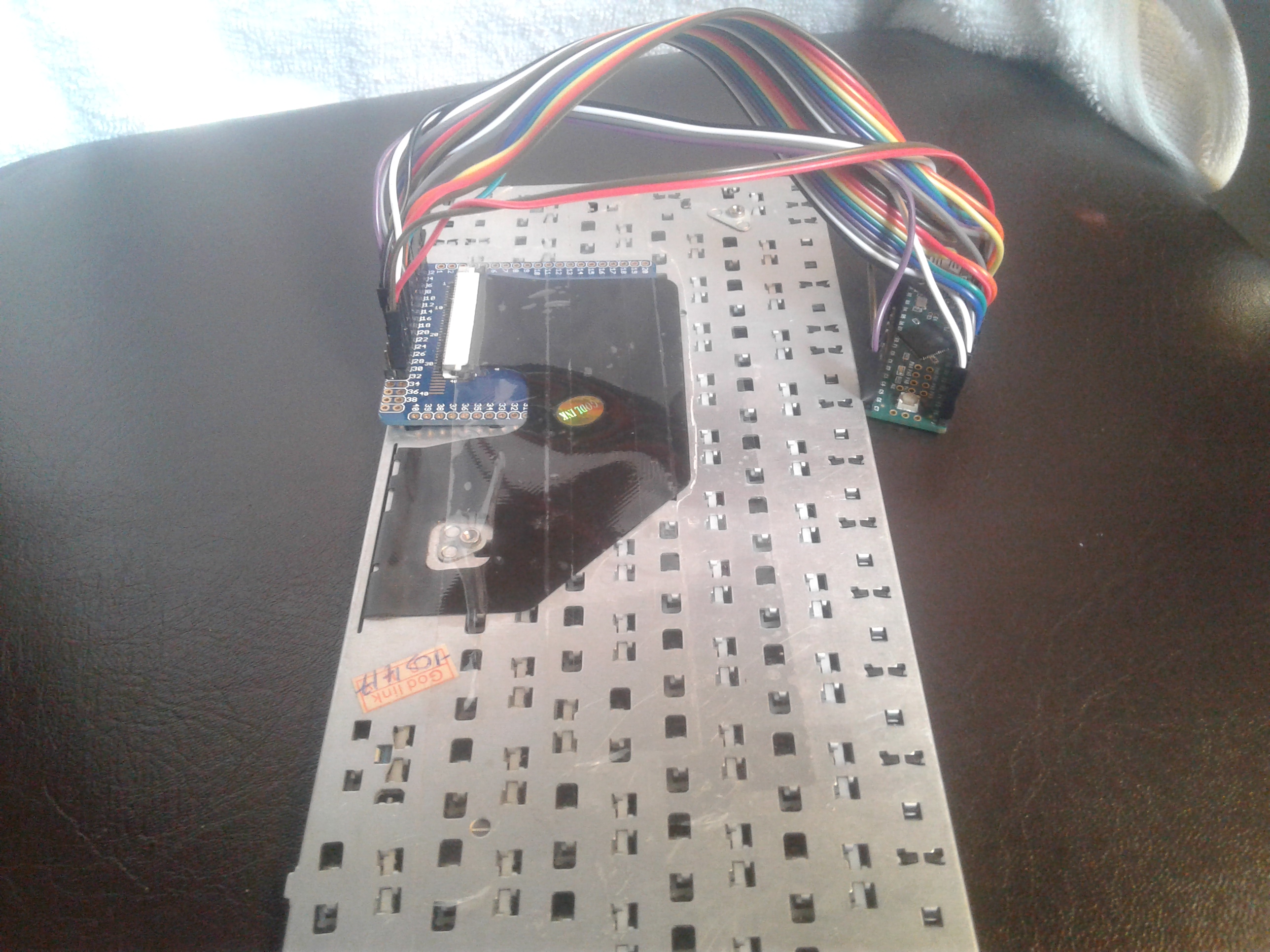

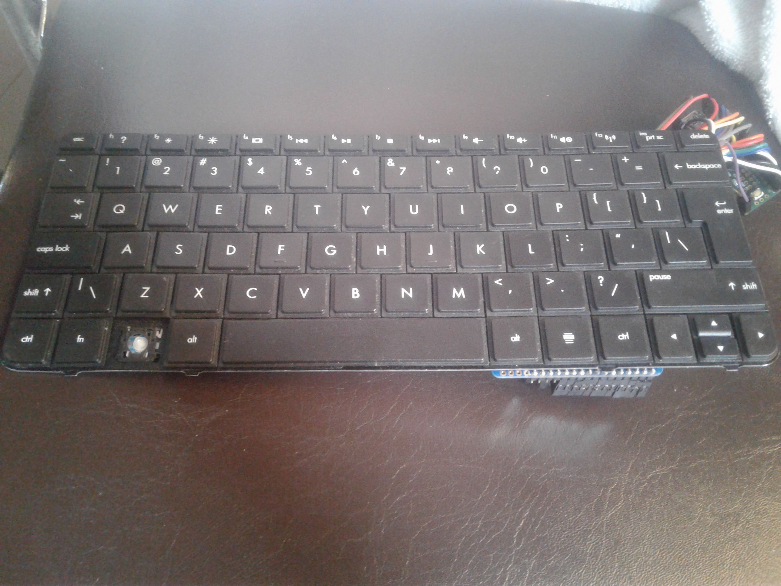

So I am trying to build my first custom Keyboard device. I decided to start simple with a Numpad. I also decided to go cheap so I bought a 3 pack of Kookye Pro Micro's (Lenardo Arduino) microcontrollers. I've got my matrix wired and now I'm working through the code here to try to make a simple 5 row x 4 column numpad (with a few No Connects). Here's the message I'm getting when I try to build the code with Cygwin64 Terminal. I'll preface all of this with the fact that I only took one C++ class in college and I was always having issues in the class due to the length of time it took me to even debug simple code I wrote myself so Unfortunatly you're working with a Noob Here. I saw Matt3o's walkthough and though. Hmmm I could probably do this but unfortnately I'm in a rut so I thought I'd post my code here and ask you experts how to clean it up.

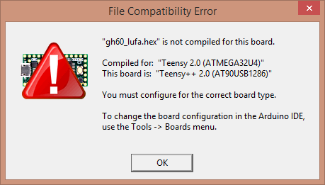

Error!
Error!

Please, I need help with a laptop keyboard. I have attached my matrix, pictures of the keyboard and the code used to build the firmware. I was able to build the firmware and my laptop recognises that a keyboard is connected but when I press a key, it does not output the key I have pressed. I have checked the wiring with the teensy thoroughly. My guess is that this problem is from my keymap on keymap_poker.c file but I am unsure of how to correct this

teyuze wrote: Please, I need help with a laptop keyboard. I have attached my matrix, pictures of the keyboard and the code used to build the firmware. I was able to build the firmware and my laptop recognises that a keyboard is connected but when I press a key, it does not output the key I have pressed. I have checked the wiring with the teensy thoroughly. My guess is that this problem is from my keymap on keymap_poker.c file but I am unsure of how to correct this
[/code]
Teyuze - could you give some more information on what keys are outputted when when you press a key? Is there a pattern to it? I completed my first completely custom keyboard yesterday after a couple of months of planning it and with a few hours of troubleshooting annoying issues it eventually worked perfectly (typing on it now) - so stick with it and you'll get there!

Picture of the bottom and solder connections
I really hope someone can help me out here or atleast point me in the right direction i want this thing to work so bad :)
