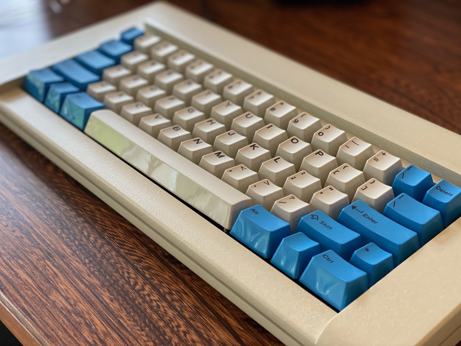

I also wanted to share with permission another great customer image. This one shows the pearl keys and Industrial SSK Blue keys:

man thats pretty... If i didnt need the arrow keys so much at home i'd totally have gotten the 62 key hhkb...Ellipse wrote: 14 Jul 2021, 01:56 I also wanted to share with permission another great customer image. This one shows the pearl keys and Industrial SSK Blue keys:

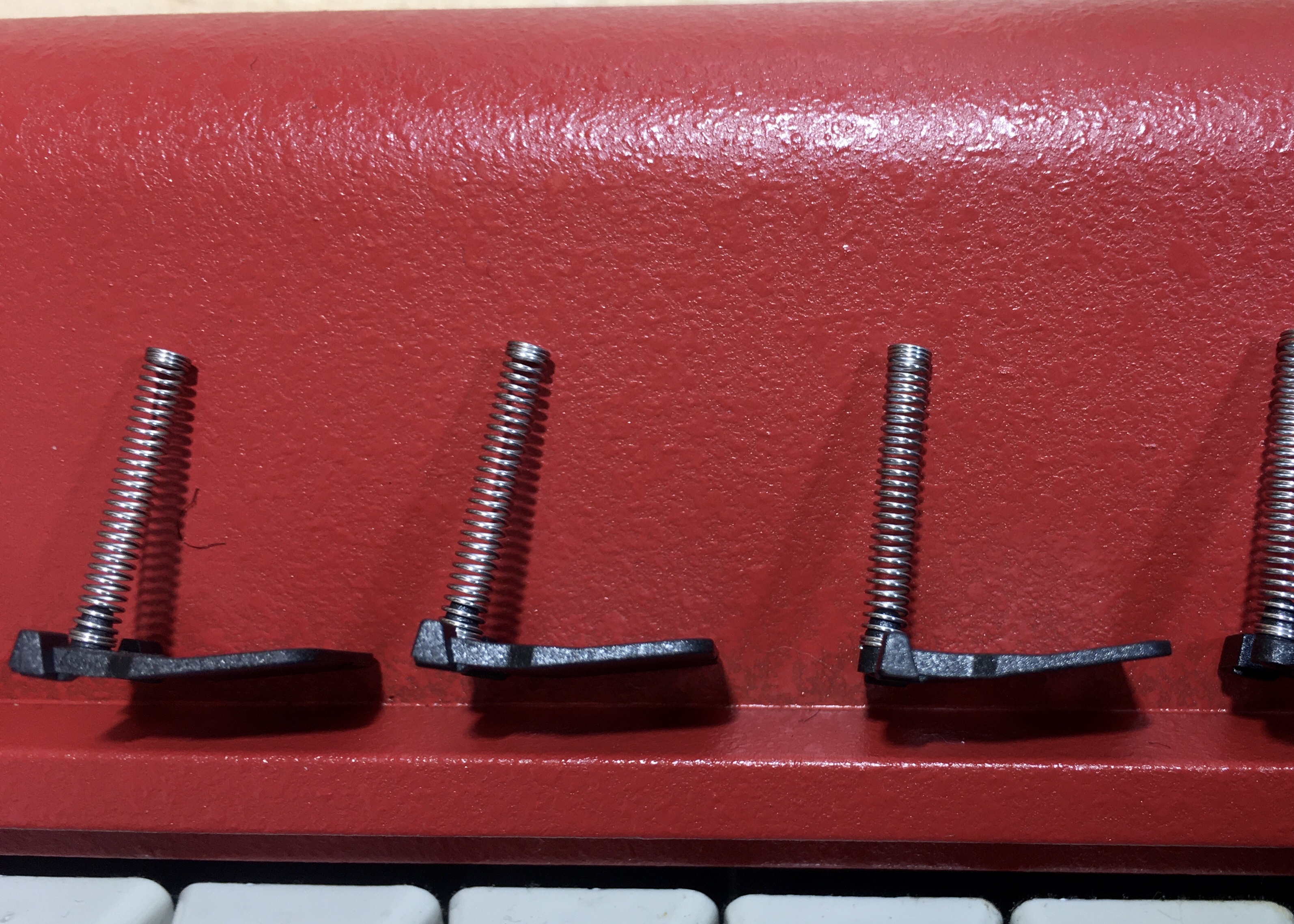

Has anyone spray painted their F62/F77 ?
Wanted to understand how lasting that would be and whether the textures will be retained.

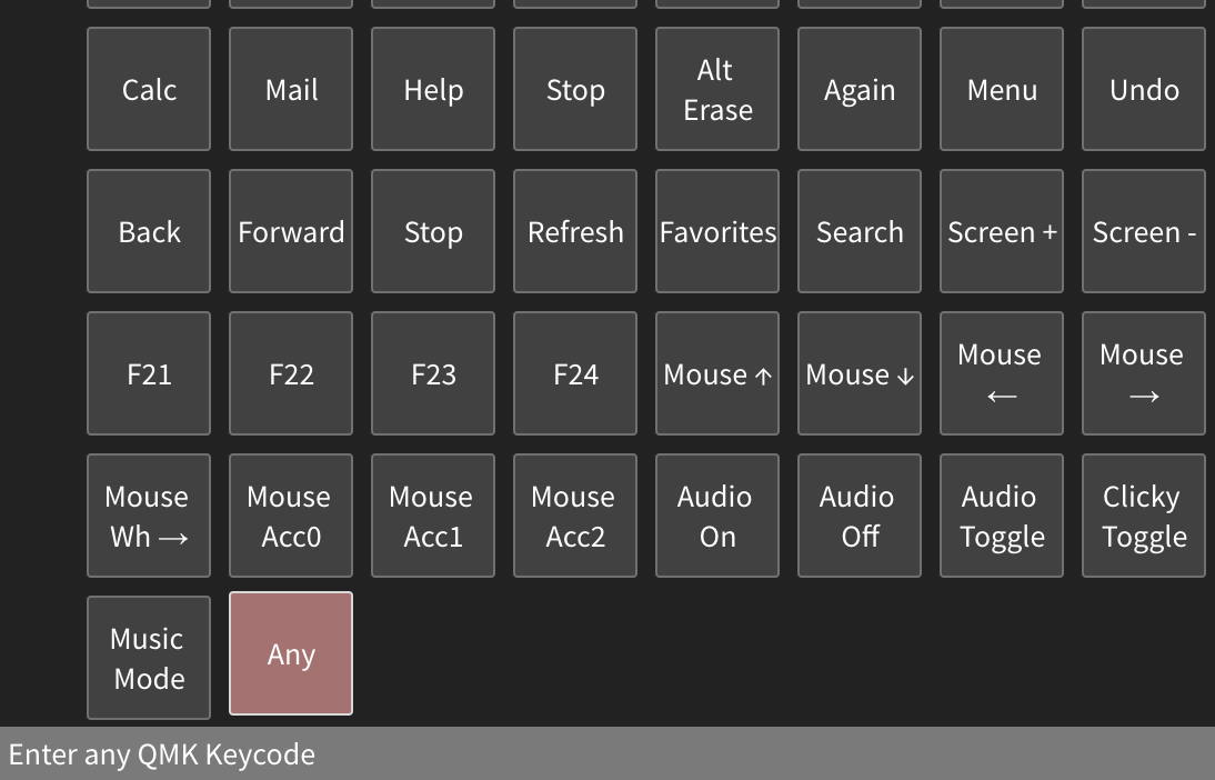

You can do something very similar in VIA using Mod-Tap.chayu wrote: 15 Jul 2021, 15:211) If you use the right side modifiers, you can Copy the same “tap” functionality: tap to access arrow layer for one press, hold to use RS, RAlt, etc. Hold fn + RS/RCtrletc to hold an arrow key. This is how the Anne Pro 2 handles arrows. IIRC LT (what this is called in QMK to get this working) is not doable in Via.nickg wrote: 14 Jul 2021, 22:21 man thats pretty... If i didnt need the arrow keys so much at home i'd totally have gotten the 62 key hhkb...
Allow me to quote from a quick start guide I am writing with darkcruix:
For some users, the decision between an F62 and an F77 keyboard comes down to the need for a navigation cluster and in particular for arrow keys. To be sure, it is possible to have the keys of the navigation cluster on a different layer. That is how the F62 keyboard is programmed by default. However, this means that you need to press a function key to activate that layer and at the same time press the key corresponding to the arrow key. This makes typing further key combinations with that arrow key awkward.
Wouldn't it be cool if you could make the right Shift key function also as an Up Arrow key, the right Alt key also as a Left Arrow key, the right Windows key also as a Down Arrow key, and the right Control key also as a Right Arrow key? In other words, wouldn't it be cool if these modifier keys also functioned as arrow keys in an inverted-T layout?
Incidentally, this might even be of interest for users of the F77 keyboard, who have the right block set up to function as a complete num pad and then have to press a function key to access the navigation cluster on a different layer. Having at the same time both the arrow keys /and/ a num pad active could come handy. And finally, on both the F62 and F77 keyboard, this modification makes it easier to reach the arrow keys from the home row.
Without further ado, how is it done? Again [...] by using Mod-Tap. First, click on the right Shift key in the keyboard layout, then on the Any key. No, not the Any key from the old "PRESS ANY KEY TO CONTINUE" joke. VIA does have an actual Any key. You can find it under the SPECIAL menu at the very end of the list of keycodes:
Enter the following command on the line in the pop-up window:
MT(MOD_RSFT,KC_UP)Right Alt (leftmost right modifier):
MT(MOD_LGUI|MOD_RGUI,KC_LEFT)Code: Select all
MT(MOD_LALT|MOD_RALT,KC_DOWN)Code: Select all
MT(MOD_LCTL|MOD_RCTL,KC_RGHT)An additional modification would be to use the middle right modifier to switch to another layer temporarily, i.e. as long as it is held. I like to do that because the right GUI key is in a convenient location but not often used by me otherwise.
Warning: Before you set up a key for layer switching, make sure that key is transparent on the layer it switches to or else you will be stuck in that layer. You do that in the keyboard representation on VIA by first choosing the layer the key will switch to, and then clicking on the key that will switch to that layer. Then click on the Any key and type KC_TRNS.
Now back to how you make the middle right modifier act both as Down key and as layer switching key. Layer switching cannot use the Mod-Tap prefix, but must use a layer switching prefix. You go back to the base layer (0) and first click the middle right modifier and then click the Any key. In the pop-up window you enter the following keycode:
LT(1,KC_DOWN)HTH
Edit: Corrected a typo in the keycodes (KC_RIGHT -> KC_RGHT). Thanks for pointing it out, xyzzy!

Thanks a lot! I was used to this configuration on my F62 with QMK, but haven't been able to reproduce it since switching to Via! That's really cool!troglotype wrote: 15 Jul 2021, 17:43 You can do something very similar in VIA using Mod-Tap.
Careful, there's a typo: the "keycode right" command is "KC_RGHT", so the full command for the bottom right key is:troglotype wrote: 15 Jul 2021, 17:43 Right Control (rightmost right modifier):
MT(MOD_LCTL|MOD_RCTL,KC_RIGHT)
MT(MOD_LCTL|MOD_RCTL,KC_RGHT)Thanks again!

This looks fantastic. These keyboards are a bit difficult to properly capture the textures in photos. So far, this is one of my favorite photos, as it really captures the feel of seeing it in person.Ellipse wrote: 14 Jul 2021, 01:56 I also wanted to share with permission another great customer image. This one shows the pearl keys and Industrial SSK Blue keys:
I'm typing this on my F77 that arrived several months ago, still with my 15 years used Model M keys. It feels just as good as the day it arrived, and the worn keys really give it that 'old friend' feel. I'm salivating at how great the new keys will be, and I'm happy to wait for them. I was one of the wierdos who ordered custom keys with homing bumps, it's going to be a perfectly customized experience.
I'm not sure if it helps the impatient, but Ellipse was able to send my second F77 more quickly than expected when I switched my order from the nav cluster to the numpad, like my first F77. I'm guessing this meant he didn't need to flash a different firmware, so the board was able to ship with less work for him. That's just me speculating, I could be totally wrong.
No matter what, I'm elated to be typing on this incredible machine, and I'm extremely grateful for him following through with this project to the absolute best of his abilities. It's an act of passion that obviously consumed much more of his effort than originally intended. I'm going to be proud of using these keyboards for years, hopefully decades.
And you know what? If I was rich as heck, I'd buy his $4k spacesaver just to show him how much I love these model F's. I'd probably never open it, and never get my money back on it, but I wouldn't care because I was throwing rich guy money at what I like. Somebody just paid around 1.5 million for a mint, unopened copy of Super Mario 64. That's the collection business; It's based on passion, revolves around disposable income, makes no logical sense, and everybody in the business is hoping for a rich guy to walk in and make it your lucky day.
(it took me quite a bit to understand why it wasn't accepted)Code: Select all
Thanks again!

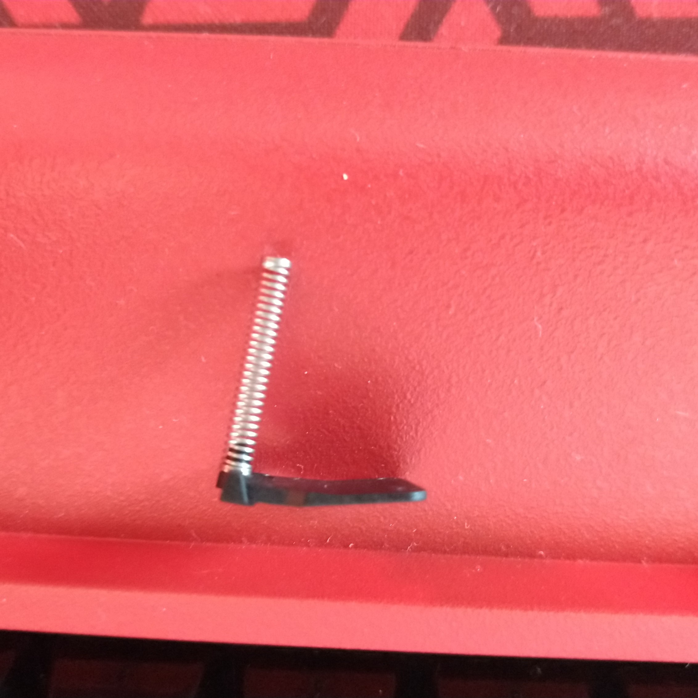

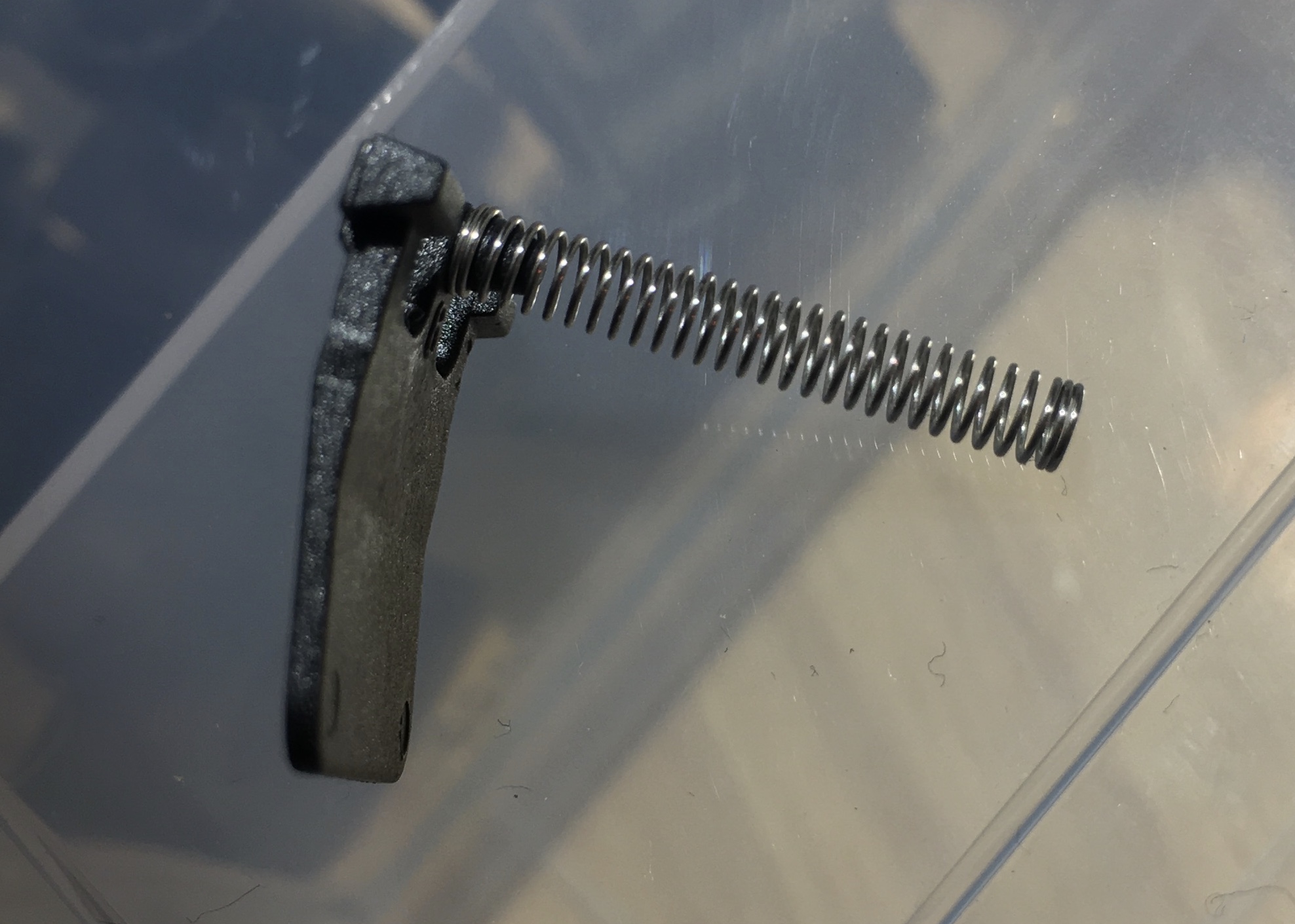

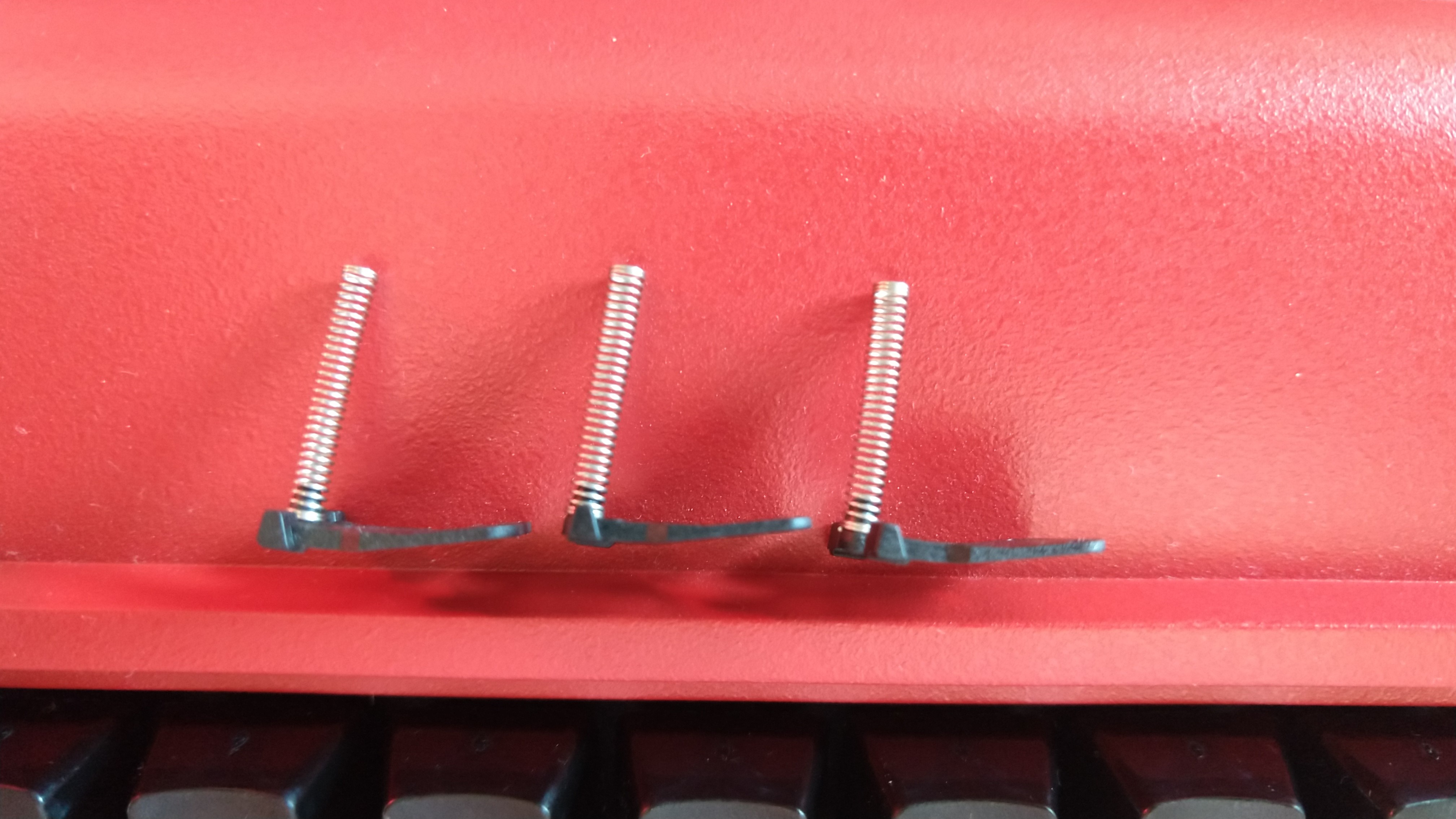

Several of the springs in my F62 (the ones that felt softer) and some of the springs included in the bag of 77 that I ordered are slightly damaged. Is this happening in transit or is this happening during production?
The pearl spacebar has some kind of flashing defect on the inside of the stem, which is what was causing the roughness. I can't really use it so that pearl set is as good as useless for now. I'm using the black set I ordered, which doesn't appear to have the defects (and doesn't feel as bad as the black set I ordered with my F77 two years ago)
The assembly isn't "happy" and the plates are fighting apart. This is despite opening it, ensuring all tabs were straight and even adding a bit of curvature to the barrel frame (which was unevenly curved without me touching it). Model F plates should conform to their curvature, even when thick replacement foam mats force them apart. With the case screws tightened normally (not overtightened), this is somewhat remedied, although it shouldn't be the case. What's going on here?
I did notice the new barrels are much shinier and more slippery in texture than the older ones from my F77, as well as original Models F.

I have updated my post. I'm not imagining it, am I? This can't be normal. I've looked at many good condition Model Fs and the springs aren't like this.

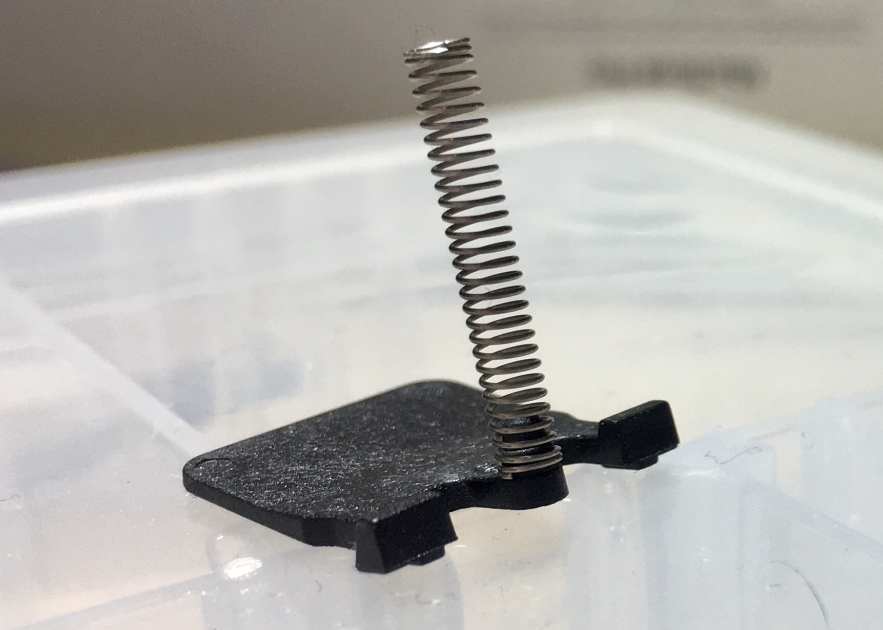

You have the same colour case as meWazrach wrote: 20 Jul 2021, 10:16
I’m attaching pics of my springs. Do they look a bit straighter maybe?
- Wazrach
- Location: Tyne and Wear, United Kingdom
- Main mouse: Razer Viper 8KHz/ Viper Mini
- Favorite switch: Buckling springs
I do love the case, it's so gorgeous. Yeah, your springs look straighter than mine. I was still able to fill my F62 with mostly straight springs, but it's still worrying.Pete wrote: 20 Jul 2021, 12:04You have the same colour case as meWazrach wrote: 20 Jul 2021, 10:16
I tweaked the tabs some more and quietened the spacebar a little bit. The keyboard is now closer to perfection. I think the keys will become smoother with a bit more use. My theory for why they're rougher is because there is less play compared to original Model F keycaps.
