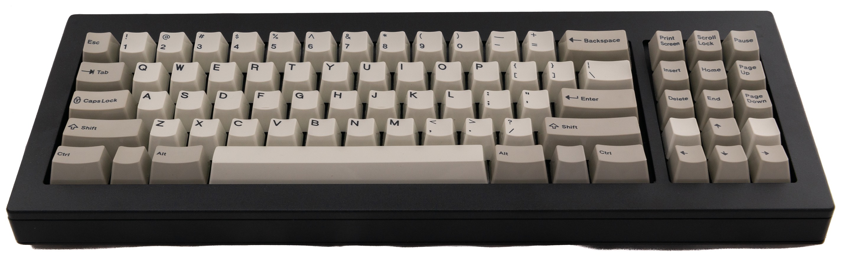

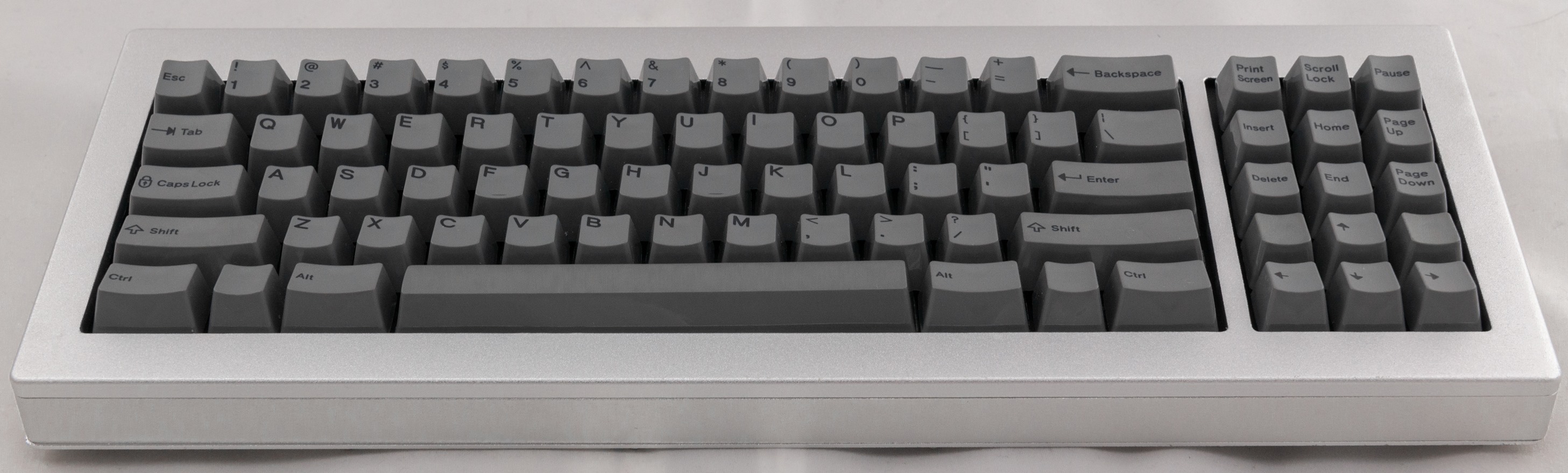

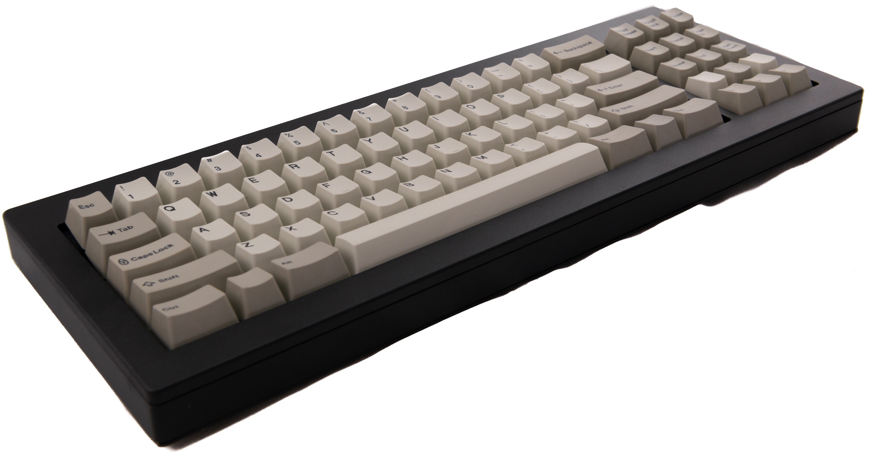

Also we have photos of two variations today: the compact cases, both regular gray and black case colors, with the 60% dark gray printed keys and also the standard pearl/pebble printed keys.

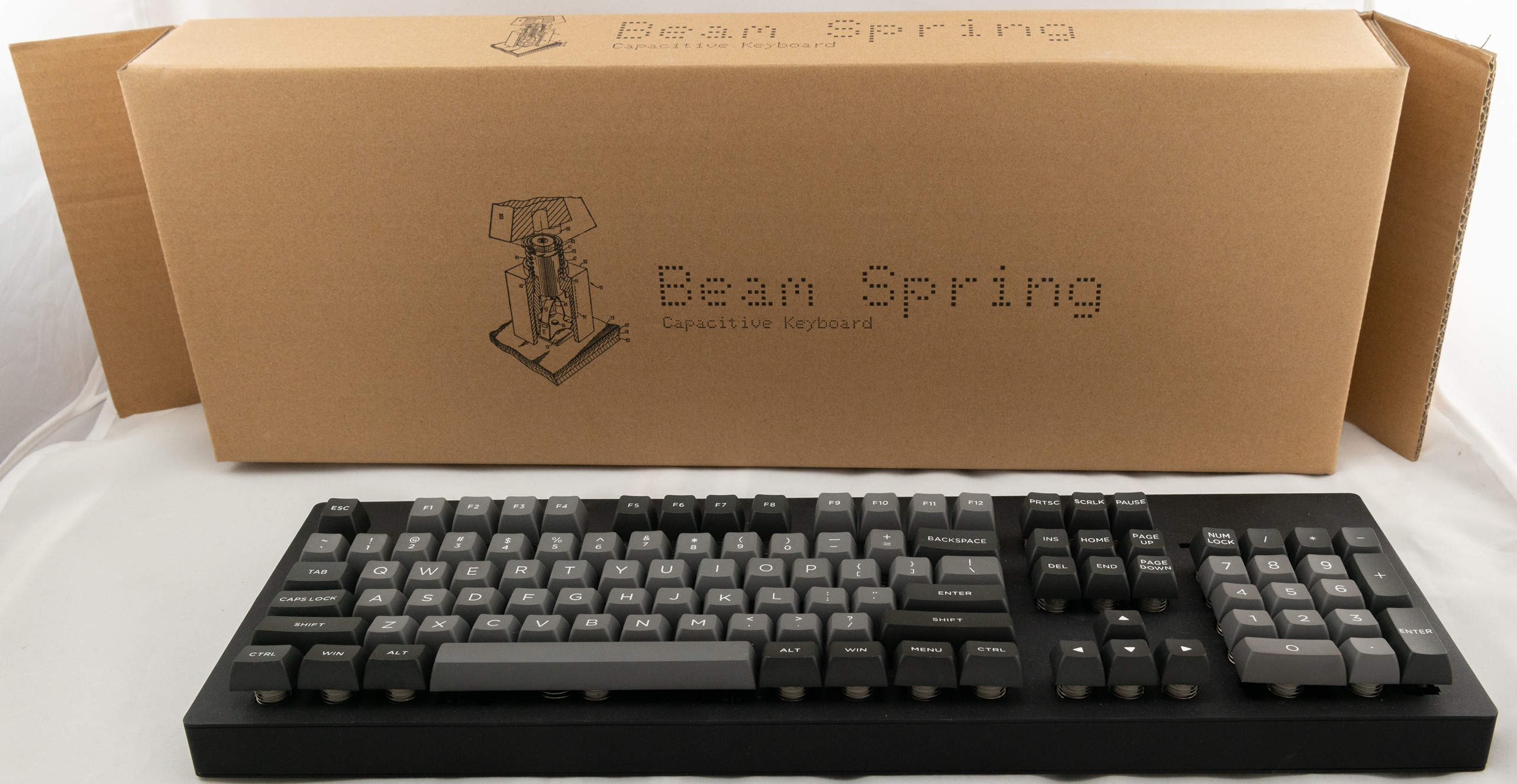

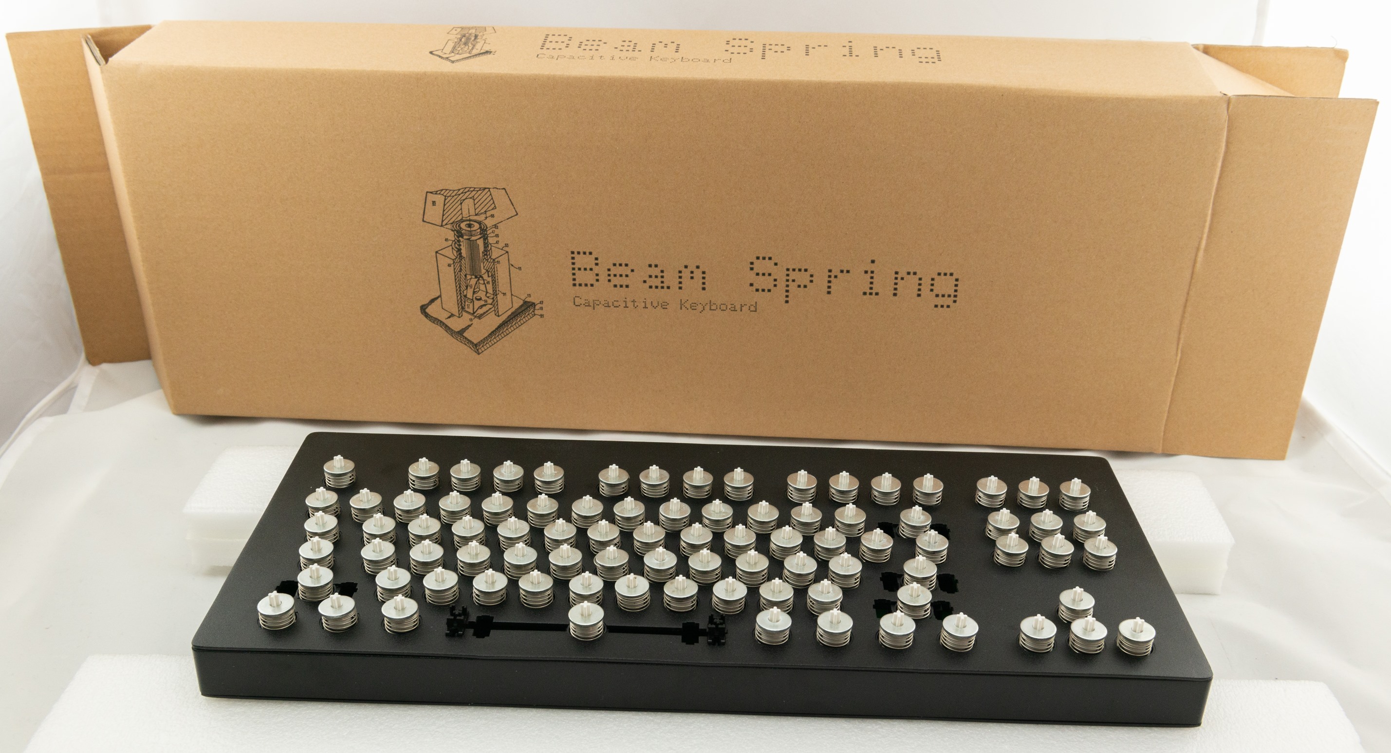

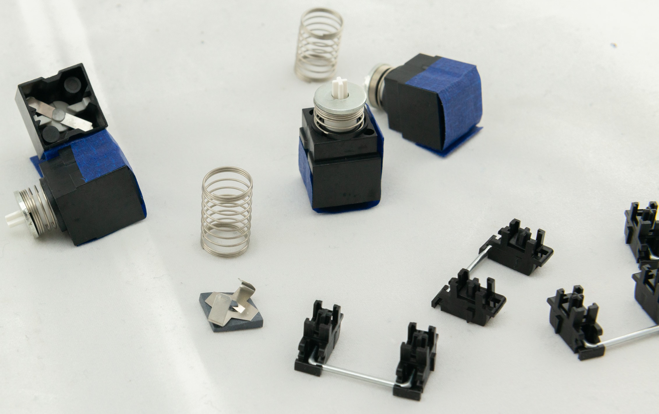

Today is the public launch of the Brand New Beam Spring Keyboards Project!
This was designed to be announced after the new Model F project ended but there was another project in the works to reproduce the beam spring module exactly (good for the purposes of spare parts for the original keyboards), so I thought it would be a good time to post. My modules are not backwards compatible with the original IBM beam spring keyboards. They have been redesigned to be used with Cherry MX type keys natively and to remove all of the wasted space in the modules and in the beam spring cases, while maintaining 100% original key travel and the same exact specifications for the fly plates, beam module footprint, etc.
For now you should check out the photos on the thread linked to below and sign up on the interest form if interested.
https://docs.google.com/forms/d/e/1FAIp ... p=sf_link
Please keep all beam spring discussion on this separate thread only so as not to add confusion to this current thread.
Details on the features and pricing are in this separate thread:
viewtopic.php?f=50&t=26174&p=491823
Important note: To repeat what I posted on that thread, the new beam springs don't ship and are not a focus until I've sent out the new Model F Keyboards. The Model F project was not delayed to finish these beam spring keyboards. More details are in the above thread.
2021-08-06_23-44-58 - Copy.jpg (670.13 KiB) Viewed 11327 times

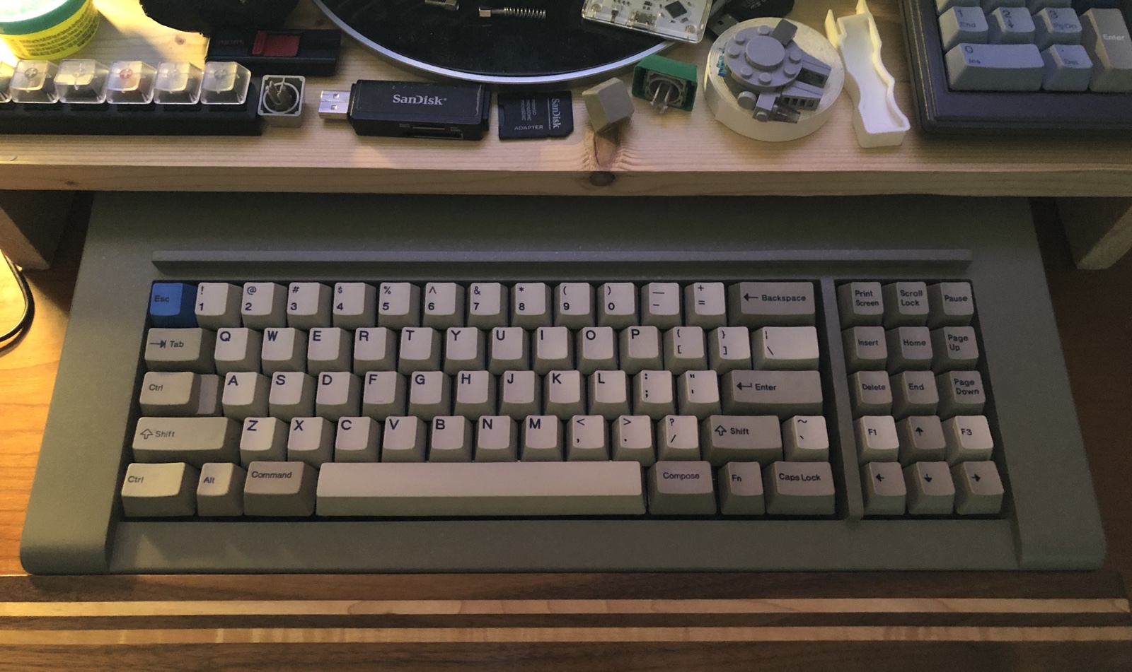

Got my Industrial Gray F77 keyboard! Is another review necessary? No, but here's one anyway.
Only one keycap came pre-installed; the spacebar. I did have to press it about a dozen times before it would spring back reliably. But after that, I was pleased to find that both the hardware and the firmware worked perfectly.
Windows is not my primary operating system. But since I had access to it, configuring my layout was not especially difficult using the recently published tutorial video (no doubt made in response to Chyrosran22's review, so… thanks, mate!) I hope the QMK folks let this support out of beta soon, because personally I find it a lot easier to work from the main github repository and the command line.
I don't believe I had touched a Model F in good repair since the 1980's, but the way this keyboard sounds and feels comports closely to my recollections. Haven't used the integrated pencil holder yet, but when I do, I bet it will be awesome. :)
The keycaps look terrific, especially my Mopar Blue Escape key. I've had to temporarily substitute a few (old) Unicomp ones, and they stick out.
My interactions with Ellipse have been extremely positive.
I prefer full-sized keyboards, so doing without a true, 4 key-wide embedded numpad and a full set of dedicated function keys has been an adjustment. I plugged in an external (Alps) numpad, but the margins on the F77 are so large that it's kind of awkward to use them in tandem. Whatever… this keyboard is so good I can learn to live with it.
Here's my obligatory custom layout.
I have "Show Application Windows" mapped to F1 and "Mission Control" to F3 and I use both of them a lot, so I dedicated real keys on either side of the Up Arrow key. Print Screen is mapped to take screenshots, and I use that a lot, too. Scroll Lock and Pause are cool, but I'm not using this keyboard with DOS or Windows MS Excel. So I mapped them to the Next Track and Play media keys, to use with the application that replaced iTunes.
Redundant Command/Windows and Alt/Option keys have always seemed like a waste to me, so I repurposed those spaces. I appreciate knowing the Fn key is there, but I almost never touch it. I have two left Control keys, because alternating between too many keyboards with inconsistent layouts has ruined my muscle memory for remembering which position it's supposed to be in. I also added a Compose (Menu) key, which I occasionally find useful but largely just think is neat.
Having Escape on the number row and keys adjacent to the nav cluster still feels strange, but I expect I'll get used to it. I moved caret/tilde next to the HHKB divided right shift for lack of a better option. Looks a little weird, but works.
I have used Hasu converters to remap keys on a Model M in the past, but the reprogrammable firmware on the F77 requires fewer cords and works more reliably when used in concert with USB switches.
So there you have it. This keyboard has replaced the new Unicomp Model M as my favorite. It has peculiarities to be sure, but nothing that's serious unless you have frequent need to enter in a lot of numbers (or are a heavy function key user.) In my fantasy, I still wish the new Model F's had included an F107 option. But if I'm being honest, I'd probably miss the desk space.
