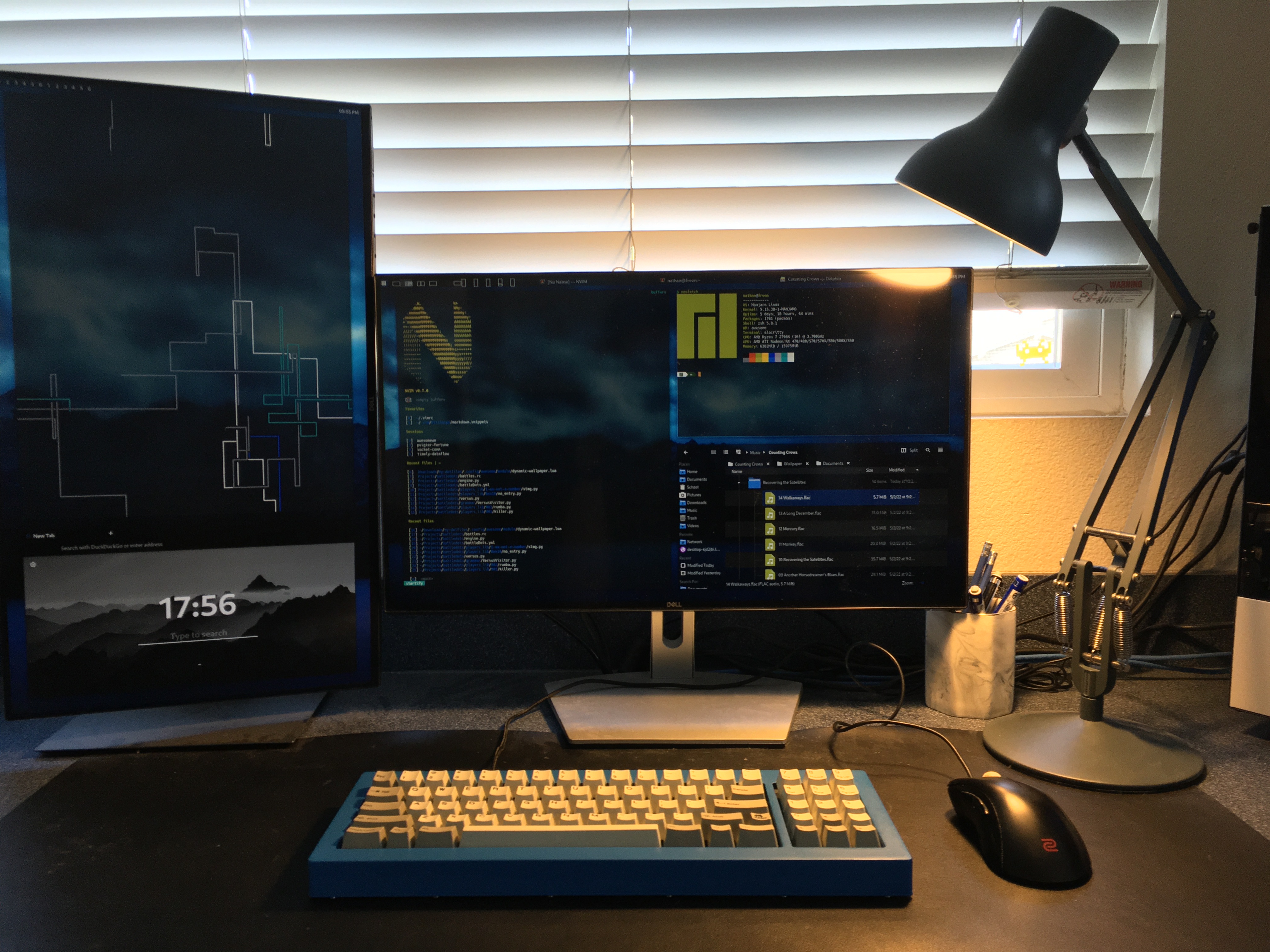

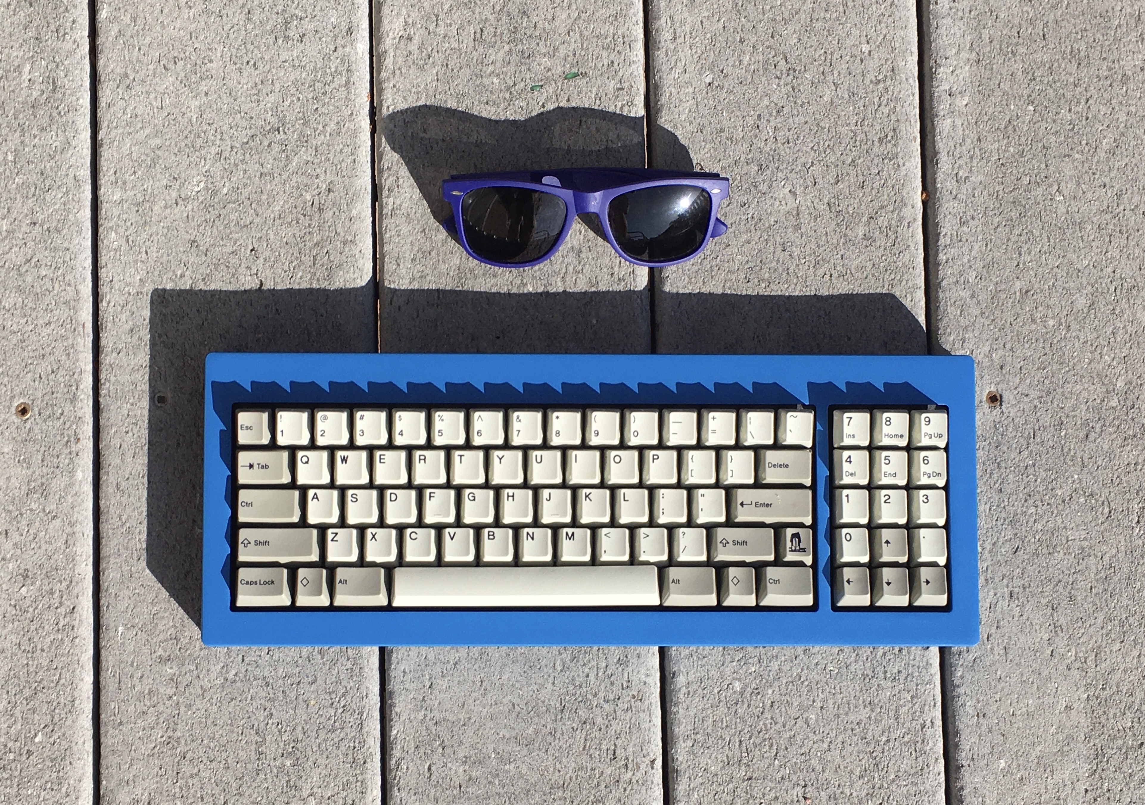

Neightro
23 May 2022, 03:29
I got my F77 in the mail a few weeks ago, and it has successfully helped me survive finals week. The experience has been incredible so far. Thank you to Ellipse, the firmware hackers, and everyone else making this project possible!
I switched to the dark blue case for the summer, so here's a few photos of what that looks like.
Out on the deck. The dark blue is a fittingly summery atmospheric blue.
A snippet of my setup. On the off chance anyone is curious, the mouse is a BenQ Zowie EC1-A; the lamp is an Anglepoise Type 75 Mini, another classic spring mechanism in its own right.
Ellipse
23 May 2022, 03:42
Neightro wrote: 23 May 2022, 03:29 I got my F77 in the mail a few weeks ago, and it has successfully helped me survive finals week. The experience has been incredible so far. Thank you to Ellipse, the firmware hackers, and everyone else making this project possible!
Nice looking photos and setup Neightro! Thanks for sharing these photos. I believe this is one of the first Dark Blue powdercoated keyboard photos that has been shared! I like the use of the buckling spring logo key as perhaps the function key - makes for a nice custom touch for the layout.
