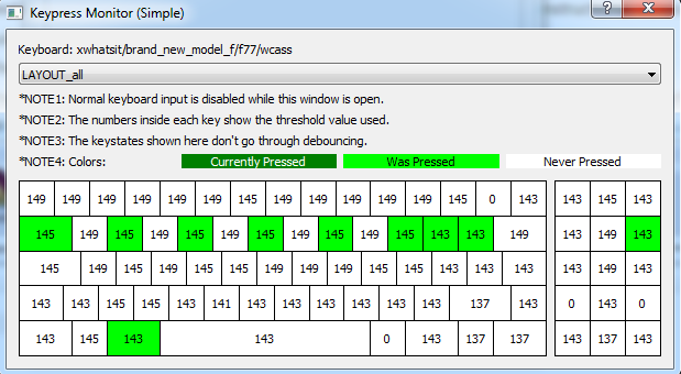

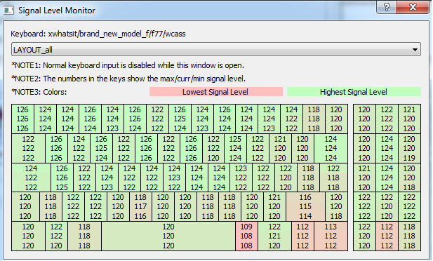

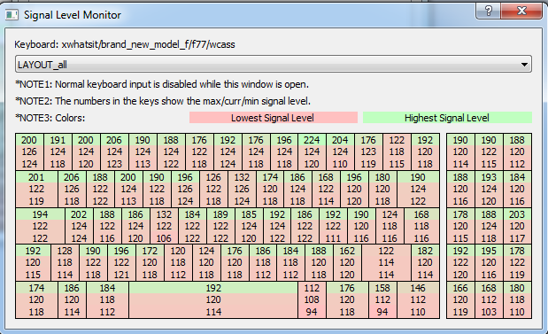

Hi everyone, my model f77 keyboard finally arrived! The initial impressions are good. The quality of the materials is indeed very high. Some minor issues regarding the keycaps were resolved easily by following the manual. Didn't hurt that I had already some experience with the model m.
But after I used it for a bit, I noticed some erratic behaviour regarding key presses. For example alt + tab wouldn't work every time or some key presses would not get registered. I had installed all the keycaps correctly without having to force anything into place. By following some of the instructions that I found so I proceeded to disassemble the outer casing and then screwing down the daughter board tightly. The problems still persisted. So I opened up the utility pointed out in the manual. Here are some screenshots.
Similar behaviour to the last image I got by pressing all the keys on the left most column several times which resulted on most of the keys of the first 3 rows to get green without pressing them.

In your signal level monitor test, I note that your keys in the Y, U, F, V, and B positions seem to show very weak capacitance level differences when being pressed vs. unpressed. (Either that or you forgot to press them before taking the after_pressing_all_keys screenshot.) And the keypress monitor shows computed threshold values for those keys (in the mid-to-upper 140s) that are higher than the values they show after they've allegedly been pressed (between 120-132), so I would expect some trouble while using those keys unless the root problem there is identified and addressed.
vpap wrote: 25 May 2022, 17:33 Similar behaviour to the last image I got by pressing all the keys on the left most column several times which resulted on most of the keys of the first 3 rows to get green without pressing them.
This is the same behavior that sedevidi and I were discussing just a couple posts above yours, where multiple random keypresses show as being simultaneously registered in the utility when you press an unrelated key. I see the exact same kind of thing happen on my 2 perfectly working keyboards, which is why I called it a possible "red herring"...it doesn't seem to be diagnostically relevant.
It's almost like the keypress monitor in the utility is overly sensitive to a row getting "strobed", registering very rapid rise and falls in capacitance as a phantom keypress even though the actual matrix decoding logic in the firmware itself either ignores or filters those out. (The other keys showing phantom keypresses do not continue to show as being held down even if you continue to hold down the one key you pressed. I have tested it repeatedly, and the phantom keystrokes do always seem to happen only to keys on the same row as the key that you actually pressed. Select the raw "Matrix" layout at the bottom of the layout drop-down list when testing to see if it is the same in your case.) It would be nice if the keypress monitor reflected how the firmware would ultimately interpret what it saw rather than give you a seemingly more "raw" view of things, which I think is potentially leading people down the wrong paths, troubleshooting-wise.
vpap
25 May 2022, 21:32
I see, thanks for the heads up NathanA. From what I understand, the 3rd note on the keypress monitor states exactly what you are saying. I just tried to reflow a bit the wire connections to the daughter board, which are easily accessible, but I still get the exact same behaviour. I am not 100% sure about which other keypresses are not working as they should but I can reliably replicate the unreliable alt + tab behaviour :P
NathanA
25 May 2022, 21:35
vpap wrote: 25 May 2022, 21:32From what I understand, the 3rd note on the keypress monitor states exactly what you are saying.
Oh, good catch! Yes, I believe you are correct.
vpap wrote: 25 May 2022, 21:32I am not 100% sure about which other keypresses are not working as they should but I can reliably replicate the unreliable alt + tab behaviour :P
Do either Alt or Tab show weird behavior when used individually?
vpap
25 May 2022, 22:17
I tried them individually on normal day to day work and I couldn't find something wrong. But by using the Keypress Monitor I found out that when I was pressing down some keys, some where a bit more responsive than others on quick successive presses. I tried after some presses to press down the key fully for a second or two. And then I saw that the alt key when completely pressed would not always be shown as pressed down.

NathanA
26 May 2022, 03:21
vpap wrote: 25 May 2022, 22:17 And then I saw that the alt key when completely pressed would not always be shown as pressed down.
Sounds like between the two of them, it's the Alt key that's the actual problem, then. If you sometimes see that keypress monitor doesn't show the key as being pressed down when it is, do you also similarly see signal levels not always changing as expected for that key on the signal level monitor when you press it?
I still think it's weird that Y, U, F, V, and B all show as low 130s at best on your signal level monitor screenshot after you said that you pressed them...are you also having problems with those keys?
