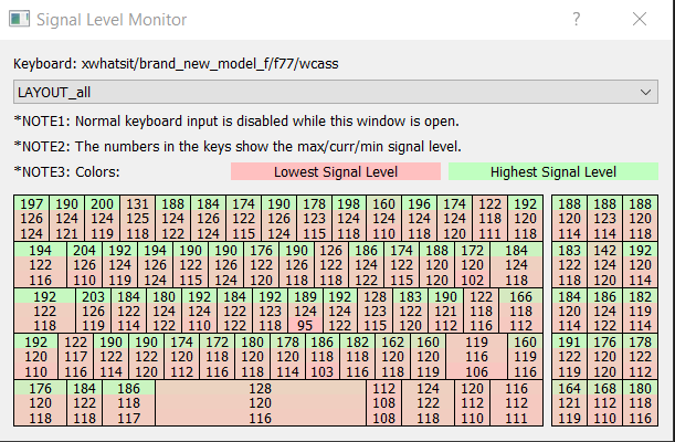

vpap
26 May 2022, 10:42
NathanA wrote: 26 May 2022, 03:21
vpap wrote: 25 May 2022, 22:17 And then I saw that the alt key when completely pressed would not always be shown as pressed down.
Sounds like between the two of them, it's the Alt key that's the actual problem, then. If you sometimes see that keypress monitor doesn't show the key as being pressed down when it is, do you also similarly see signal levels not always changing as expected for that key on the signal level monitor when you press it?
I still think it's weird that Y, U, F, V, and B all show as low 130s at best on your signal level monitor screenshot after you said that you pressed them...are you also having problems with those keys?
It seems like the Alt key was the problem after all. I took out the keycaps of Alt and Ctrl and I compared the barrels and the springs and there wasn't anything too obvious. But it seemed like at their resting position the spring on Ctrl was always on the center of the barrel, meanwhile the spring on Alt was always slightly looking downwards. So with a pair of tweezers I played around with the spring on the Alt key and I tried to "bend" it the other way. This seemed to have done the job, I can't replicate the previous erratic behavior anymore.
Regarding the other keys you mentioned I redid the test by pressing each key on the keyboard instead of trying many at once. I don't have problems with other keys so far.

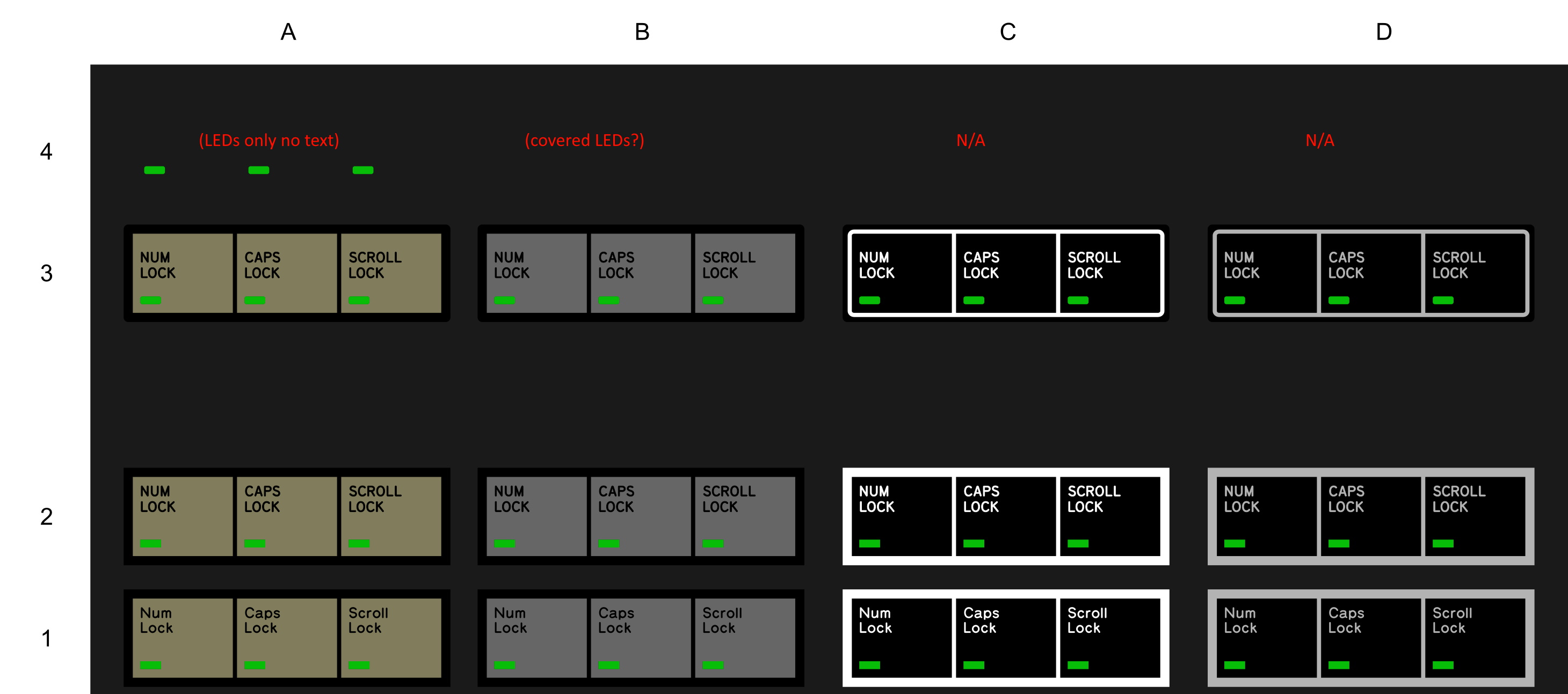

Ellipse
30 May 2022, 06:20
Also posting here as well as on the beam spring project thread - what do folks think about the new beam spring LED overlays? They will be Model M spec so that they can be used on the original Model M keyboards too (maybe if you use the new Model F project keys on a Model M or are custom adding overlays to the F77/F62?). A big thanks to Zed for creating these overlays.
In the coming weeks I expect the factory to start production on these. It may be possible to offer additional designs if there are any suggestions, but not sure yet. There may be a limit of designs so not all of the below designs may be produced.
LED overlays.jpg (312.8 KiB) Viewed 46730 times

As a recap, I tested on the following ports on my Thinkpad T430 with my Mini Dock Plus Series 3 :
  • dock USB2, 2 hubs from the root, with mouse, phone and USB-audio : bad LeftCtrl, not good feeling overall
  • dock USB3, directly on the root hub : some glitches with LeftCtrl, good feeling
  • laptop USB2 yellow rear charging port : everything OK
  • laptop USB2 side port : everything OK
I didn't test on any other computer. I'm testing now without the USB-audio adapter (I just swaped audio and keyboard to keep them "away" from each other).
30 May 2022, 14:08
sedevidi wrote: 30 May 2022, 13:08
  • bad LeftCtrl, not good feeling overall
  • some glitches with LeftCtrl, good feeling
Perplexed about what you mean by "feeling" when you say the board's flaky on them both.
I'd definitely try with another computer, too. Anything with USB will do. ;)
sedevidi
30 May 2022, 15:18
Muirium wrote: 30 May 2022, 14:08 Perplexed about what you mean by "feeling" when you say the board's flaky on them both.
The LeftCtrl is definitely the worst key, thus defines the flaky behaviour. Other keys feel like they do not registrer some times, or registrer a bit late: that's the feeling. Nothing definitive or clearly defined. LeftCtrl is the only key which I can really identify as OK/not OK, depending on the USB port... And ports provide various levels of feelings, from really bad, to somewhat OK, to really good.
Muirium wrote: 30 May 2022, 14:08 I'd definitely try with another computer, too. Anything with USB will do. ;)
My latest test is "swap keyboard and audio", and it seems to be OK up to now (keyboard on dock, USB audio on the laptop). So, it seems that this not-so-cheap chinese USB dongle introduce power supply noise, which, on top of the probable dock noise, makes the keyboard mis-behave. I have this USB audio dongle because the analog audio routing from the laptop through the dock, to the microphone jack, introduced a lot of analog noise that is not present when using the laptop's jack or laptop's microphones...
