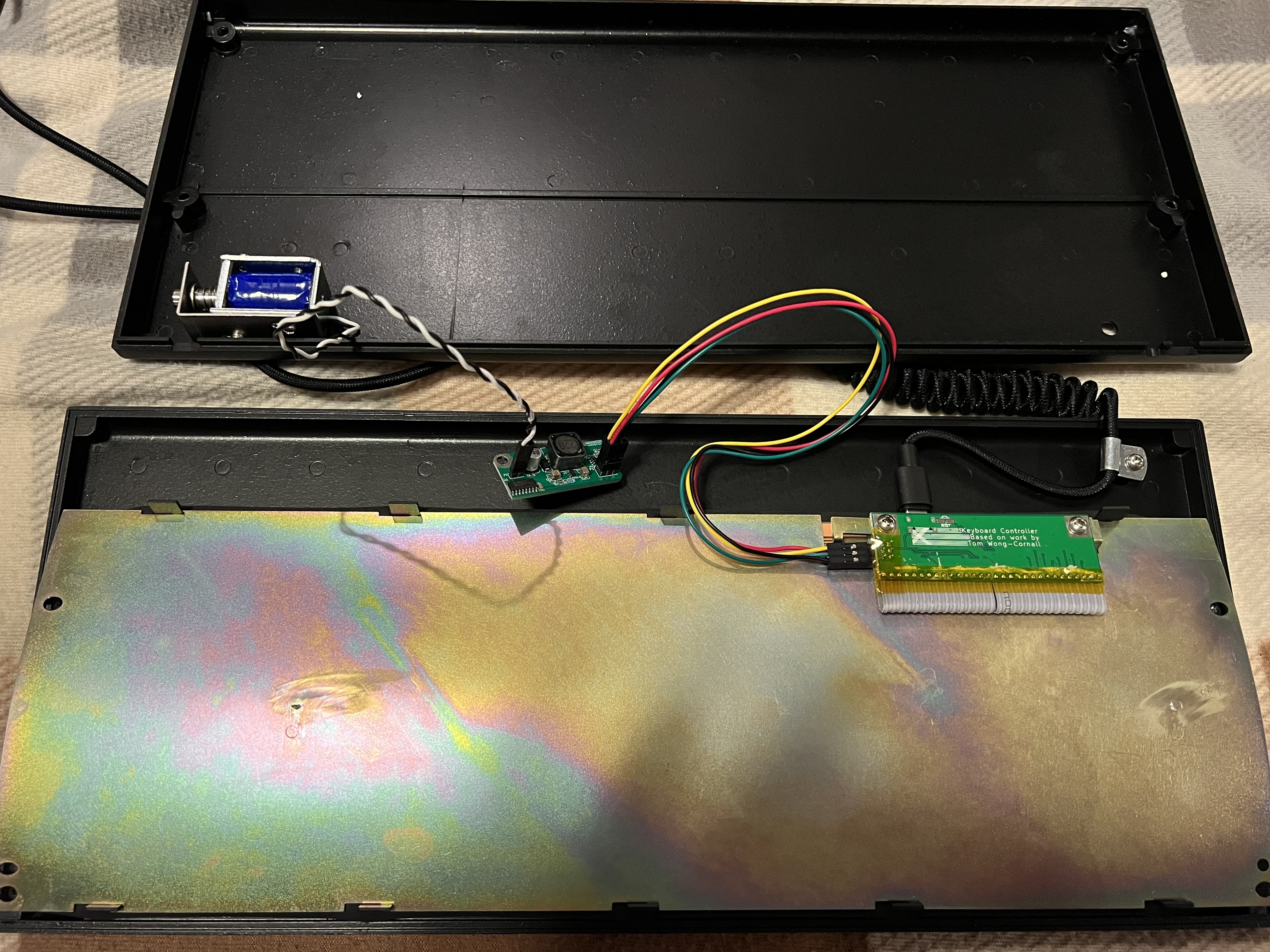

I'm having issues with the solenoid, I installed according to the video but it doesn't work. I just hear a fain buzz when enabled but it doesn't work. Does anyone know how to fix it?
elira
06 Jun 2022, 04:14
elira wrote: 06 Jun 2022, 03:37 I'm having issues with the solenoid, I installed according to the video but it doesn't work. I just hear a fain buzz when enabled but it doesn't work. Does anyone know how to fix it?
Ok, solving my own issue. I took the solenoid and controller out given that I saw it has a small LED that tells you if the solenoid is enabled or not. Once I did that I saw that the controller's LED was flashing properly. Upon further inspection I saw that the header solder joints looked bad (on the solenoid controller), so I reflowed them and now it works fine. It's my first keyboard with solenoid. I think I have fixed all the keys that were funky, so far it seems like an interesting keyboard, but it seems to need a lot of tweaking to get it to work. So far I have had to replace 3 springs, and re-seat a couple more.

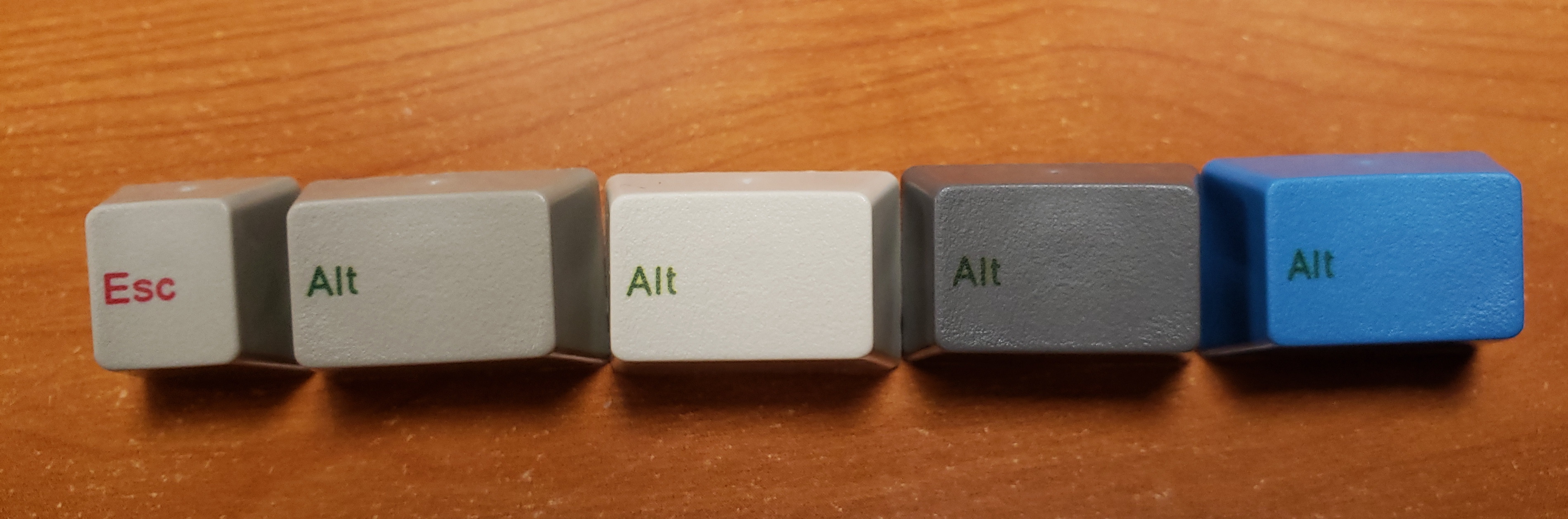

Project milestone: this week the 3000th Brand New Model F Keyboard shipped! I am still going through the backlog and expect to finish up over this month and next month as noted earlier.
Also the first red and green text dye sublimation keys arrived from the factory and look nice. Some folks wanted red text esc or green font for the alt key like on the Model M keyboards.
2022-06-07_13-35-16 - Copy.jpg (868.96 KiB) Viewed 40775 times

RaoulRod
13 Jun 2022, 01:43
I got my solenoid in and installed it, got it working!
In the manual it shows you where to install the solenoid in the classic case. But nothing deals with where to put the driver board. Other than using some double stick tape, does anyone have a good suggestion?
There is a spot for a screw on the driver board, but I didn't find any good spots to mount it in the case

RaoulRod the solenoid driver can be loose but I recommend taping the bottom side with polyimide or electrical tape so that it does not accidentally come in contact with any exposed metal surface such as the bottom inner assembly plate.
RaoulRod
13 Jun 2022, 13:13
Ellipse, thanks for the reply. I think mentioning the solenoid driver location/electrical isolation is something that should be added to the manual/video. Also, I did experience the same electrical gremlin that AgentOrange96 experienced. Initially I screwed the solenoid in too tightly, and it didn't work when the case was closed. I replaced the outer washer that I ripped trying to secure the solenoid and it is working now.
I do need to raise the board more than the standard cork feet to account for the extra height of that screw.
Again, something to probably add to the manual

Confirmed I have added the solenoid notes to the manual as well as on the solenoid product page.
